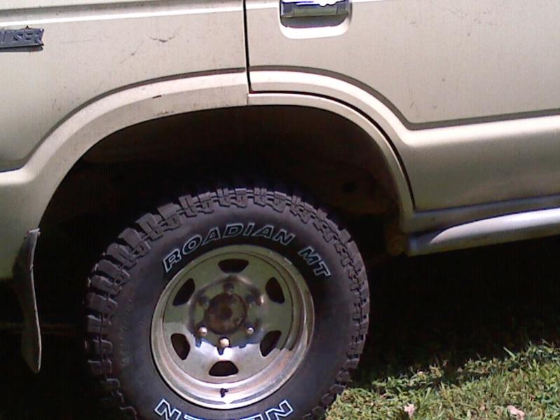

Well these are actually smaller than what i had.(235s) i am not a big fan of the rocks anyway. These actually were used. Had 500 miles on them.

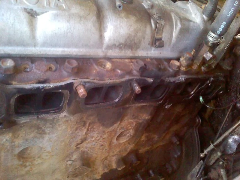

Dove into the exhaust leak today. Got one bolt that refuses to come out. Turns some but not much. Going to see about getting a long handled socket wrench today. Bolt has been sprayed several times with pb blaster.

Got it off. Breaker bar made all the difference.
Cleaned up well. Might hit it with a wire brush.
Started reassembling today. Should be rolling by Wednesday.
I'm just going to warn you there is a good chance that gasket is going to leak. Especially with those headers. Tighten those bolts down evenly.
Started it up today. Looks good so far. Seeing some smoke here and there but i have spilled antifreeze and that ceramic paint has to cure. Still got to put exhaust pipe back on but so far so good.
I have to concur with Marshall having run several one piece headers.... they suck. I always seemed to have leaks. I hope you have better luck than I :beer:
Well if it leaks as long as it is not as bad then will live with it for now. Someone did tell me to cut the metal between the pipes and it would help but i did not try it.
