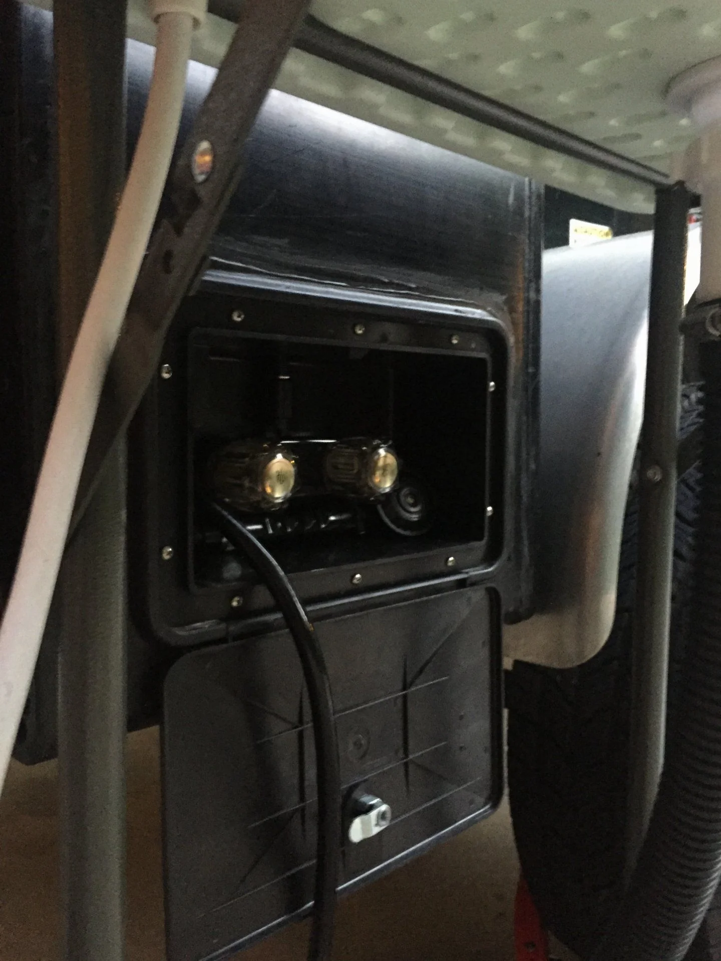

If he is gonna do it he needs to go big. This hangs in my hall, pulled it out of a huge house on the Main Line in Philadelphia in the late 80s.
Man that is friggin awesome!
I have an uncle with a huge old house in Vermont that has open fuseboxes like that all over the house.
I'll only agree to it if it's attached to a van de graff generator and every time I flip the switch a hunched over assistant says "yes master"...
How bout goin wireless, and using a Tesla coil, and shooting arcs of electricity between the truck and trailer? Would look really cool drivin down the road, with the under trailer lights synched up to the music, somethin classy, like Metallica's Ride the Lightning or somethin

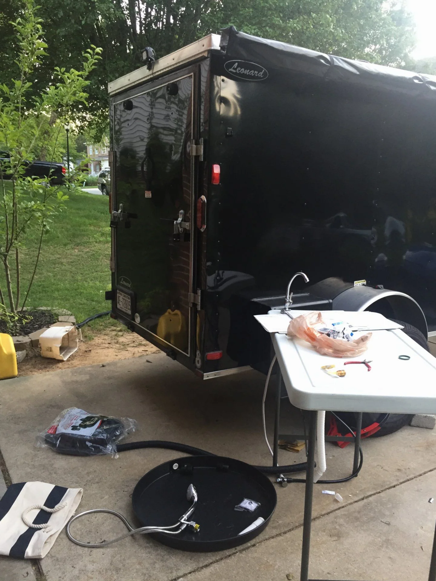

So the shower and sink, I.E: waste water is all done.
First I had to get a variety of plumbing supplies.
And make a huge mess.

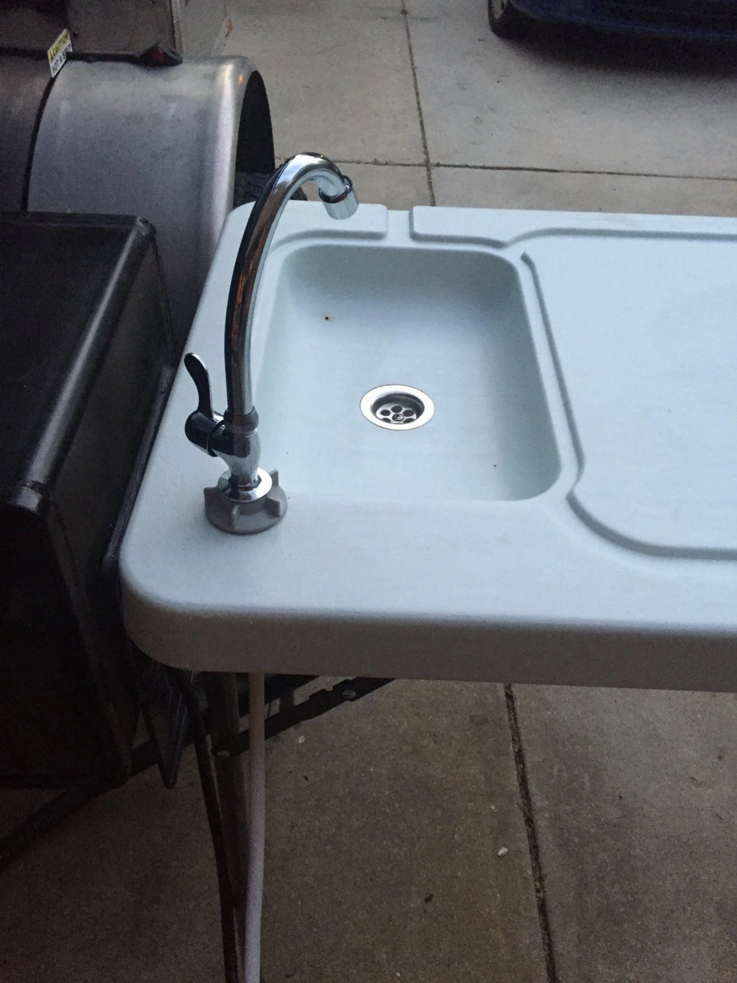

So. Water comes out of the faucet

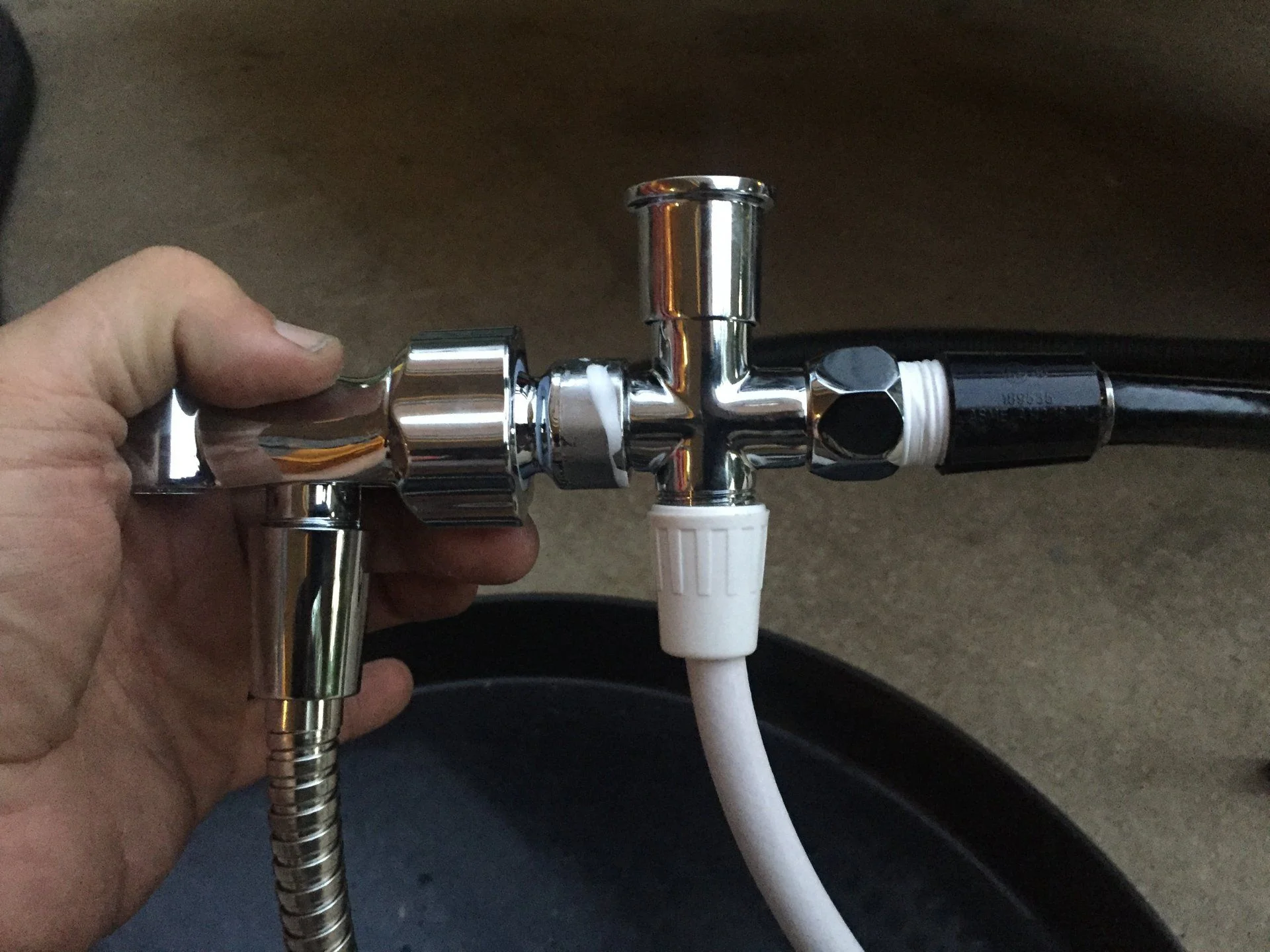

And goes into this little doohickey. Which switches between the faucet and the shower.
White hose goes to the sink table faucet:
The other hose goes to this shower head which will be hanging in the enclosure.

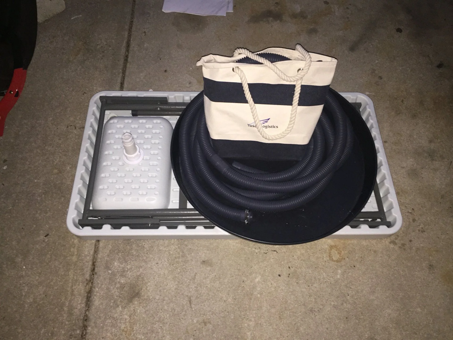

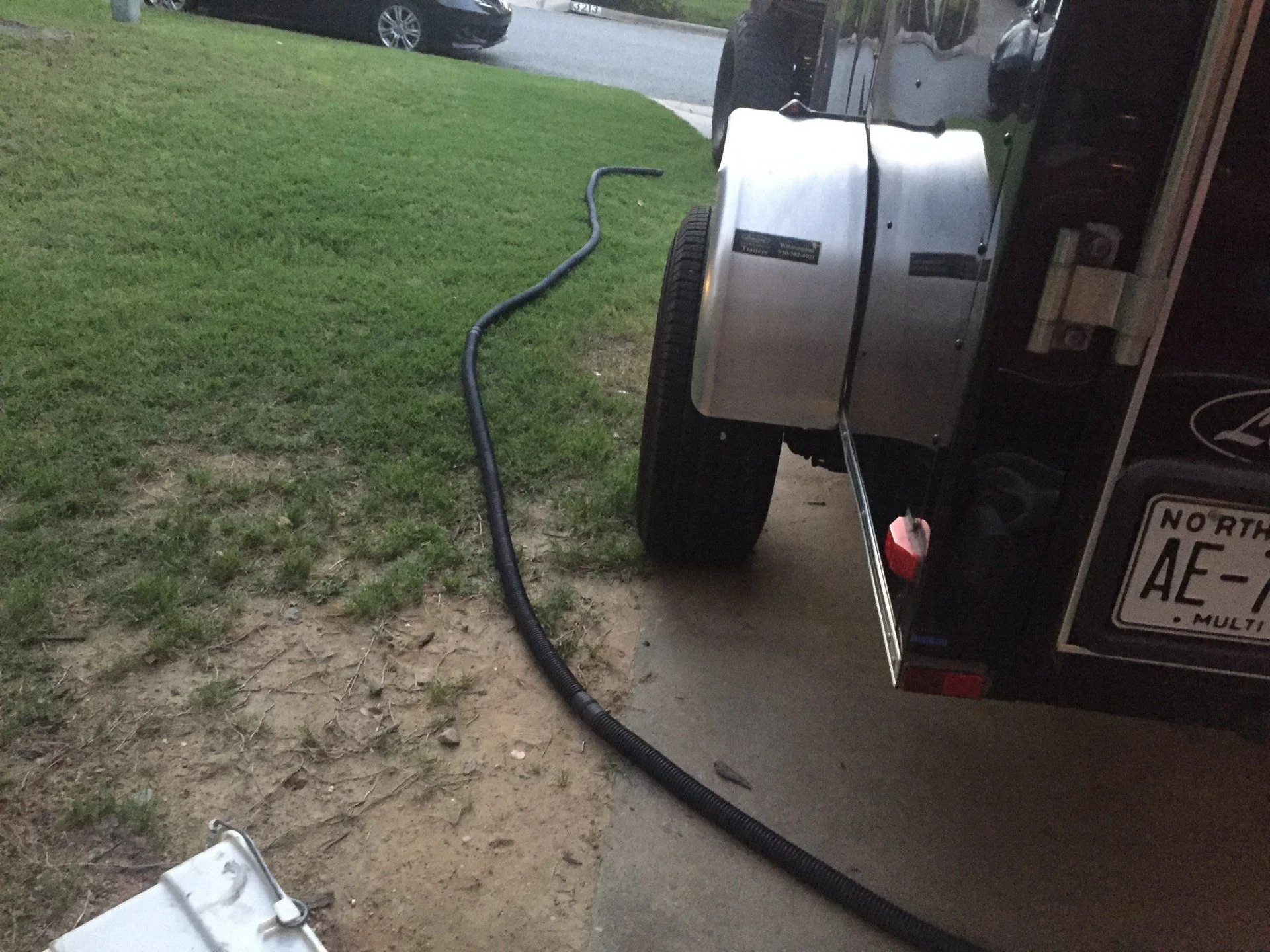

Inside the bottom of the enclosure will be this lightweight hot water heater pan. It's got a drain.
The T is where both drains meet.
Got 25 feet of discharge hose and another 20 foot extention hose if I need it.
Total weight of the table and drip pan and all fixtures. 29 lbs. not bad.
At 29 lbs/ft2 lol
Lookin good James. May wanna consider a check valve of sorts so you dont get scrambled egg bits in your shower pan ;)
Yeah - thought about the potential draining issue - that 1" leader pipe from the T thingy to the pan is just a slip fit. If there's backwash I can just put a longer leader pipe to fix it.

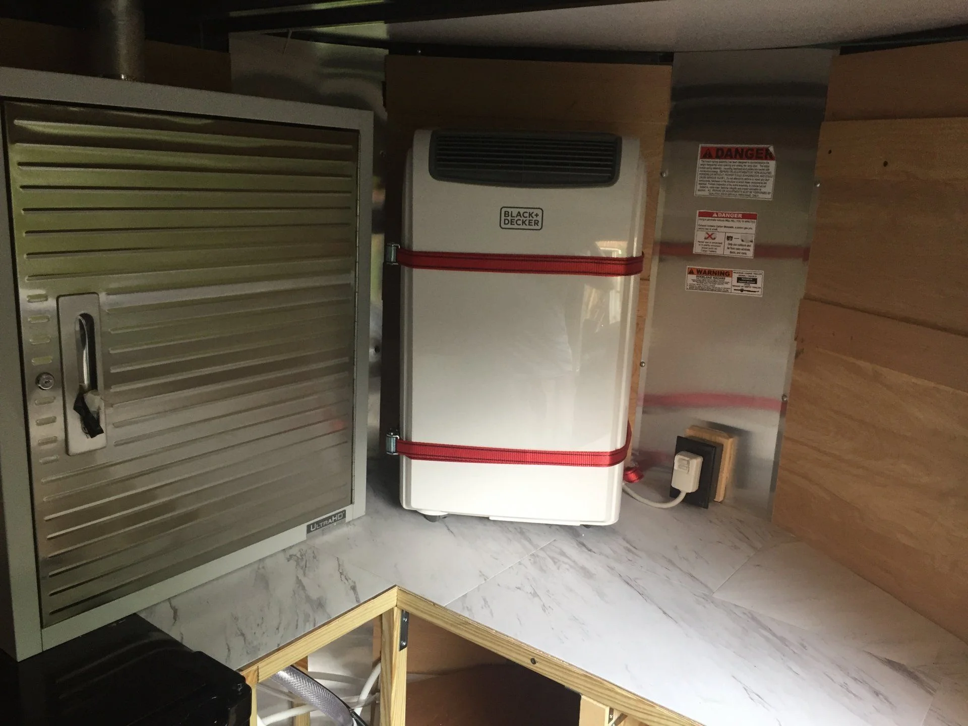

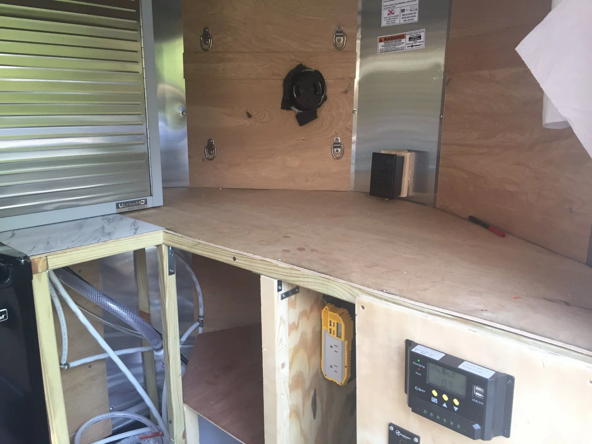

AC back in place.
Still have to face the cabinets and build some more inner structure. Doors are being custom built and a corner hinge is on order.

AC back in place. View attachment 1463159
