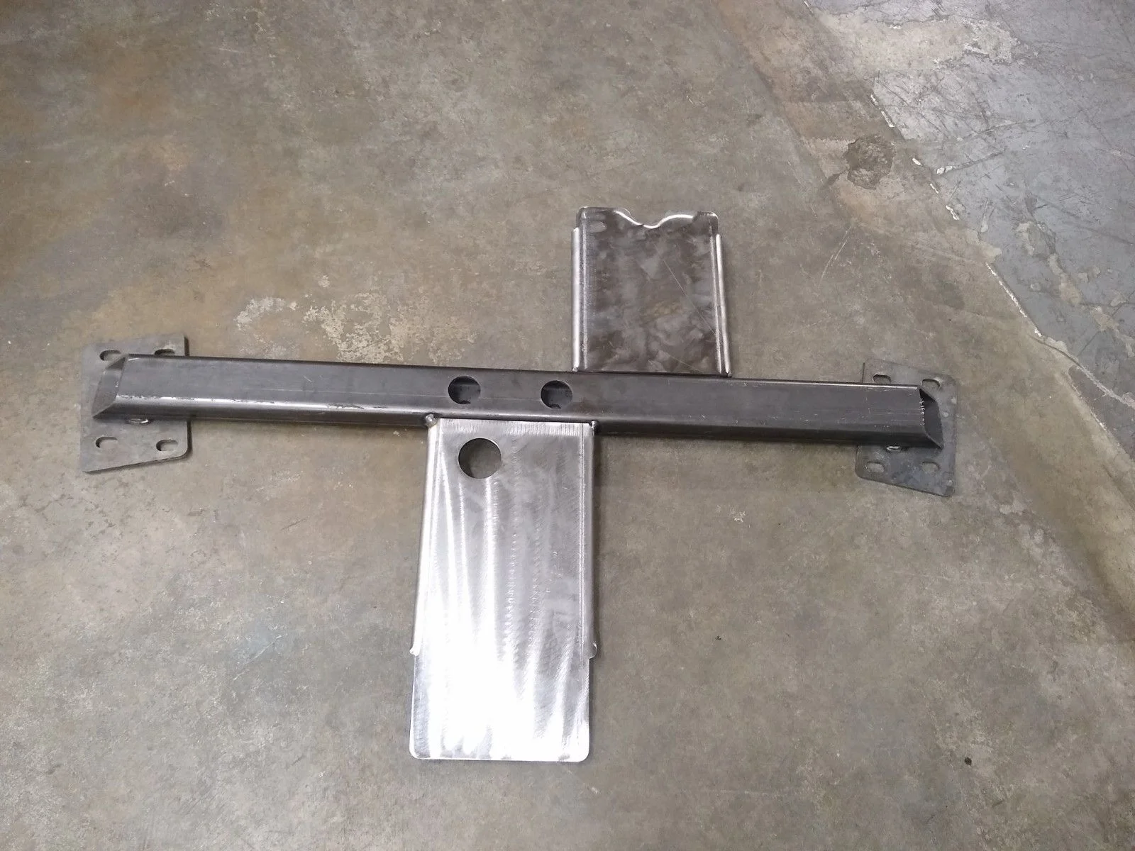

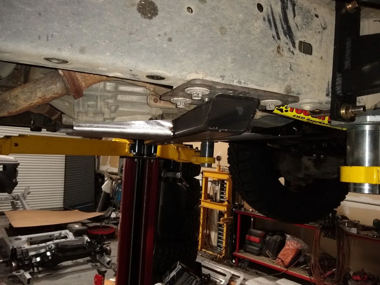

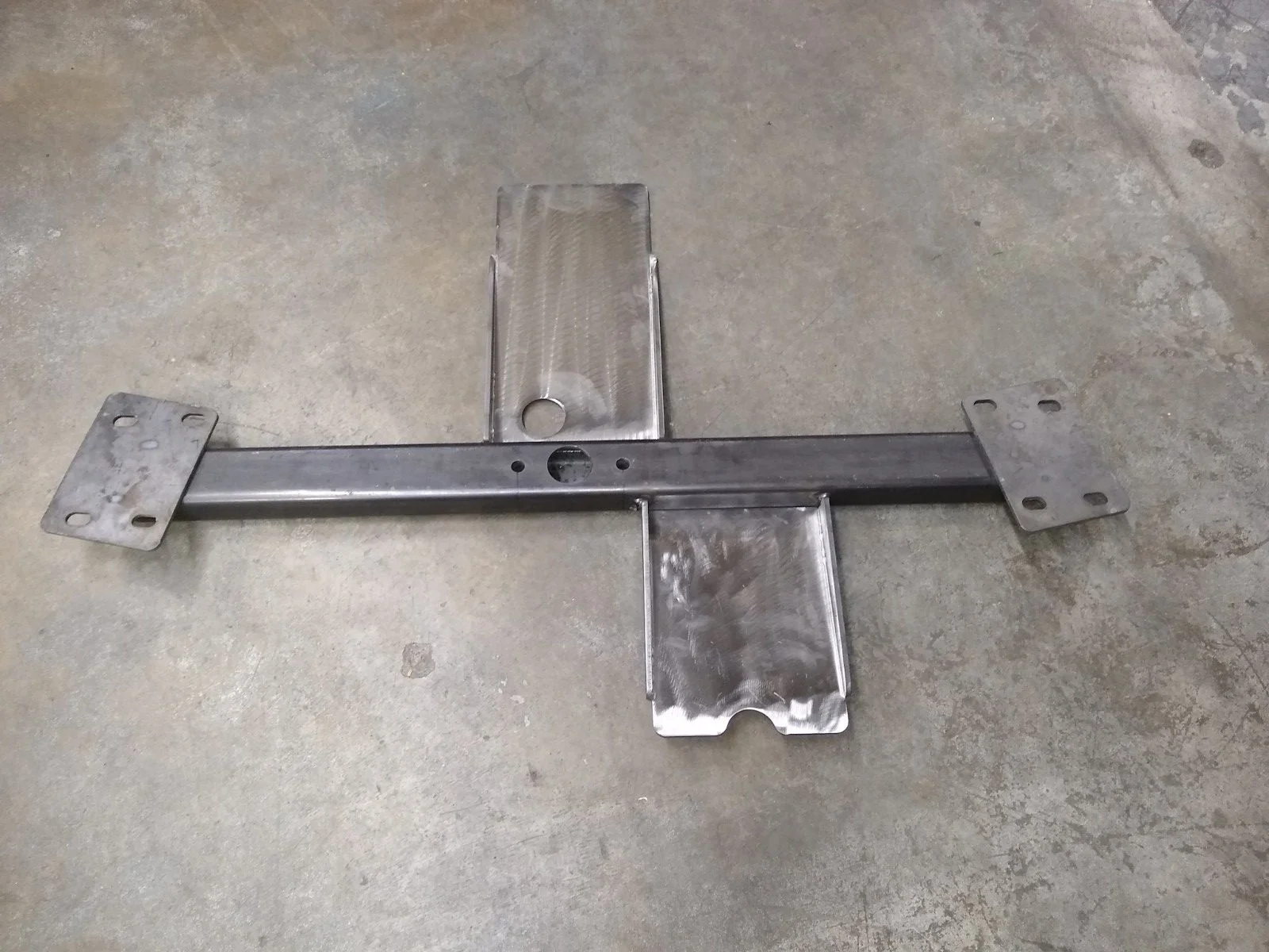

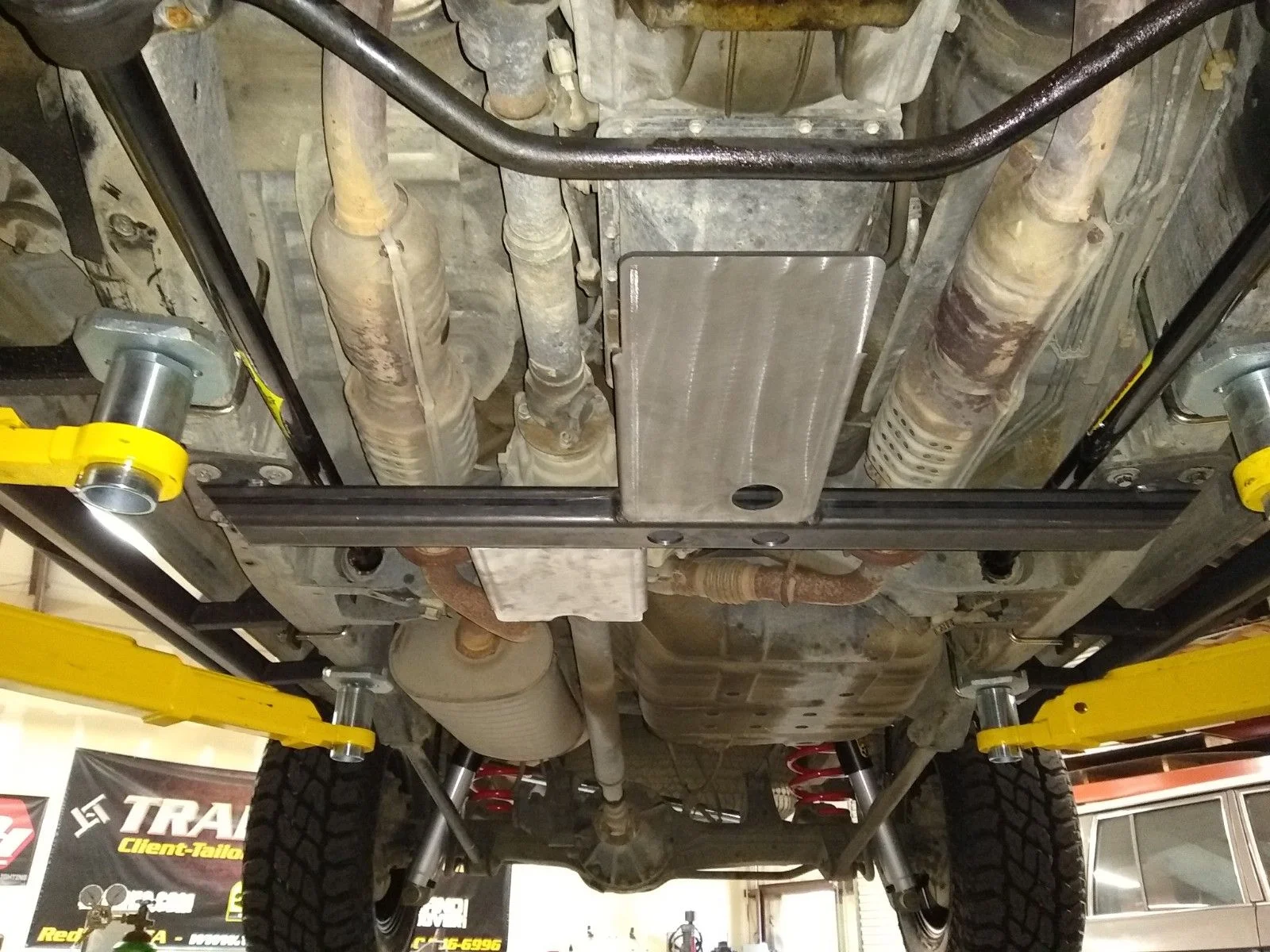

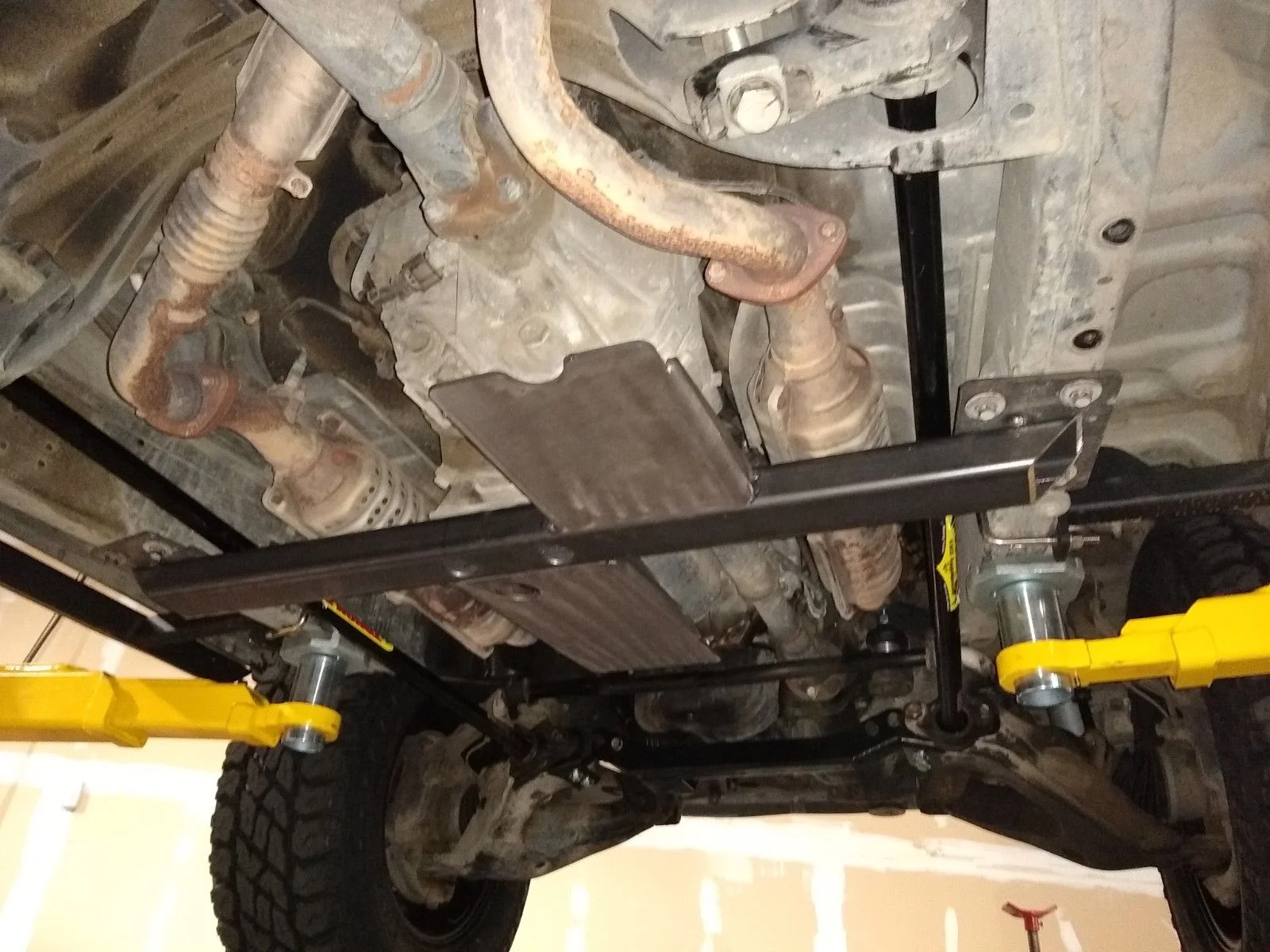

Got the Creeper Skid tacked up today.
Pricing will be 465.00 powdercoated SHIPPED to the lower 48.
3" x 2" x .250" tube crossmember, .250" Grade 50 frame plates and skid plates. These will all be CNC milled and cut. This replaces the factory crossmember. Protects the transfer case and the transmission pan. Holes are cut for draining fluids easily and still access the TC fill hole without dropping a plate.
Factory skid 18.4#
Creeper 44.2# actual product (shipping weight 51#)
Who's in on these? I'm order materials tomorrow and get going if I can get 5 orders.
