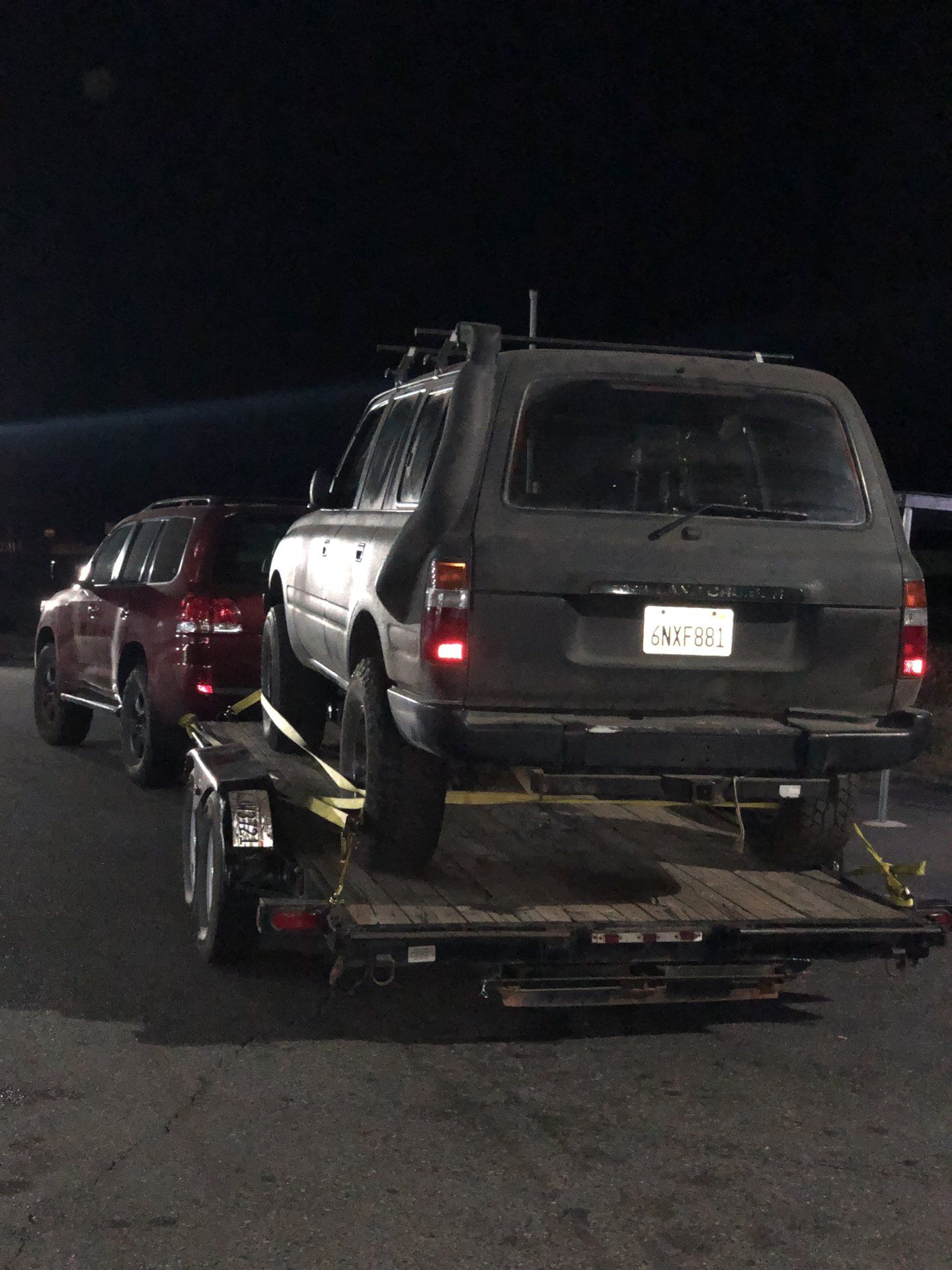

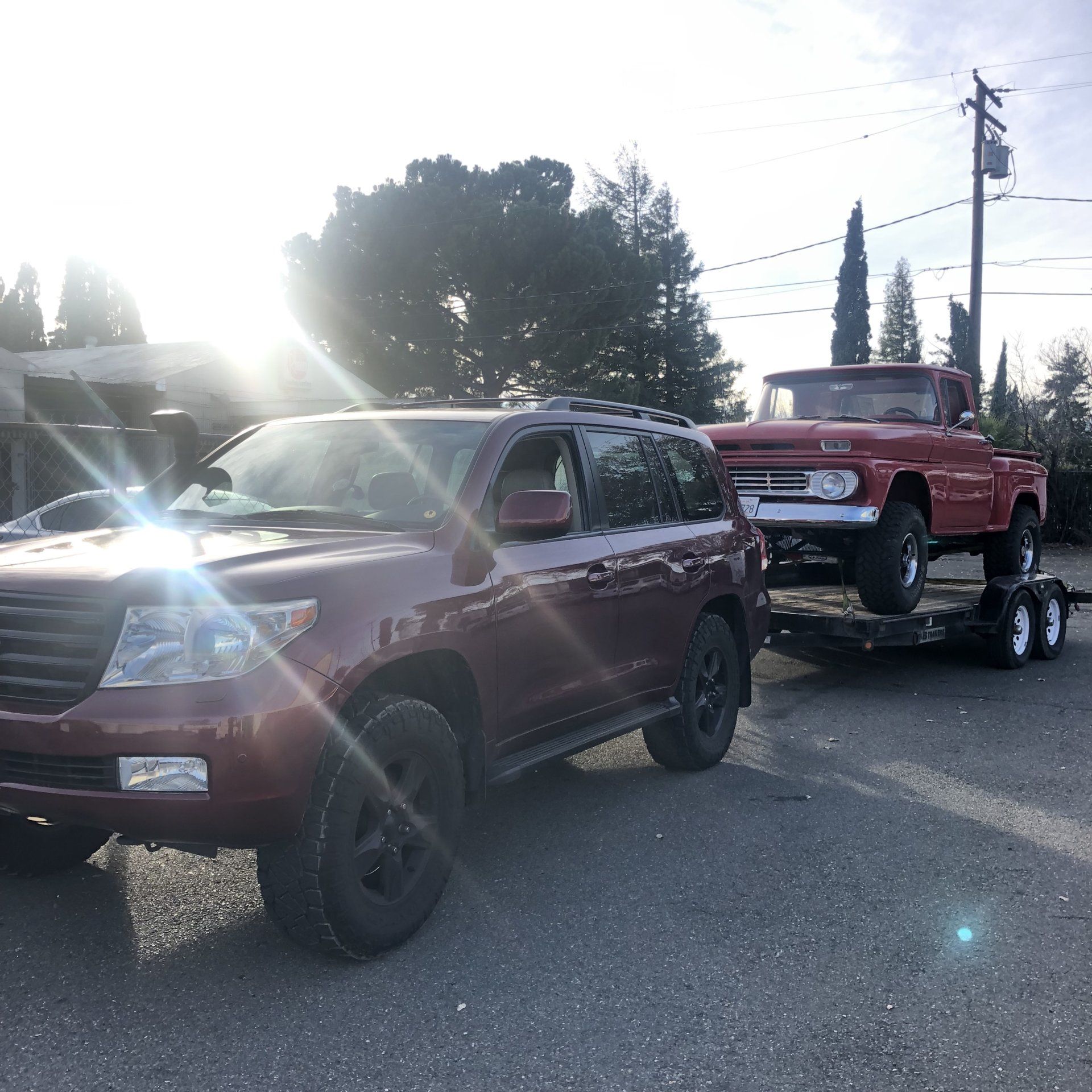

Jason, Thank you for the Coils. I have hauled 18 or 19 Vehicles and 6 Hoists with my move for the new Shop. These Coils and the 45mm TD Shocks set at position #8 (valving) are sooooo good. Cruiser handles like a Swedish Gymnast with the Trailer loaded. Hauled my 80 to Lake California and roads are crap and curvy but, it towed like a Champ! I have done some light wheeling in the snow last weekend on setting #2 and it's very comfortable and plush. Loving this setup for sure!

@fj80psi donyou have the heavy duty springs?
How is the ride unloaded?

What's going on with that 80? Rear snorkel?
Or have I just not had my caffine this morning?
It's a Remote Turbo Setup. I drove it for 7 years and had a ball with it. I decided it was time to make it my play Rig and not my DD, Thats when I got busy with life... It's my "Maybe Next Year" Project.

I am running Trail Taylor's TourFlex Springs and Tough Dog adjustable rear Shocks. Unloaded ride is great. I set them at position 5 for road, 8 when towing and 2 so far off road. The wide range valving really works well with these springs. I will be installing a rear Bumper soon so I think it will sit just right. As I understand it, the coils are actually taper wound. Jason can chime in with details I'm sure.
