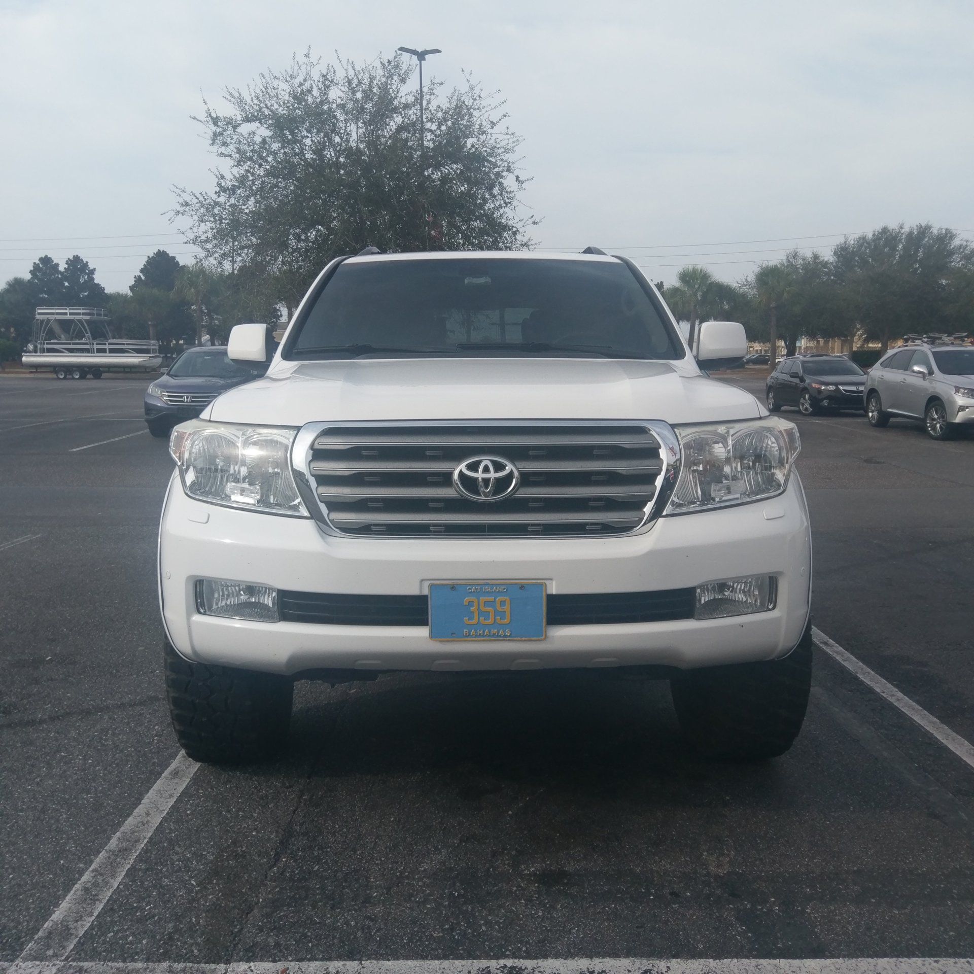

Did you use any lights to stay on while driving? I know we will lose the lower fog lights with the bumper. Is there a solution to the oem fender flares yet? J. Will you have all the part #s for all lighting options. Thanks MikeView attachment 1646778

No luck on the flares yet. I haven't even seen a 200 with flares here locally to look at.. Like I said before. You'll more than likely just have to mark and cut the flare approx. 1/2-5/8" from the bumper edge.
