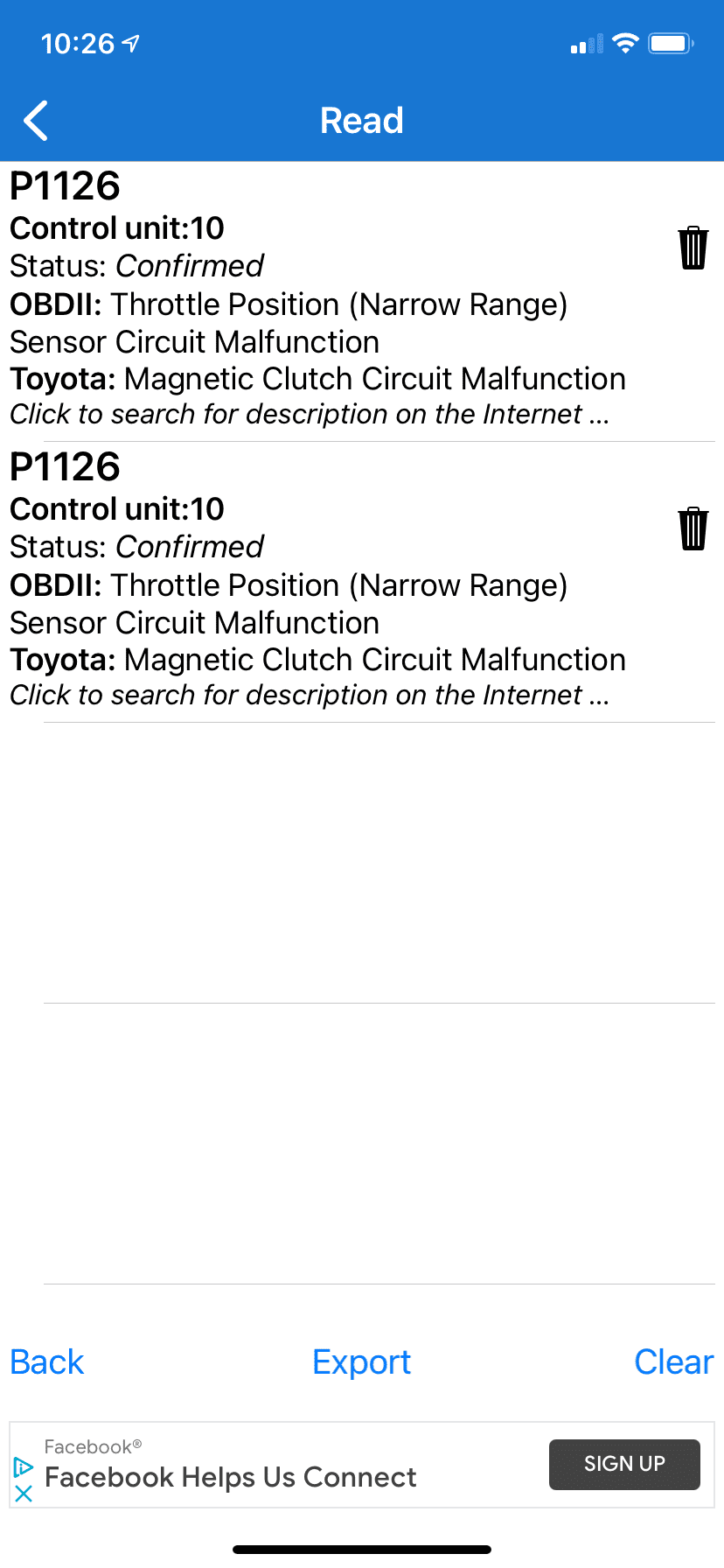

I got the cel and vsc off lights and all that jazz yesterday. No limp mode yet. Got a P1126 code from my reader. Reset it, on the third crank, same thing with the cel and vsc off lights. I’m thinking of trying to replace the TPS first as it’s the least expensive option to start with.
This is what my reader gave me... any thoughts?

Hey @Chaser717. So I chased the 1126 for a long time. I would show up each March once things started to warm back up in Texas. Performance was never an issue, but it made me pucker up when getting the car inspected. So I replaced both the APPS and TPS and it still came back occasionally over the course of a few years. After developing a dead spot on the new APPS sensor that caused me to lose power at 75mph (and have to pull over on I-40 in NM to rest and restart the car), I bought an entire take-off throttle body complete with sensors and haven't had a single issue since.
The cost of the used throttle body and sensors was less than the new APPS+TPS sensors I installed on the old throttle body. Wish I had just done that the first time around.

I took it to a shop and they dug around and cleared the code, said I needed a new TPS. I found a new throttle body for $437 with new sensors and all. But since they cleared it, the light hasn’t come back on so I don’t know. I may just put in the new throttle body in anyway just to renew the whole thing. But still hang on to the old one just in case.
