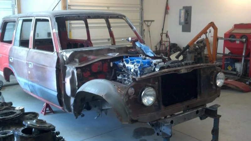

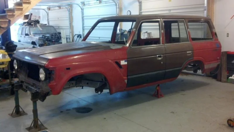

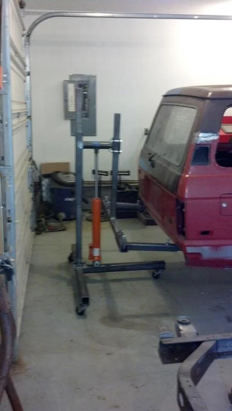

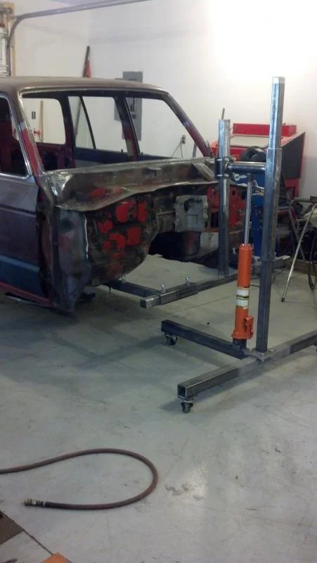

Got the rotisserie done to the point that I got the 60 body up on it. Need to add a few things to get it to balance out when up sideways. Enjoy the pics

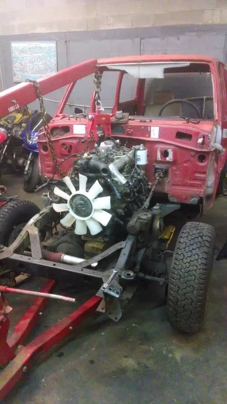

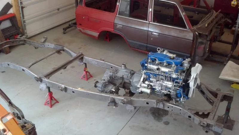

Slow and steady work on the 60. Got the motor to frame mounts in and the motor all bolted in. NO more engine hoist.

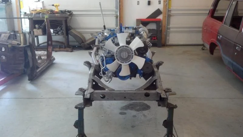

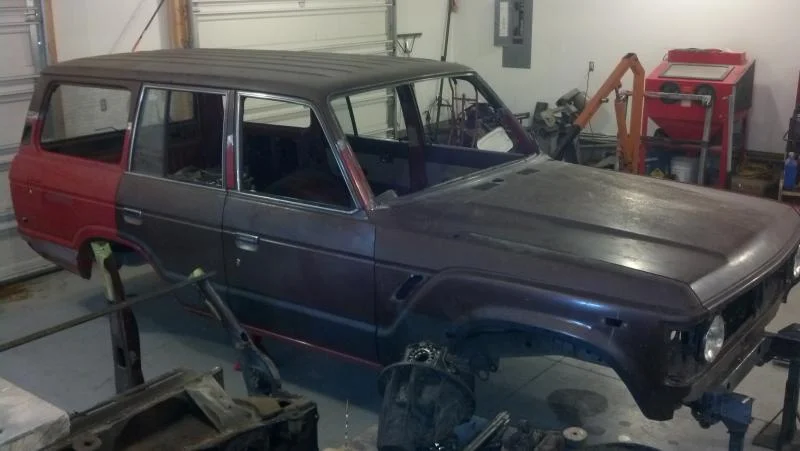

Got the body back on so I can get the weight on the axles to do the SOA conversion.

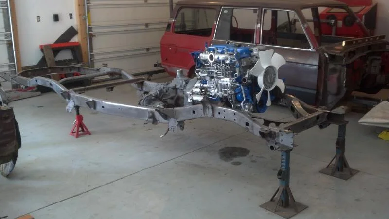

Few More Pictures
Got to a stopping point today with getting the body and other sheet metal parts on.

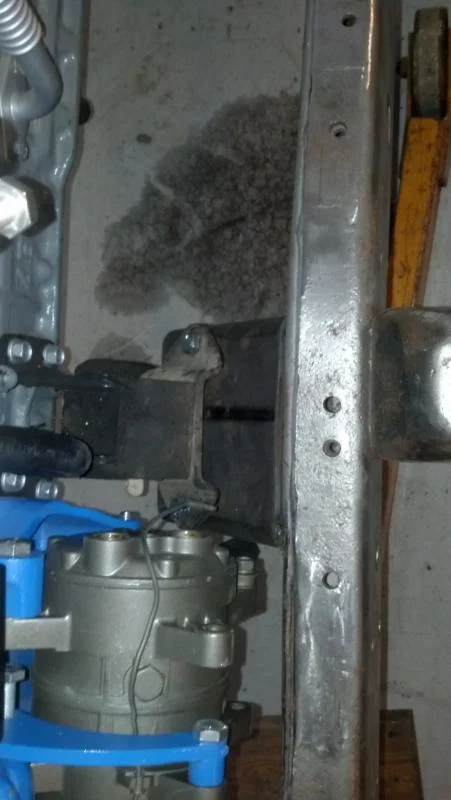

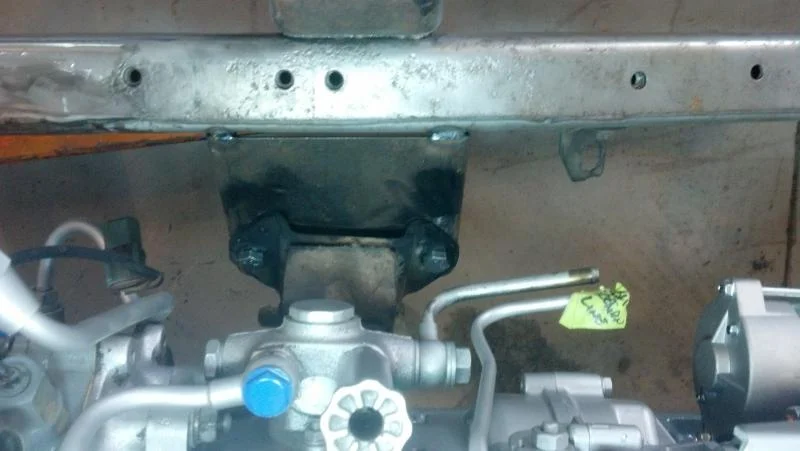

Here are a few pics of the motor mounts. Can't take credit for them, got the idea from doug720. Check out his build thread, the journey begins, its in the diesel section. I think he has some great pictures of the motor mounts on page two there.
1st pictures is passenger side frame rail mount
2nd picture is drivers side frame rail mount
3rd picture is the actual motor mounts before they got bolted up

Thanks, will review Doug's thread, though I know it well. Most interested in the gusseting on the plates that you welded to the frame, and how high the mounts are on the frame.
Here's why I'm asking...
