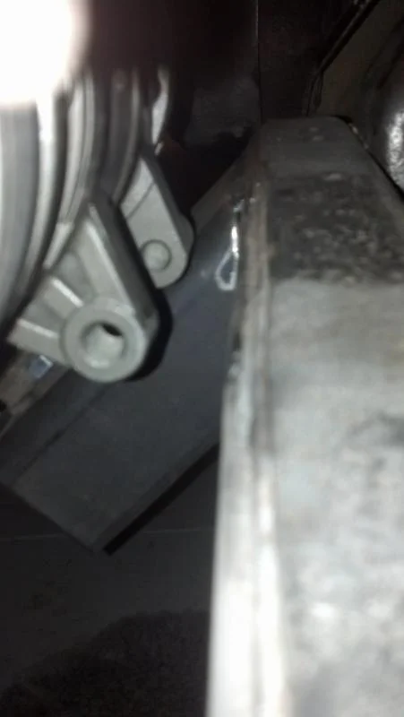

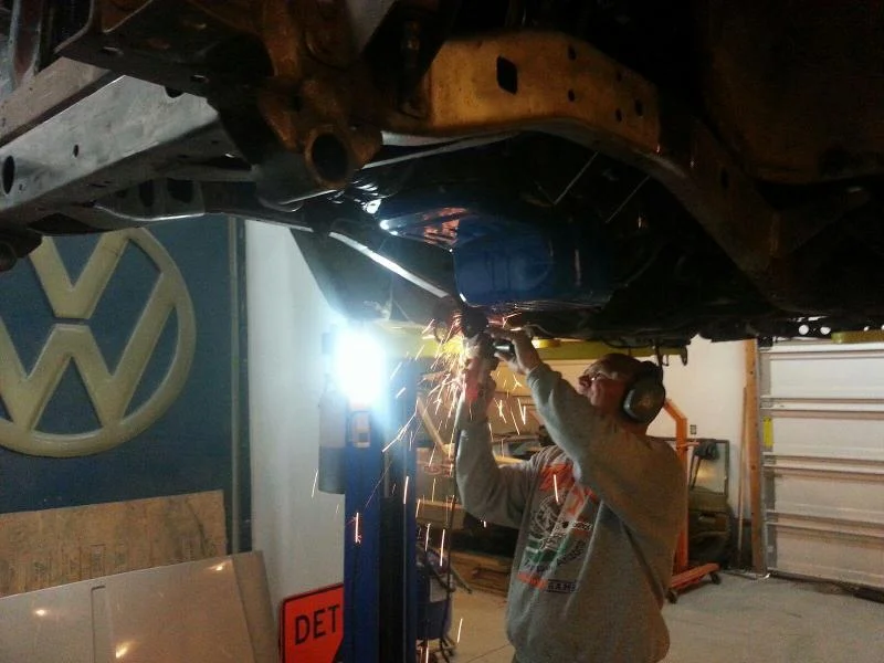

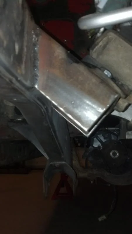

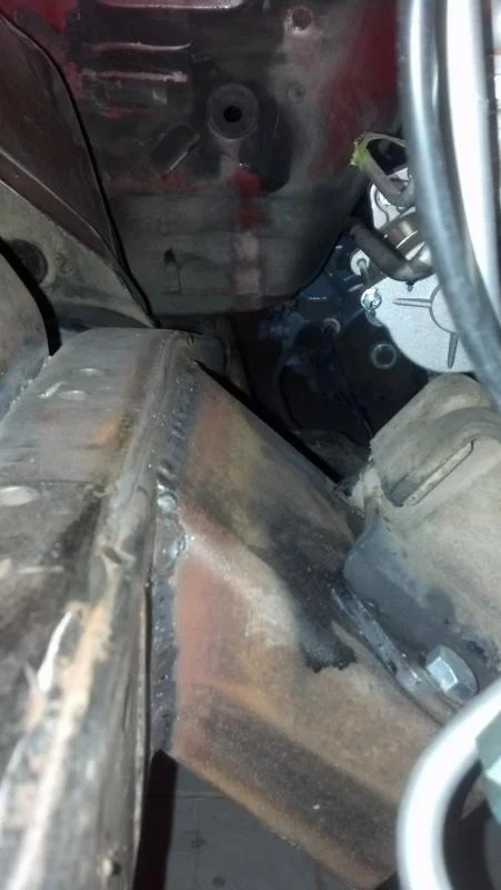

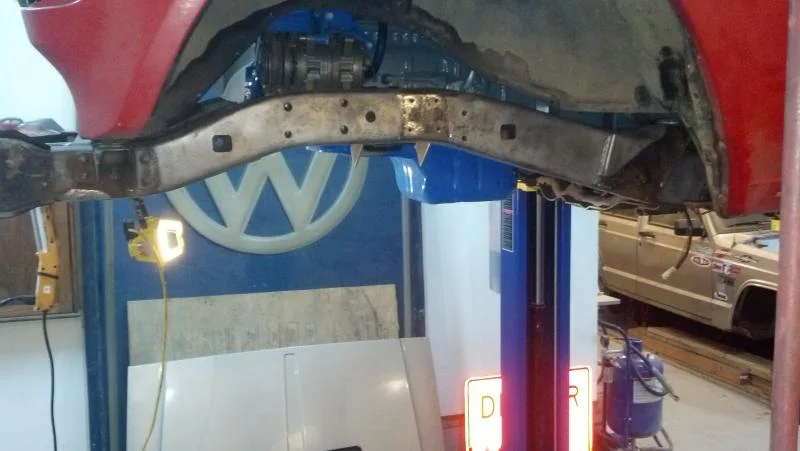

More Motor Mount Pictures
Here are a few more picture of the frame mounts for the motor.
1st is passenger side
2nd drivers side
3rd is underside of passenger side
Still need to trim off some of the excess. I don't have any gussets right now. I think the welds and downward pressure of the motor will be just fine, pushing the bottom of the mounts to the frame.

Thanks for the mount pics. I am very close now to doing mine. What are the specs of the rectangular tube? Looks like a great way to go on those.
Got the idea from doug720, the box tubing I used is 4"x6"x6" and I can't remember the wall thickness. I then had the angles cut at a machine shop and test fit the pieces. Had to cut the length down to about 5 1/2", then cut the bottom side off to make a C-channel and used a marker to locate the mount holes from the motor mounts. Then used an old motor mount and a transfer punch to locate the center of the holes on the marked area. If I remember correctly, the mount holes are 7/16". Hope that helps out. :cheers:

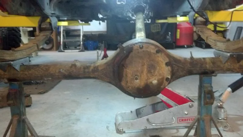

Well I haven't done anything to the front but clean up the frame rails. Started on the back leaf springs today. Got the springs mounted in the front by the spring hangers. Don't have any bolts for the shackles yet. Did get the third member in and the drive shaft hooked up. Got really lucky there. It bolted up fine and was really surprised. Thought that I would have to have it lengthened due to moving the engine forward. More to come..:cheers:
