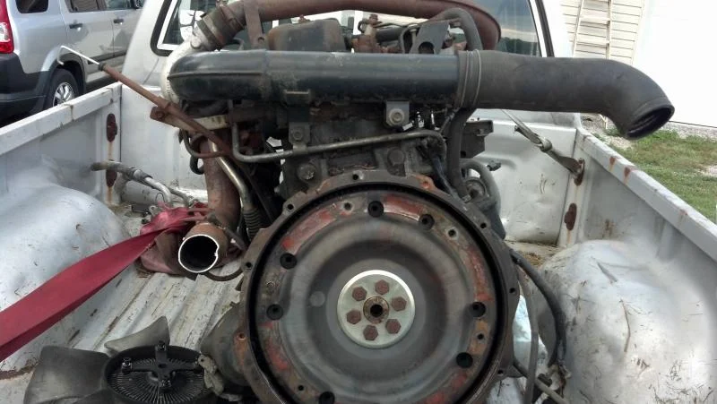

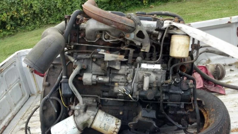

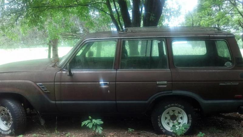

Well I guess it's time to start my build thread. Here are the plans, starting out with a stock 1984 Toyota FJ60 that had a tired worn out 2F motor. I really didn't know the condition of the motor and I always wanted a diesel. So I set out looking for a good diesel motor. Looked at the Cummins and went to look at a few. Every time I did, they sold before I could make a decision or I had the money. As luck would have it, found a guy with a Isuzu NPR box truck that he was parting out. Went to go look at the 4BD1T motor and it looked good and started up. Bought it on the spot and pulled it out the same day. So, this is the start.

My new purchase of the 1990 4BD1T Diesel Motor

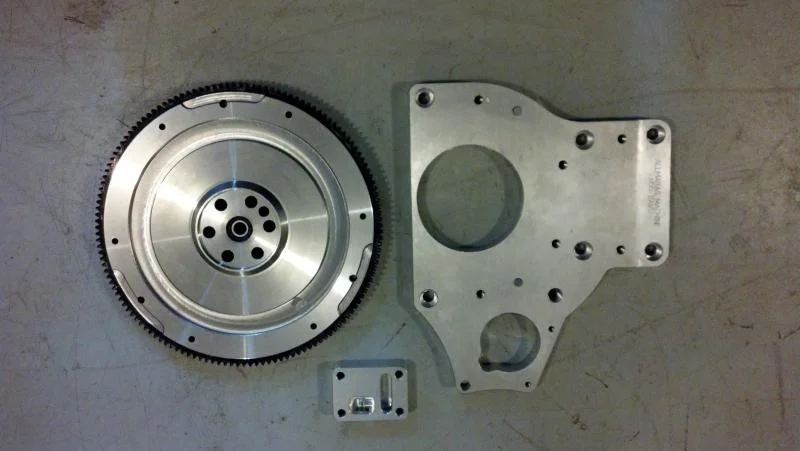

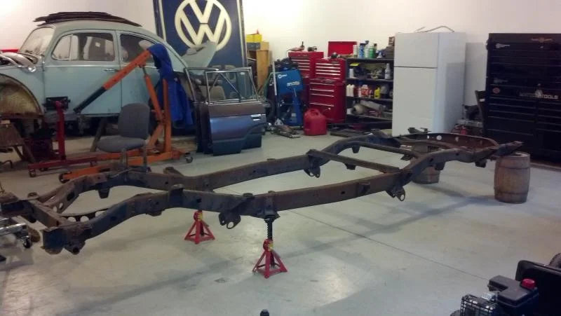

Got cleaning on the new to me frame. No pictures of the progress but here are some when I got it home and in the garage. Also some pictures of the adapter kit from Allmaras Machining. This kit looks awesome and bolts the stock Toyota bell housing to the 4BD1T Diesel Motor.

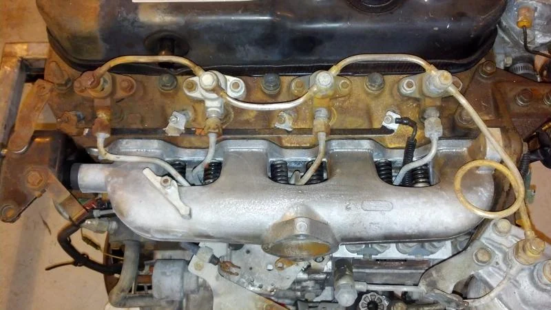

Here are some pictures of the partial tear down. May be ready for paint by next week. Attached Images
