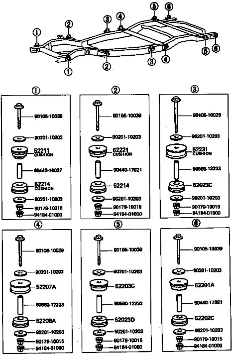

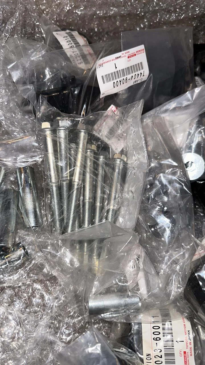

This 5-page report was prepared on the body mounting of my car, a 1988 Land Cruiser FJ62, and I wanted to share it with the Toyota community at ih8mud. I hope they benefit from it. The report is in PDF file and contains the manufacturer numbers, part code, pictures of parts and replacement parts, as well as the total numbers of each part and a diagram of their locations (total number of Required Quantity (96) pieces) Almost the entire collection costs between 420-500 US dollars. In the chassis that Land Cruiser FJ62 owners in particular and 60 Series owners in general need, because I think it fits all 60 Series.

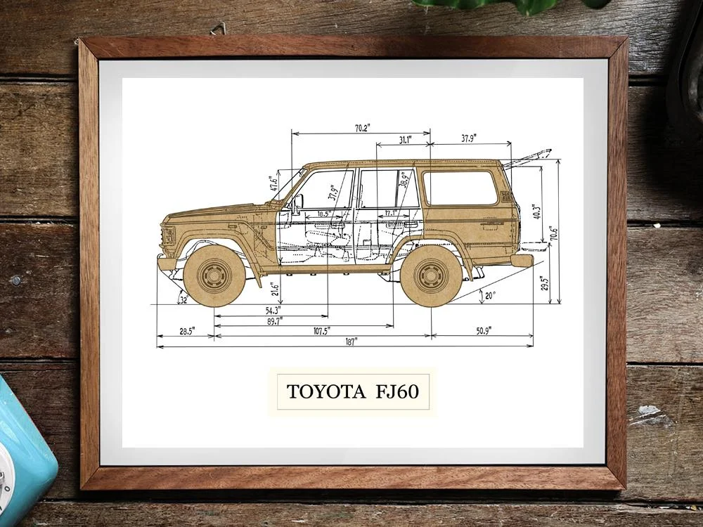

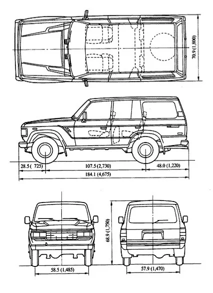

I intend to swap out my poly body mount bushings (but retain the 1" lift blocks) sooner rather than later so I can restore a little ride comfort, so this is fortuitous timing.
Thank you! First time I’ve seen the dimensions in inches and metric. A new body

This is a great post! Great job! I'd like to find out what the real difference is between an '87 body mount lineup vs an '88. I can't imagine there's a huge difference. cheers!
