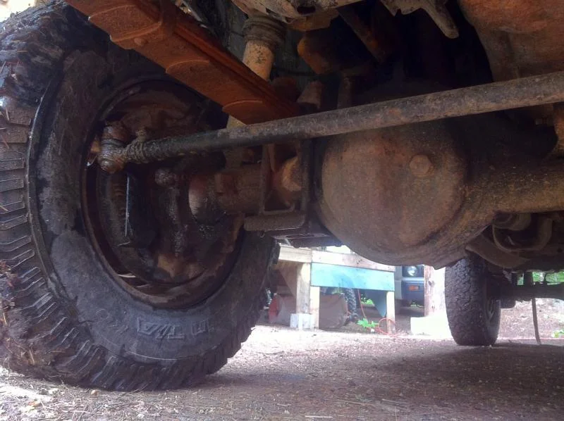

Didn't mean to bonk (i've been away) and much thanks for the replies. I am not the woman who drives the other hilux in Pemberton although i know she's online here.
I'm new to Ih8mud and not very quick with the lingo.
I have a 91 Toyota Hilux double cab pickup Japanese Import.
It is grey RHD and is very similar to a 90's 4runner.
It has a SFA, I've already fitted it with 91 4runner calipers and landcruizer rims have the right offset and allow clearance for the steering cross link where as aluminium toyota tires do not.
