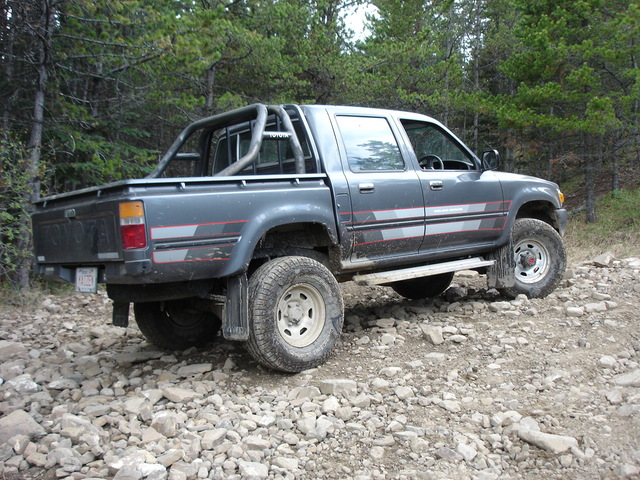

Shwing! Right hand drive, solid axle, 4 doors.... It's like yota porn!
cool, I have one of similar color and same body style in a 1989 hilux, though its nowhere as close to as cool as yours as its not runnning yet. I have yet to finish putting it together. Maybe Ill have a pinch of time to start on the motor mounts this weekend. :rolleyes:
I want a 4door mini SOOOO bad..... stupid import laws. I guess in a couple years I will see if I can find a 1990 model to be the twin to my current mini pickup. I love those rigs.
