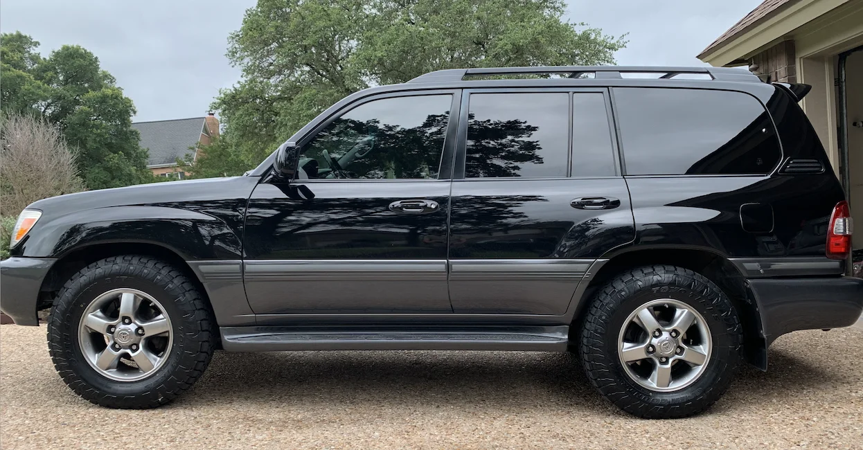

Here's what it looks like ... hopefully ya'll don't mind a little 100-series photos mixed in!?

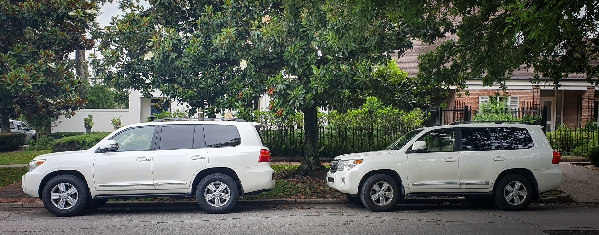

First let me say thanks guys, this thread has been a source of great information. I installed a set of Toyo Open Country AT3s in 285/65-R18 tires on my 2014 LC 200. So far they have been great. No rubbing, nice ride, minimal noise. Just hspped to park next to an Identical LC with stock tires yesterday, so took took this photo for a side by side comparrison.
Is that an optical illusion? your LC looks so much bigger! :D
