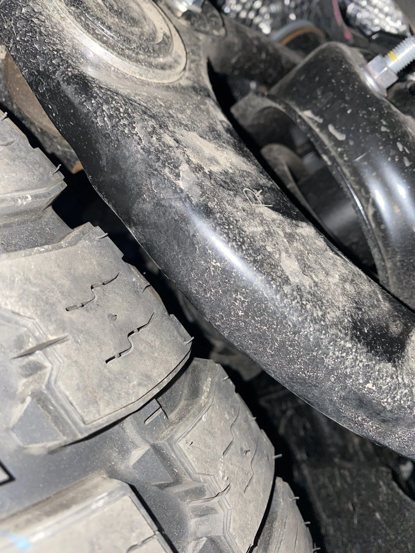

Is this too close to the upper control arm. These are Toyo at2 285/65/18. On my 2021 HE. I have AT3s ordered and now am worried about the spacing and debating if I should order 275/65/18 instead.
Angles are hard to judge with a static pic. Is that at ride height with the tires straight ahead? The clearance against the UCA gets tighter when the suspension is compressed and steering is cranked over. Though for a 285/65r18, should clear okay based the number of people that have run this size?
This is photo of passenger side with wheel turned towards the drivers side. It seemed like there was roughly 3/8in between tire and UCA

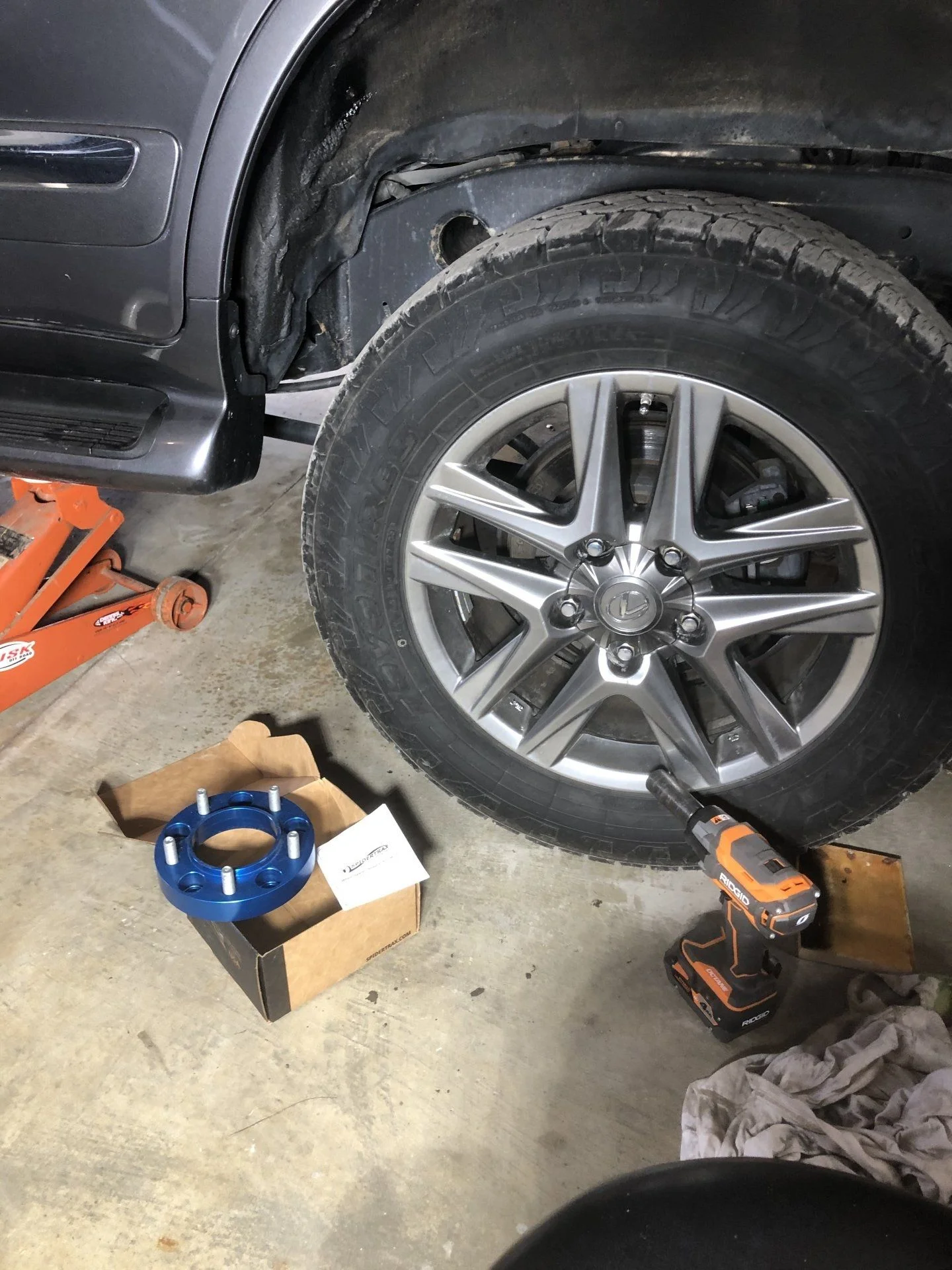

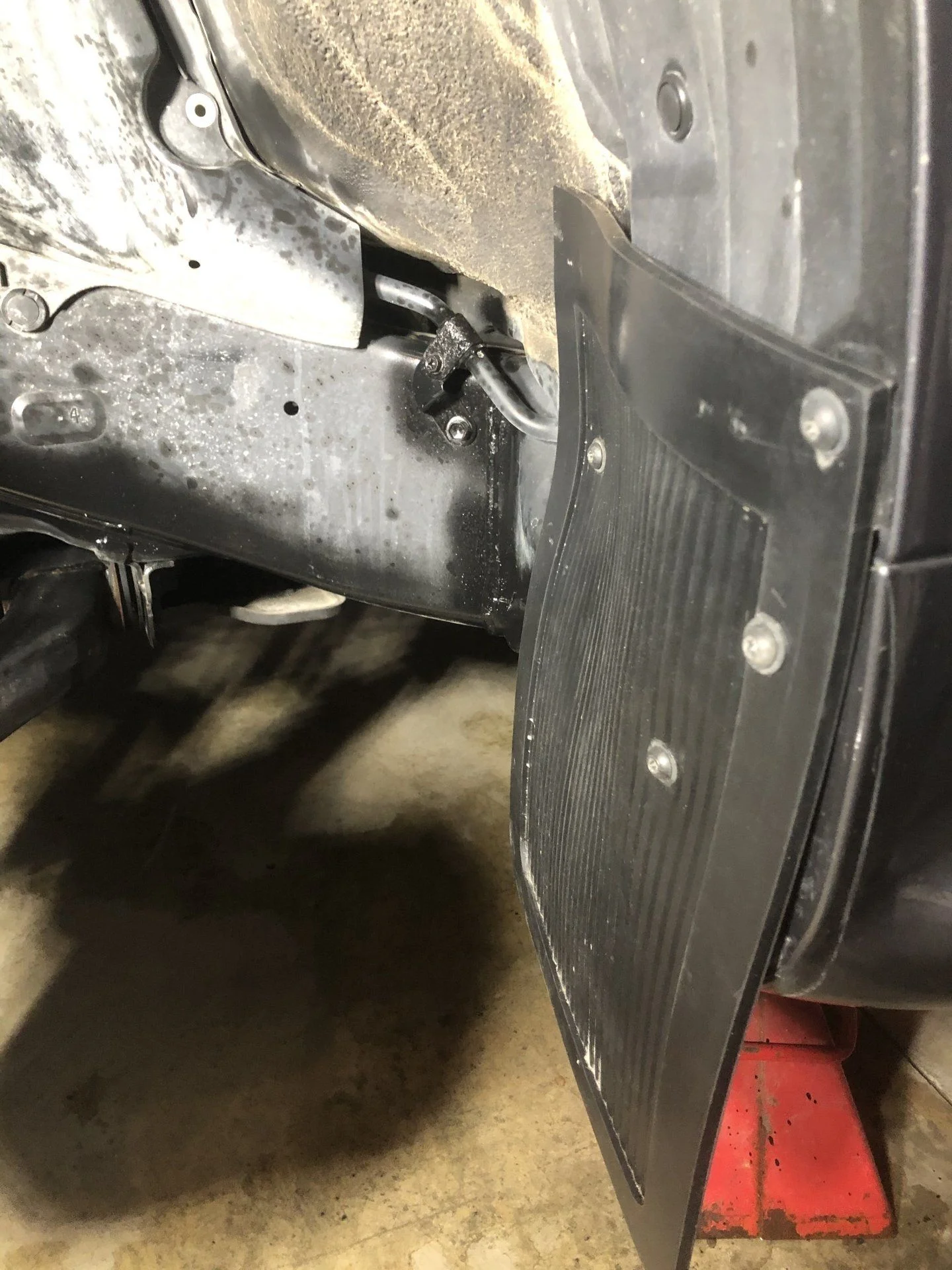

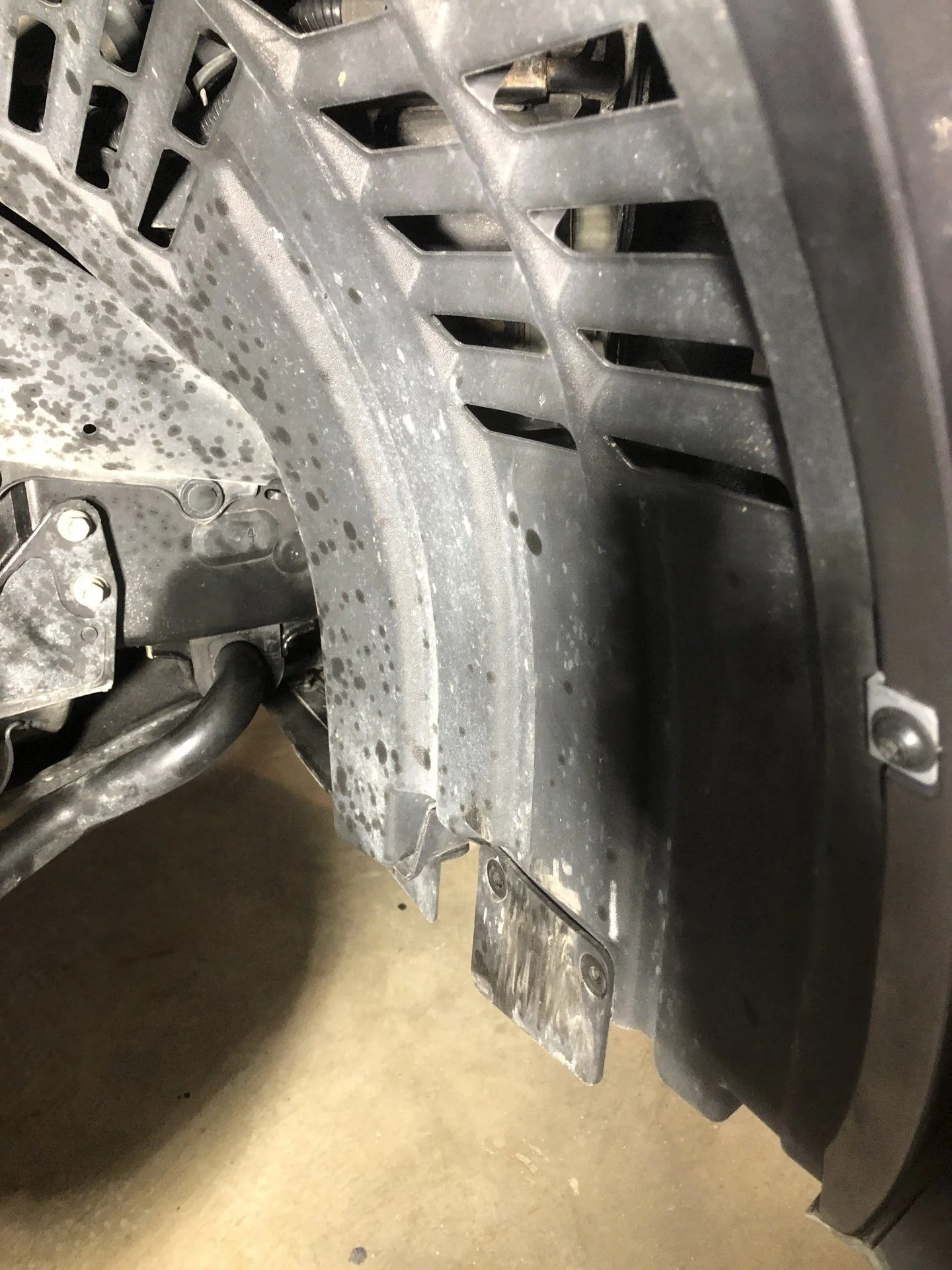

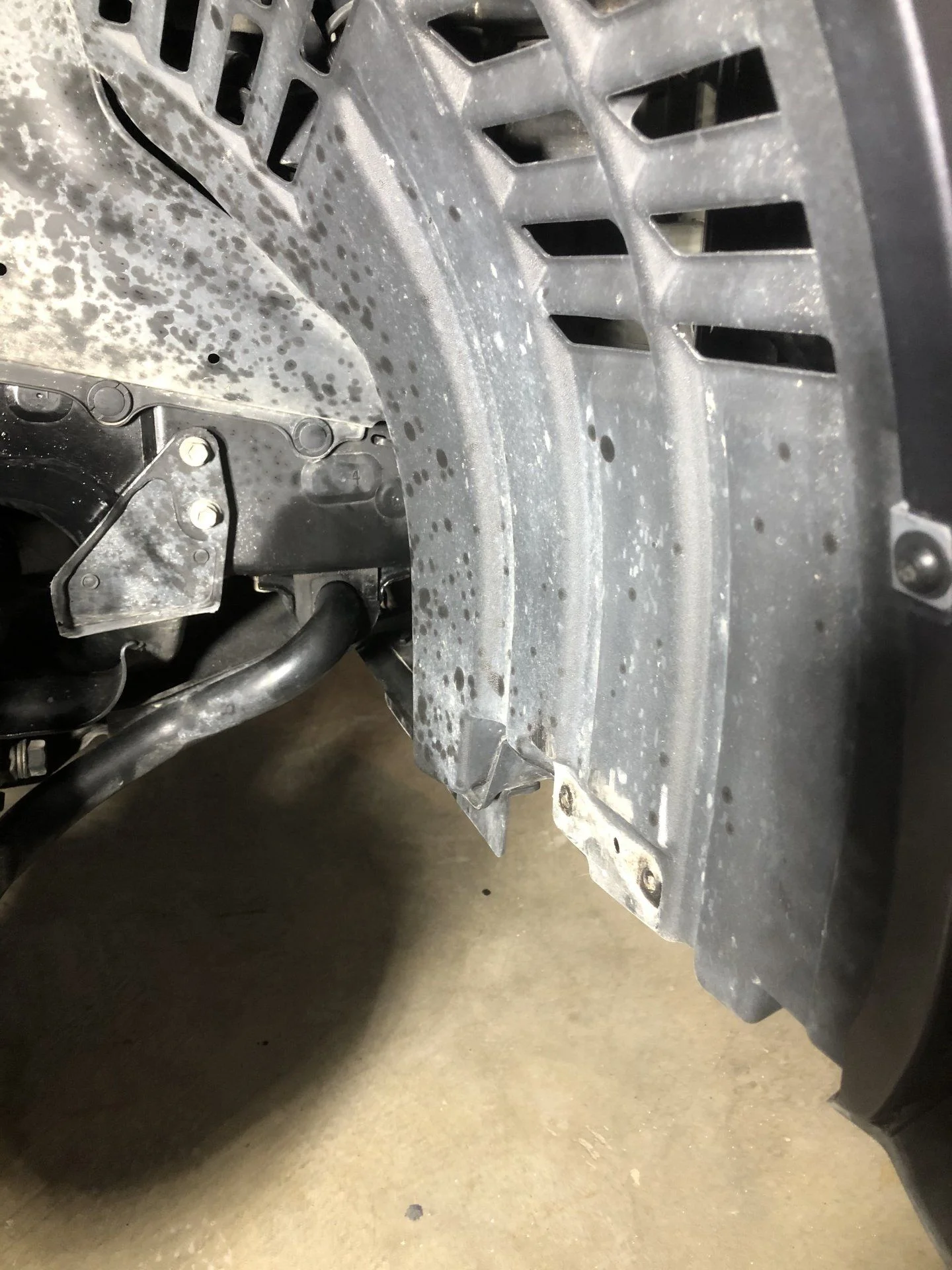

I made some time last week to change out the front brake pads and add 1.25" spacers.
The AT3's have less than 2k miles on them and rubbed a little without the spacers. I pulled off the front flaps and used a pair of 12x18 flaps bought from EBay. Got a couple more inches of mud flap all around and with the tire installed you don't even really see the flaps. I used a heat gun to bend the plastic on the front where I removed that plastic piece. Still getting some tire rub right there from pass side though.

Im thinking about just removing those front mudflaps. From the looks of the the new front bumpers overhang, they don't seem to do much... its the only spot thats rubbing and ive rubbed halfway through one already. As far as my rear mudflap on the front wheels im getting some annoying snagging from the bottom in reverse. Other than heat-gun is there any other recommended method? Ive seen some threads that involve a lot more cutting than i have the patience for.
The oem mudflap serves as kind of the end cap for the side steps. It sticks out from the body pretty far. The one on the front needs to go. Cutting is permanent. So go slo.
Thanks. Wish there was an aftermarket mudflat/end piece.
