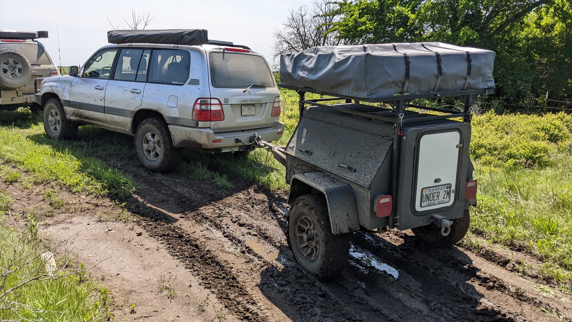

Does anyone know what the towing capacity might be for this style hitch and mount to the rear crossbar?
It's not rated in the US but for other countries, I believe it is 3500 kg (braked) and 750 kg (unbraked). I'd imagine the US has different standards. I would not tow close to that amount of weight.
Good god that was a lazy install 🙄
It’s strong but it’s nowhere near as strong as a proper weight distribution hitch.
It will be removed soon. Bought it with it but don't trust it to tow anything. Thanks for input 👍
I replaced the port/dealer installed Draw-Tie/UHaul hitch with that model on my 80; mine's a Kurt, so I can't vouch for yours specifically. I tow 6000-lbs with max tongue weight and have never had a problem, either with the load or hitch/frame. The 100 frame is stouter back there. I wouldn't worry about it, if it's a quality hitch and the bolts are Gr. 8/12.9; actually, I'd worry more about the bolts than the hitch/frame.
My understanding is the factory pintle is rated for 3500 kg. I fastened a 10k lb pintle with the Toyota bolts to my 99. I have about 8k miles pulling the trailer across the country without a problem.
