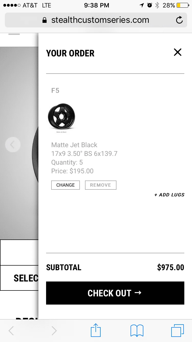

Will a 17x9 3.5 bs fit?
It's a -38 offset. Seems aggressive.
Will a 17x9 3.5 bs stuff tire?
That SCS wheel was made to be an excellent fit for an 80 series. It will be set in 3/4" more than my setup. Should clear nicely, but I'd talk to someone who has them, to be sure. A bunch of Mudders got in on that initial run of wheels.

That's what I was hoping. I know the 17x8.5 4.2 BS will fit but the 17-9 3.5 I'm not so sure about. If you know anyone running them let me know. lol need to order right away
Just for reference... a stock wheel with 1" wheel spacers is a 3.5" BS
With 37s should be no problem... just might need a bit more bumpstop & or more trimming. No a big issue....

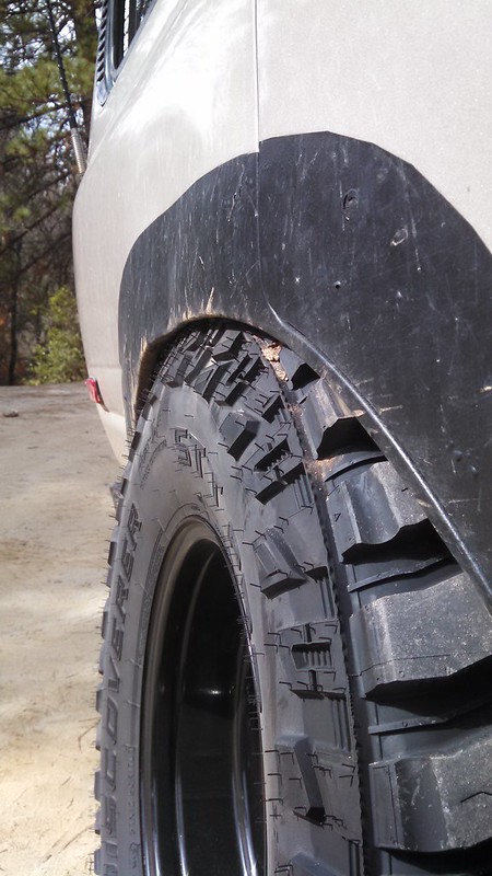

Reason I was concerned because 3.5 bs on a 9 is -38 offset and that just seems like a lot compared to the -12 I'm running now on 16x8
I'm running a 17x9 with a -12 offset and have had no problems with tire/fender clearance. You will need to adjust bump stops accordingly to not hit the inner fender well or bottom out the shocks depending on your setup.
