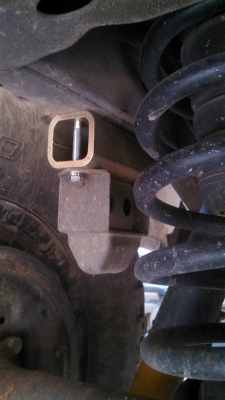

What length rear did you go with? I think I'll just buy like 3 hockey pucks for each side and go from there
I had the same thought until I priced hockey pucks. They've gone up a few hundred percent since I was a kid.

Yessir, too good of a deal to pass up. Who else sells front bump stop pucks? Slee is the only retailer I see when I search google.
I am looking at bump stop extensions now too since I took delivery of my 37" trxus's. You might consider body lift pucks. They can be had cheaply.

No, possibly use a body lift puck as a bump stop drop in the front is what I meant.

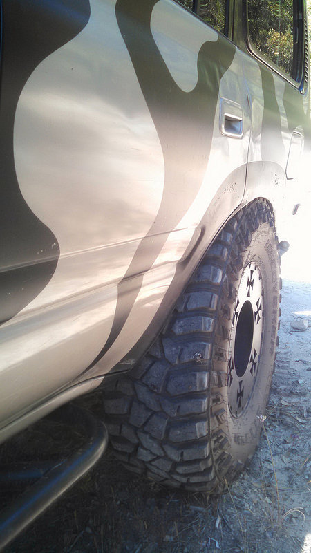

Maybe I'm lucky but my 17x8 wheels (4.5" BS) stuffed the 37s quite well with only a 4" lift and no trimming needed. Only a bit of rubbing on the rear bumper which I only knew of because the powder coat is rubbed off.

well I went to 17in rims and Im currently rolling 37 mud grapplers, they stick like glue on rocks mud etc etc but are exactly like a small single engine aiplane, way louder than the KM2 I replaced. FYI
