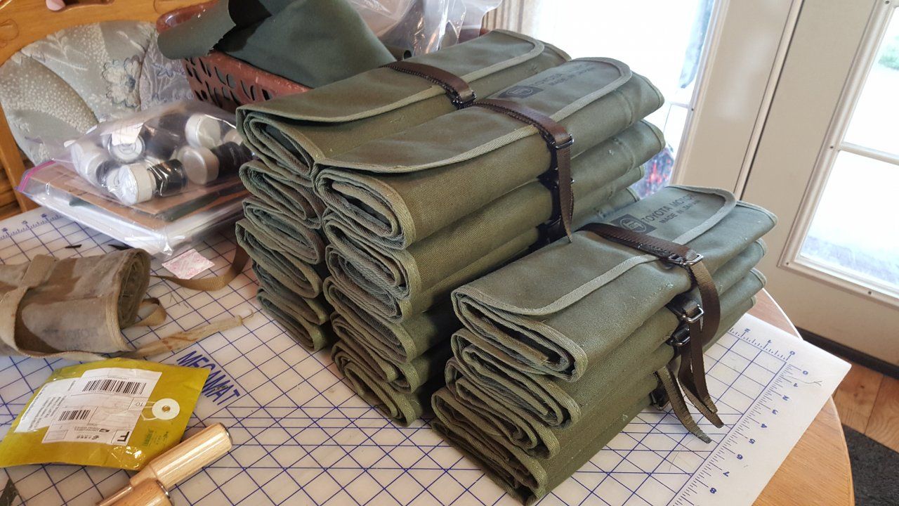

I received a new roll of canvas yesterday and the color was the same as the batch of rolls I just did-which is good news
I will be starting a new batch in the next two weeks, lot of people have been asking for me to do another batch, will post when they are done and still have some available room on the list. I will ask that we keep sales off this thread-message me if interested in one, but showing picks of your roll with tools would be great on this thread, thanks.

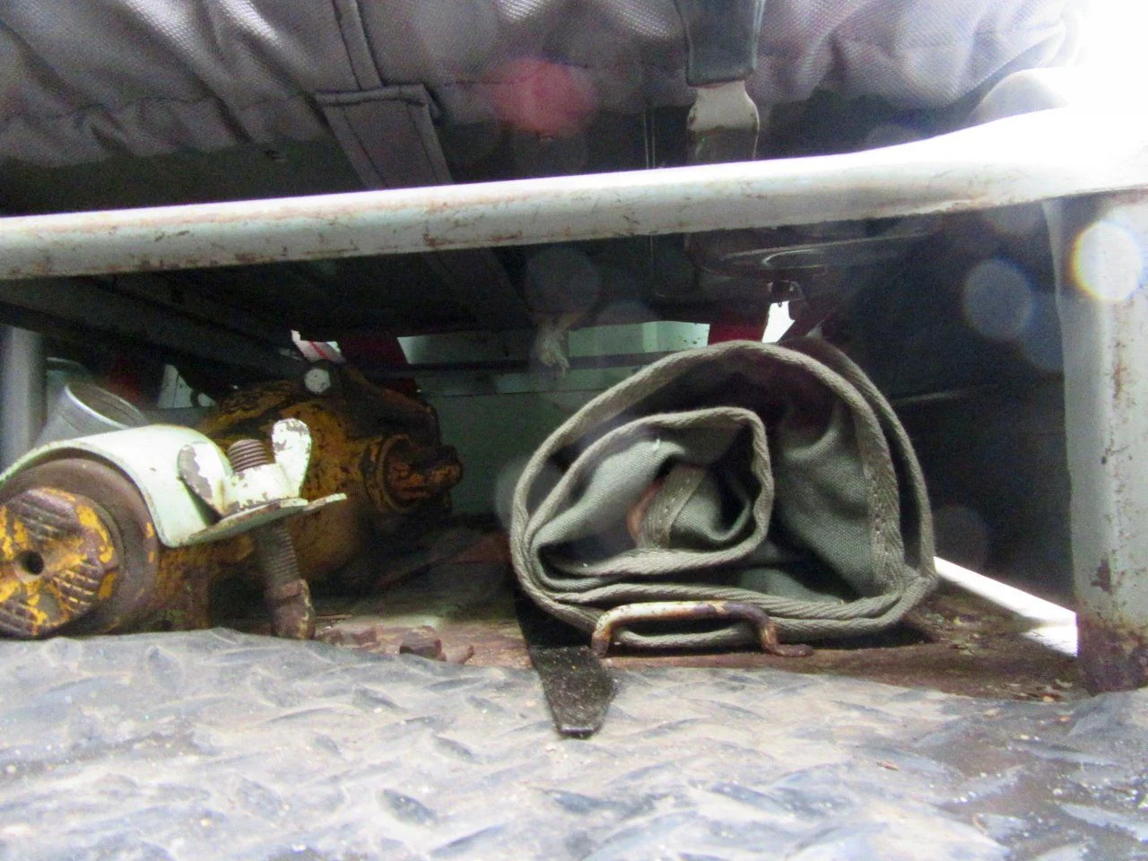

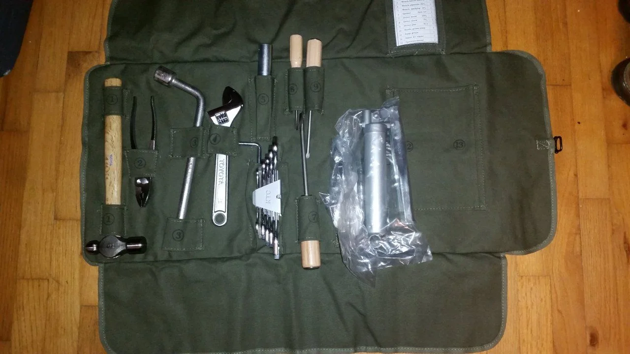

Really nice job on the Tool Roll! Thanks again for making these. Finally got to replace the motorcycle tool roll that has been under my seat for years.
a few more tools added including the yamada KH-120 pump and maple KTC drivers...Close to completion. Only item missing is the engine adjust kit.

2nd Batch with lessons learned!

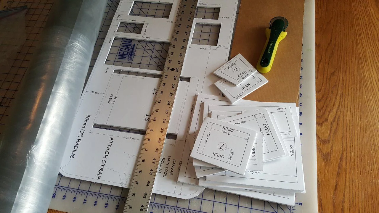

I took one of the plans I did Tool Roll 21mm, printed at full scale (local print shop) ANSI D size so it gave me 1:1 Scale on some of the drawings.

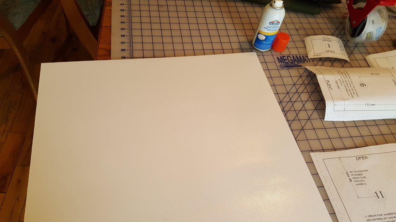

I bought two pieces of foam board at Micheal's for .99 each (on sale) and spray glue was $7 i believe (I had some from before, but the tip was clogged) I glued the printout on the foam board and cut them out, the two foam boards was just enough for one tool roll pattern with a little left over. I had to tape a piece to one board to make it long enough, I used clear packing tape for this.
I was able to cut out all my patterns in a few hours.
Here I am cutting out the pattern, the nice thing about the pattern is, when I start to fold and sew, I have a scaled drawing on each pattern for the correct size, making a mistake will be harder!
