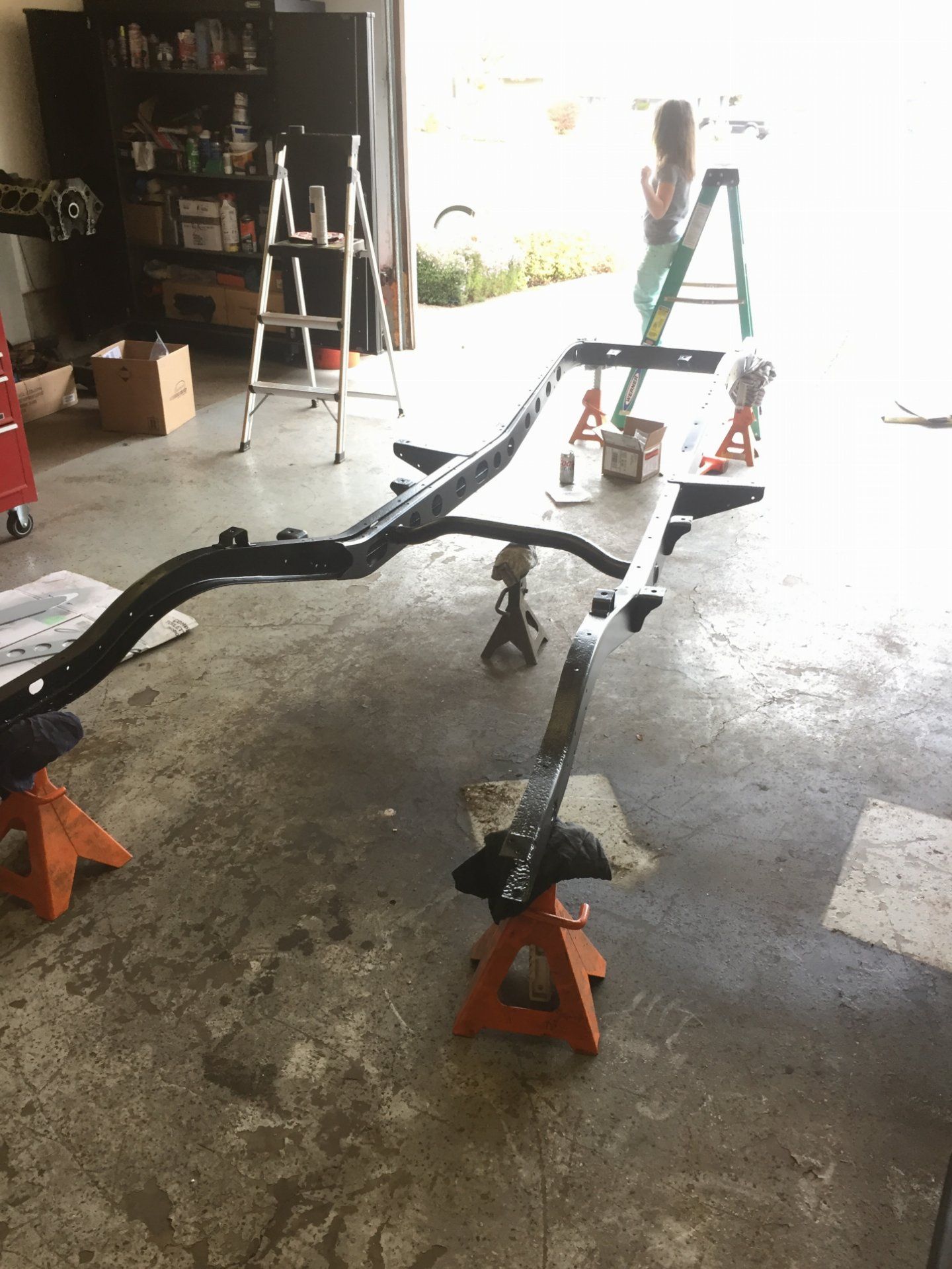

Also painted frame with Eastwood 2k gloss chassis paint. I don't like the gloss or the coverage (used 4 cans) so I ordered more today. Satin sheen. Tips with this stuff is to setup your substrate so you can keep the can vertical. Very nice product from what I can tell thus far.

What are you going to do about that missing chunk of the frame?
The hole is actually an optical illusion from the light reflecting off of the gloss finish. Although i do have plans to do some repairs on the back of the frame. Ill tie the rear most frame portion in with the ruff stuff frame box kit.

We got back, paint dry to the touch so I assembled. Very durable stuff. I really like Eastwood and will be buying more from them in the future. In total 6 cans was suitable for two solid coats. I used a faceshield respirator. Buy one if you get the chance. Wish I had it on my last project while doing the raptorliner. 70 some odd grade 10.9 yellow zinc bolts later... she looks beautiful. To me at least. Which is all that matters I suppose.

If you look closely you may see some of the putting caused by the rust. I wanted to leave it. For some reason I like seeing that history. This build isn't meant to be perfect, but perfect to me.
Used ratchet straps to get it "perfectly square" prior to tightening everything down. Every bolt is accessible from center frame so I'll check on the bolts down the road and note any loosening issues here.

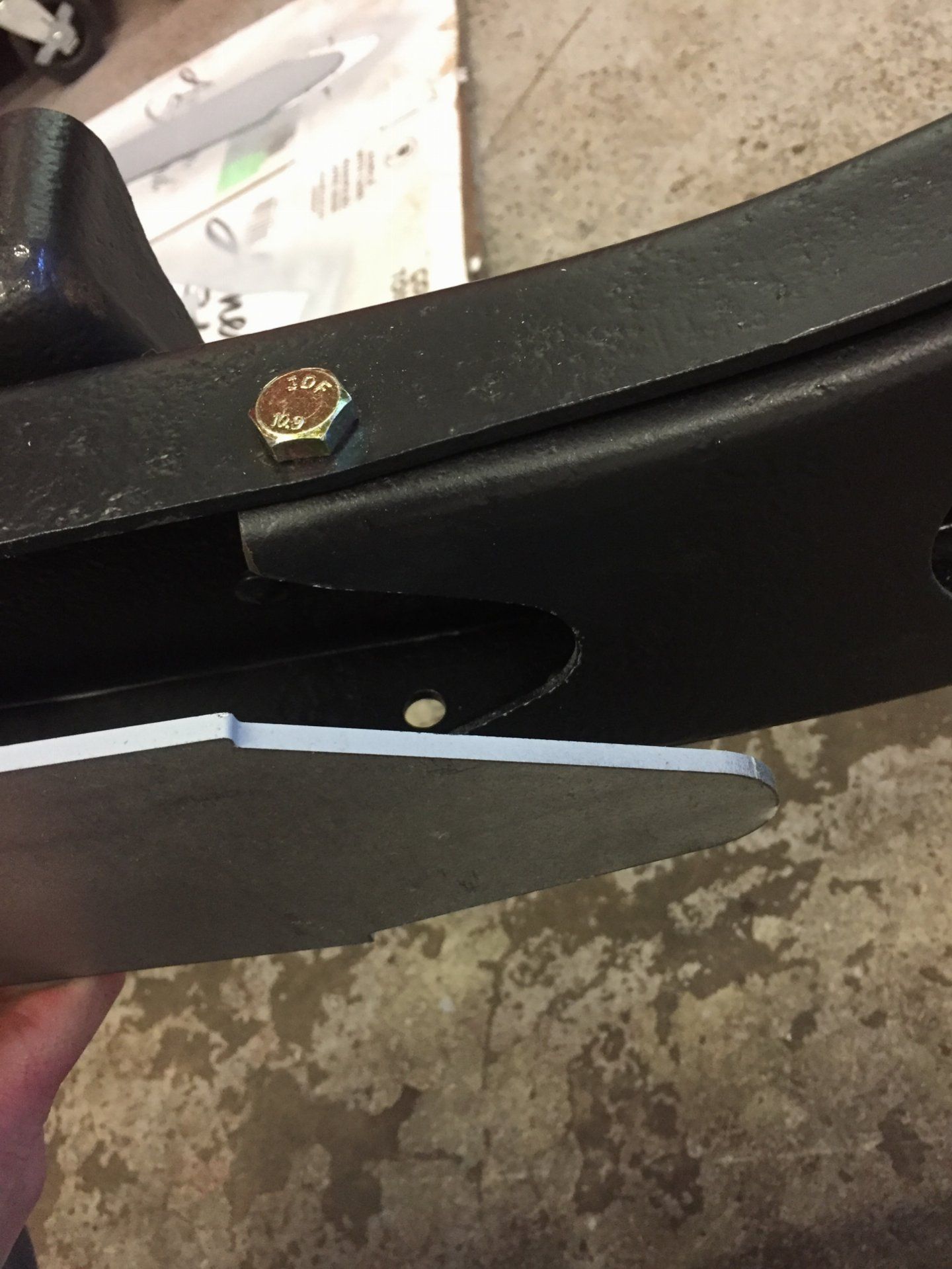

Played with the rear box kit from ruff stuff. Shot primer on inside in preparation of weldment.
Maybe it's just due to my frame year, but the front contour didn't match well with the inner frame rail. No big deal. Just requires some trimming.
Make sure you document that rear box install; that is useful tech.
Is there a reason you are doing this before installing the rear crossmember?
