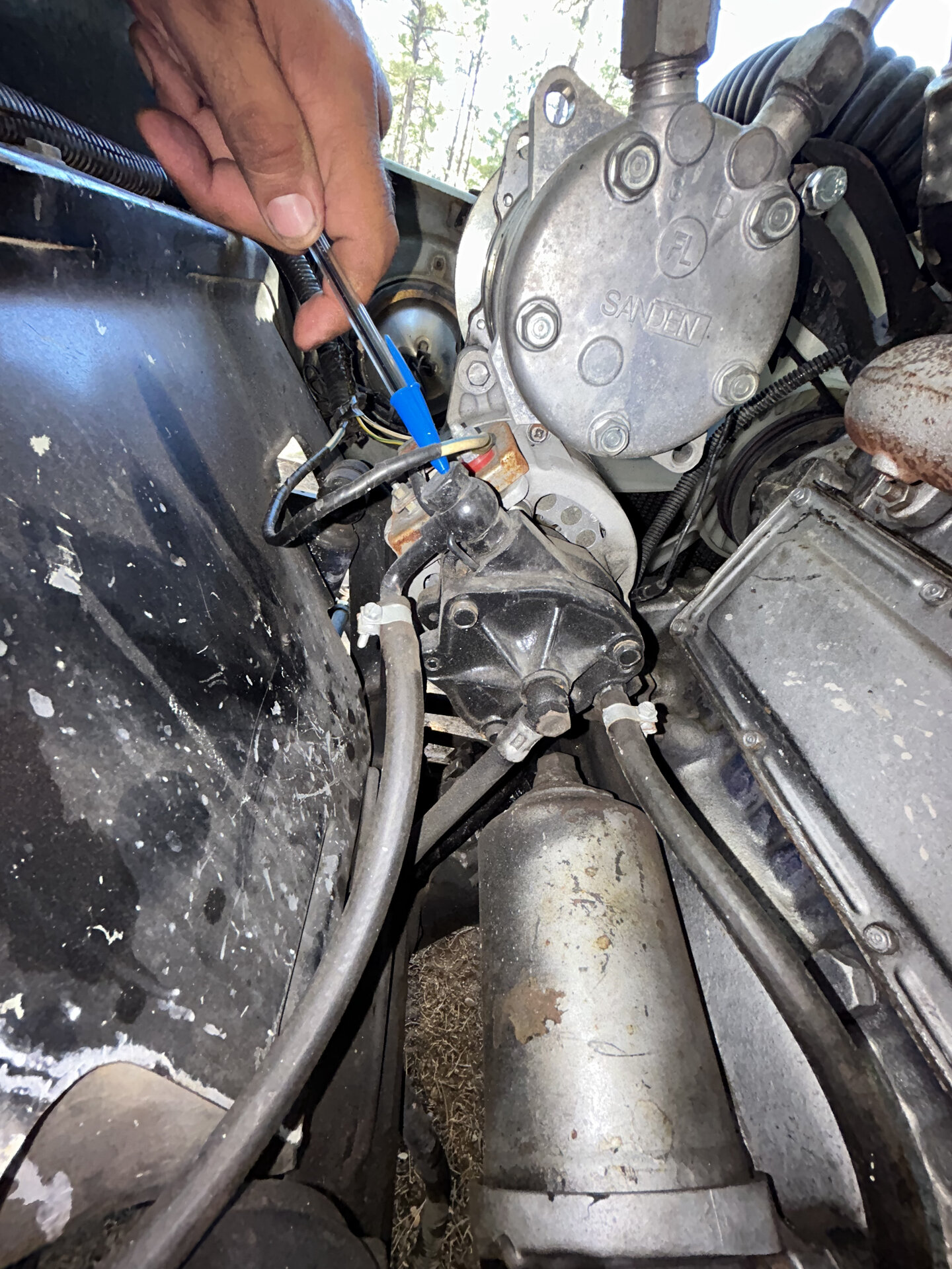

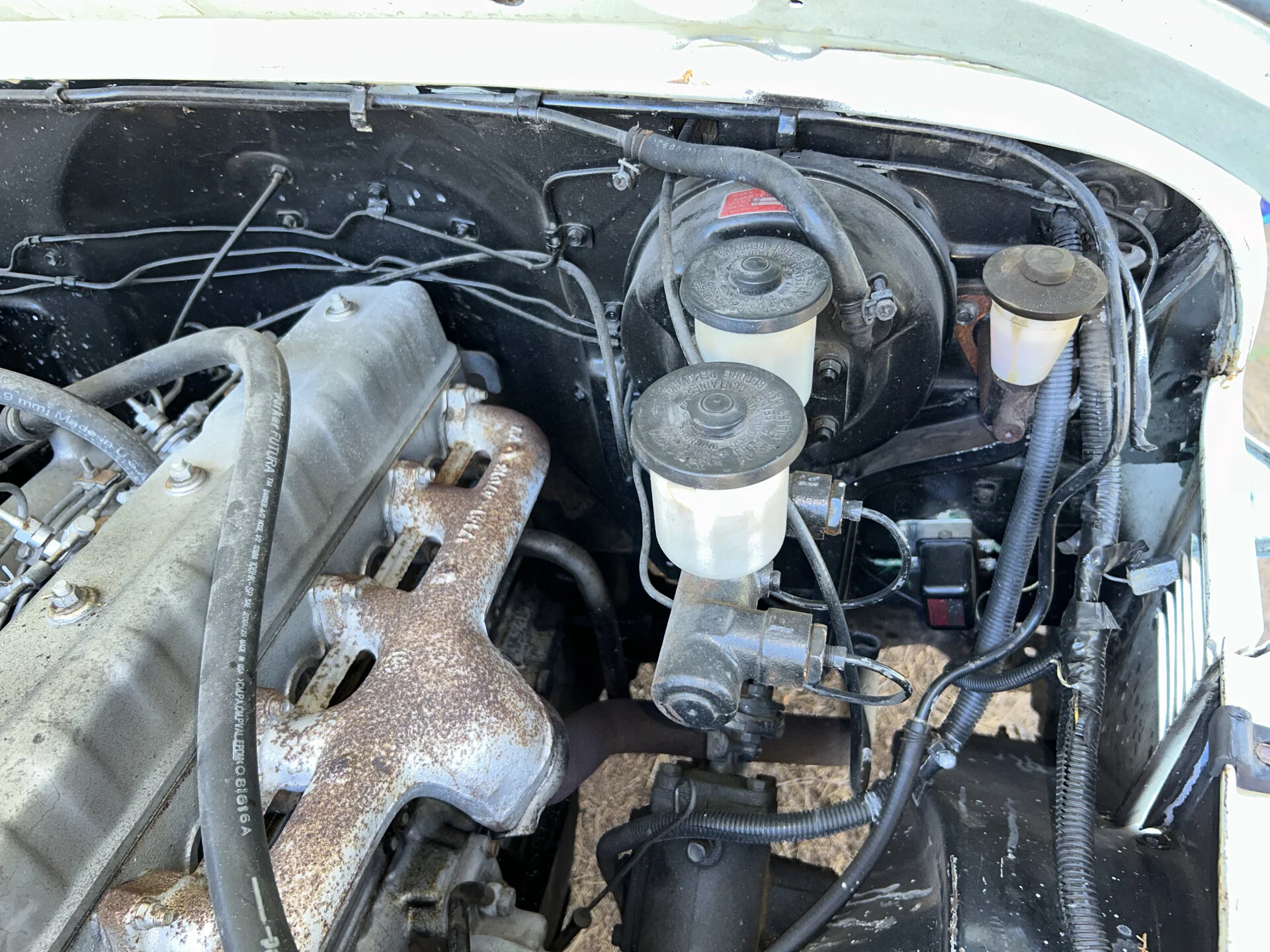

I was looking at that canister. Undid what looked like a little drain screw on it and oil came spewing out. Put it back on.
Oil was black. Looked like engine oil.
The line from the brake booster goes to the canister, which is filled with engine oil. It returns to the engine oil filter area.
I am totally confused.

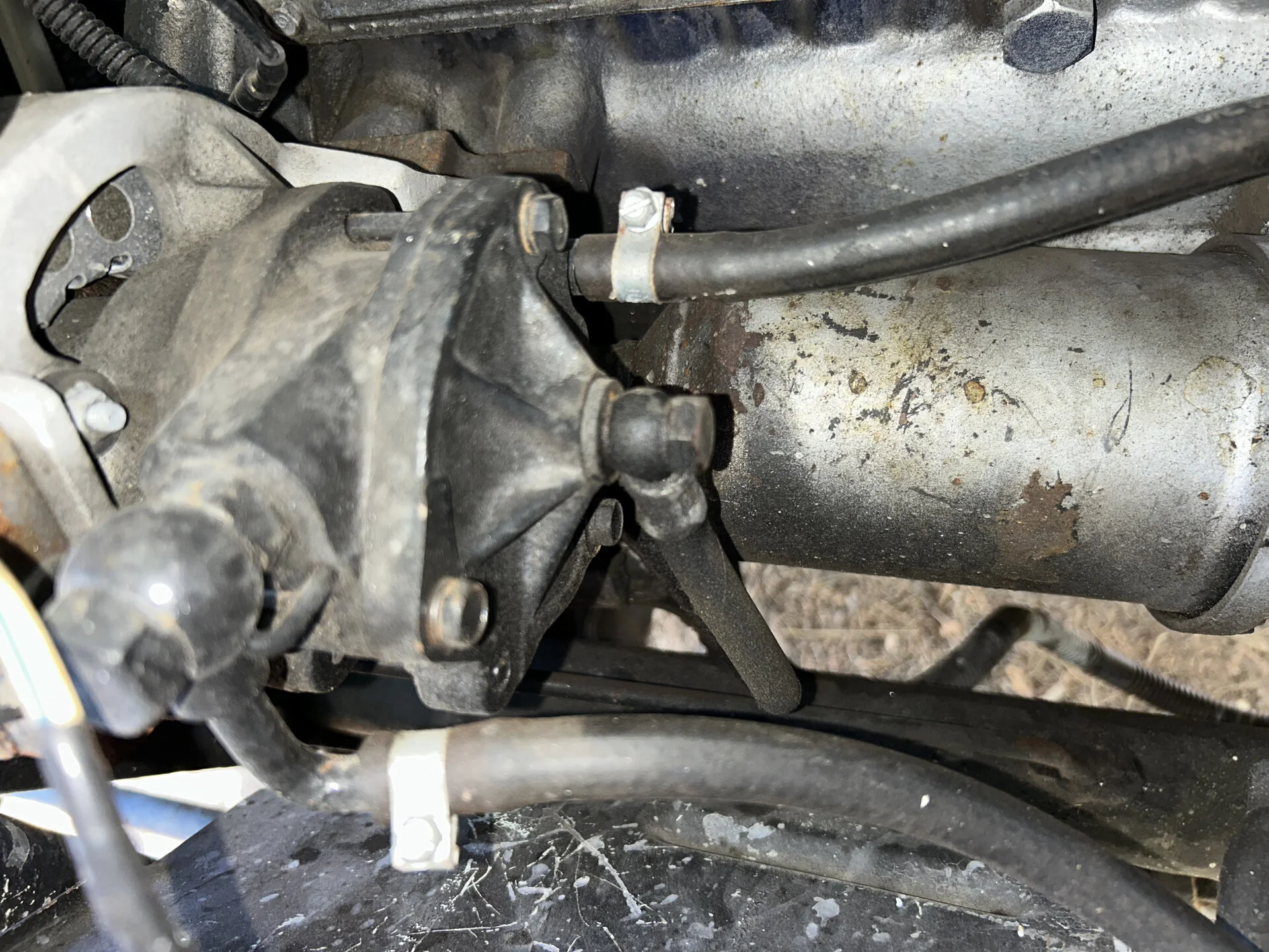

View attachment 3356419View attachment 3356417View attachment 3356418
That's the vacuum pump on the back of your alternator, right?
There's a sketch in the following link that helps explain - there's an oil feed and return to the pump to keep it lubricated as well as vacuum port (where it sucks).
Until today, I had no idea this thing had a vacuum chamber, and even less that it was filled with oil-forget about knowing the pump is connected to the alternator.
I'm totally ignorant about how this all works.

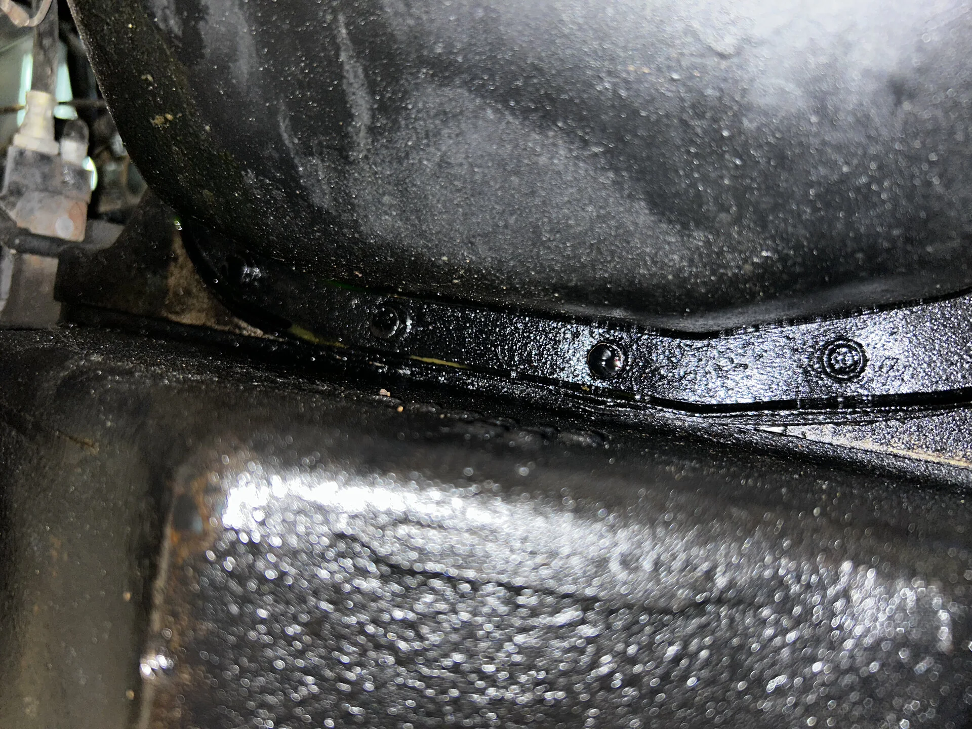

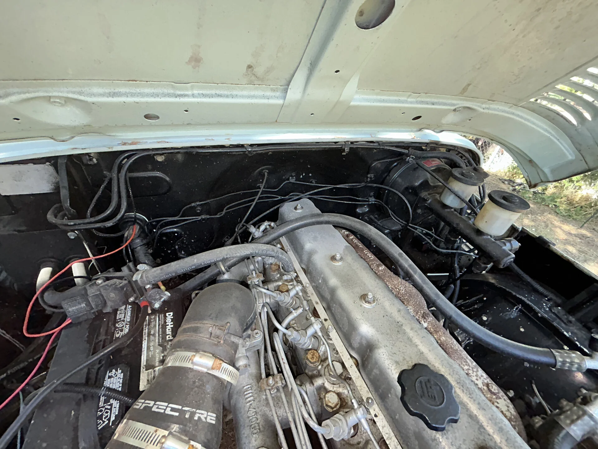

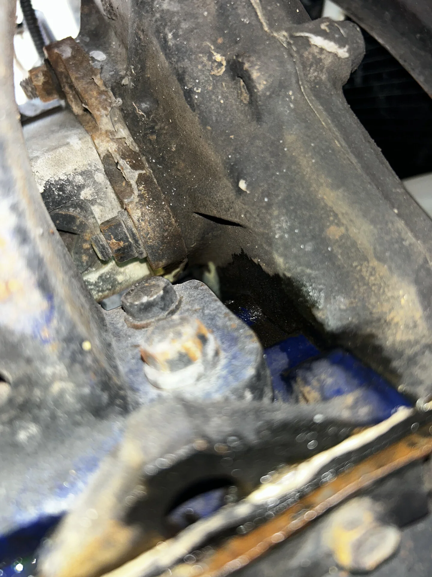

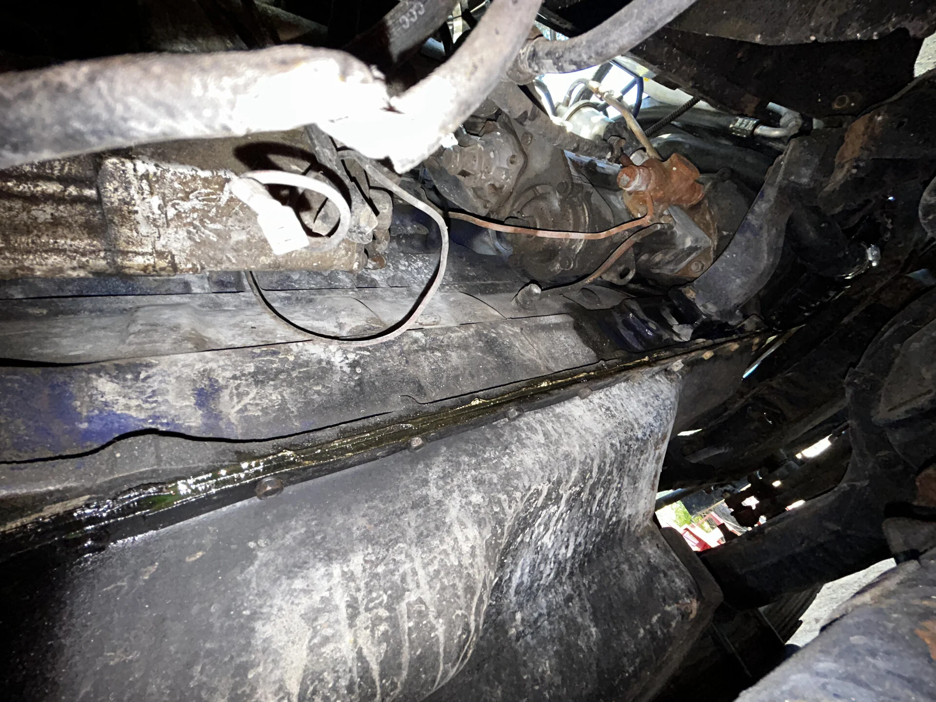

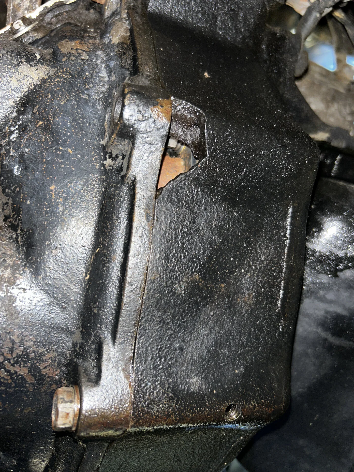

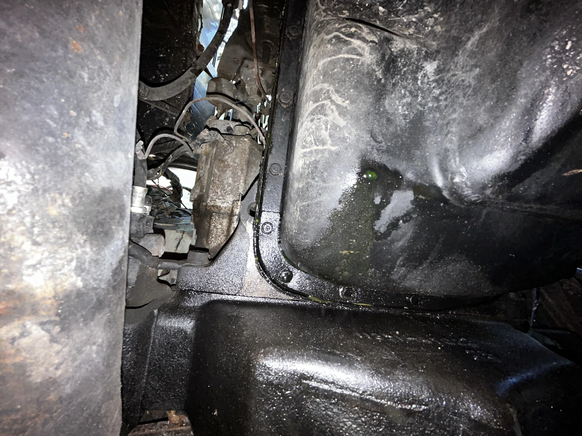

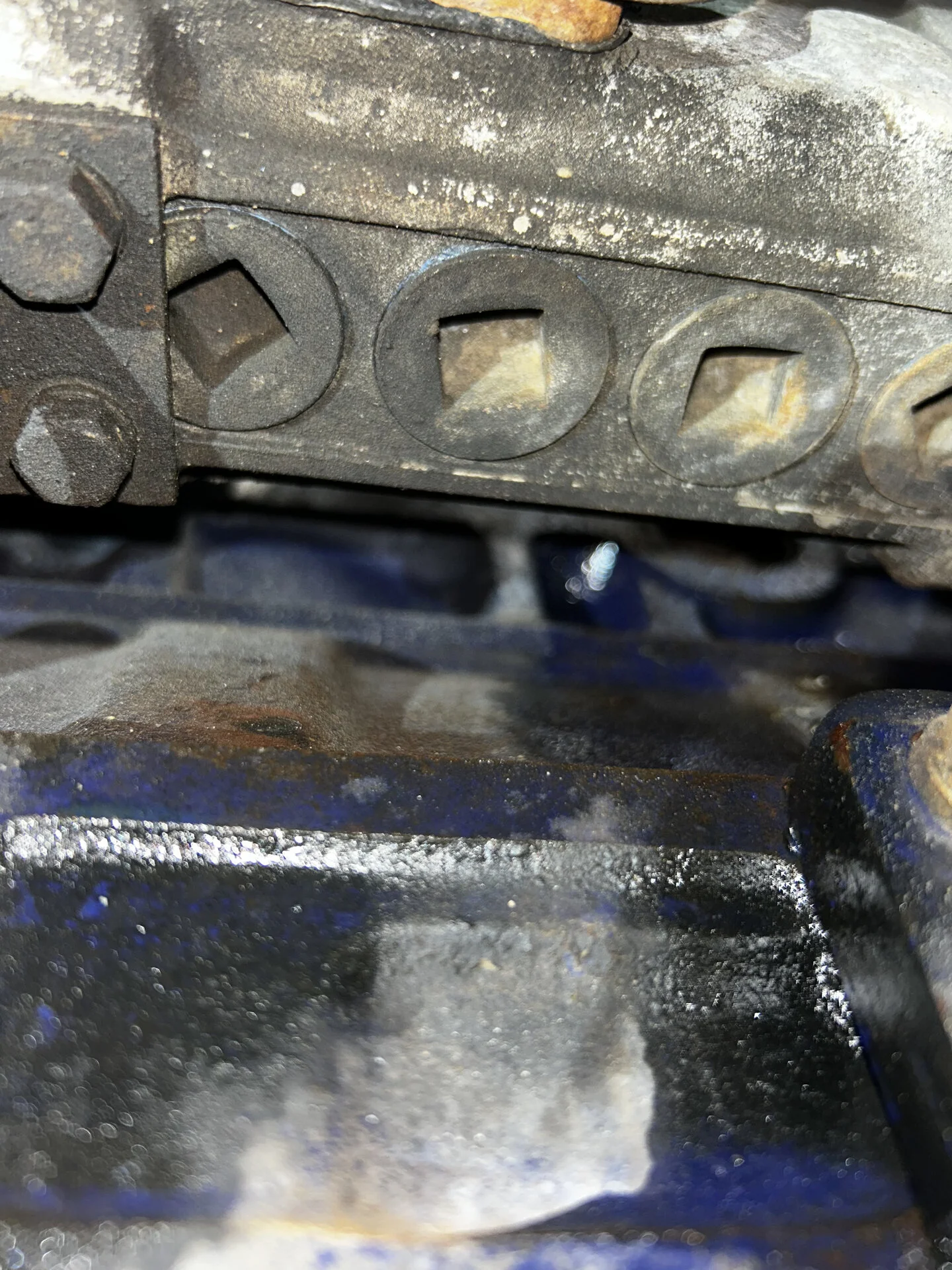

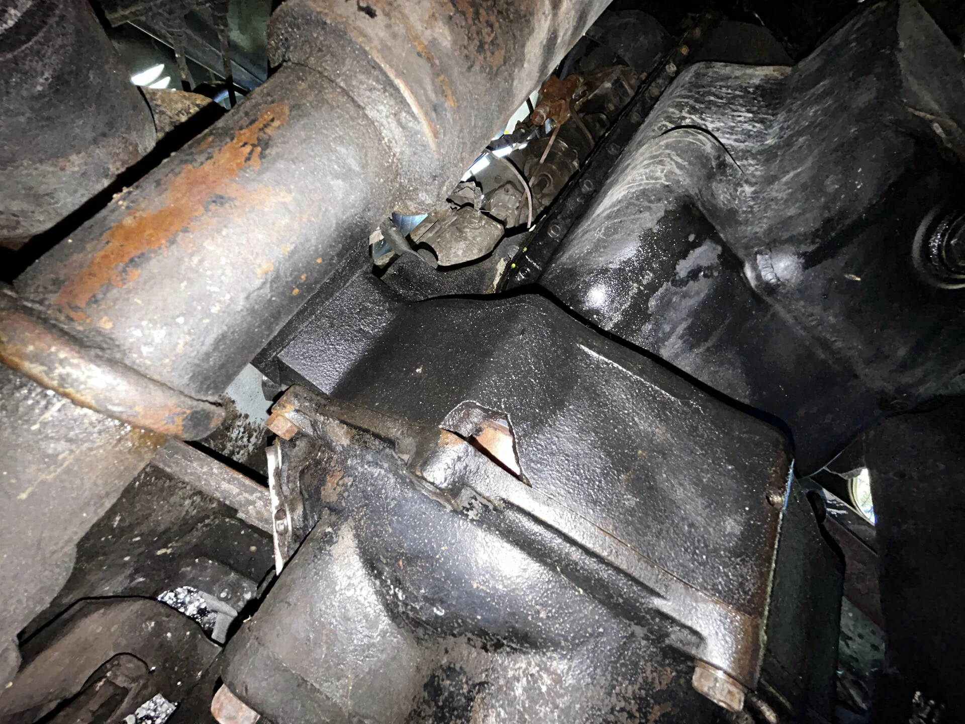

I used some Simple Green on the engine and washed it. I didn't do a deep scrub, just let it sit with SG for a little and then sprayed it down. Here's what I found afterwards:
So...
  • I have an engine oil leak-seems like it could be the oil pan gasket.
  • I have a coolant leak-can't figure out from where. Engine plugs? Doesn't seem to me mixed with the engine oil, so probably external leak.
  • I have a broken off piece at the bell housing where one of the transmission bolts connects to the engine.
I'm doing an oil change right now because it's low on oil, and because I just drove 3,000+ miles across the country.
The coolant is a little low as well.
Suggestions welcome.

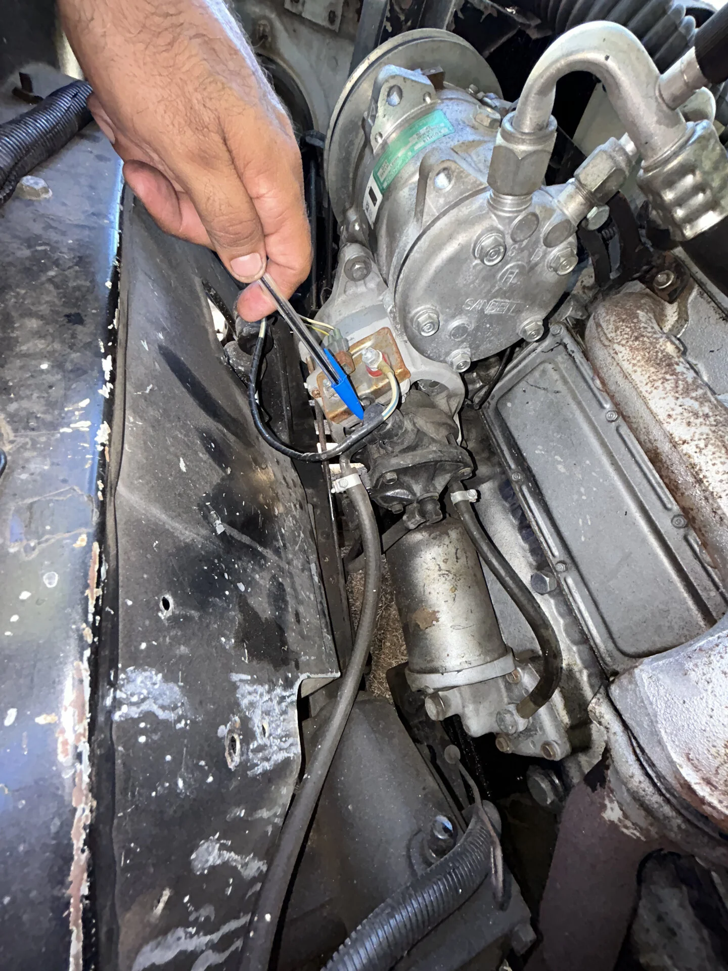

Stopped in middle of oil change. Can't access the damn filter enough to get it off. A 24mm seems to fit the nut on the front, but can't get in there with a ratchet, a wrench, anything!!!
I guess maybe a longer extension and a u joint adapter.
I may just leave that filter on for now as is.
Anyone know of a filter replacement/relocation kit for this? I'd rather switch to a modern filter, or at least be able to even relocate the existing one.
