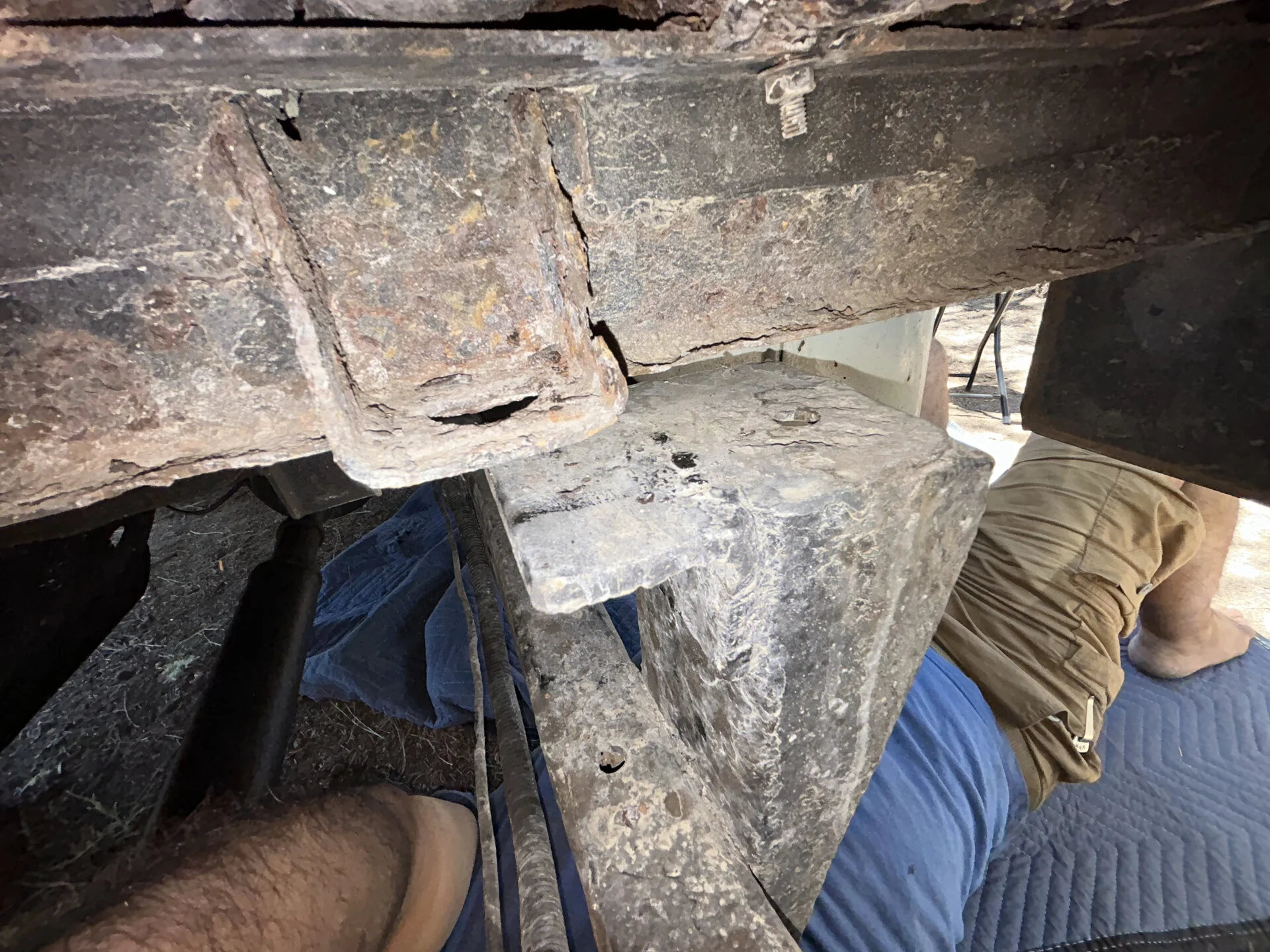

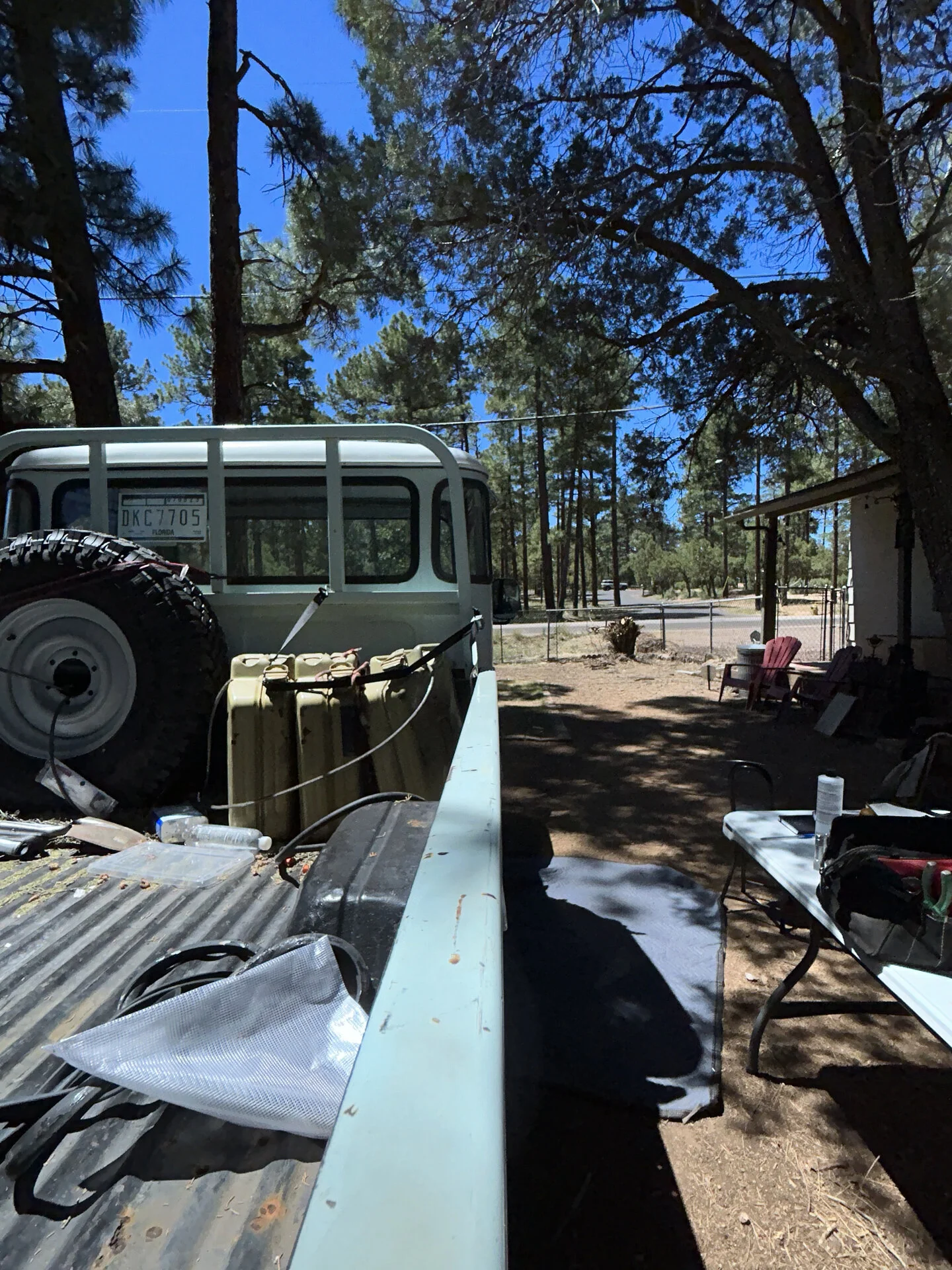

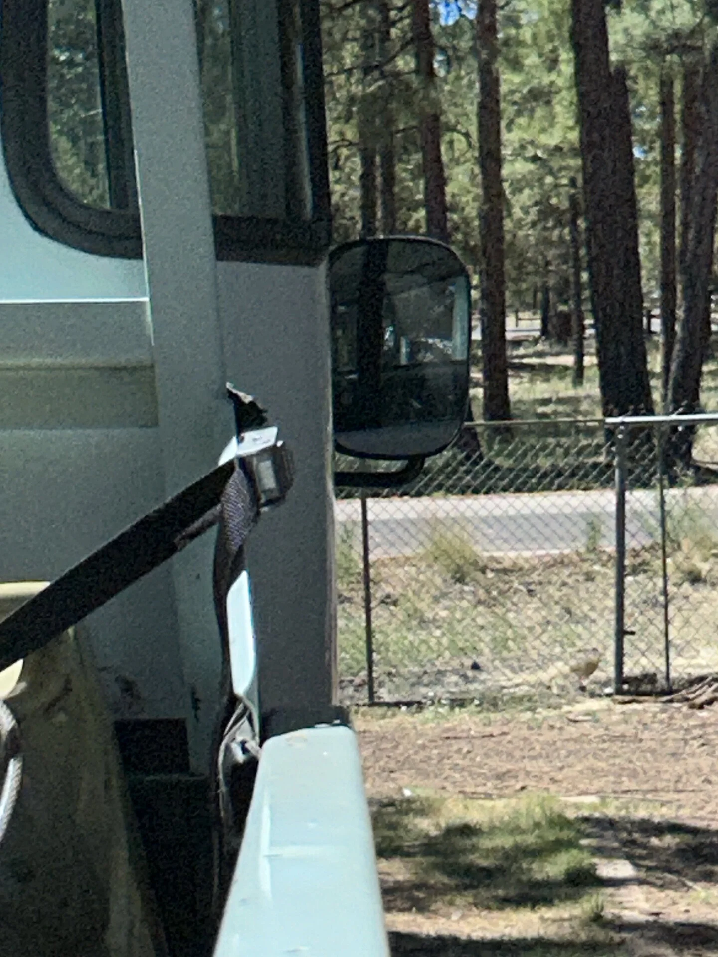

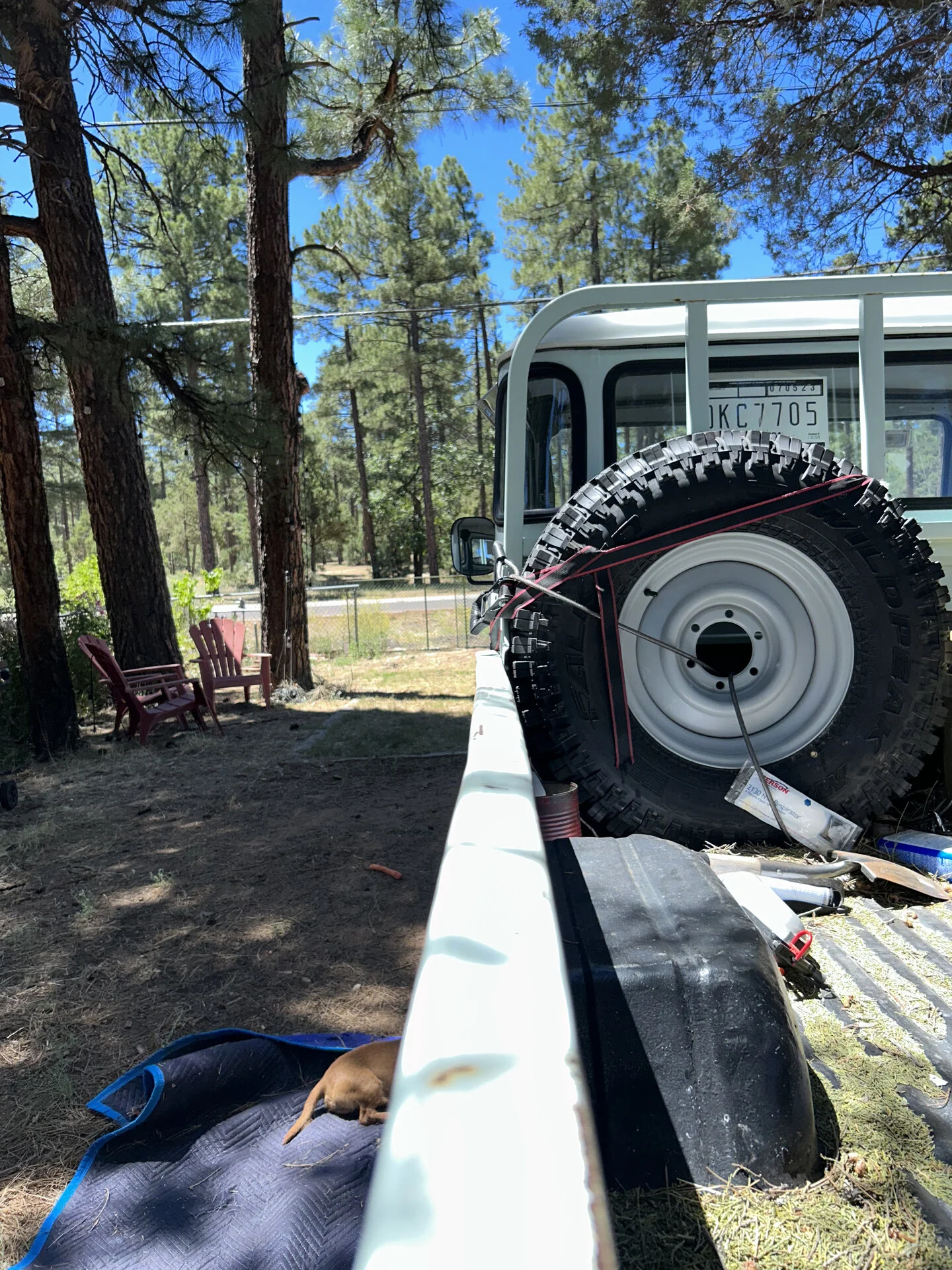

Looking at my truck's bed/tub, I noticed it is misaligned: sticks out at port, flush on the starboard side.
You can see that the port side is a bit "un-straight".
Would like to straighten that out-any suggestions are welcome.

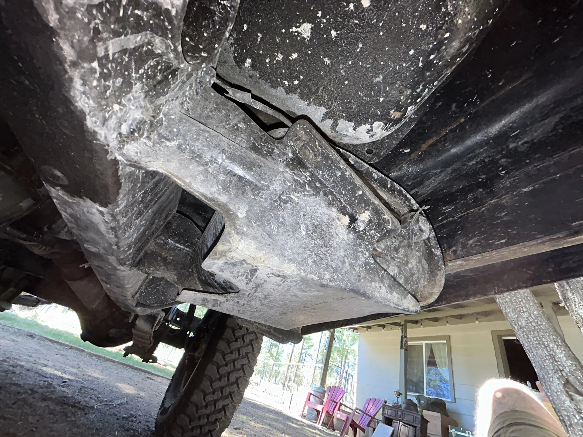

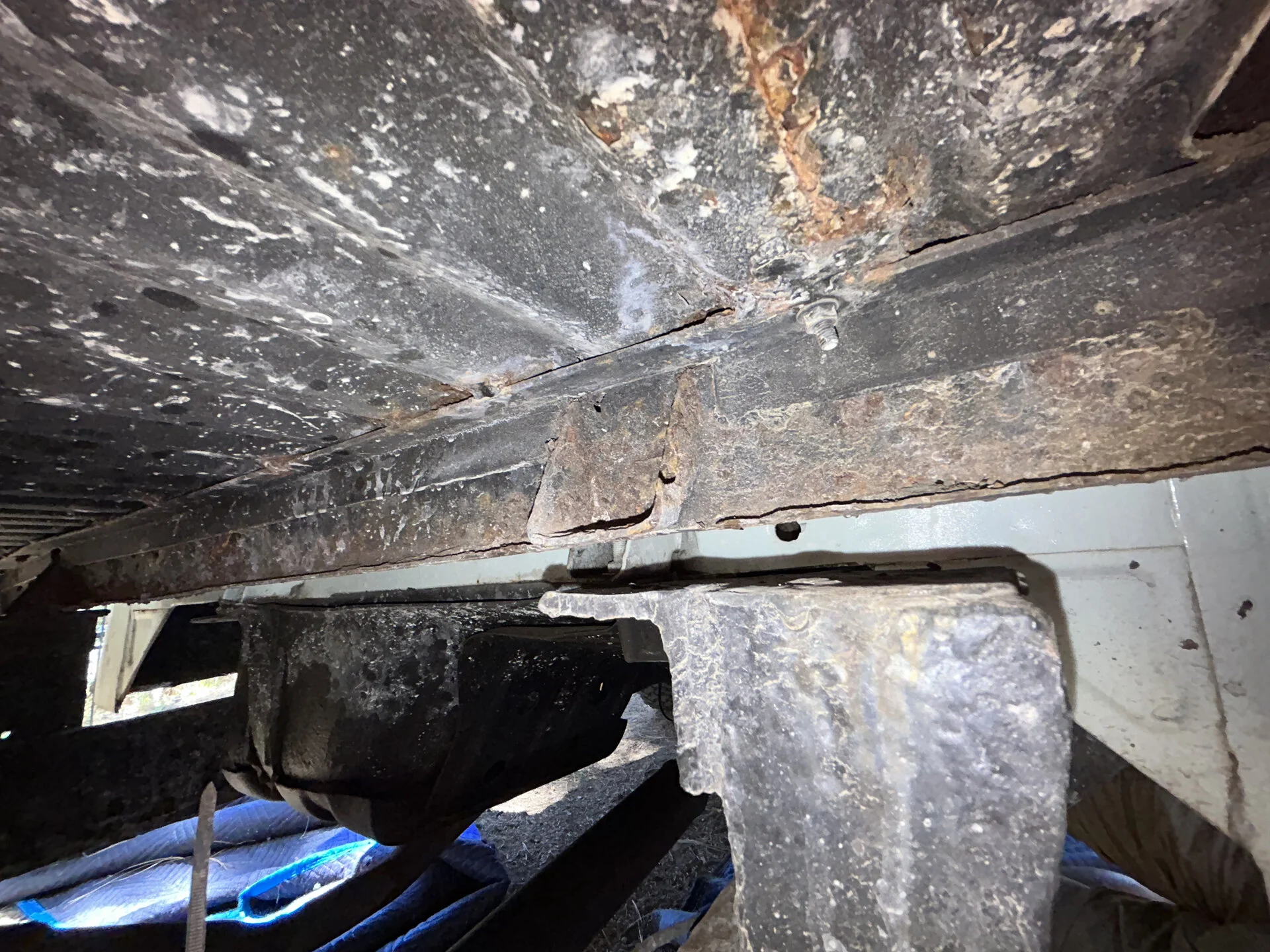

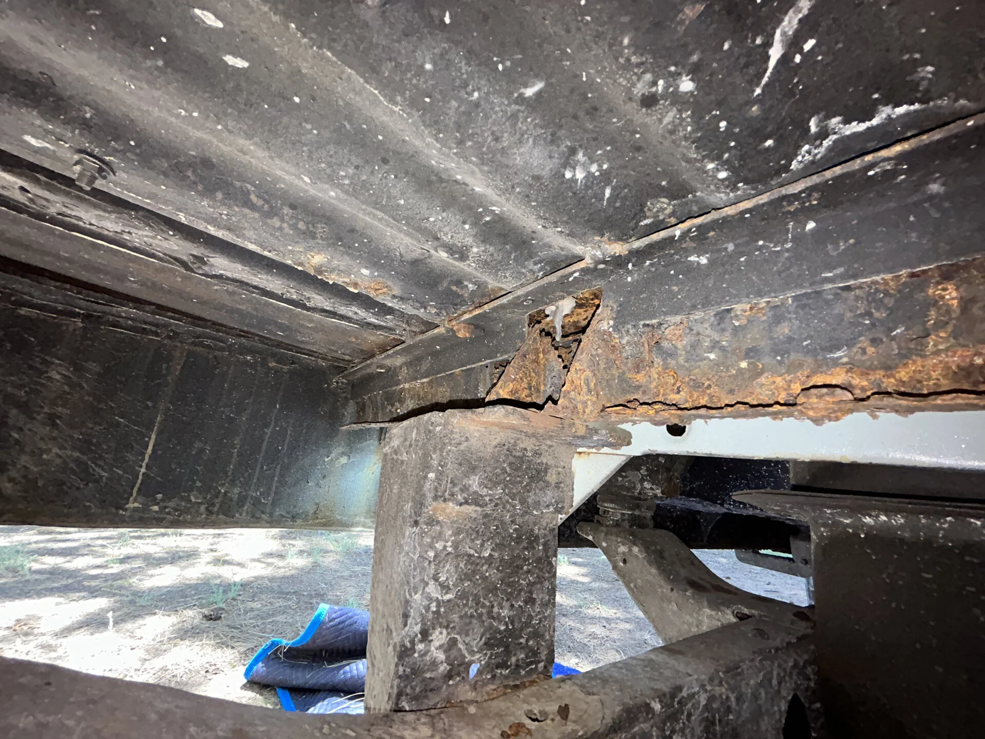

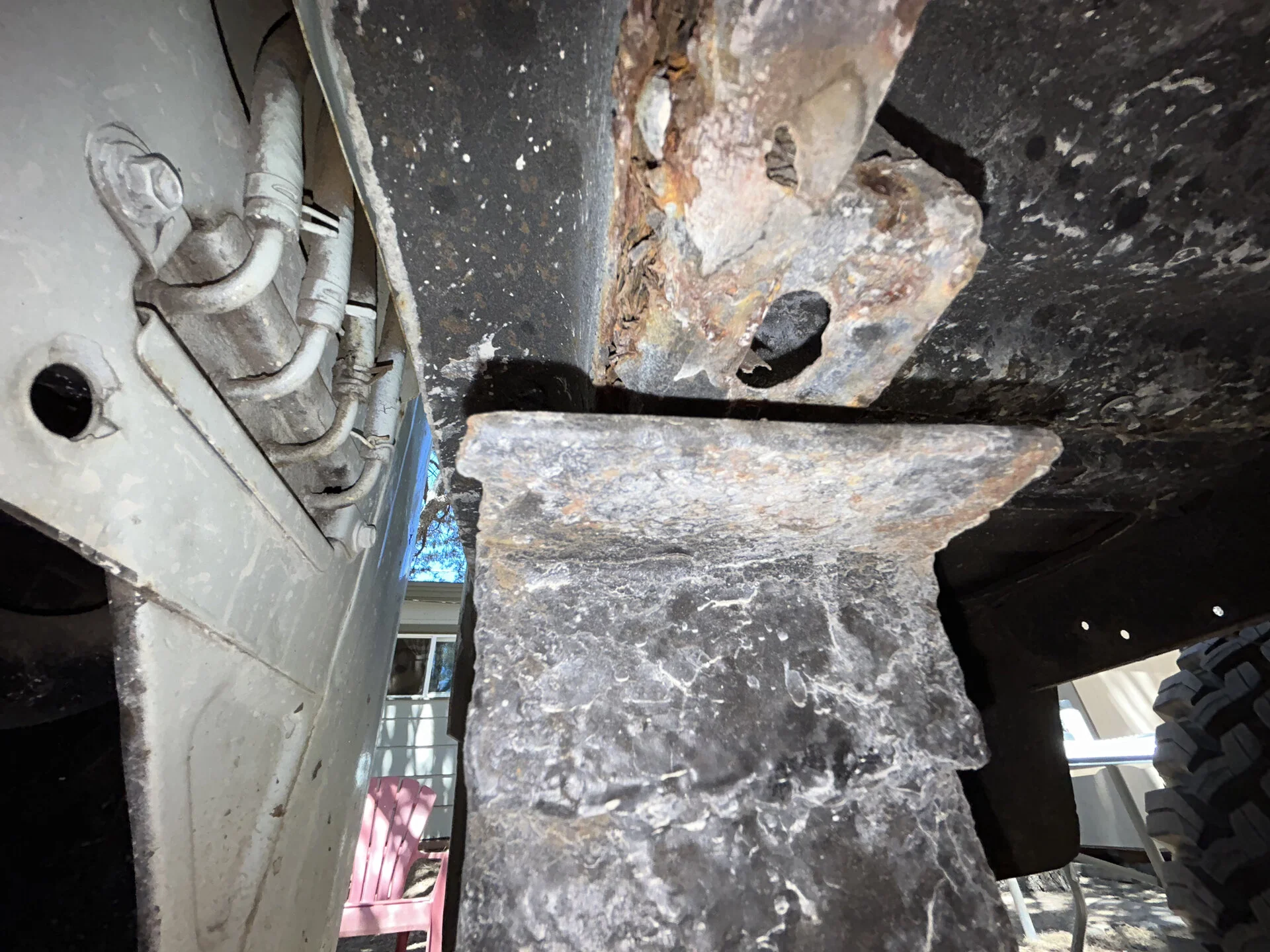

So, I got under the truck and checked out the situation.
Here's what I found...
Well, the mounts are missing at those points, so no wonder the bed shifted. Good deal of rust as well.
I will be taking the bed off, removing the rust, and welding steel plate to those areas that are rusted away. This will give me the opportunity to clean up the frame as well.
Have to check for the mounts too.

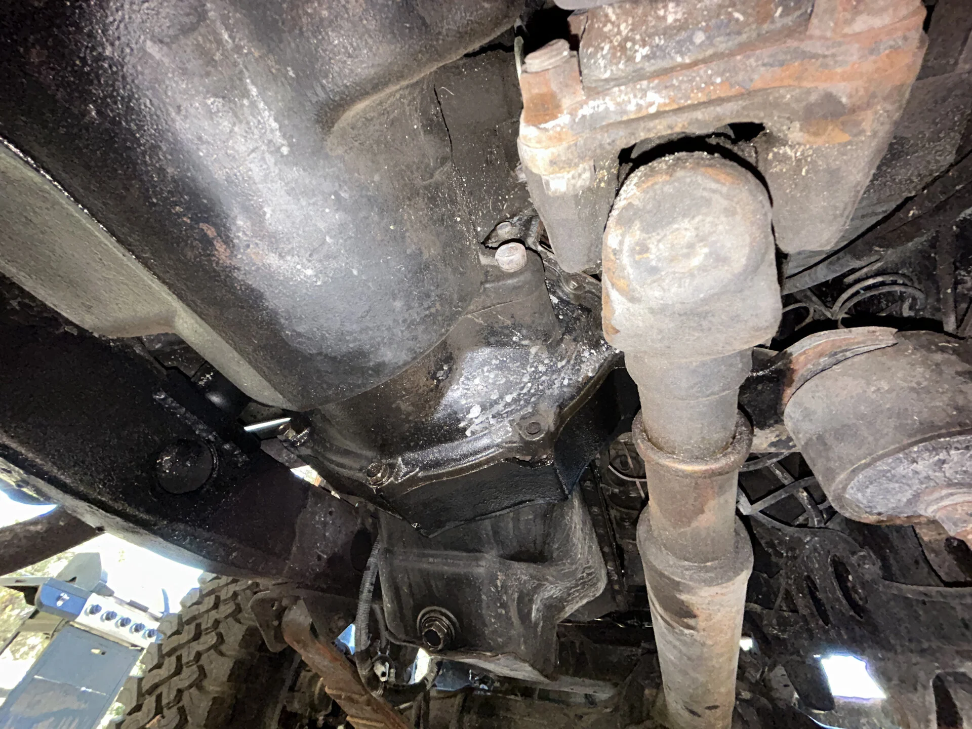

Another issue: Oil leaks!
You can see all the wetness from oil.
Getting a drop of oil about every six seconds.
Seems to be from the gasket of the oil pan.
Kind of like driving a sieve at the moment! LOL!

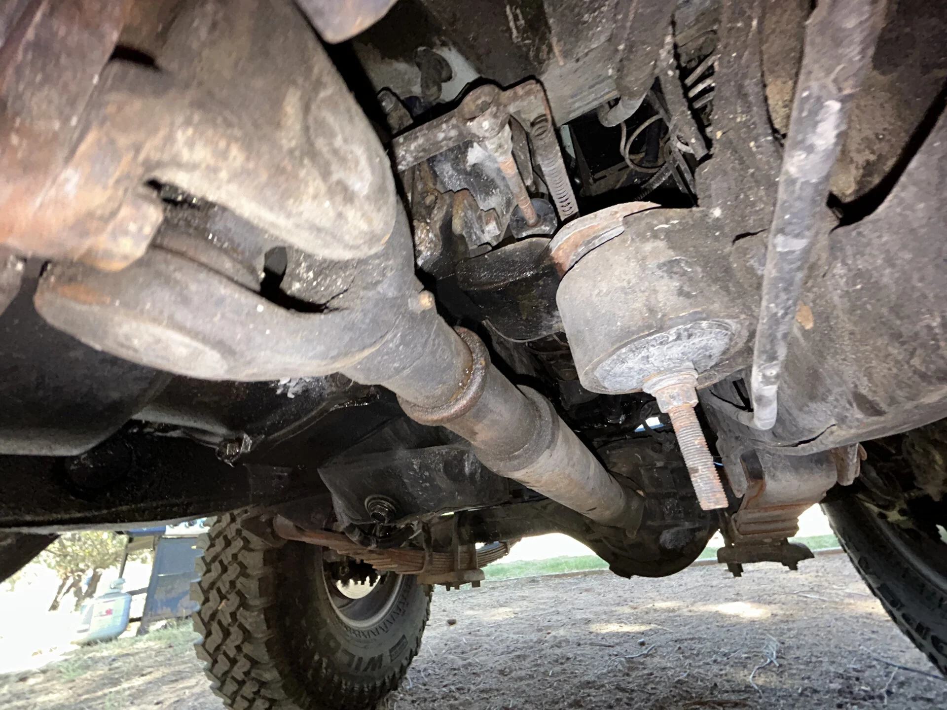

That is a vacuum resevoir tank to store vacuum for your brakes. Likely disconnected due to leaks. The switch is a low vacuum warning light. Unfortunately the south american 45’s were well used and abused, then quickly painted and lots of short cuts taken to make some money selling to unsuspecting buyers in the us.
I see some big frame repairs that were done.
Make sure the driveshafts are in phase, they usually aren’t. I can see the front isn’t.
Do the repairs look bad? I will take a closer look-once I get around to removing the tub.
I'll look at how to get the shafts in phase. Have no idea.

Worth noting that all those joints and shaft couplings have grease nipples for a reason.
Doesn't look like they've seen grease recently - worth spending an afternoon figuring out where they all are and pumping them up.
