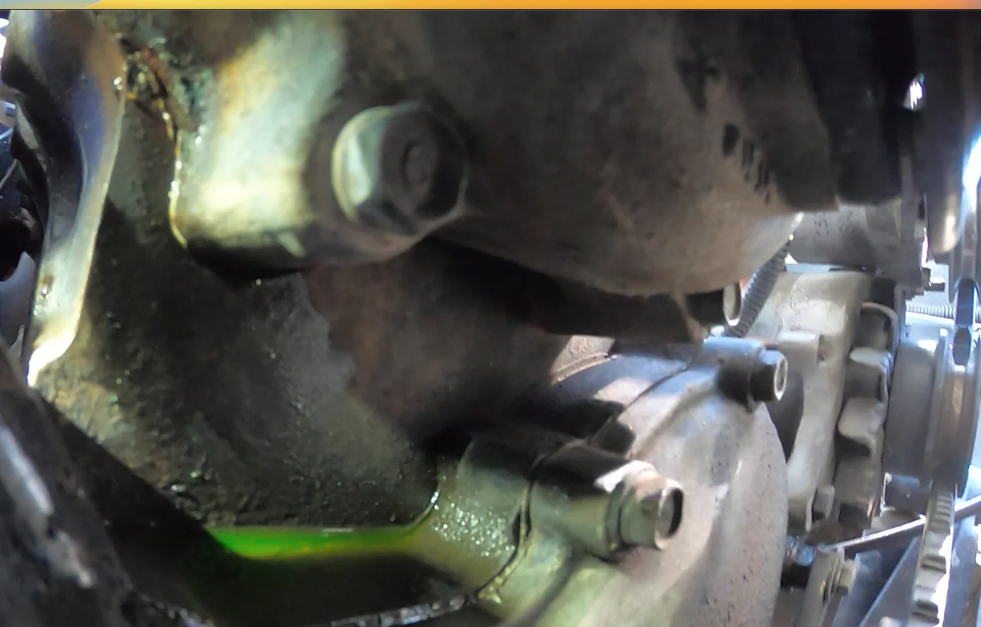

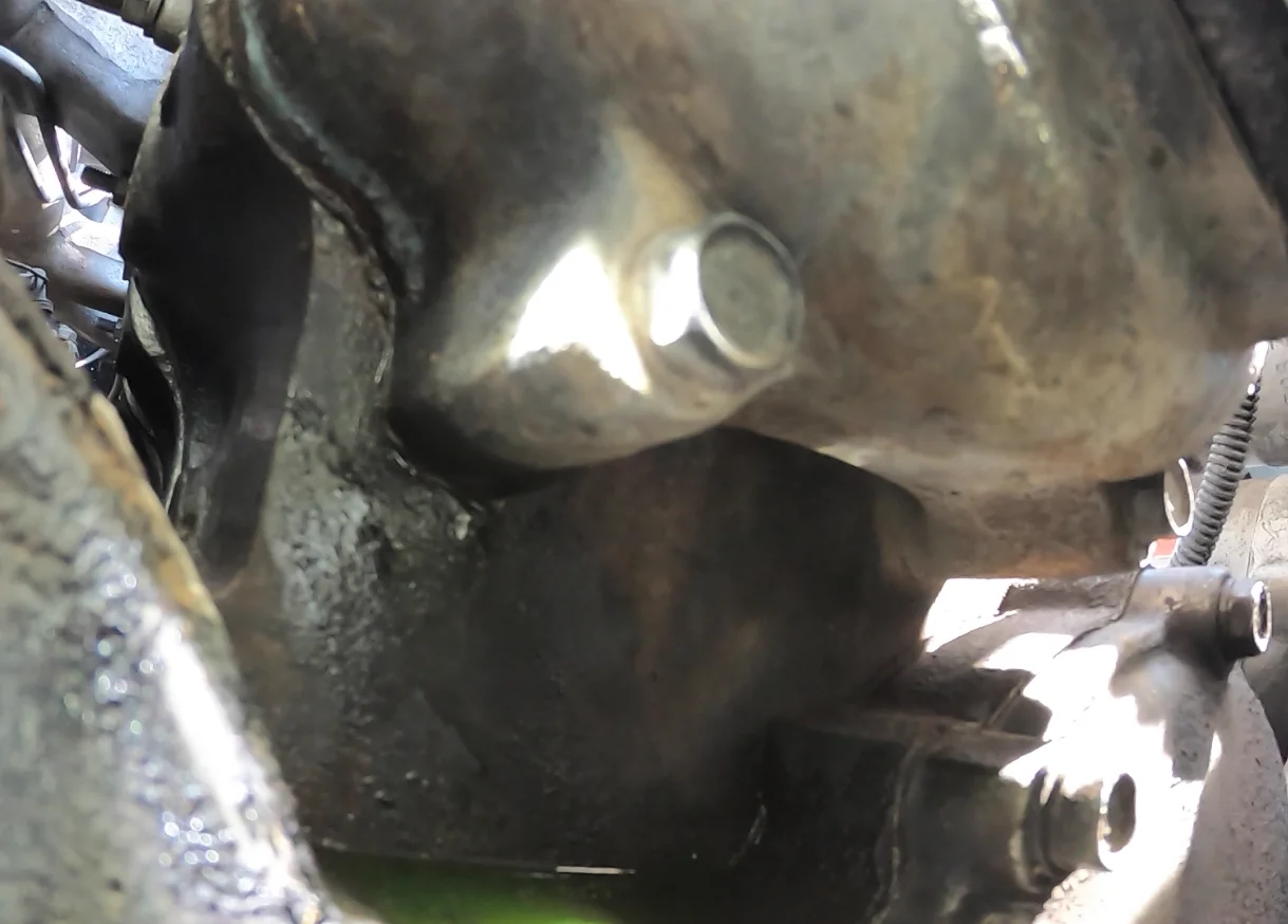

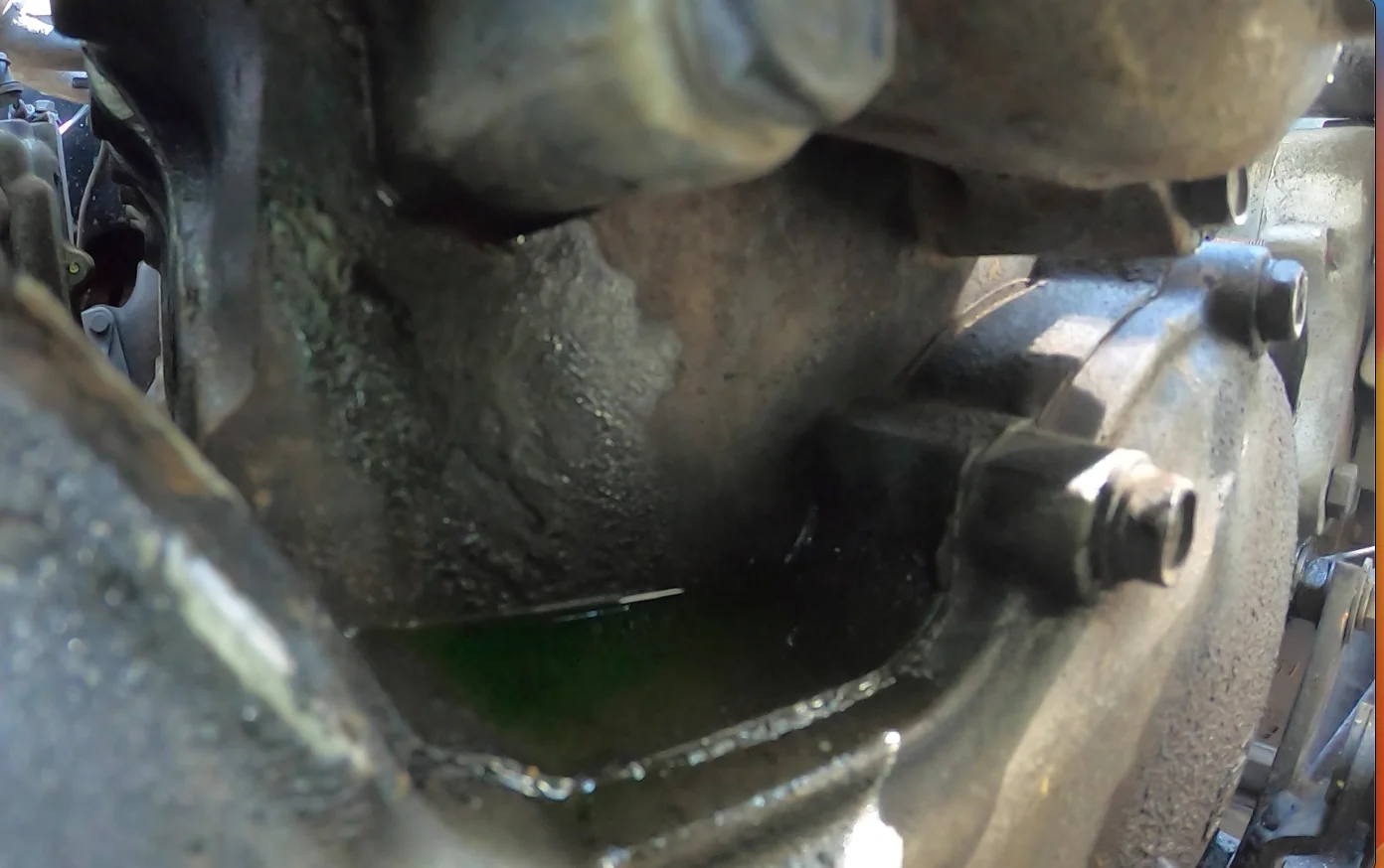

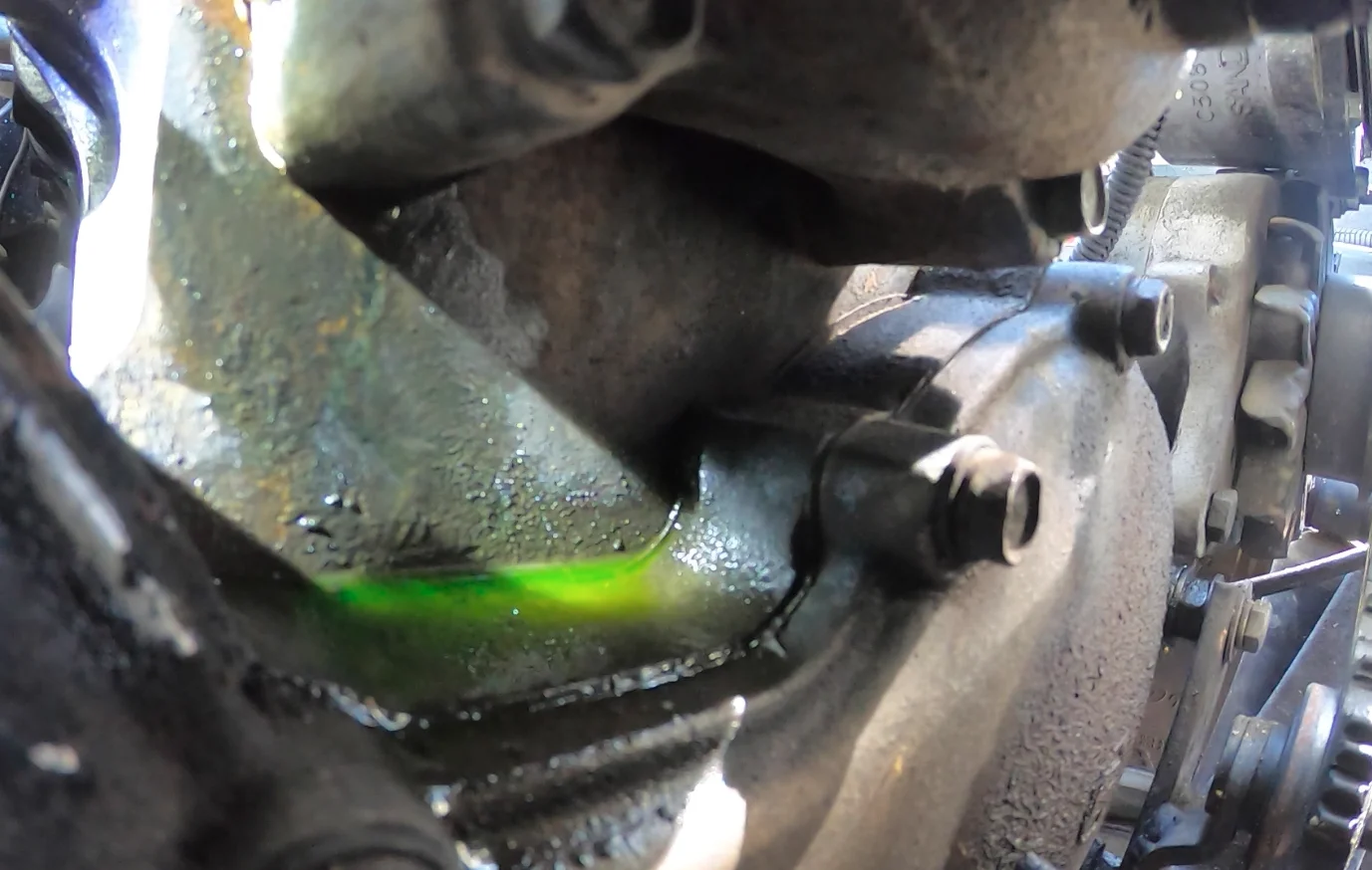

I felt the joint of the radiator hose and no moisture.
However, there’s a good deal of coolant pooled under the water pump-so I’m thinking the water pump gasket has a leak. It’s a brand new pump.
Used my GoPro to check behind the fan and under the water pump. Seems to me it's the water pump gasket/seal.
What do y'all think?
I checked the water several times on the trip and it was always topped off. However, the morning after the hotel in Roswell, NM, after that grueling drive through Texas, I had to add water-about a quart or more.
Here are some pics from under there:
Certainly looks like a strong candidate.
I'd double check the heater hose clamps before pulling it though - and especially that metal pipe which can rust with pinholes.

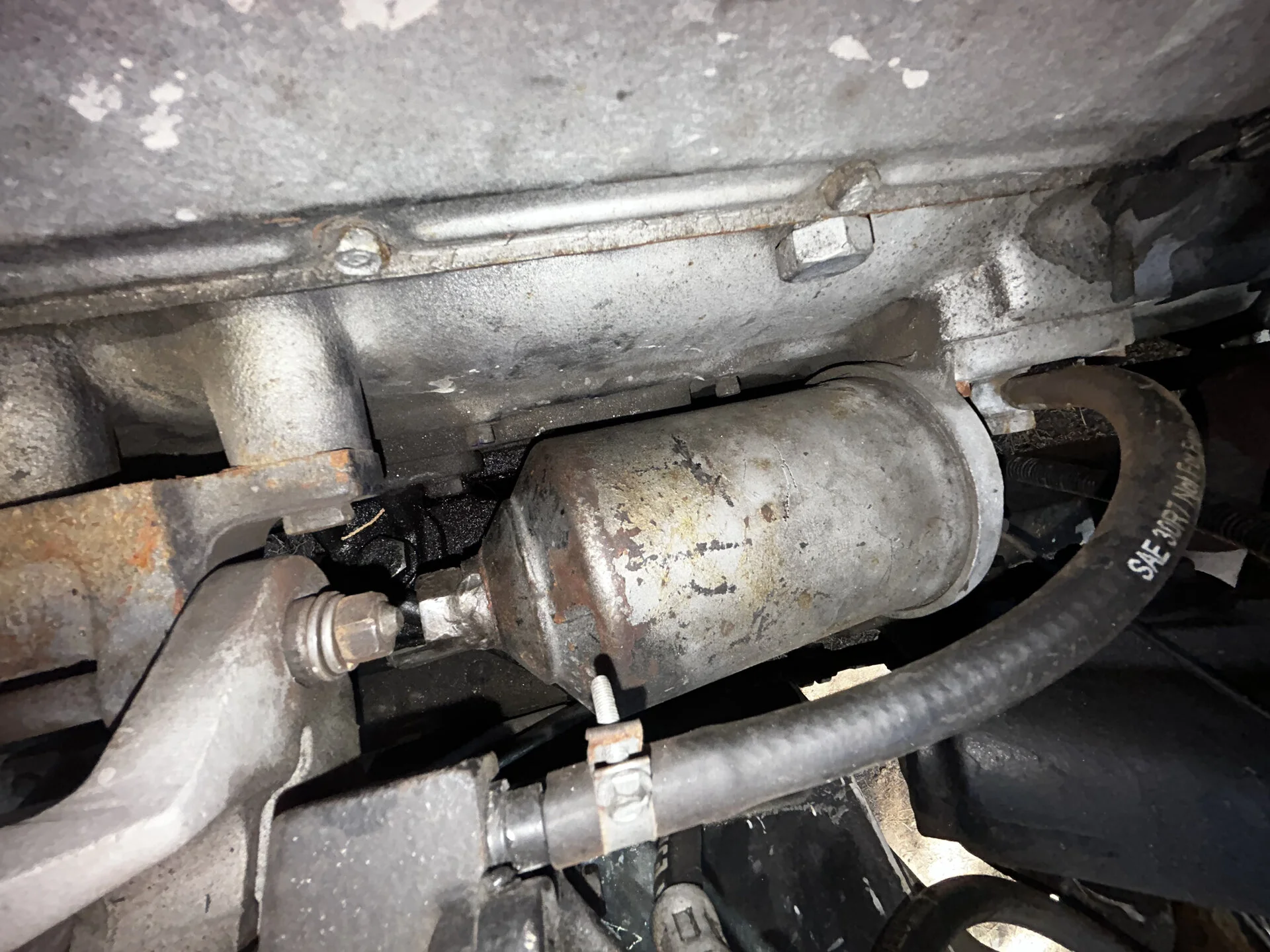

Do you have identical setup to me?
24mm is way bigger than mine (17mm I think).
You do have more clutter there with the vacuum pump tbf. Happy that my electric vacuum pump is well out of the way :)

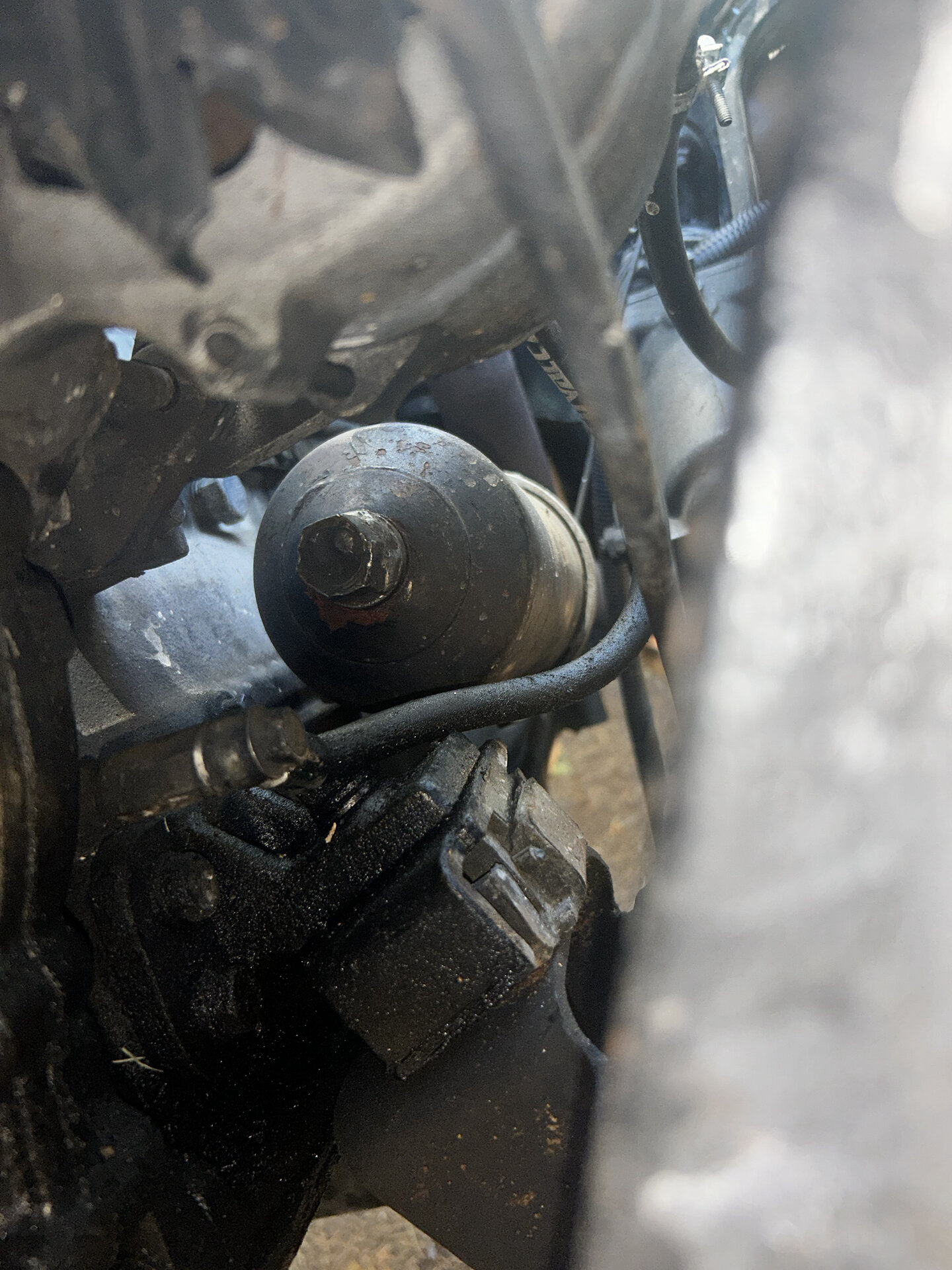

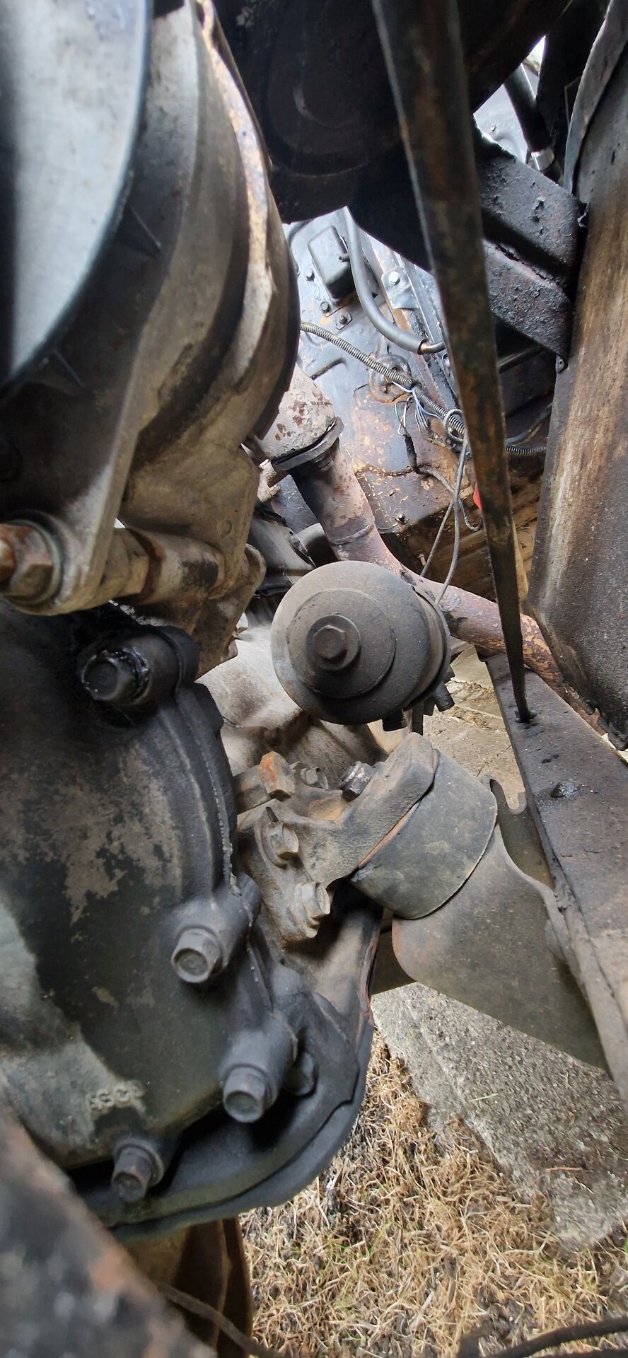

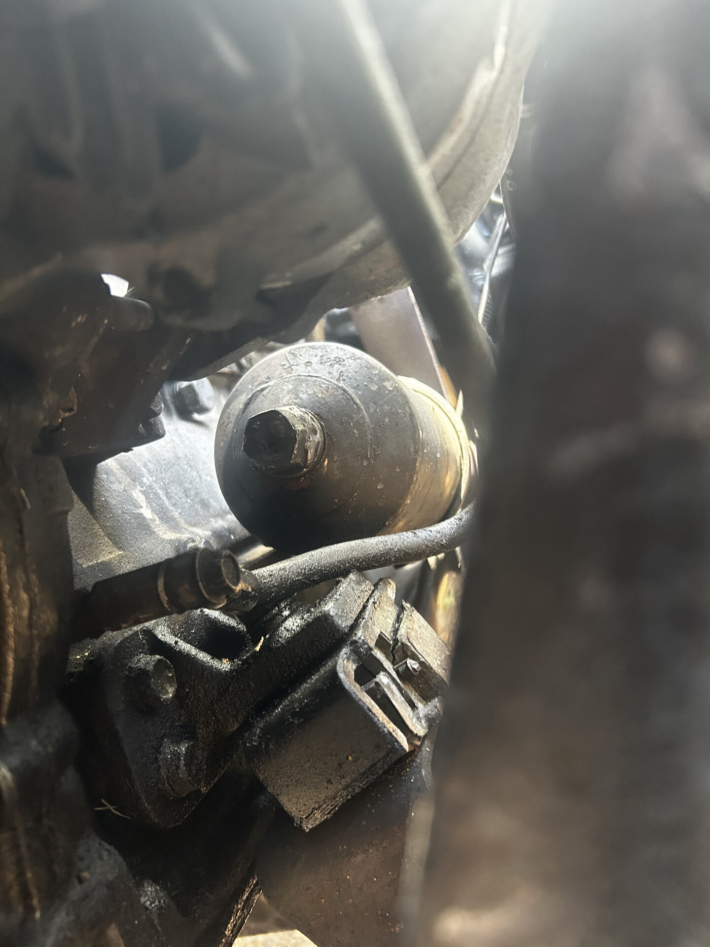

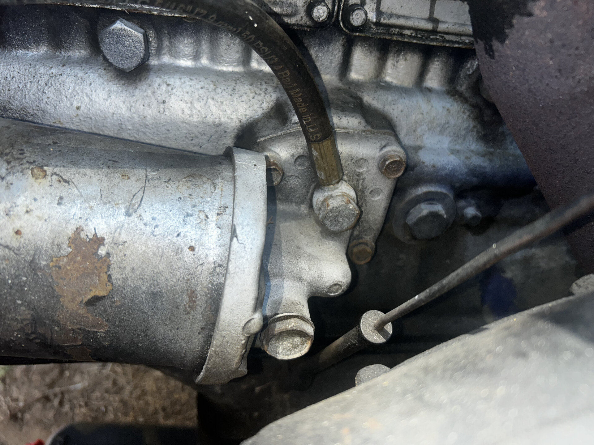

Here's a few pictures of my oil filter.
View attachment 3360408View attachment 3360409View attachment 3360410View attachment 3360412
Is it me, or does it look like some A$$*ole welded a nut on the end of it?
Yea something definitely fishy with that. Possible that the whole centre bolt was remade even? Pull the whole thing off as suggested, but be prepared for all eventualities. Might take a bit of effort to get it back together.
Hopefully they just tacked a nut on the end because it got rounded off due to overly frequent oil changes.
Doesn't look welded to the case at least
