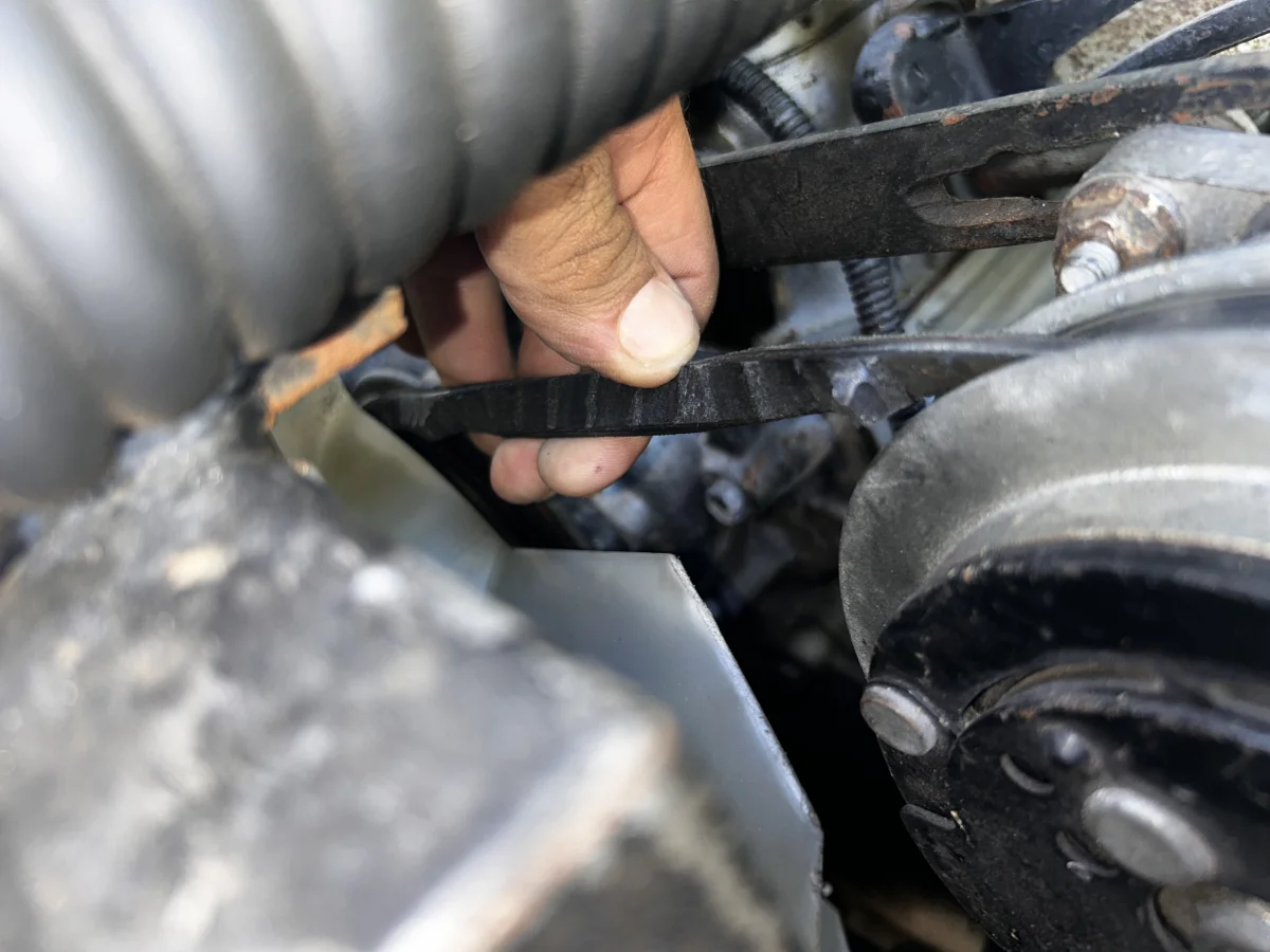

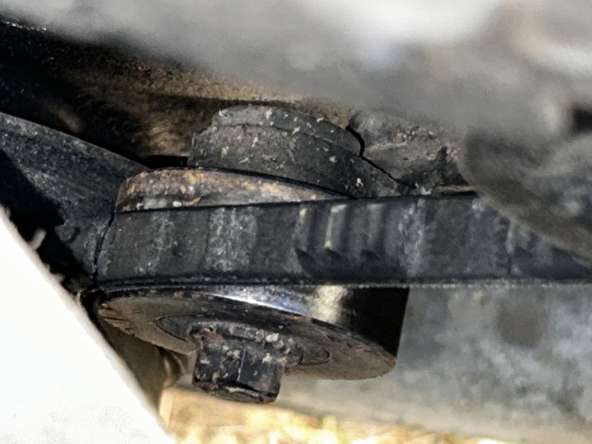

Noticed that the engine belt was really wiggly when running. Stopped the engine and checked it.
The belt is being chewed up really significantly and is at the point of failure. I am thinking this could be due it being too loose. Also, it has "teeth" on the inside. Shouldn't the belt be a solid one? Any ideas?
Also, this belt doesn't seem to tighten too well. Previous owner, my friend, said it threw the belt before while he was driving it, so he measured it with a string and went to a car parts place. I am thinking it may be too long an thus not able to be tightened correctly.
I have this spare, but it's not OEM-just got it after measuring around the pullies with a string. I was in a hurry and just realized I gave the person the measurement, but that was including the old belt being on, so my spare may be an inch too long. If that's the case, it will be even longer than the messed up one is has now.
I am seriously considering removing the Vintage Air unit. It worked fine when it worked-leaked out the "Freon" though, about a day into the trip. I know that's fixable, but not sure if I should keep it on.
On the plus side: it provides nice cold air.
On the negative: it makes me use a non-OEM size belt, and robs power from the engine (?).
Since I am planning a tear down and rebuild (not the engine), maybe it's just as well to remove it, pack it up, and reinstall it later?
Also, I am seriously considering one of those 12 volt undermounted AC units. This would serve to cool the cab, and also the box on the back. The truck being so small, I could probably also cool a tent addition! Being 12 Volt, I wouldn't need to use engine power tto run the AC pump.
I could also just get a correct sized bvelt for use with the AC and use it for now, until I start the rebuild.
