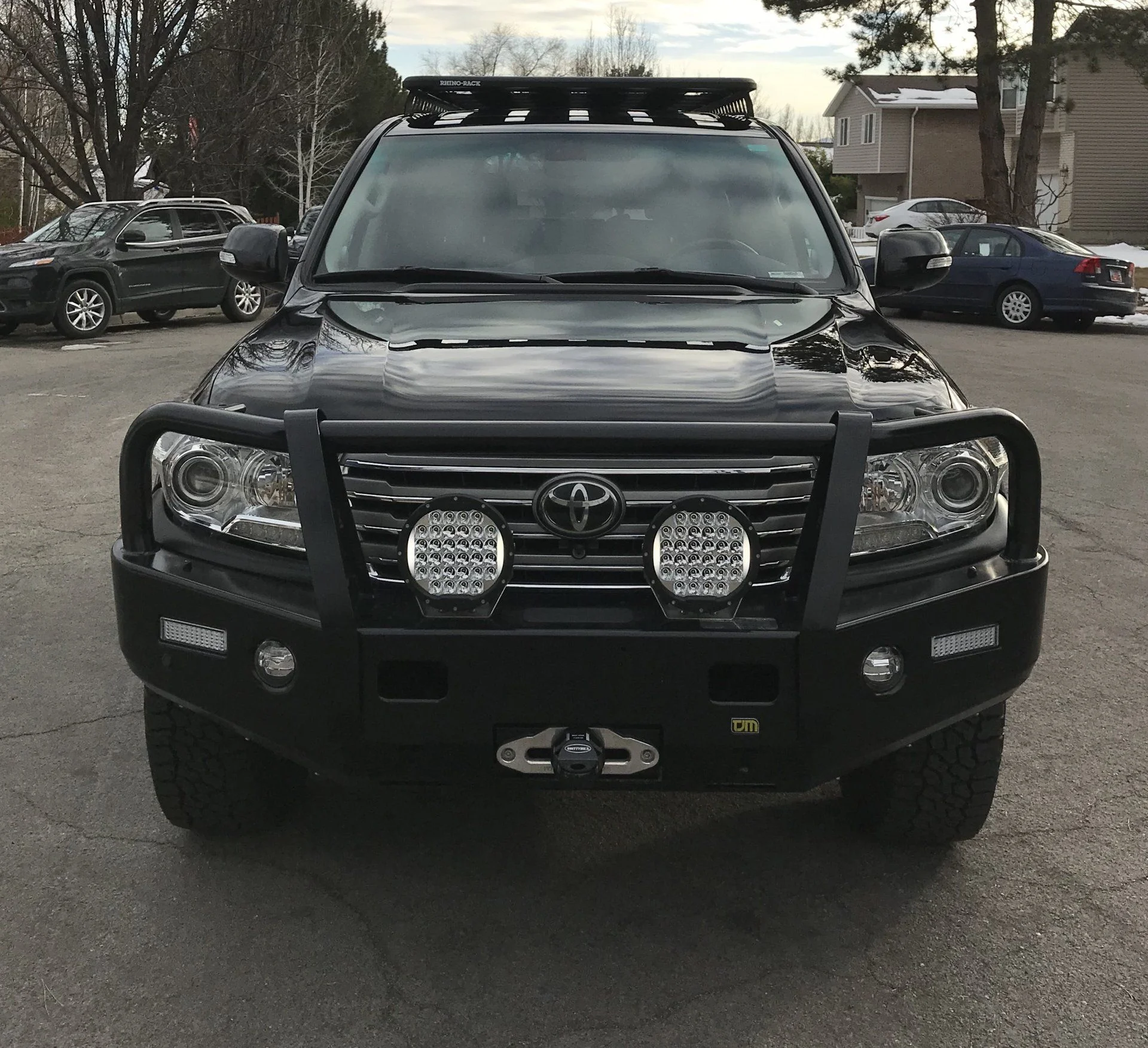

@ckkone did you ever get your 9" lights mounted on the TJM? I will be picking up my bumper from Slee in a few weeks and installing. I have some 9" ARB LED knockoffs that i want to mount on the bumper, but was curious of they will fit with the hoop design.
@ckkone I saw you mounted a winch with the synthetic line and used the extension for the hawse fairlead. I have a Warn VR10000s with synthetic line and once i put the extension piece on for the fairlead, it makes the line contact the winch steel. Do you have any problems with your winch line doing that? I will try to post up a pic showing what I am talking about.
The line co tact’s the angle support that goes on the winch plate.
I highly recommend Stedi lights out of Australia. Heavier mounting brackets than ARB, and include harness, switches and two amazing lights shipped to your door in the US for $600.
Here they are on my TJM T13:
