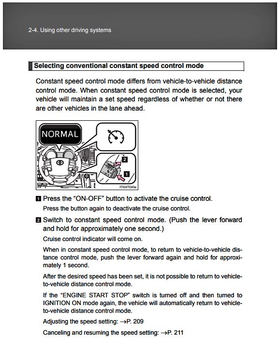

Did you try to set the cruise control to standard by holding the cruise control lever towards the dash?

I agree with @M1911 . When turned on, the cruise control starts in Radar Cruise Control mode, I think you need to switch to normal cruise control mode that does not use the radar. Here's how:
HTH
Yes I tried that and it didn’t work. As soon as you press the on off button (step 1 from manual) it throws a “check cruise control” error and the pushing the lever froward step does nothing.
