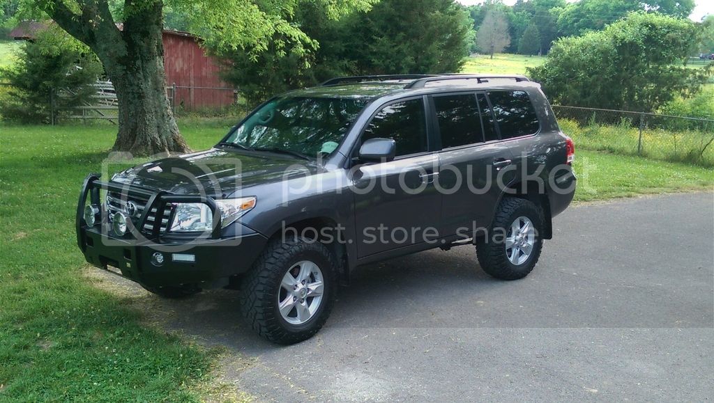

Mine is not color matched, but Willy had his powder coated to match. Here are a few more pics. If you would like something specific, let me know.
I see you pulled your running boards. Looks great.
My wife made me put mine back on. :(
