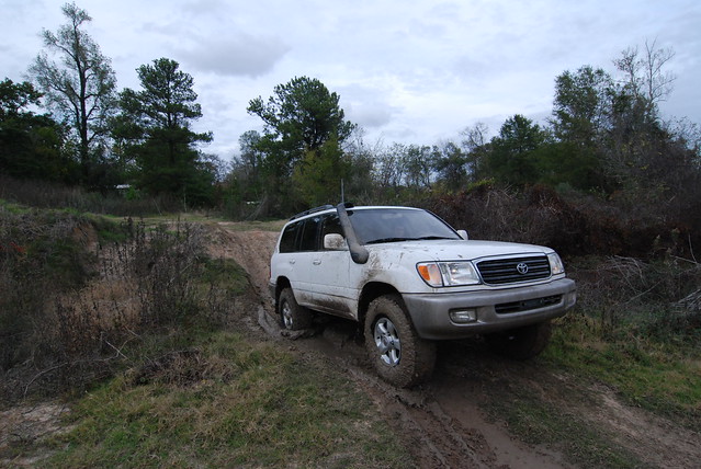

running a nearby river this weekend. (sucks when you are the cameraman) No river crossing pics, but the water was never over the top of the hood.

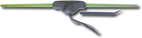

Ben at Slee mentioned a similar deal with the rear window antenna, wasn't sure if it will work but I will find out... I suspect best case is reception is similar to how it is when the power antenna is all the way down, which is ok but not great, depending on location. I am thinking of a "soft" antenna that is tied to the snorkel... like a piece of twin lead of something. If I could restore 80 percent performance in a more stealth mode, I'd be super happy.

Yup, see some of the ideas on page 2 of this thread.. there are some soft antennas, some that could be mounted along the snorkel somehow, or even mounted elsewhere. Personally I'm annoyed by the default up & down behavior of the antenna, and since I haven't gotten around to RobRed's switch mod for that I'll get a 2fer here with the snorkel.

The rear wing window antenna doesn't cut it for me. So I ordered a 31" whip with a spring type base. I'll see how that works...but from a reception point of view it should be about the best.
