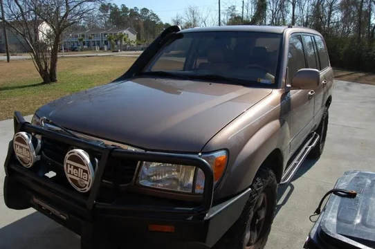

TJM Airtec Snorkel purchase and install
Looks good in bronze too:grinpimp:
I'm sure I'll get a 10hp boost and 2MPG better based on looks alone:cheers:

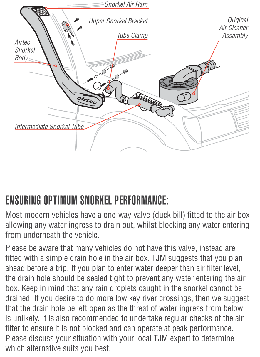

I did some additional research and it appears that the newer design for the 100 Series snorkel does not have any drainage built-in. TJM's marketing collateral states:
This is referring to the Safari-like snorkel models that they offer.
Finally, according to this document, it is our responsibility to ensure that we have a one-way valve in our vehicles and to firmly seal any holes that are on the (non-TJM) air intake path.
Going to check for the one-way valve in my air box. I could have sworn that the round air canister 100/105 crowd were the sole beneficiaries of this valve. I'll know in a bit....
Ok, unless I am missing a part, our air boxes do not have a one-way valve. What I found was a plastic cap with a hole in it. You can even see the paint of the fender well in the hole of the cap. It would take a long water crossing, but our fancy snorkels would be rendered useless in prolonged deep water. Does anyone know if there is a replacement part for the "plug" we have at the bottom of the air box?
