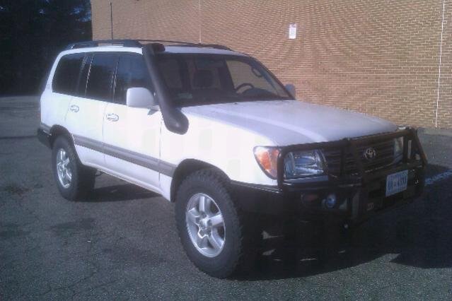

Luckily for us, the snorkel is on the opposite side to the radio aerial. No problem here if I have one installed.
So far I am very happy with my TJM snorkel...
*FWIW, removing the power antenna did impact radio reception. Its not too bad in the city, but once you get out of town you can notice that reception is worse.
Looks great ! take a front on shot and post it. thanks.
