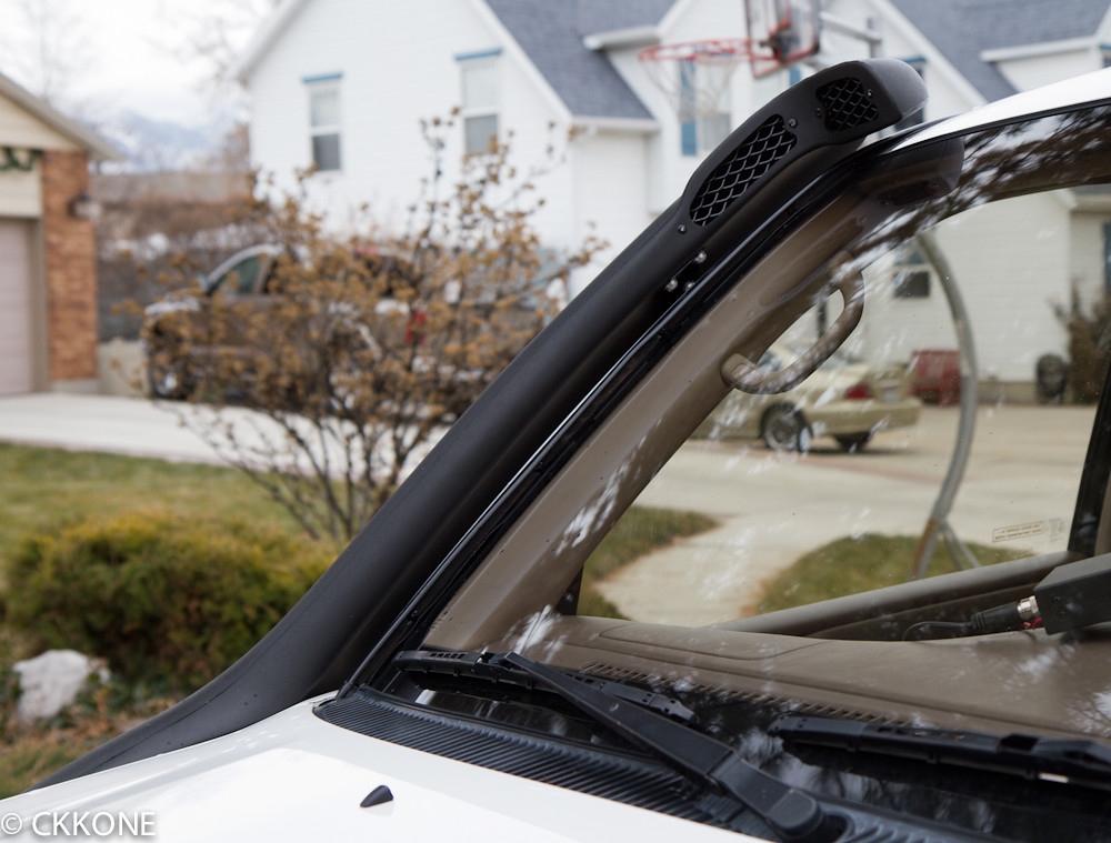

Where is the hole for the antenna, does the snorkel body cover it? What did you so to cover the hole? Any pics during the install? I think I bought the last one from Carl and inquiring minds want to know:p
waaaay off topic, but the spressowagon needs the 35 MTRs back. It looks so peaceful and nonagressive. It makes me a little sad.
Agreed! I've got a little driveline vibe that is obscured by the MT/R's...and I haven't had time to get the darn rear upper adjustable's built to play with the pinion angle. But yes...the darn spressoWAGON looks damn nekid with the Toyo AT's!
:lol::lol::lol::lol:
Yes the TJM Airtec covers the OEM antenna hole atop the fender. This was the only photo I snapped. Pretty uneventful install for photos anyway ;)
FWIW I ruined every plastic inner fender skirt retainer getting the darn thing off. So I'd suggest having extras on hand...
FWIW2 I had a 3-1/2" holesaw on hand and didn't feel like running down to get, and spending $, on a 4-1/2" holesaw so I just used the air grinder to enlarge the holes including the smaller holes for the 4-studs/bolts. Worked great. A step type drill bit would be better IMO for the smaller mount holes as it wouldn't catch and distort the sheetmetal compared to a regular 135* drill bit.
I should have the flex hose tomorrow or Thursday...that should make the install simpler and better in terms of a more airtight fit between the snorkel and the air filter box elbow.
