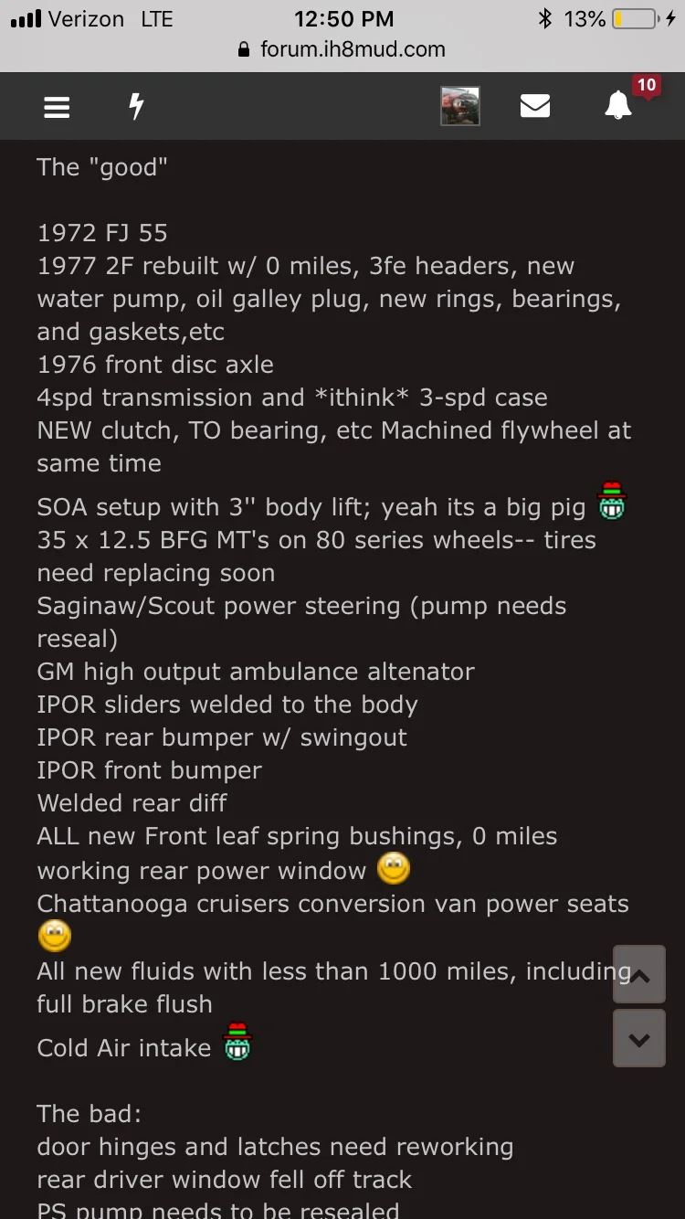

IIRC It was @junkdriver Tim Prillaman’s (sp) before I owned it. He put the 3” BL and 38” gumbo Mudders on it for east coasts pig party probably 2003 ish. Had the armor installed up at iron pig by Lance and crew. I think I bought it in 06 up around Charlottesville VA

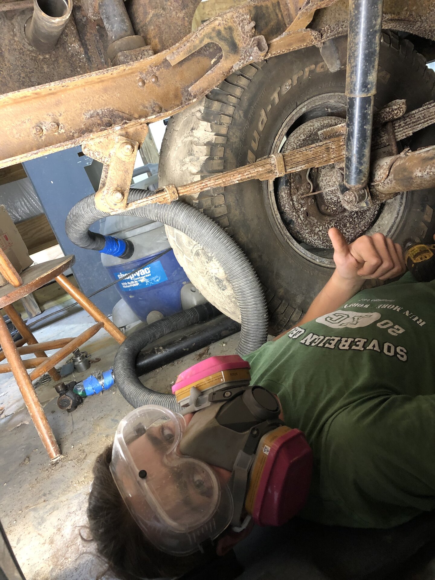

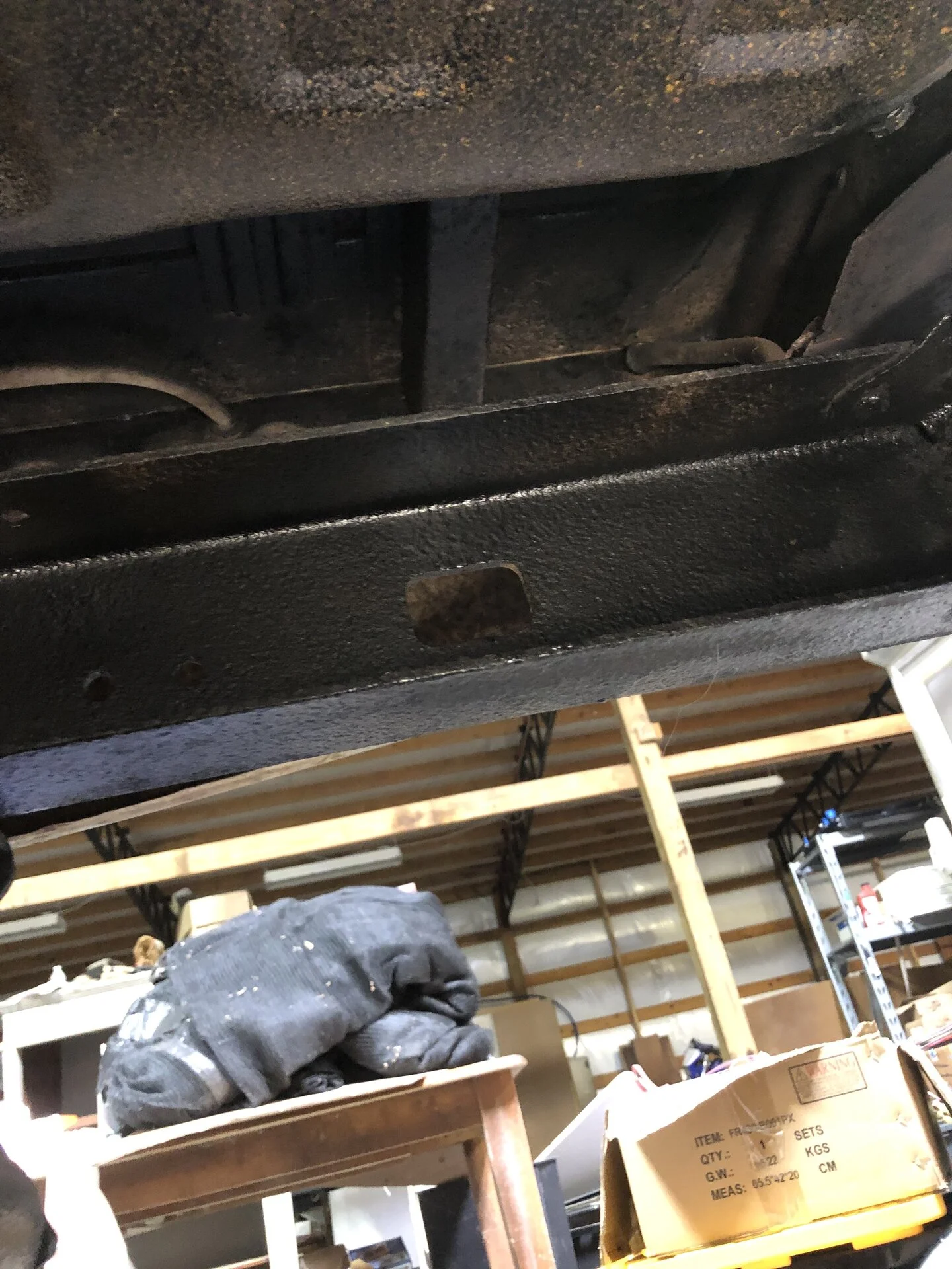

Today wView attachment 3451172e cleaned up the frame around where the tank goes and rattled canned the frame and underside of the body in that area. Got the tank back in and blew out the gas lines
Need to follow in your footsteps and swap my tanks. Frankencruiser hasn’t been out of the garage since April.
Tank wasn’t as bad as I thought it would be. I’d read about some being terrible to get out. The worst part was the back two bolts broke. I ended up cutting the mounts a little and putting bolts back in thread side down through the original holes and welding the mount back closed. I sprayed all the vents with some lube and the hoses slid back on pretty easily. Tomorrow going to start on putting in the radiator, thermostat, and hoses back on. The radiator was cleaned, pressure tested several years back and been in storage.
