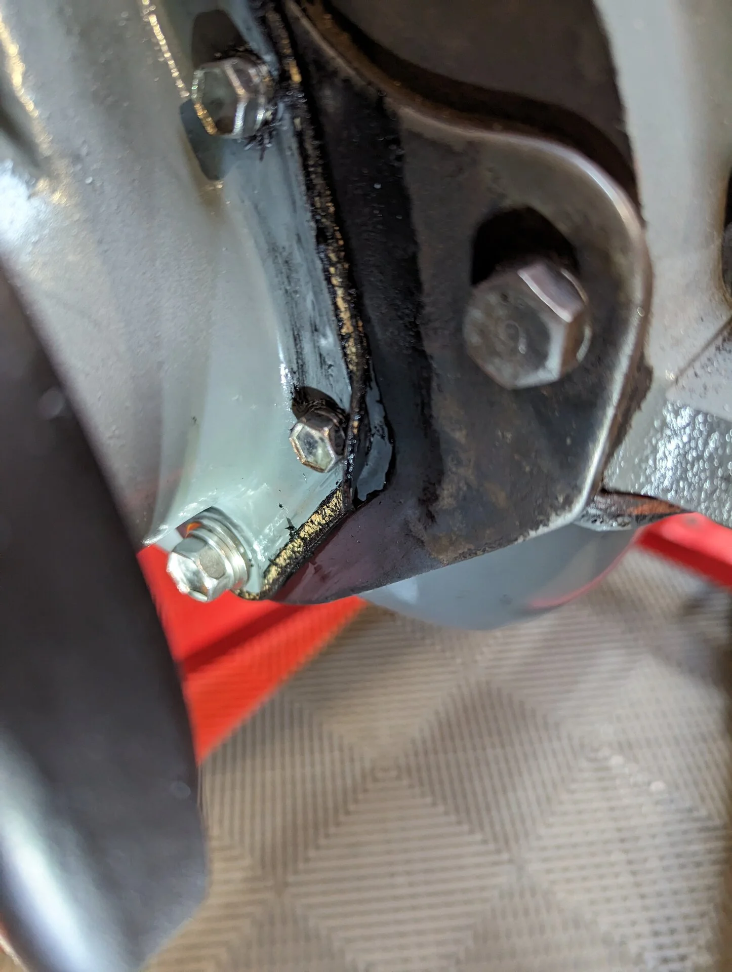

Hi All, I recognize there are many threads about this, but none that I've found seem to answer enough. I'm in the process of putting my motor back together, and when torquing the timing cover to what the service manual calls out, it pushed the gasket out. As other threads have suggested, I went through and flattened the timing cover metal flange, which was true with mine. It had been overtourqued in the past and bent the metal. With a very flat cover, I laid a thin layer of FIPG on both sides of the gasket. I let it set up for 30 mins then finger tightened it over the timing gear. I put the harmonic balancer on, then let the FIPG set up overnight. This afternoon I pulled the balancer back off and torqued the smaller bolts, in a back-and-forth pattern, to the min of what the manual calls for 53in-lbs and the larger to 12ft-lbs.
Most everything seemed okay except for the bottom right, one up from the larger bolts.
My question is, do they need to be tightened so tight? How much oil pressure is behind there, would a torque value similar to the side cover be enough? Or, is there something I'm
missing that would allow this gasket to stay put?

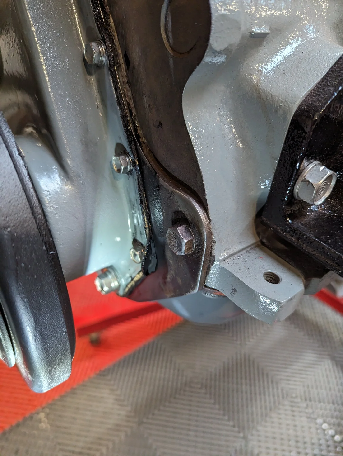

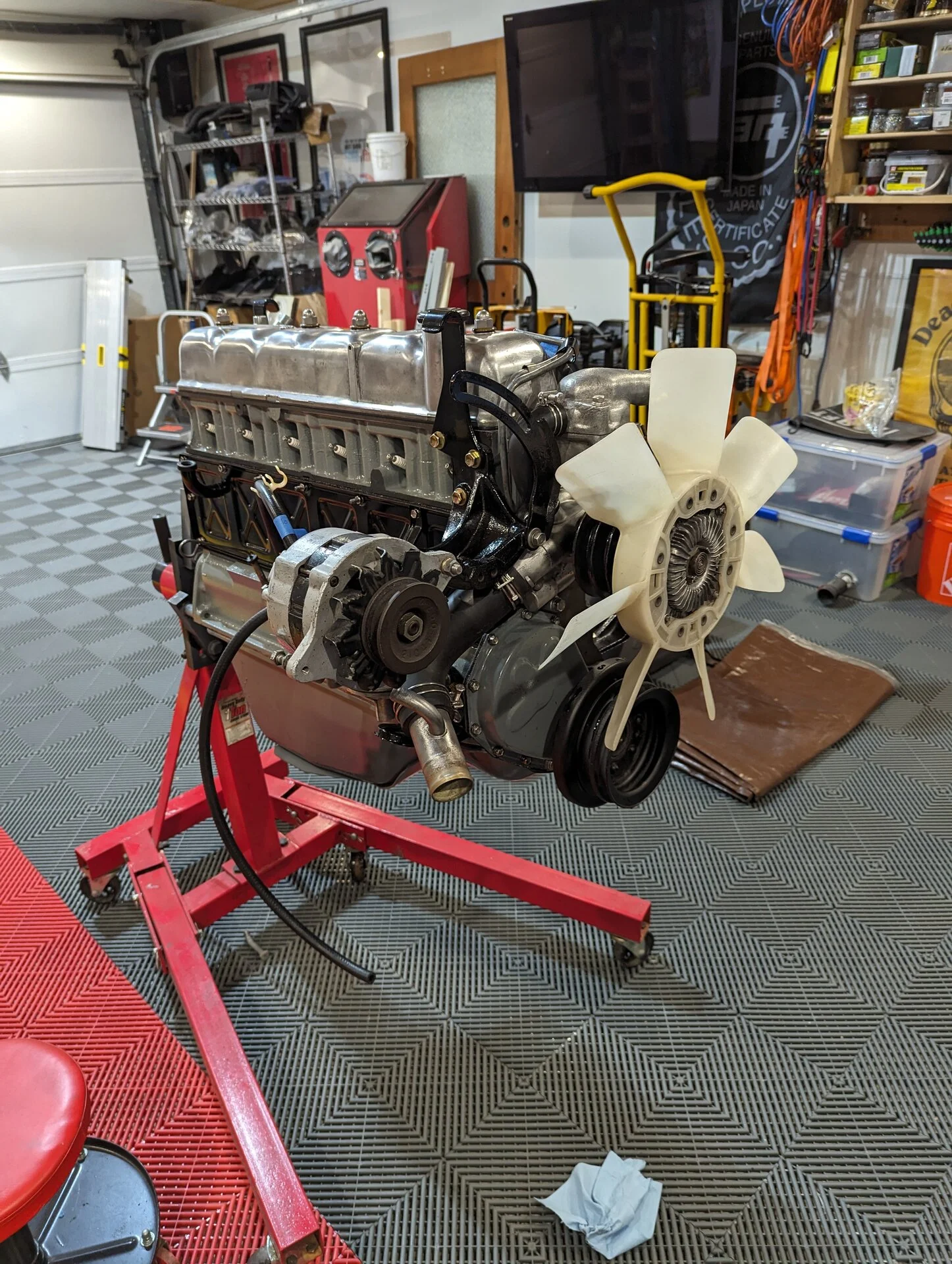

Picture of the whole thing, becasue im excited about it.

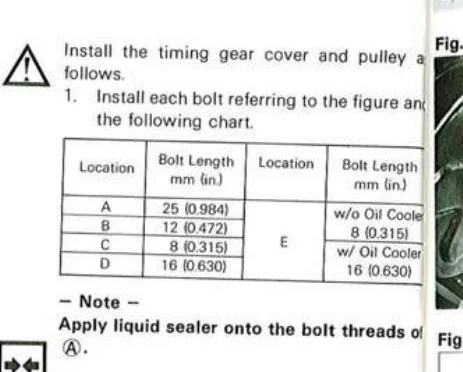

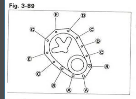

- did you make sure to follow the thread LENGHT LOCATION chart location plan-a-gram in tghe FSM too ?

Hi Matt, thank you for the detailed response! Based on you're staemtns, I think there are some things im missing, i copied your statemtentis in italics and added a comment at the end here:
- did you stake the V-HEAD / giant flat head screw driver machine screws like the FSM states ? No, im not sure what this means, can you elaborate or point me at the figure in the FSM?
- did you make sure to APPLY the black FIPG sealer to ALL the male bolts threads here as the FSM mentions too as well ? I only applied liquid sealer to the two larger bolts. Not FIPG though, I used Permatex 59214 high temp thread sealer. Are there different versions of the FSM, maybe im using the wrong one? All i saw was this.
If i do apply FIPG to all, when in the process should i do that? When i finger tighten the bolts. Doesnt FIPG take time to set simillar to BLack RTV? Thats what ive been going off of, on the back of RTV it says to wait an min of an hour before torqueing?
- did you make sure to follow the thread LENGHT LOCATION chart location plan-a-gram in the FSM too ? I did this, though i only had two lengths. The longer two i put into "D", the rest got the shorter lenghts with the exception of the two bigger bolts at the bottom, "A".
I feel like this statement is key "- when you see the cork start to PUSS out the outside edges simply , , STOP .......🛑" 53in-lbs seems to tight along that side.
Im going to pull it apat and try again, using your suggestions. Do you think i need a whole new gasket, or cani just apply a thin coat of FIPG and go at it again?

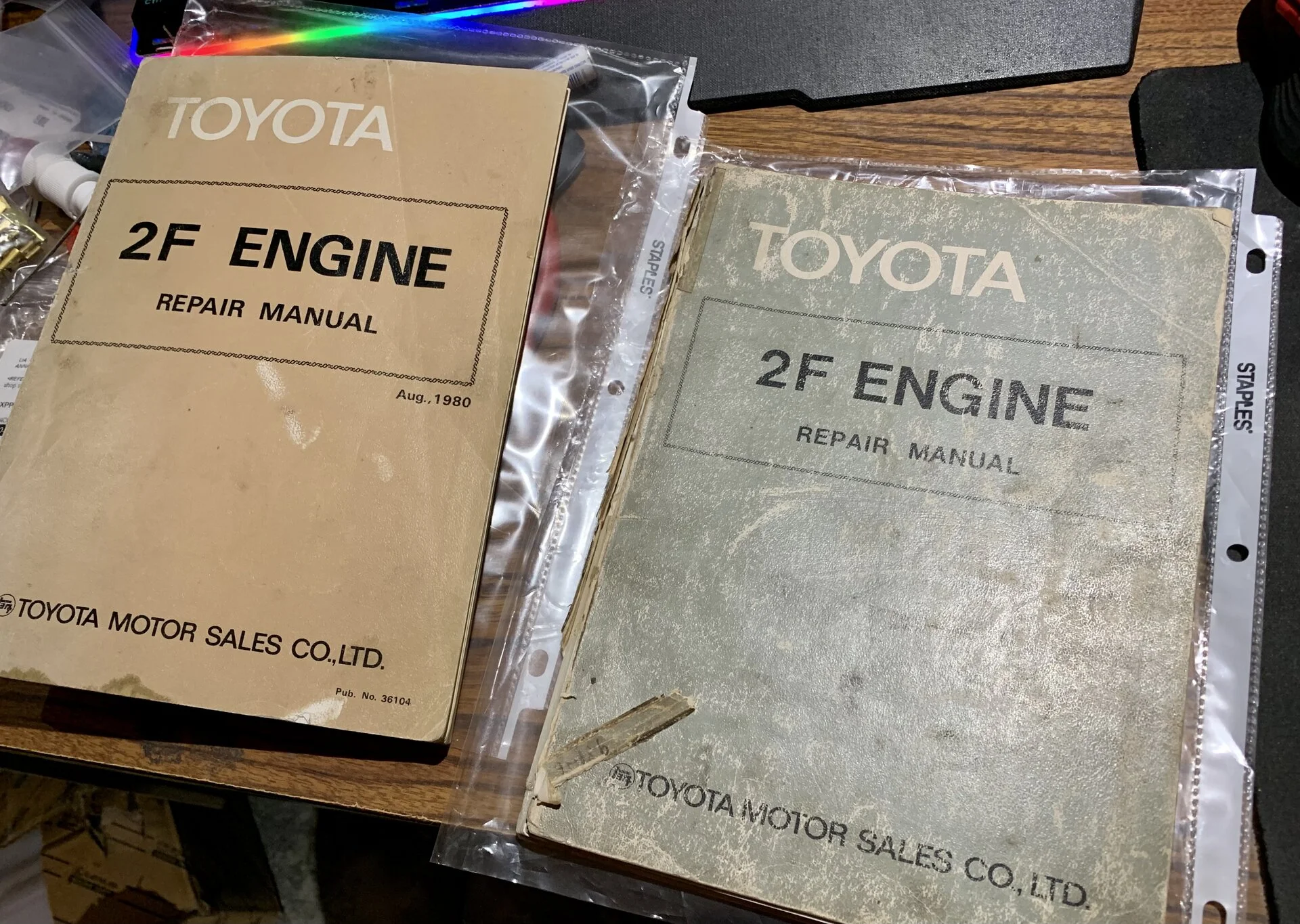

- I always roll like Billy the KID on a 2F , having a twin FSM,s going on , one in each hand here …
- the 1st gen. Gray one and 2nd gen. Tan one are so paramount for me to go at a specialty step by steps job scope like the cork timing cover gasket and a new crank shaft seal too ….!

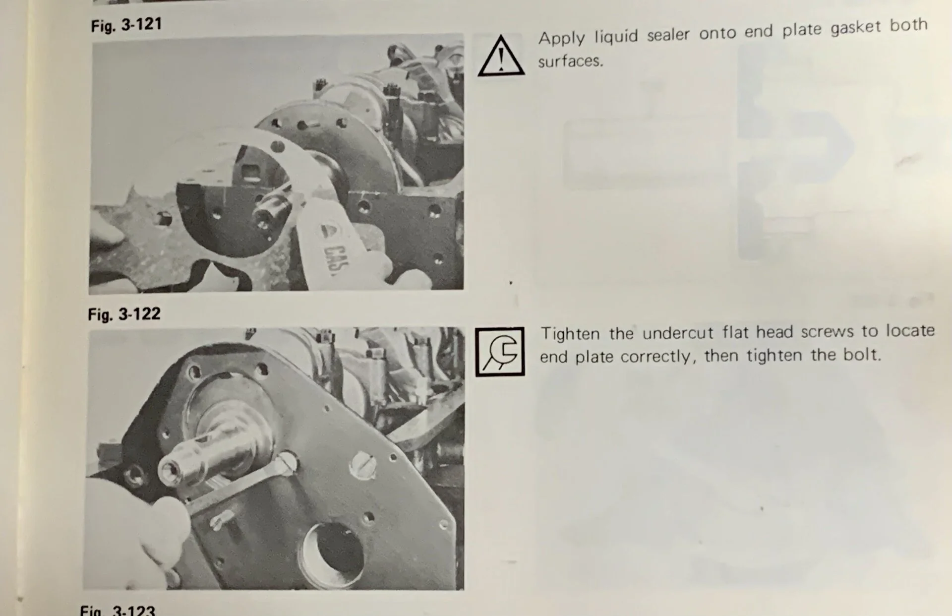

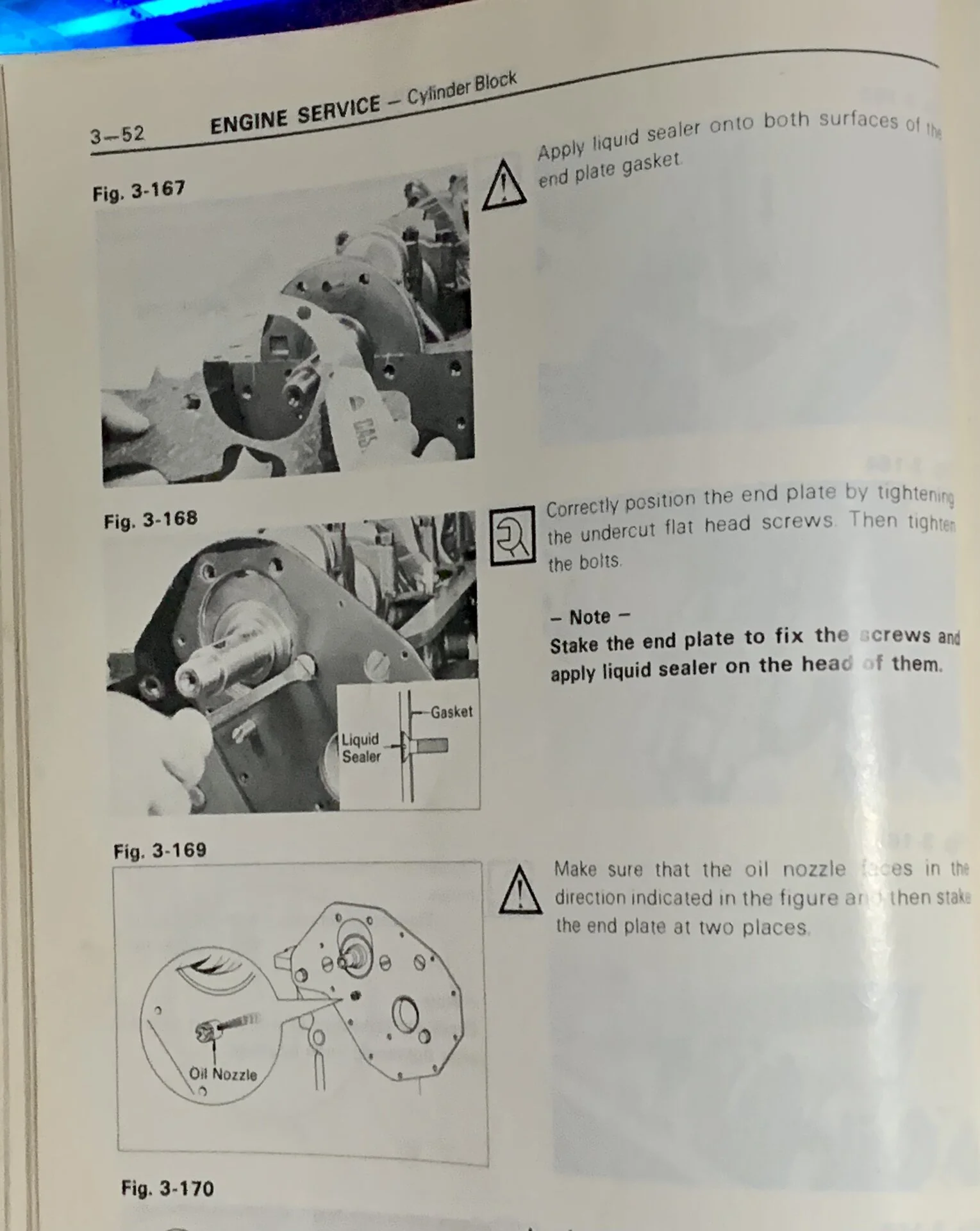

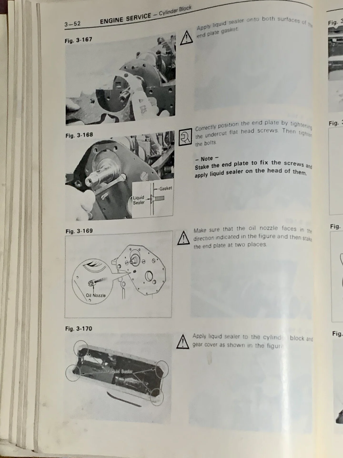

I will show you below the WHY and it relates to the STAKED plate V-head Machine screws ..
I should have asked if you pulled the FLAT plate behind the timing gears or not ?
If I was not pulling plate , I would by nature examine the oil nozzle and all the staked V-HEAD machine screws too to see if any any and time movement had occurred ?
I have seen this occur many times and that in it self dictates the irk-some task of the plate gasket replacement too here ?
I was flowing on your thread here and it seemed to be an engine rebuild ? But clarify here please ?

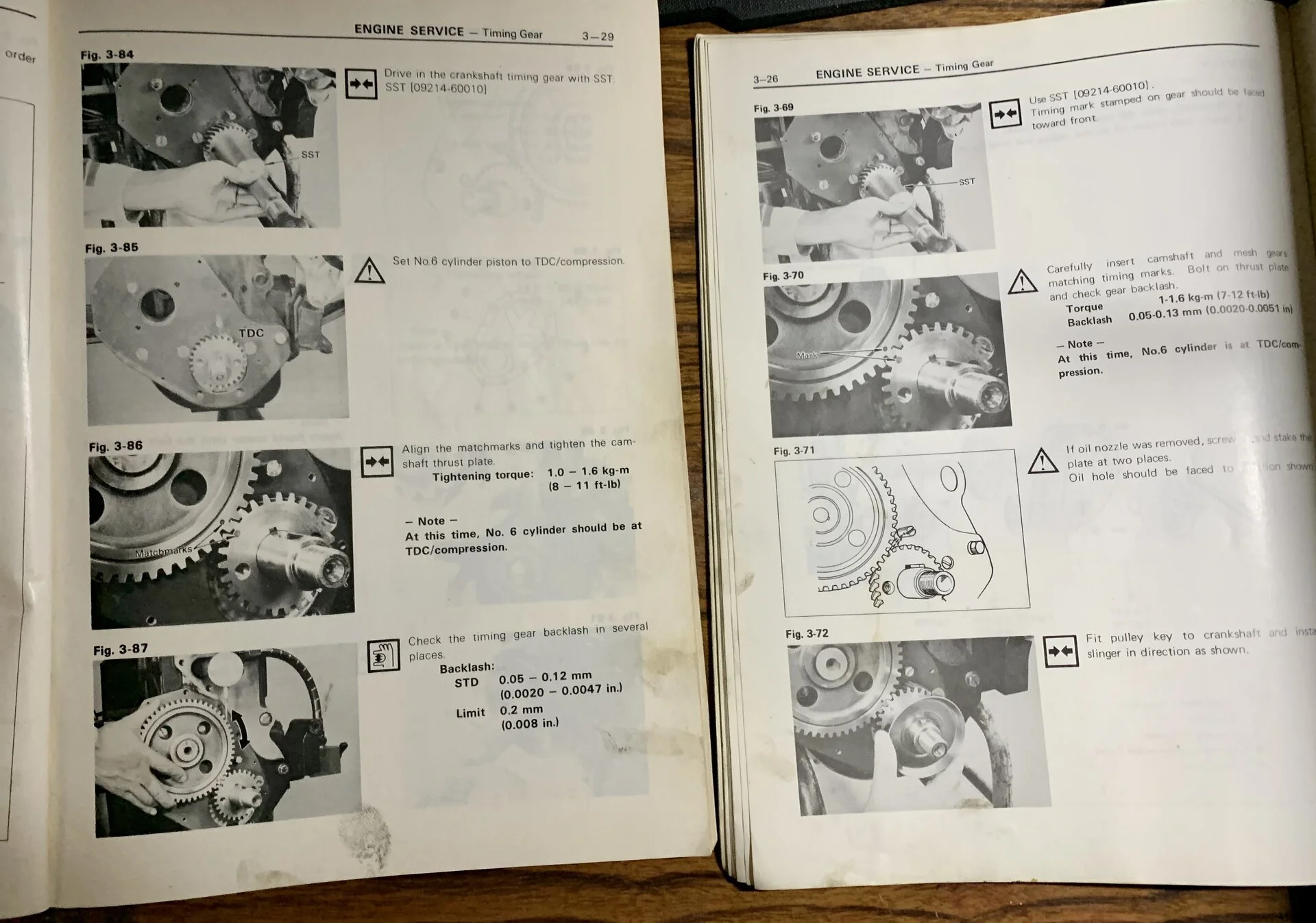

The grey early 2F FSM 1st gen. Makes NO reference to staking the V-heads with a drift punch …
The tan 2nd gen. One does and also shows a step by step picture-gram of sorts too !
I have takin this example of coming to a Timing Cover gasket gun fight with an added Secert weapon and solid good example of another refinement up in clarity too !
This is a 1984 3F FSM , look at how TOYOTA really emphisizes the liquid sealer on bolts and staking the now updated TORX V-HEAD machine screws holding the flat timing cover plate too !

Having both 2F grey and Tan is an absolute , and job scope end product results show me this is the way …
