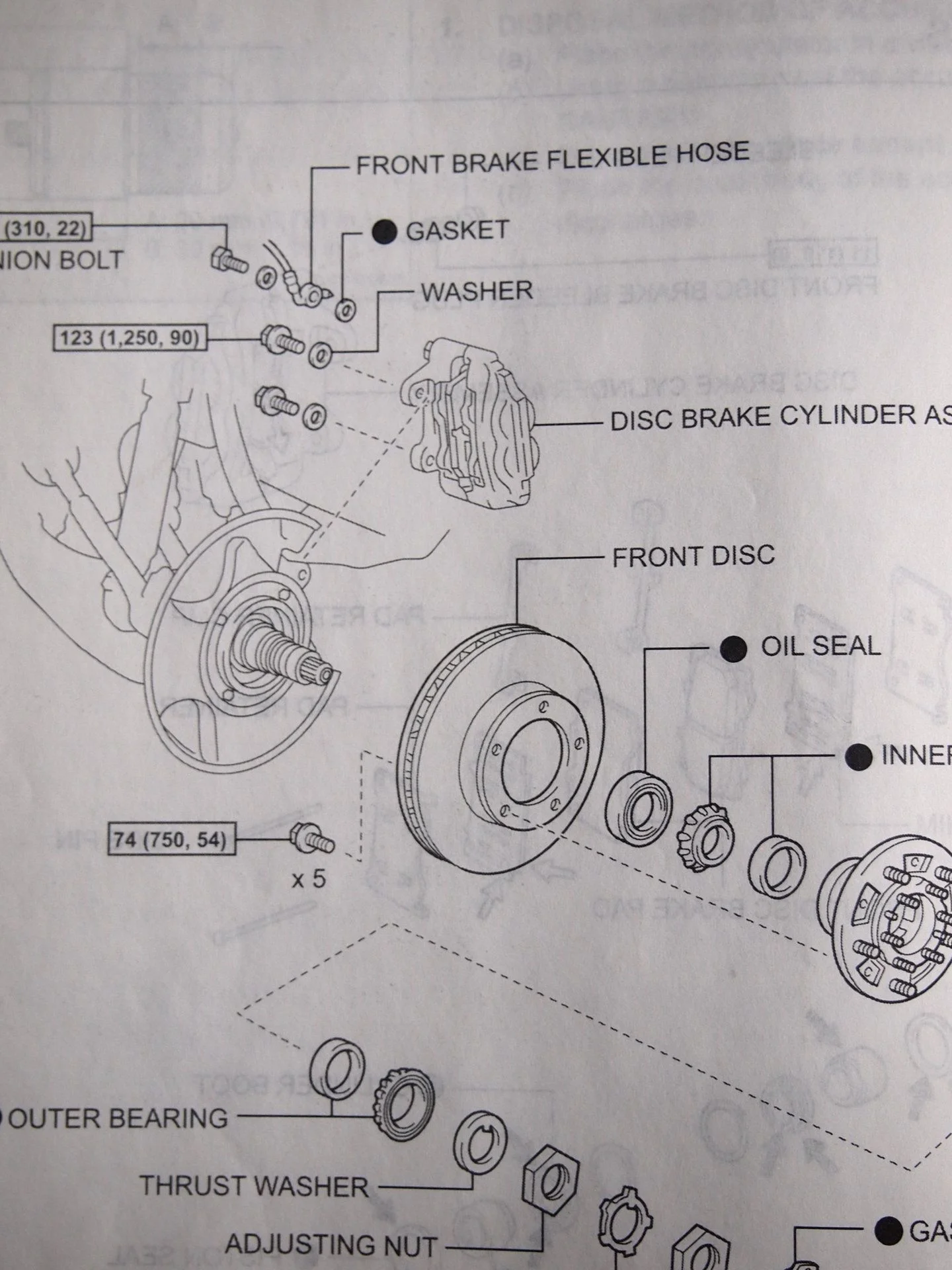

Not to detract from the timing belt stuff, but I’ve always put a dab of blue locktite on caliper mounting bolts. Yet to have one back out on me. However, I do think threads get stretched, so I reuse bolts and add blue locktite on first caliper removal job, then get new bolts and add blue locktite on second caliper removal job. Whether that be for wheel bearings or whatever, I replace caliper bolts on #2, #4, etc removal.
Whereas caliper is not specific to this thread, it is dealing with cause of this entire issue; Torquing bolts! "Caliper mounting bolts", replace every other time the bolt removed and use a thread sealer. Sound like a good procedure. One I'm going to adopted along with marking torqued bolts of consequence.

Brake Caliper mounting bolts:
Factory Service Manual (FSM)

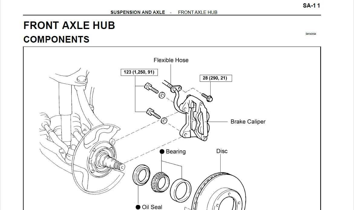

I've been rooting around FSMs from 2000 thru 2010. From 00-07 they do not recommend thread sealer on or replacement of, caliper mounting bolts anywhere I've seen. They simple give a torque just as they do for CAM bolt. Every bolt on the 100 series as a torque spec and some bolts and nuts have spec to reuse like head bolt, non reusable or pre-coated or call for a thread sealer. I'm a big stickler for following the FSM to the letter. But I've found many misprints, some wrong procedures and some stuff we need to do that is not in the FSM or that Toyota subsequently change their position on..
In 2008 (200 series) is first mention of caliper bolt being non reusable. I did not see (did I miss) anywhere FSM states pre-coated or thread sealer.
I've not been adding thread locker. Some may say; "we'll why not". Well, whenever a thread is lubed, be it thread locker, anti seize, oil, grease, wax, etc torque should be reduced. I get that info from Denso dealing with spark plugs.

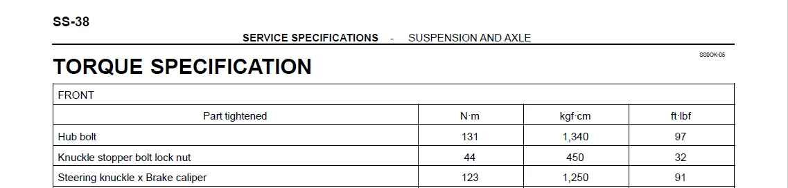

Most everyone feels Toyota uses a very lite torque spec, as it is! So if were going to replace the caliper bolt. Over torquing, due to lubing threads should not matter. But I did see a lower torque in the 200 series of 73ft-lbf vs our 90ft-lbf in the 100 series for front caliper (which are bigger calipers) and no lube or pre-coated statements. But bolt for 200 series may be pre-coated see the red:
That said, Toyota 2008 200 series they change recommendation to non reusable Caliper bolt. Given the statements we've seen in the 100 series tech section of mud, on them coming loose. I feel and alert to mud is called for. This thread will just not bring the attention to the issue of caliper bolts.
