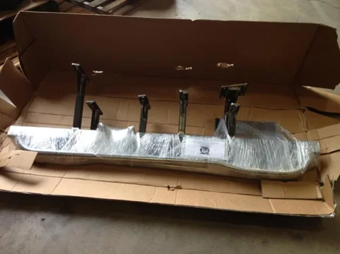

Are you interested in painting a second set? These babies just showed up today!!
Nice. If you weren't all the way in east TN, I'd be glad to keep my paint fume buzz going for another day or two.
They are hella heavy to manhandle. The Cat protection looks solid. I used rustoleum etching primer and one big (14 oz) can of gloss black per slider. Make sure to get some thinner or something and wipe all the mill scale off so the paint will stick. Just a quick tip, if you are working on the ground like I was, I used a block of 4x4 to prop the short leg up to make it easier to get to the underside to paint.
