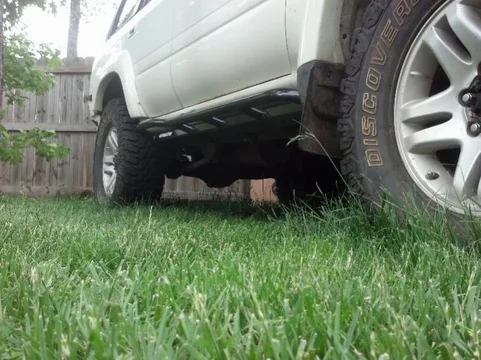

Sliders are on. Took me awhile to get the DS on because of working around the cats. Very solid. About 4 hours and I learned that new cats are very high on the list after GSMTR. Also need some taller front springs or some spacers, the stink bug is getting more pronounced the more weight I add.

Looking good!!! You'll probably get more feedback in the 80 section.

Looks sweet man, now stop working on your truck & cut your grass!

**** good lookin sliders- yes the cats are a PIA to work around.
We'll have to get together at GSMTR-
Thanks and Just a word of advice, if you have a thread chase set, chase the 4 bolt-holes in the frame before you try to install the supplied bolts.
I spent like 2 hours trying to get mine chased out, 8x1.25 chase, and I was cusing ALOT, but when time came to bolt it up, the bolts went right in quick and easy. Made me feel all the fighting and cusing was well worth it.

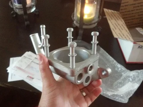

My boy came thru, looks like I need to make sure I put some good anti-seize on the bolts and get this monster back together.
SEXY!!!!
