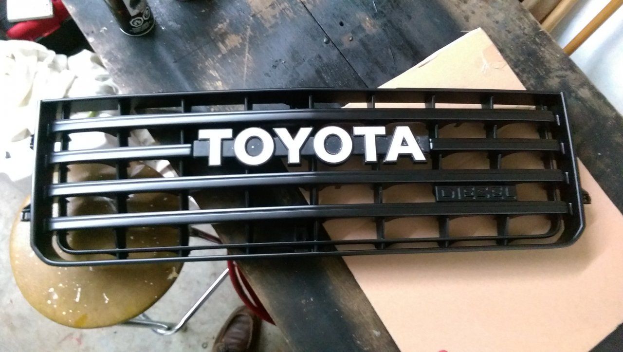

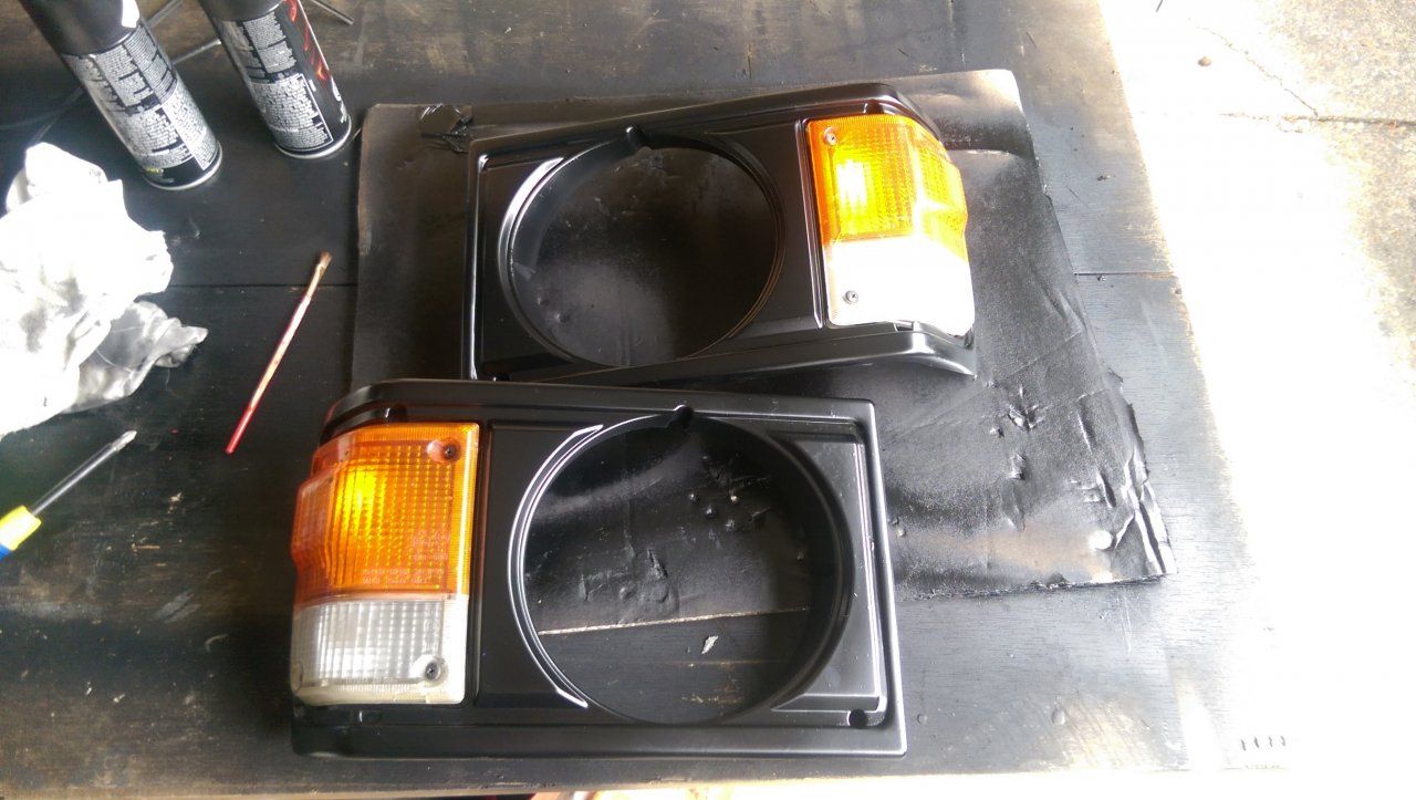

I think everyone has seen it since I painted the grill but here are some pictures anyways!
Cleaned all the parts with Simple Green Degreaser, then a quick sand to rough up the surface followed by a wipe with Methyl Hydrate. Picked up some plastic primer to seem legit before laying a couple coats of VHT Chassis and Rollbar paint on. I use the VHT on everything, bumpers, sliders, any blacking out i do. keep it consistent.
