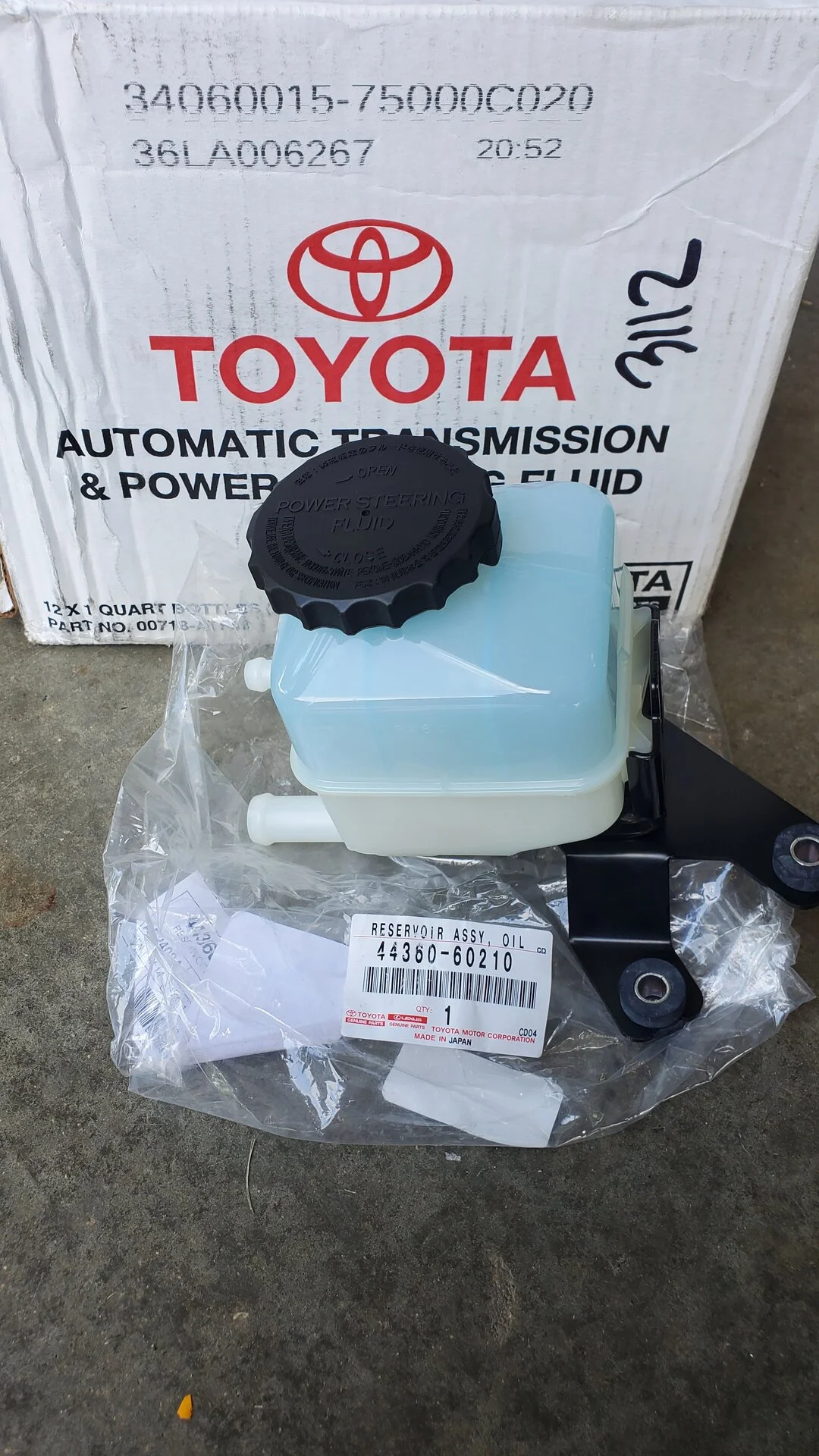

My PS pump was still screaming, so I tried to take off the reservoir and clean the filter. Well, it was badly gunked up so I ended up getting a new reservoir and flushing almost 4 quarts of Toyota ATF, using @2001LC method. It is nice and quiet now!
I prefer Mobil 1 ATF over OEM ATF, but either work fine.
