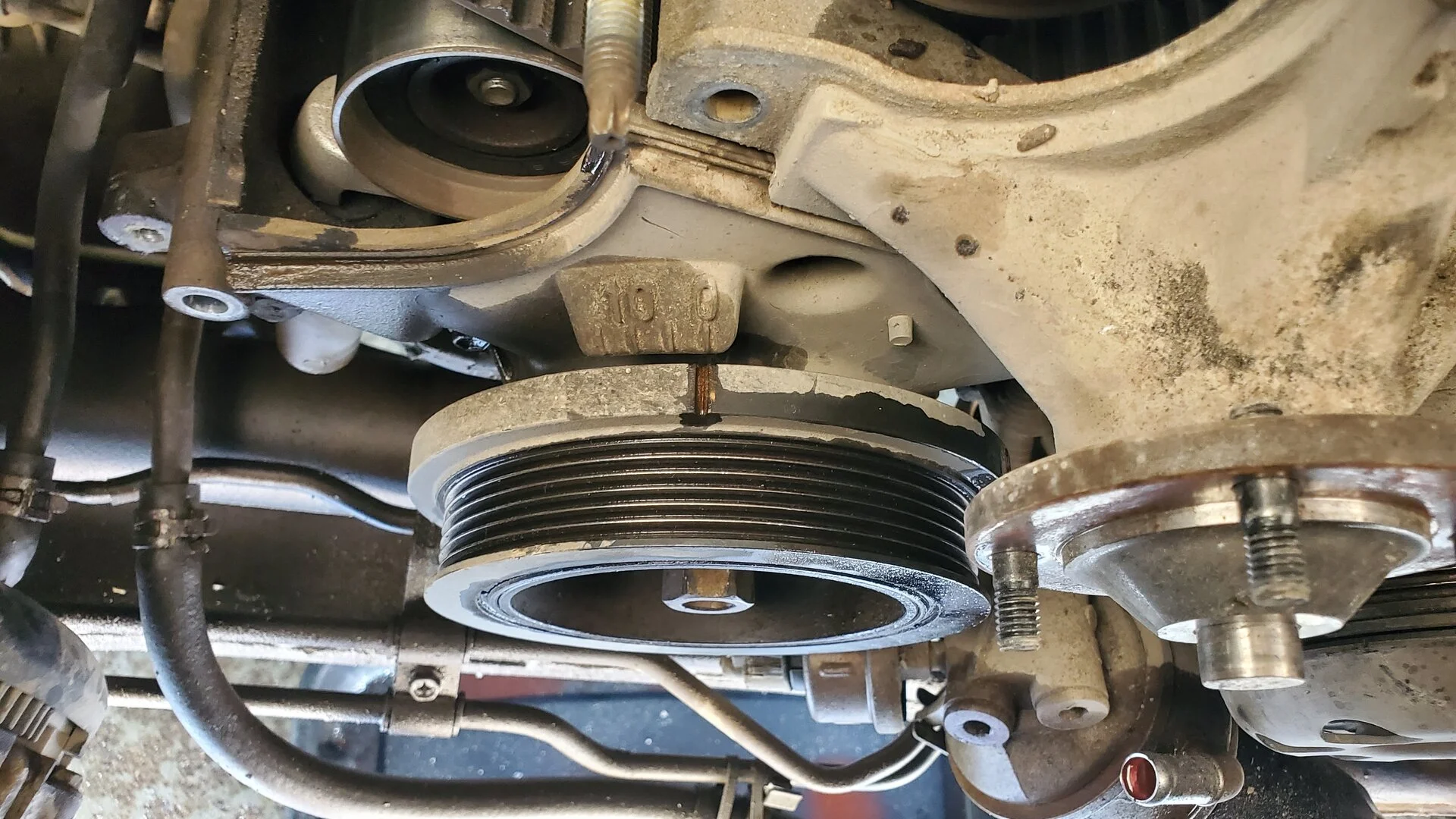

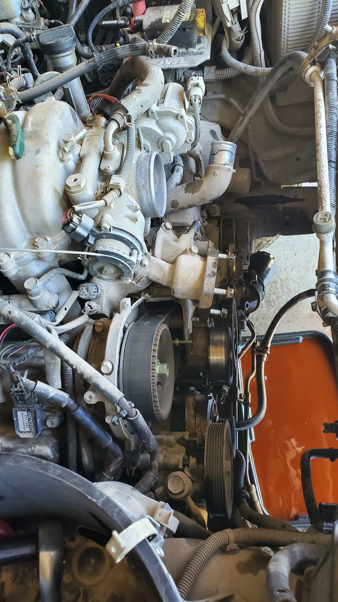

Since the truck will be out of service until the new globes show up, I decided to start the timing belt job.
Spent about an hour draining the coolant and taking off some parts - still a lot to do!
So far I have been pleasantly surprised how easily everything has come apart. All the bolt had thread locker on them and so nothing was found cross threaded. Looks like the last person that did the TB job knew what they were doing :clap:
Using a chain wrench to hold the main driver pulley while loosening the main bolt works best in my experience. Don't forget to cover the pulley grooves with a piece of v belt!
Thanks @2001LC for sharing this trick
