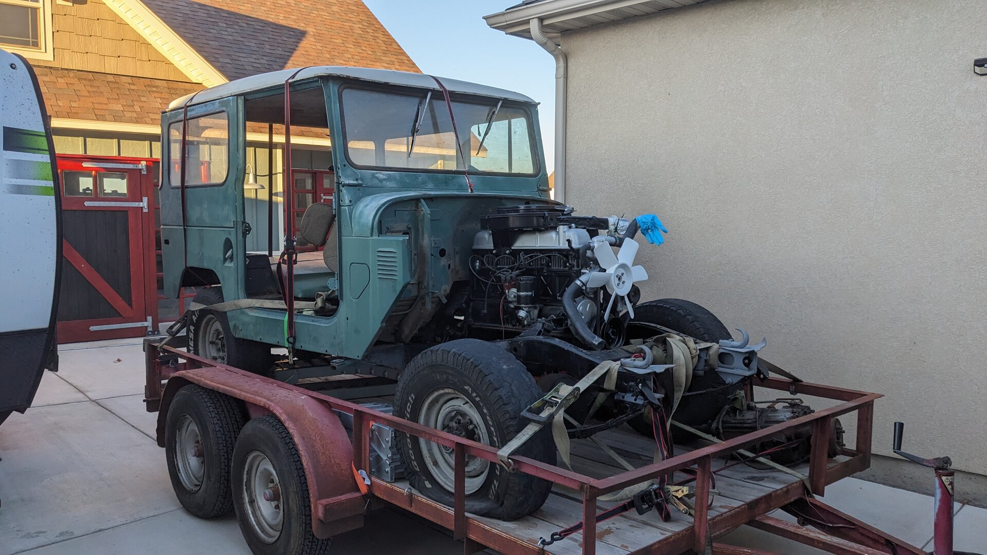

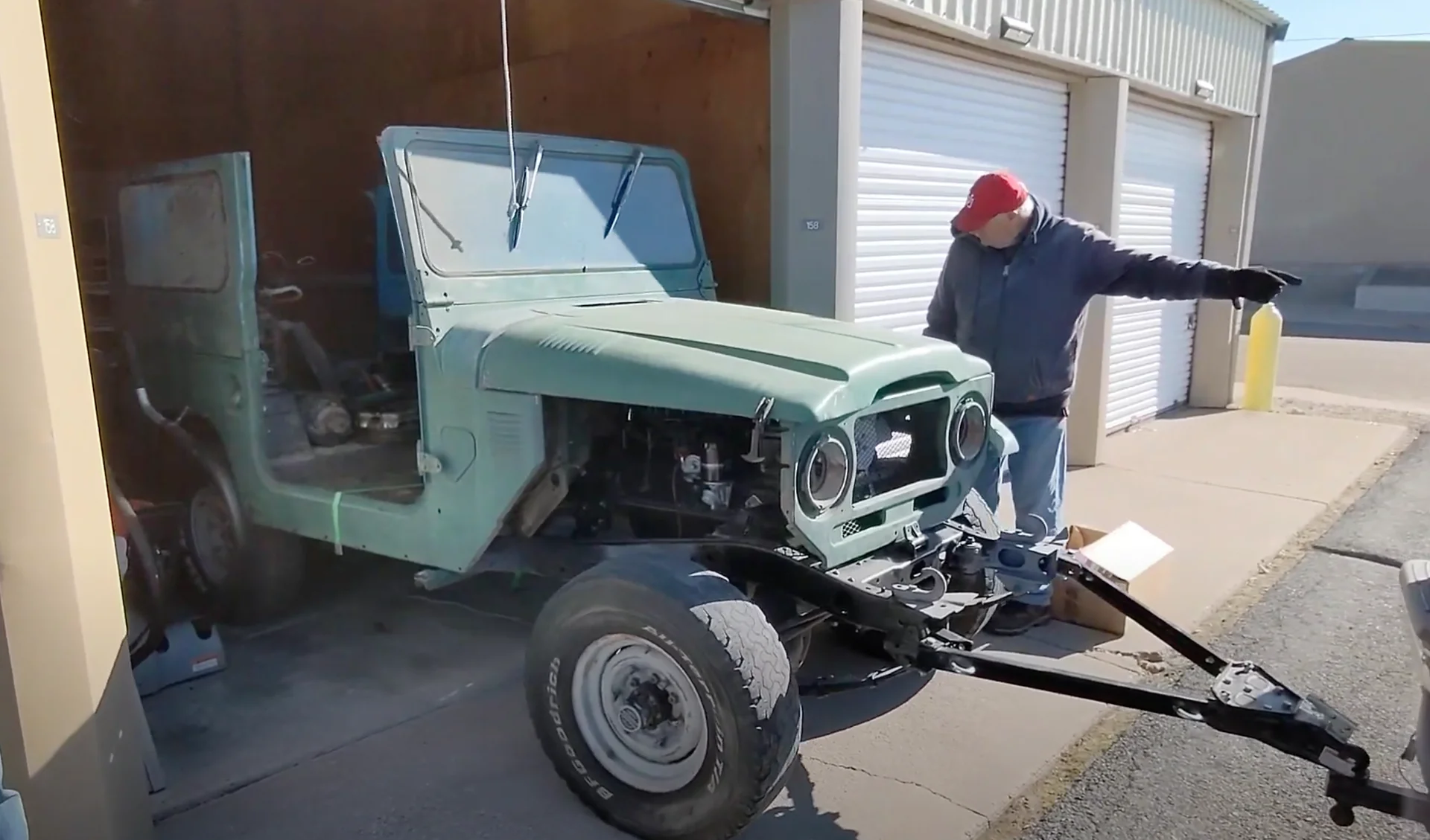

I've been over on the 80 Series Forum for the last 12 years, but was always wondering what ya'll were doing over here. Well, now finally get to find out! I just picked up this 1972 FJ40. I guess you could call it a storage-unit find. The PO tore into it well over a decade ago, built the engine (a 2F) and that's as far as it got. PO said he put a "mild RV Cam" in it, but I'm kinda dumb when it comes to technical motor stuff and not sure what that really means in terms of performance. Will have to dig into that. So I've got a strapped together 40, and a truck bed full of parts that I'll be needing lots of help with figuring out where everything goes. It came with the original 3-speed and another 4 speed that was thrown in with the deal. First order of business is to get a full bolt kit ordered and get the passenger front tire to stay inflated so I can roll it. I'll be using this as my build thread. Looking forward to meeting fellow 40 series Cruiser Heads!

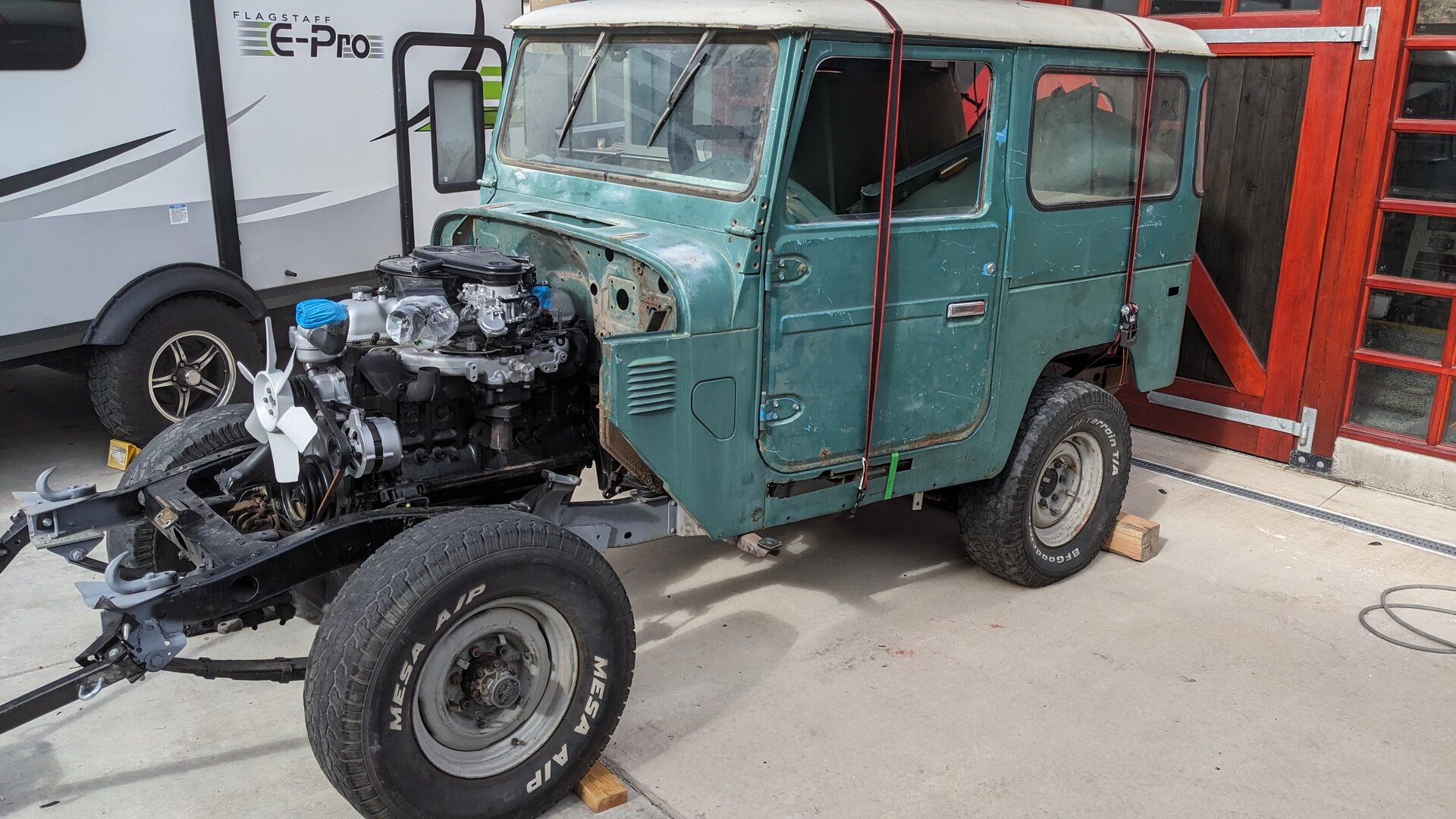

So what I quickly realized here is that I've bought a Frankenforty. The blue paint inside the top, side doors and ambulance doors should have been the dead giveaway, and I knew they were from some other vehicle, but didn't realize that they are not 1972 correct. I already knew the 2F was not 1972 correct either, so this was never going to be a complete restoration, but I did want to keep it on the resto side of restomod. I think at this point going back to 72' doors and top is not economical, plus looking around there seems to be a lot more aftermarket support for the later models. I have a lot of cleaning up from the P.O. with what they did to the fame, etc. as it is. I guess my biggest worry is if this thing is going to look stupid or not. I know to the general public they won't be able to tell the difference, but am I going to get laughed at for having 1972 blinkers, windshield wipers etc, and later model pretty much everything else? What kind of things are faux pas when mixing/matching different year stuff on these 40s?
These trucks are like Legos. You can easily mix and match parts with a touch of fabrication. This one looks like someone has played this game. Would it bother me? No, but I not a purist. Especially if the mods are properly done. Will the purist turn their nose up? Perhaps. Should you care? Not if it puts a smile on your face.
Laughed at? No, especially since you are declaring it up front. I say build with what you got and get familiar with FJ40s. It will become clear as you go if you need to or decide you want to go all same year.

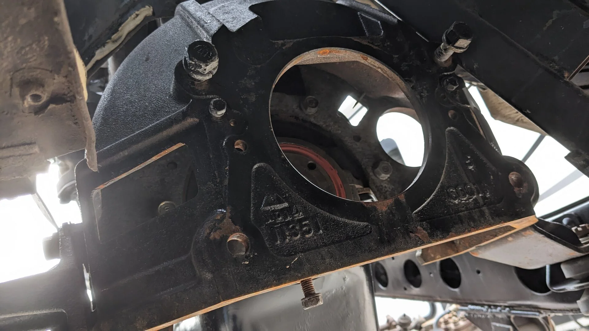

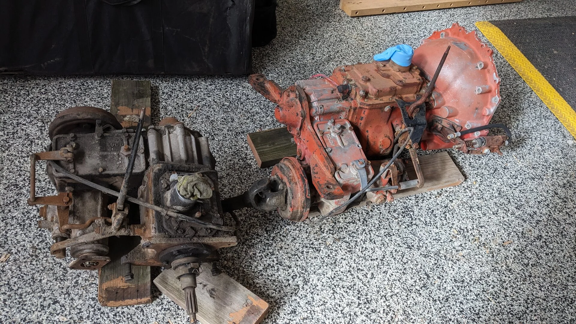

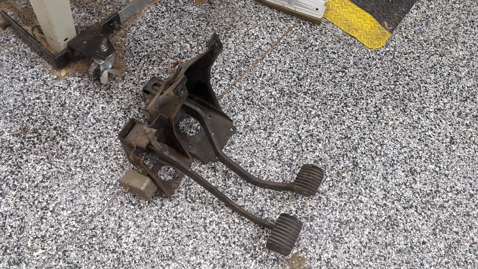

I have the original 3-speed transmission, and the bellhousing for it is already on the 2F. The Seller also threw in a 4-speed with a Downey universal SB bellhousing. What I want to do is put a H55F in this because I want to be able to go down the highway to my fishing spots without getting rear ended by an 18 wheeler. So I don't need any of these, but my question is will this 3 speed bellhousing mount to the H55F, or will I need a new bellhousing for that? Also, can this propeller type crossmember work with the split-case transfer case? Thank you!
What I need vs. what I've got.
Sherpa-
5speed on a split case is really a nice option. But, you have a 4speed already. You can swap out the 4:11 for 3:70 gears in the diffs and run a taller tire. I did this early on. I can tool along without breathing hard on all secondary roads, hold a steady 65-68 on the interstate (which Im very seldom on) and still climb like a goat. Just saying, if you want to “dance with what cha brung“ and use the savings for “other things” it’s an option.
Great score BTW. Following along. 🍺👈 :popcorn:
Sherpa-
Will it go down the road ok with the 2F, 4 speed, 3.70 gears and 33" tires?
I’m on a 76 2f, 3:70’s and 17” FJC steelies. 4spd, and 1 piece TCase. YRMV depending. It’s an option. Or, in certain circles, a “course of action”. 😎👈 I’m just offering this as a way to absorb some of the associated cost, and there’s going to be “associated cost”, to get mobile while diverting $$$ to other areas. You can even have that 3spd case turned into a 4 spd. If I understand it right, that would give you a lower 1st gear. Options…🤔
I do encourage you to do some research on the forum. You’ll hear + and - regardless of your choice. I love the straight up stock resto threads. I’m just not one to play “inside the box”. At the end of the day, it’s yours, and if you are leaning toward something other than “stock”, which I think you are, you have some “freedom of maneuver”.

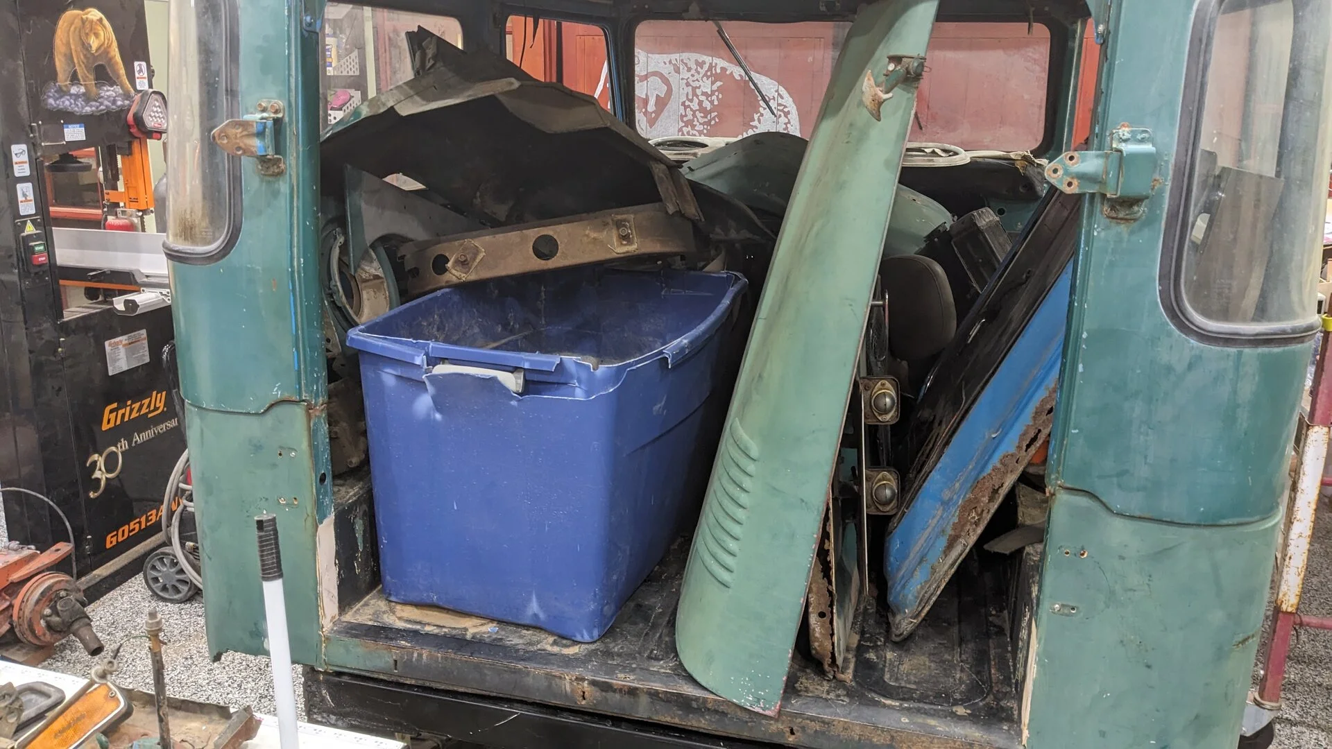

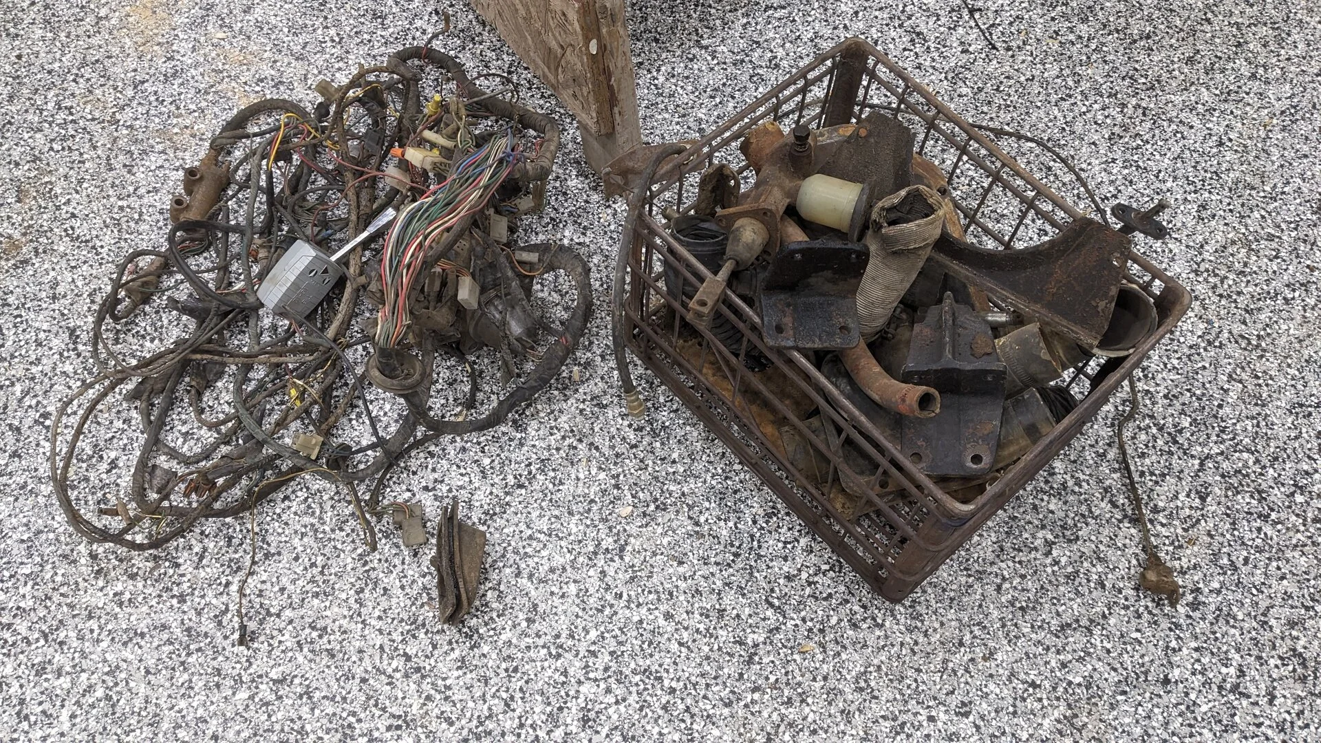

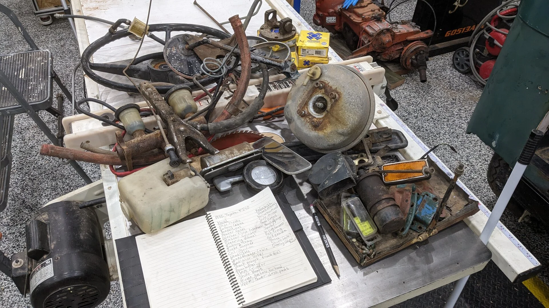

I went through the crates of parts given to me by the former owner and realized most this stuff is garbage. There's a few items worth refurbishing, but I think I'm looking at having to source mostly new or at least a lot better than what I've got parts. I also am realizing that there's a lot of missing stuff. Mainly dash knobs, glovebox lid, and other interior parts, and that's just the stuff I know I need. I'm sure there will be a ton of other stuff that I come across that is just MIA. I reached out to the previous owner asking him to look and see if there was a box that got forgotten, hopefully that is the case and I can get more of the parts. Feeling pretty low at this point and think maybe I should just try to find a more complete FJ40 parts vehicle, or use this one for parts, what's left of it anyway. Overall it seems the rebuilt 2F is the only great thing out of this deal.

is hitting me hard today.
Blank slate Brother. You the mini fridge and your imagination…Sure it might feel like the YODAVERSE kicked you dead square in the nads but, there are possibilities sitting in that pile…:popcorn::beer::cool:
Also, in addition to the sage advice above; I humbly suggest that you don't throw anything away for quite some time. What looks like complete garbage may eventually be some rare nugget that is unobtainable that you really need.
Don't get down on your find just yet! I see a lot of good stuff there that should not be thrown away. This is definitely not a parts rig...more of a rigs worth of parts. The body looks pretty darn good and that's a relief in itself.
I am also assembling one from tubs and totes given up on long ago. I live over in Alpine if you need any help.

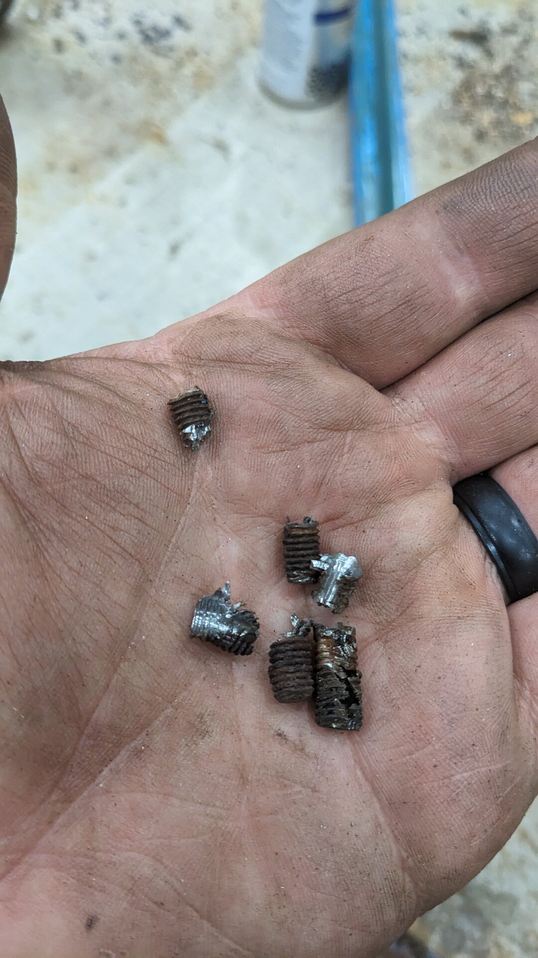

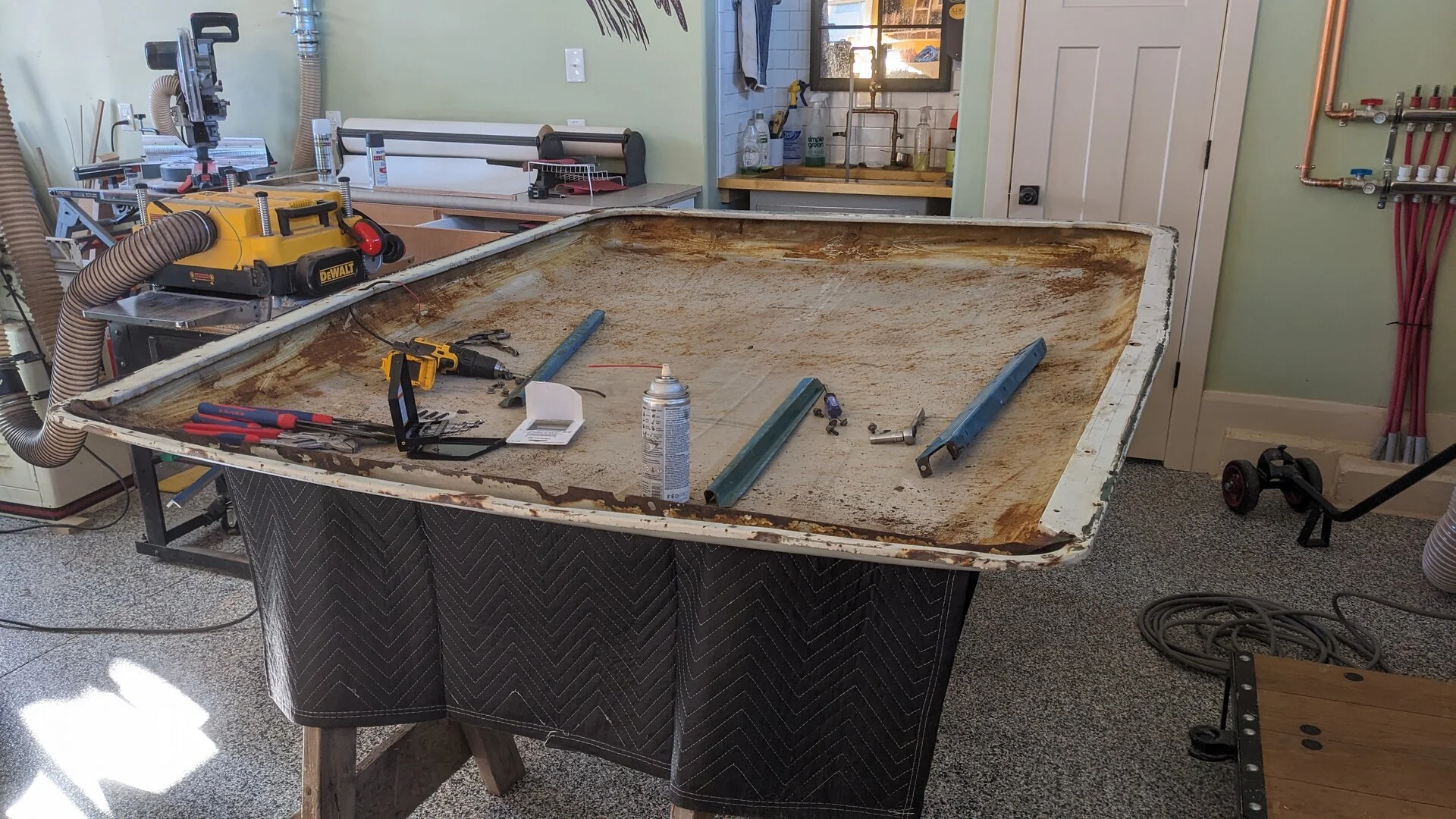

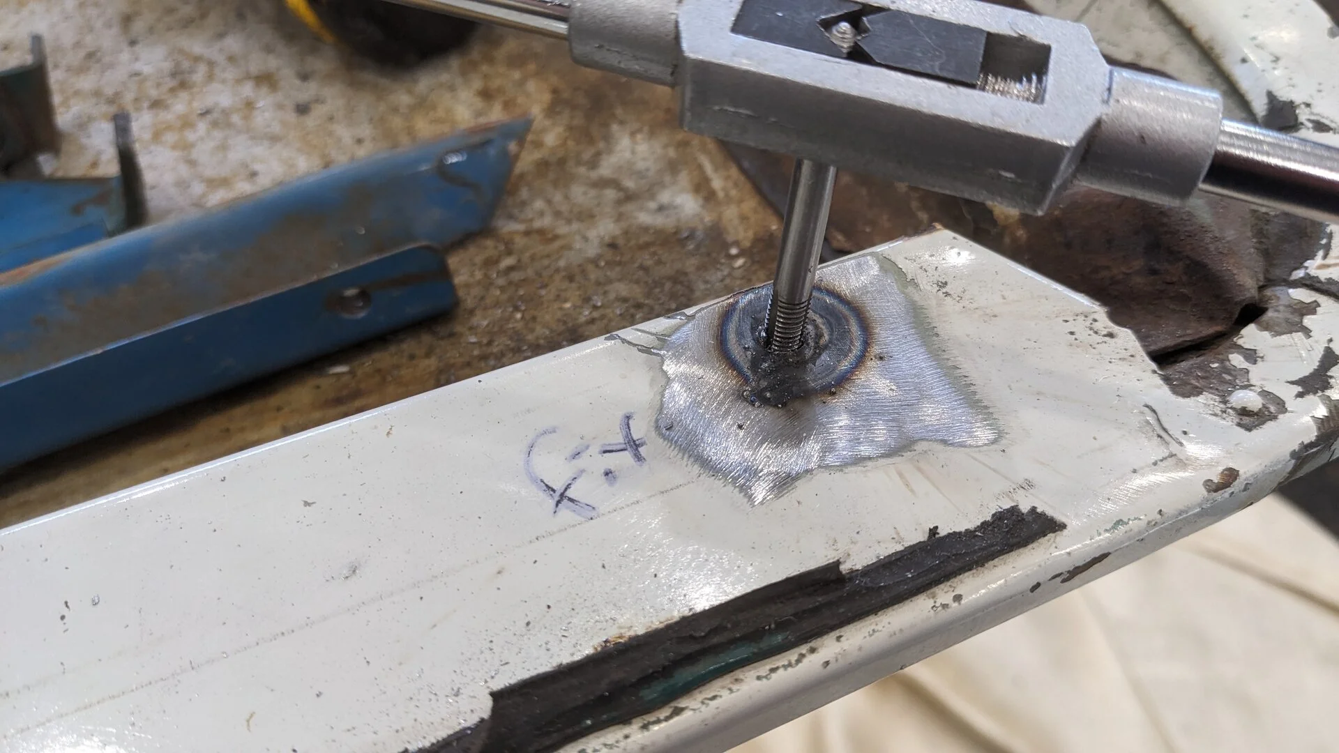

Gotta start somewhere. Whoever took the top apart broke nearly all the bolt heads off. In their defense they do look pretty corroded. So got going on removing a lot of broken bolts. Some came out with vice grips, many didn't. I had to drill those out and re-thread them. Some were too far gone and I had to weld the hole and completely drill a new hole and re tap the threads. Got them all done now, and at least can start putting the top back together. I also ordered the SS hardtop hardware package from Overland Metric. Was a bit disappointed though that apparently that hardware kit is for later model hardtops, so it's missing a few bolts that the earlier models require, which sucks after spending almost $50 on bolts.

Try to abate any rust as you reassemble like on the rain gutter.
