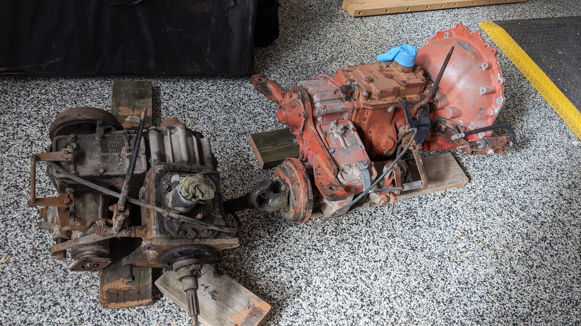

What I need vs. what I've got.

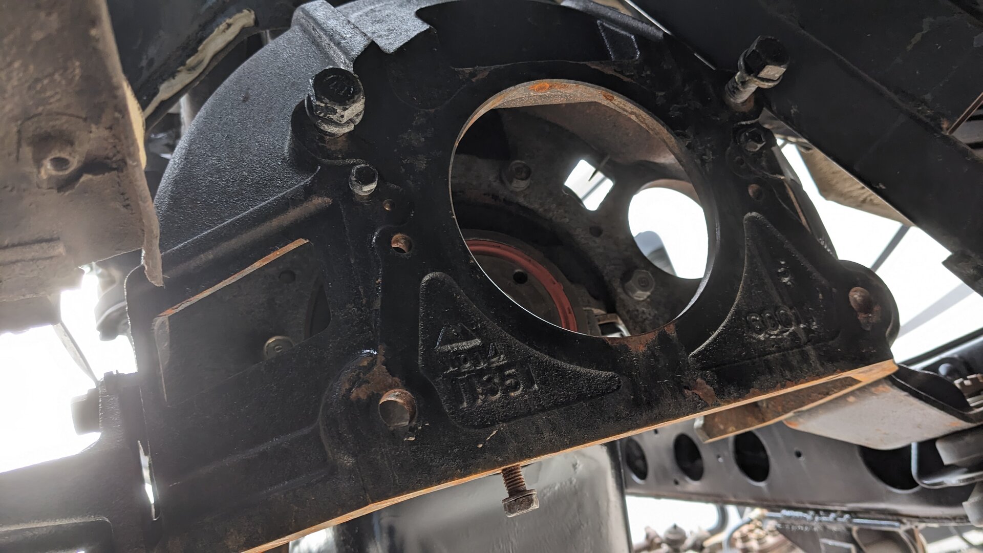

I have the original 3-speed transmission, and the bellhousing for it is already on the 2F. The Seller also threw in a 4-speed with a Downey universal SB bellhousing. What I want to do is put a H55F in this because I want to be able to go down the highway to my fishing spots without getting rear ended by an 18 wheeler. So I don't need any of these, but my question is will this 3 speed bellhousing mount to the H55F, or will I need a new bellhousing for that? Also, can this propeller type crossmember work with the split-case transfer case? Thank you!
The H55F has a different bearing cover that is more hour glass shaped. A 3F or 2F bell housing will bolt up to a H55F. The 2F needs a little work with a die grinder for the bearing oil galleys. The 3F bell housing also cants the transmission a few degrees lowering the outputs of the TC.

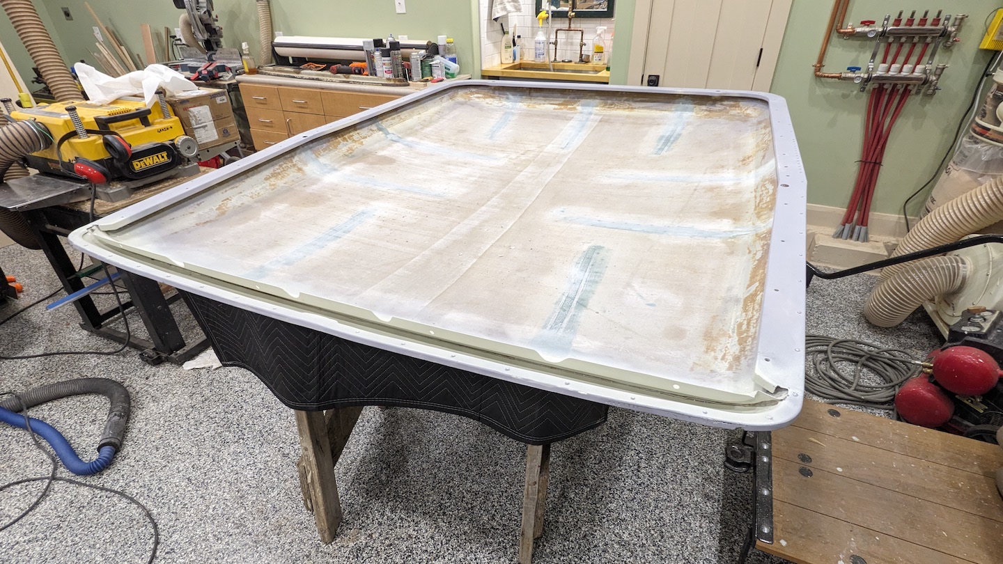

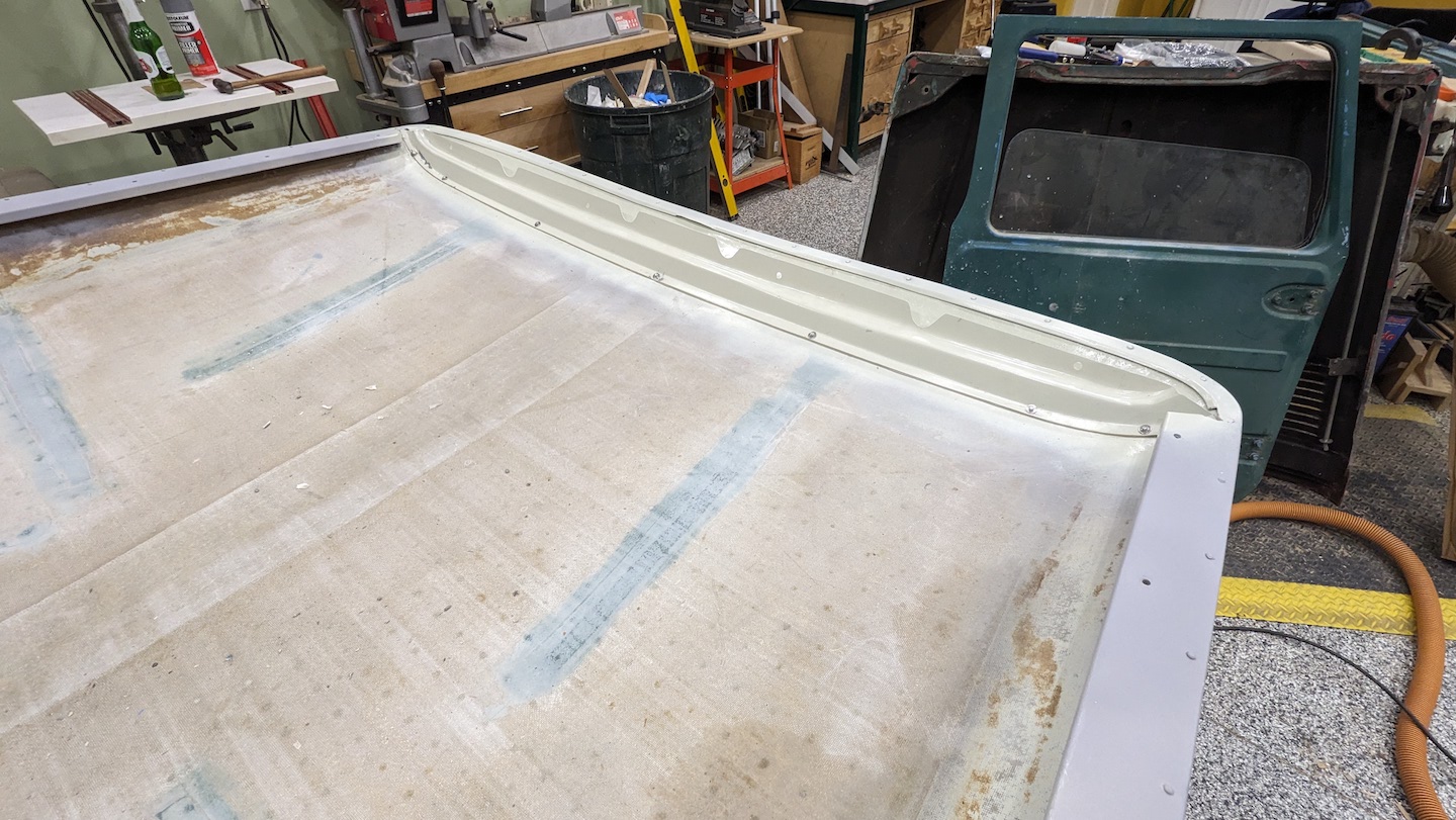

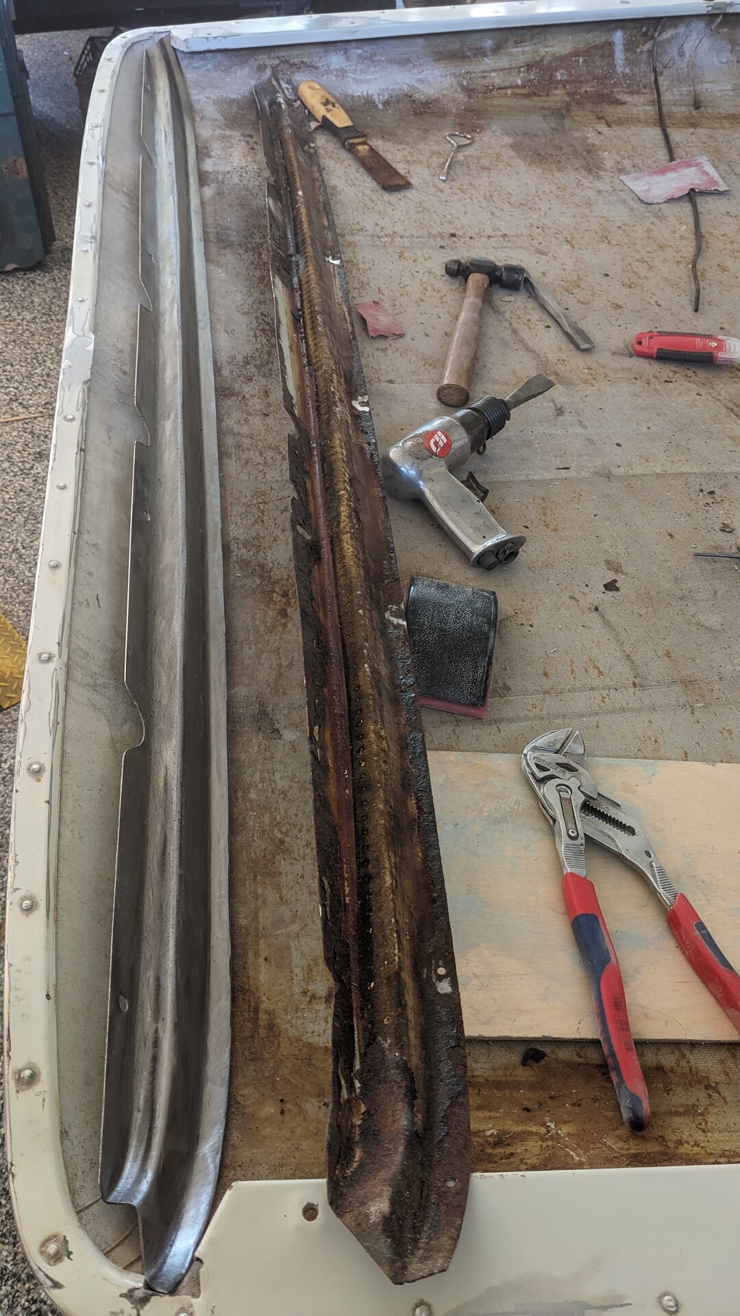

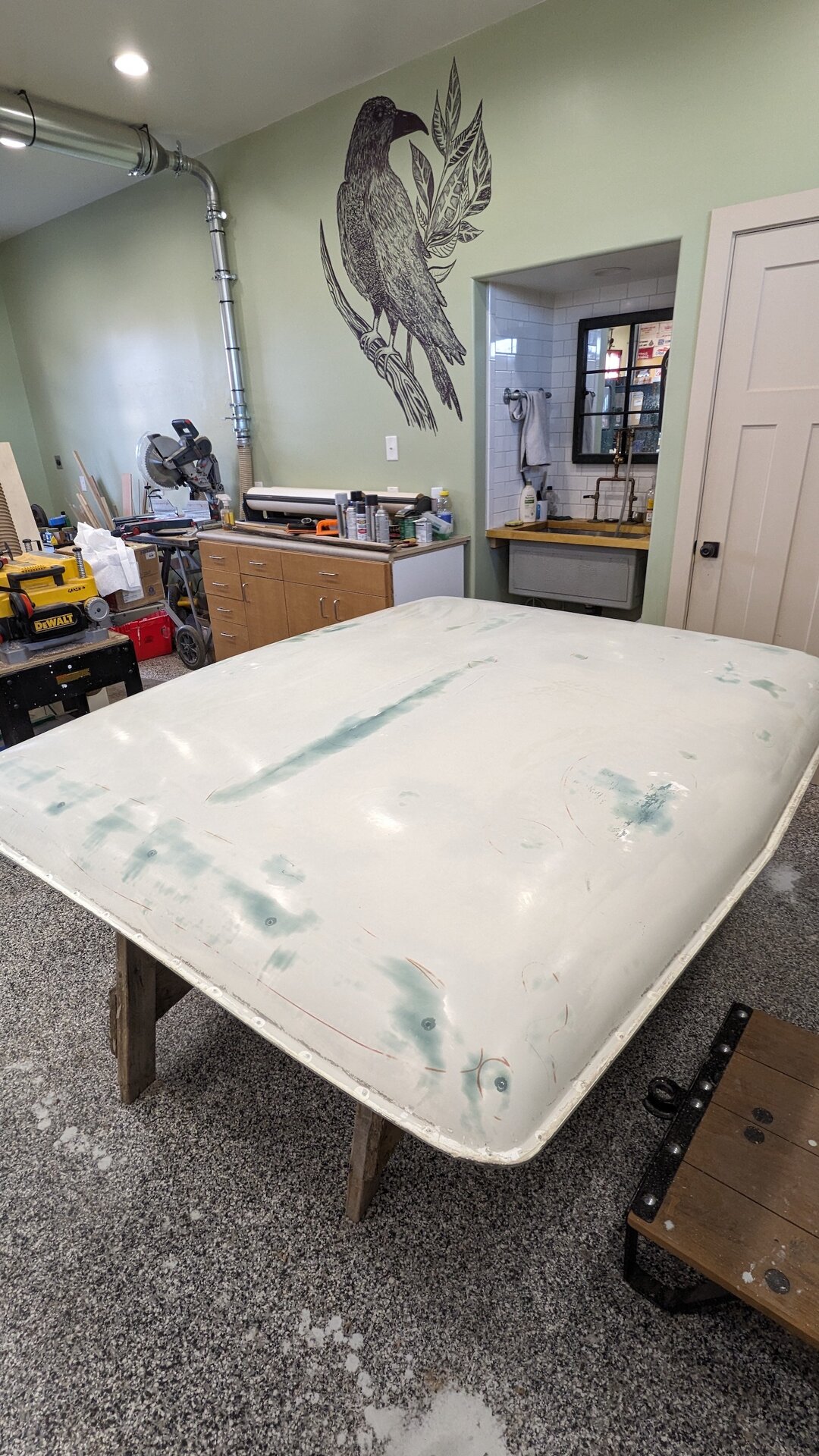

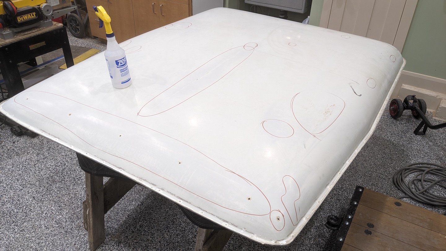

The work on the top continues. Got the gutter removed and the old seam sealer cleaned up. Also repaired some fiberglass damage with West System epoxy (marine epoxy made for fiberglass) and some fiberglass filler. Next up is fixing up the gutter. I was hesitant to remove it, but now that it's off I'm glad I did. It's worse than I suspected with surface rust, but should clean up nice.
Built some dollies for the frame and got the frame put on them. Now I can start working on the thing without breaking my back. Also got the rain gutter blasted...some before and after photos...
