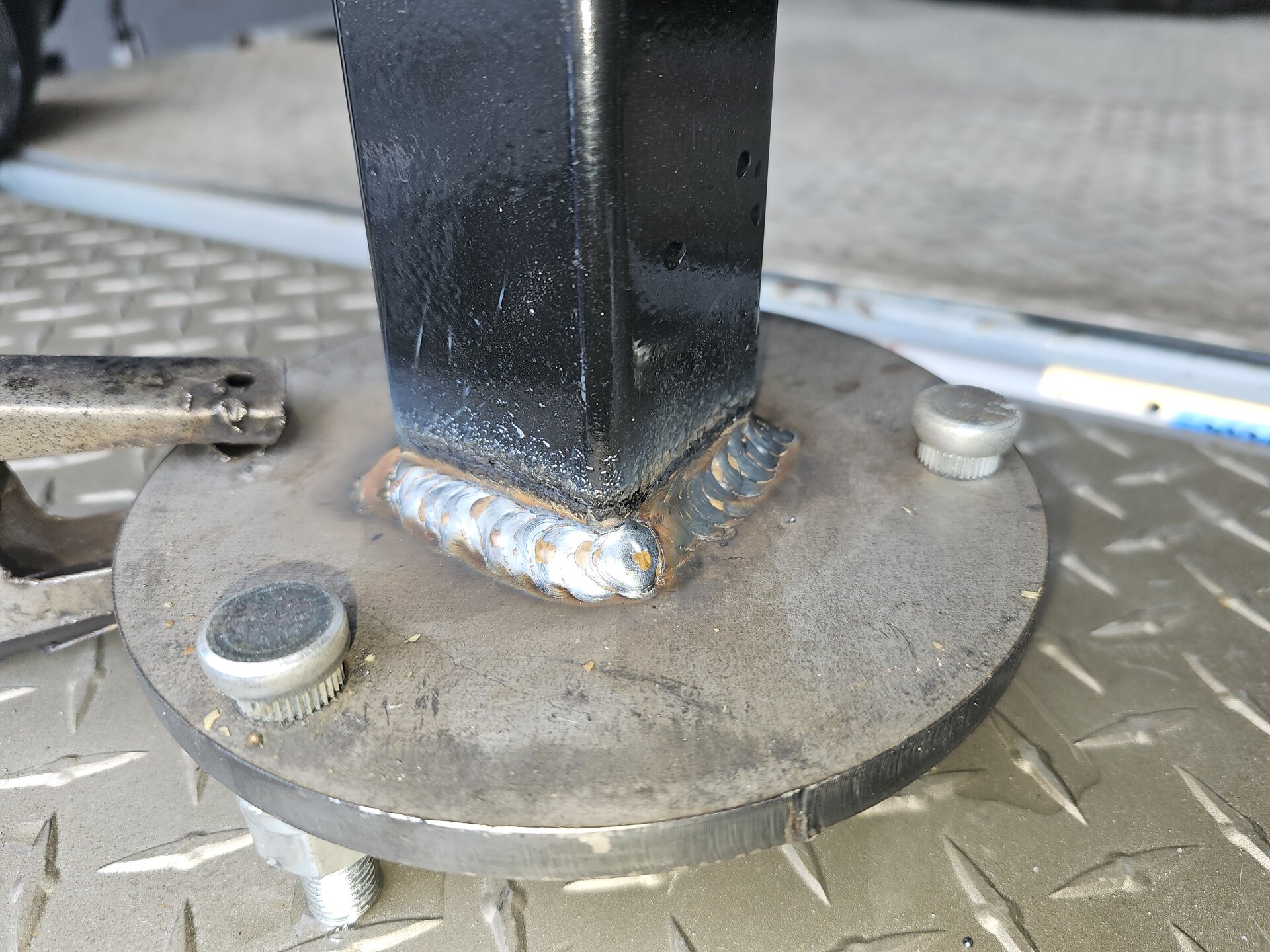

Collected scraps of metal from around the shop and decided to build a spare tire carrier to mount inside the bed. I wanted to make it easily removable if I needed an empty bed for hauling stuff. I wanted something modular so that I would be able to mount different items depending on use. First I had to have a crossbar which will be the mounting points for all attachments. I drilled than welded in nuts to both sides of the bed rails and main hoop. Then used angled steel and gussets to bolt from one side to the other.
After a million measurements and testing a billion angles this is what I came up with.
Here it is after it was all painted. The tire doesn't touch the cab or bottom of the bed. It's free floating and can be removed with two nuts that connect to a crossbar.

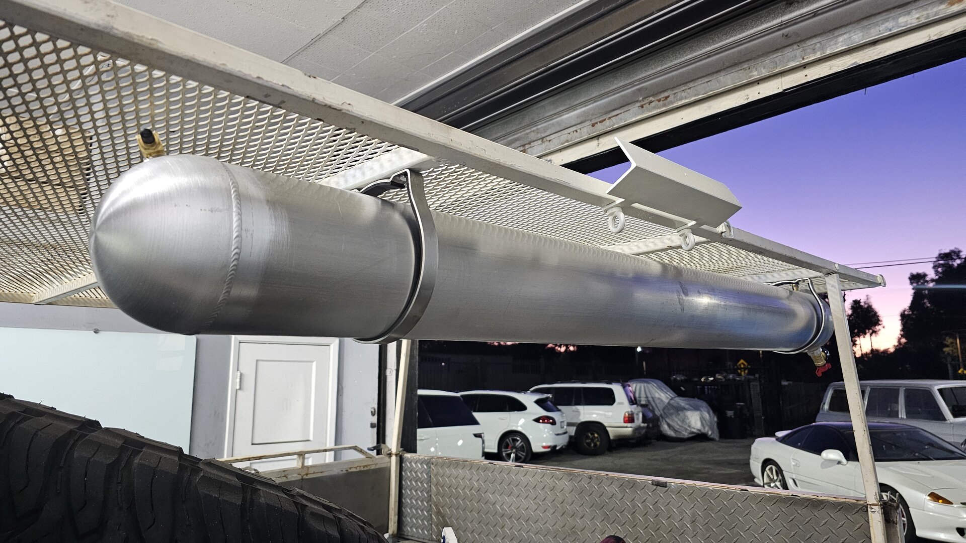

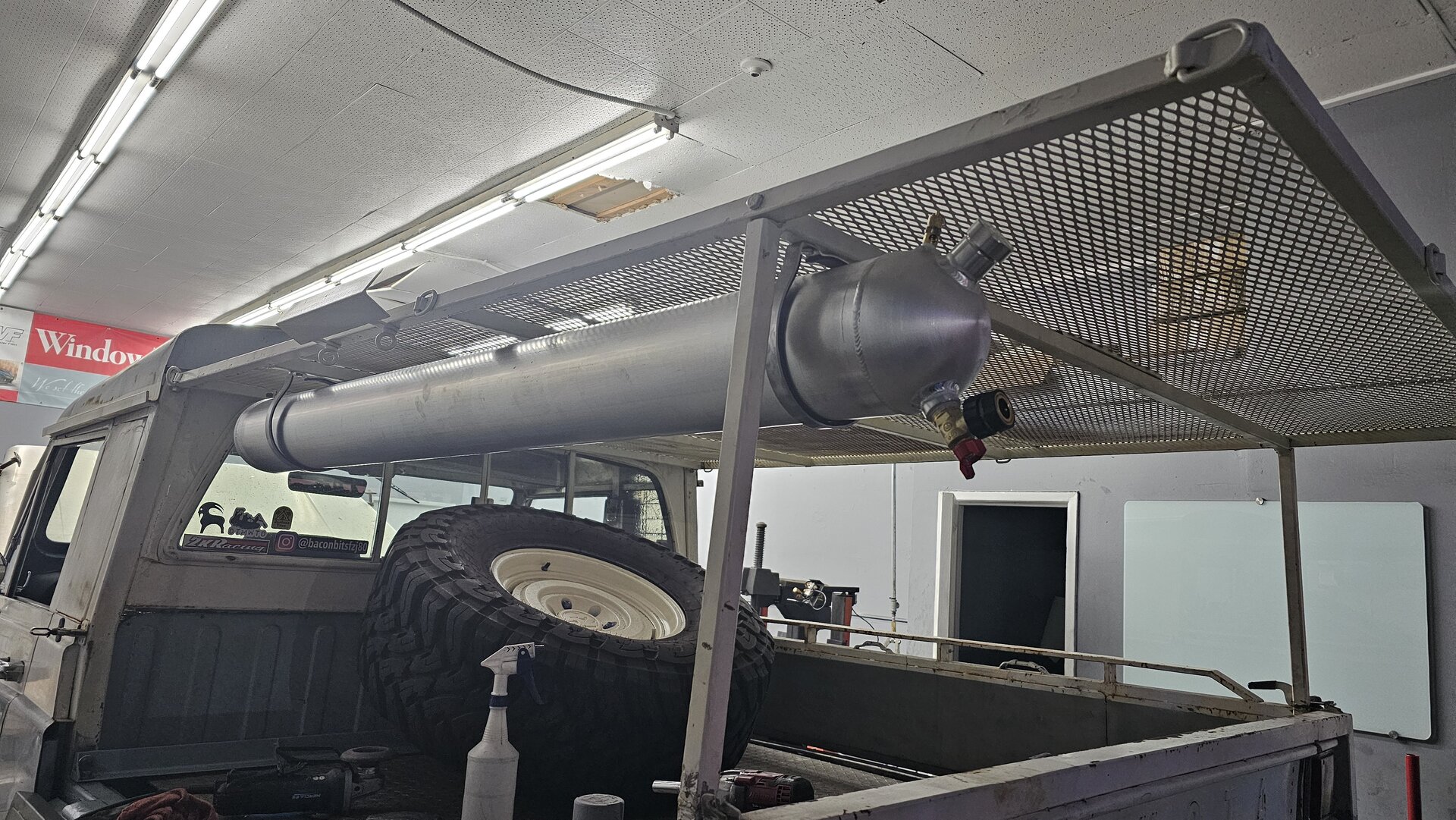

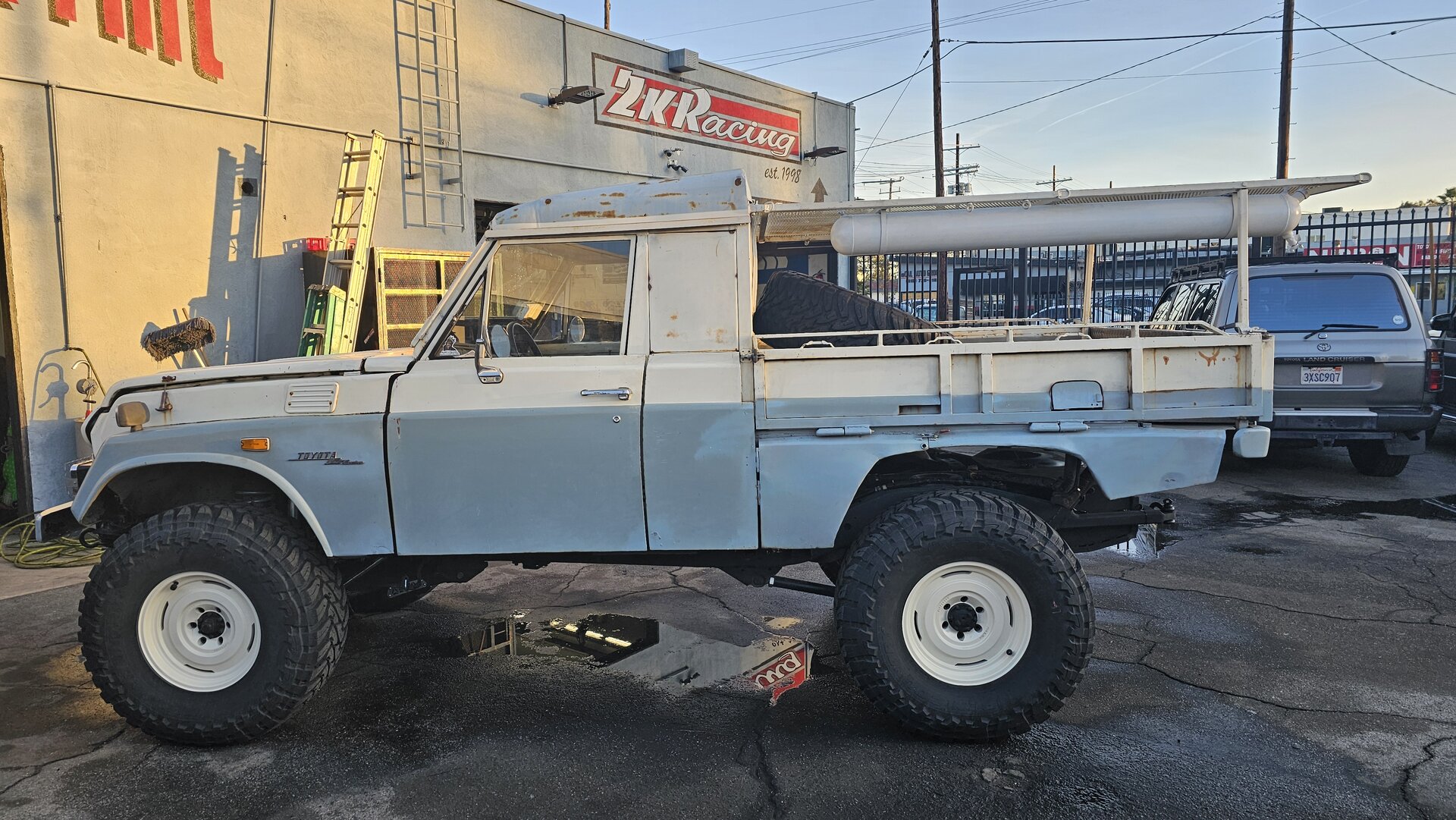

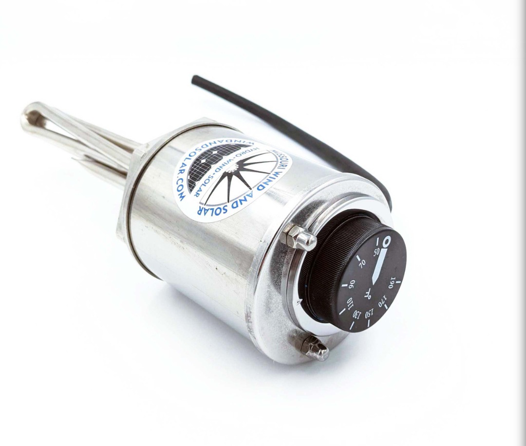

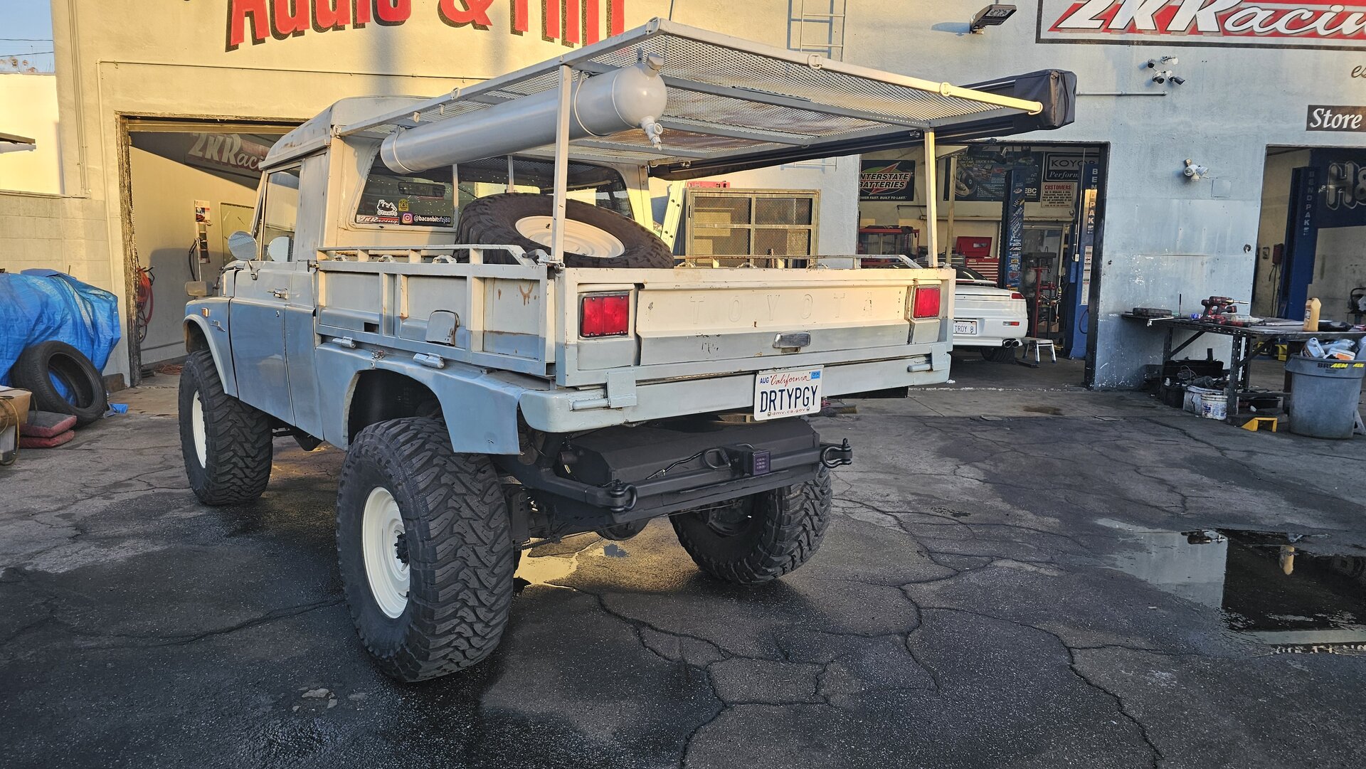

Next little add on resembles what most land cruisers in the middle east have. Unfortunately being in CA I have to settle for a water storage tank shaped like one. Its an 8 gallon tank that can be pressurized to 50psi. I will also be adding a 12v heating element that is adjustable which is pretty cool or should I say hot.

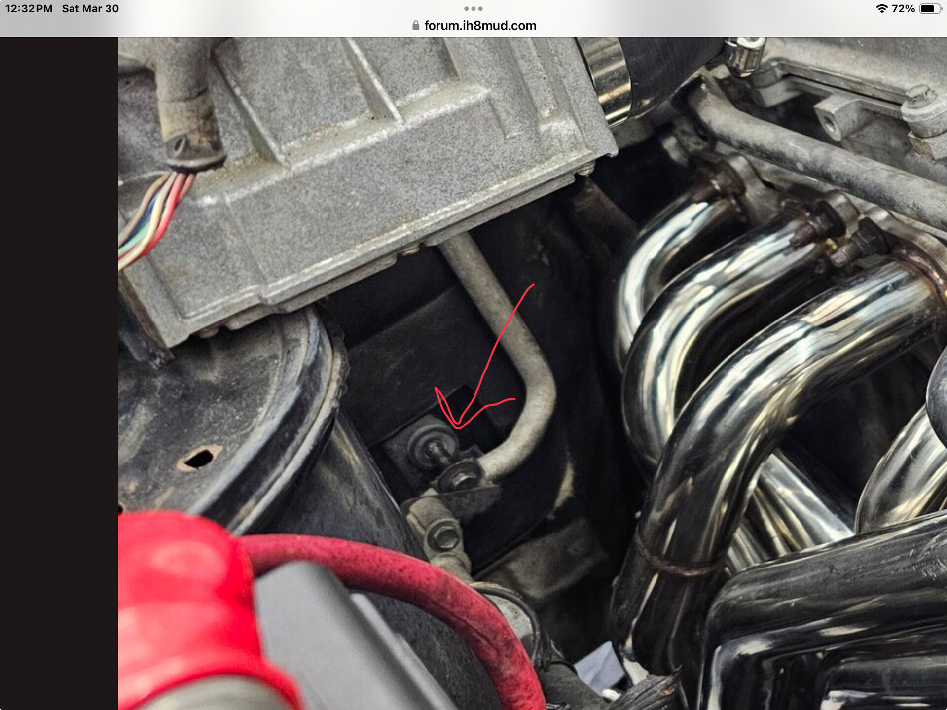

Went to grab some parts for a customer from Specter Offroad. Decided to take Bacon to test out the new headers, EGR delete, Rear Heater Delete. Happy to report no leaks. Just a tad bit louder than factory, but definitely a deeper tone.
