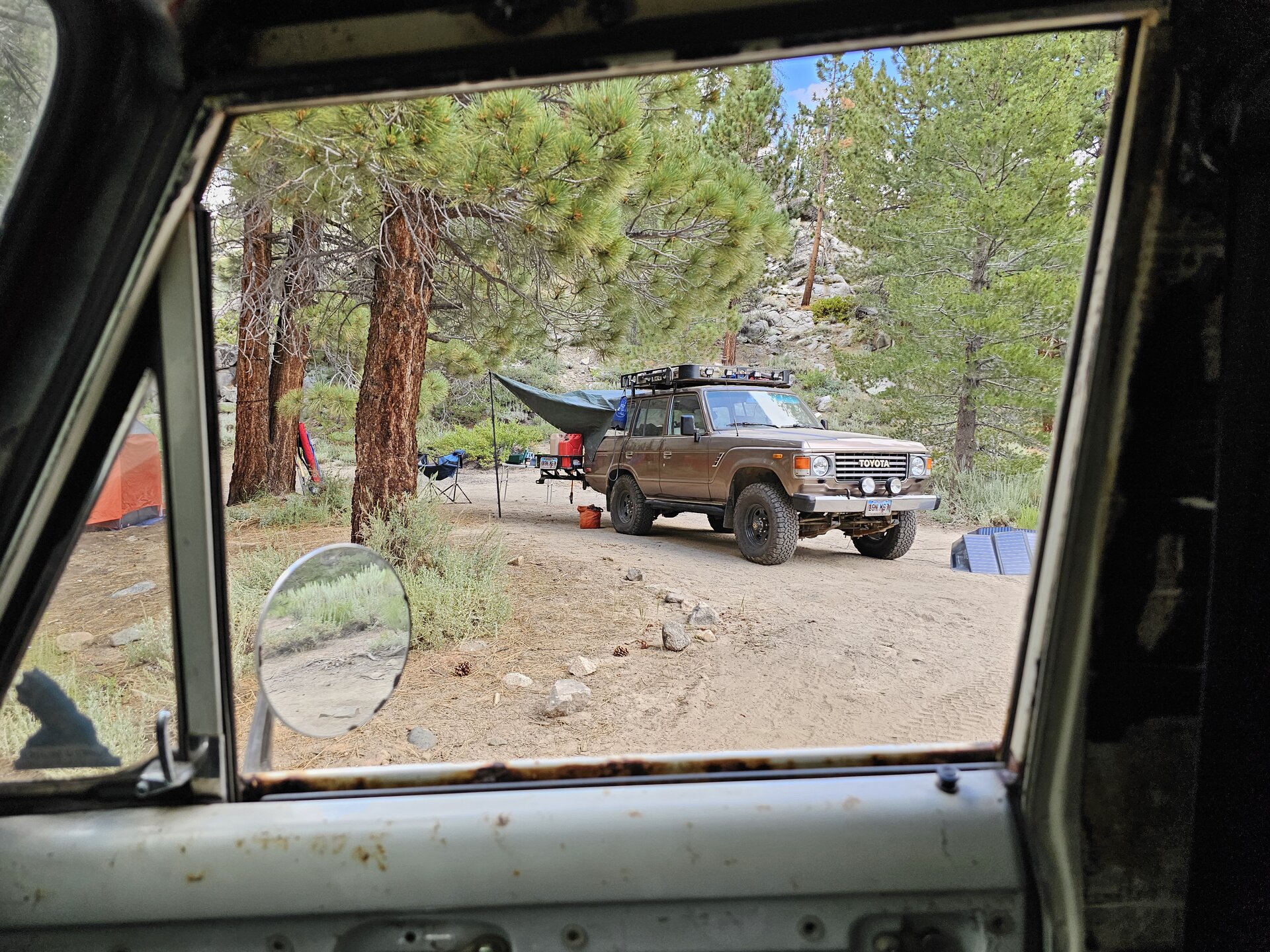

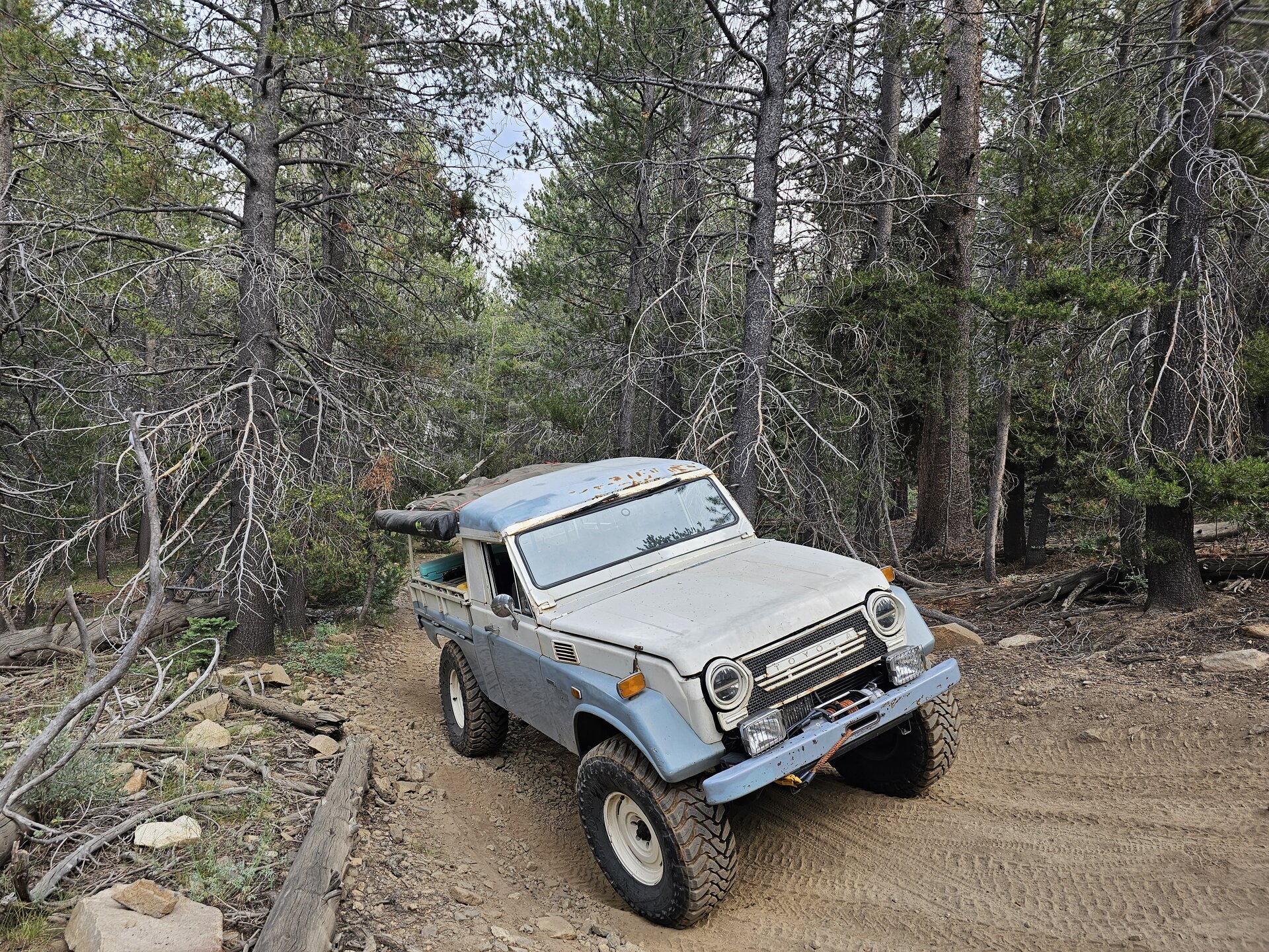

Now for the fun. Got to get out for 3 days to explore Monache Meadows 2 weeks ago. It was amazing weather and got to test out all the new upgrades on the piggy.
Ran into some members with various series Cruisers down by the river camps.

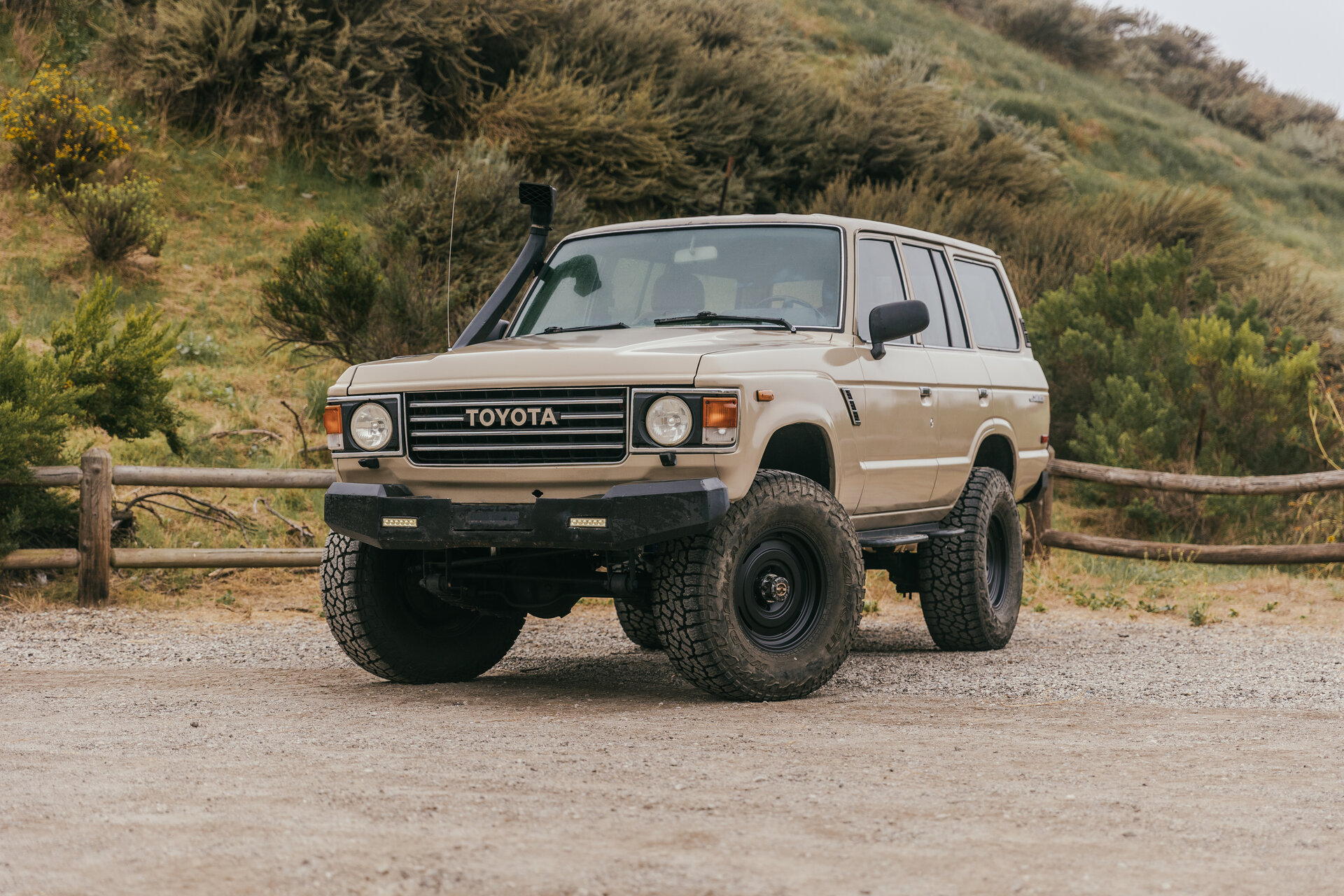

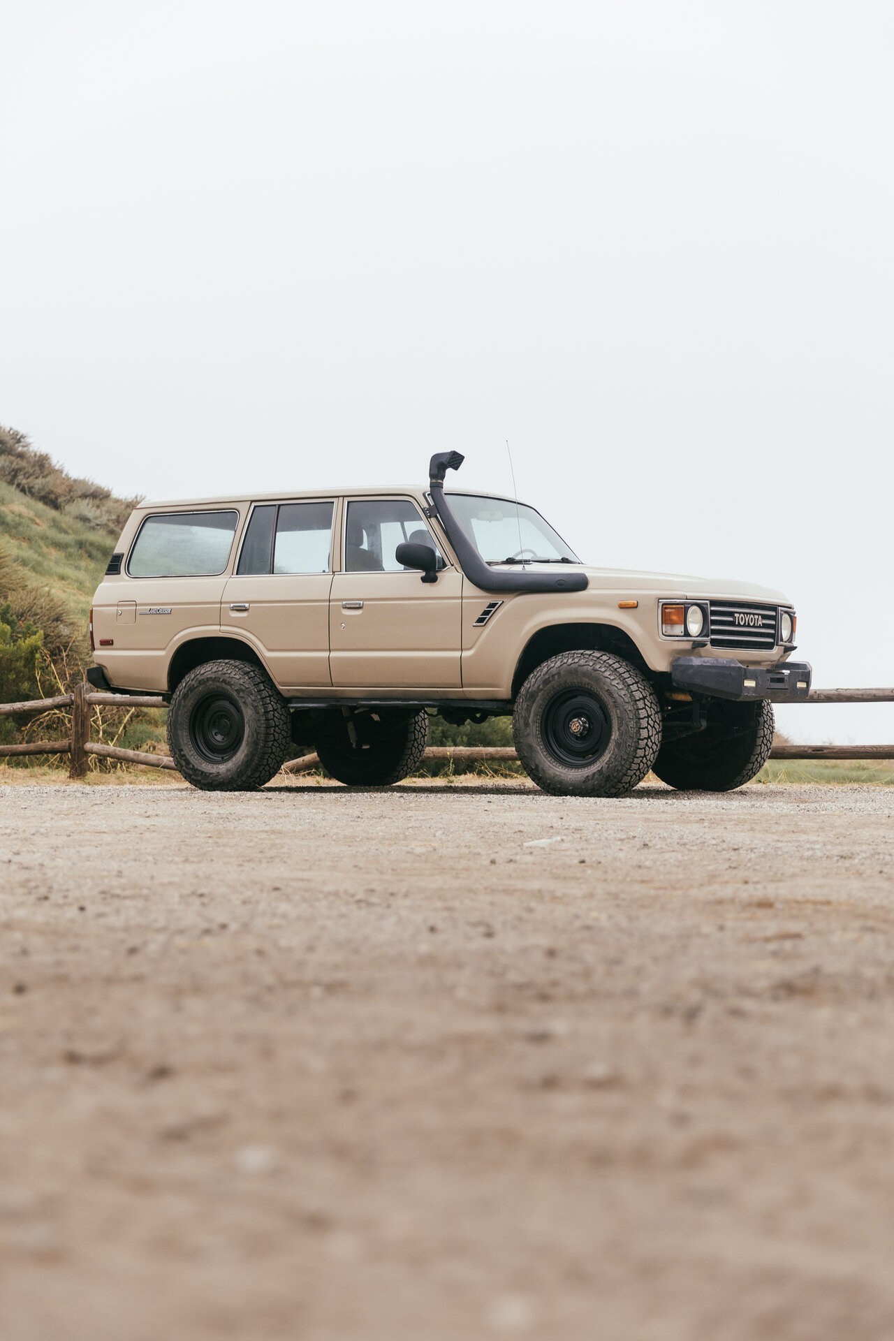

So Fifteen52 wheel company reached out to me on Instagram a few months ago and ended up doing a photoshoot of BaconBits. Thought I'd share some of my favorite pictures.
They also shot my LS swapped 60 since it had the same wheels.
Funny. I was just catching up on this thread and admiring the fifteen52s in white before I got to the photo shoot part. Good move on their part documenting 2 sweet rides !
I love everything about your truck but the snorkel. For some reason I just cannot get my head around them.
I'm right there with you! Previous owner installed it and I despise it. One day I will either remove and do the body work or just sell the truck. lol

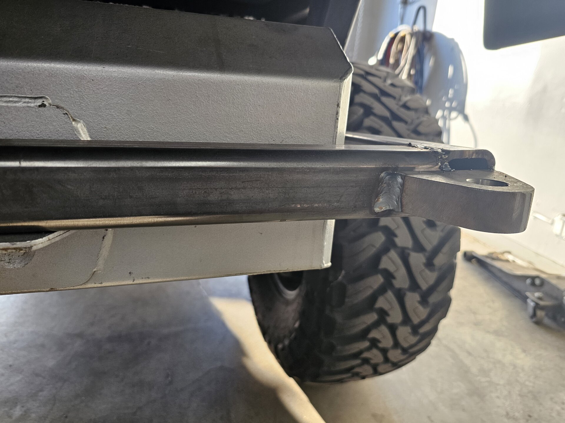

To add a Long Range America 25 gallon auxilary fuel tank I had to build out the rear frame section that was cut and shortened. Used 2" square with 1/4 wall and added a 2" receiver. Also welded some angle to the bottom and corners of the tank for added protection. Still need to cut the fuel inlet pipe and reroute towards the rear for the filler neck.

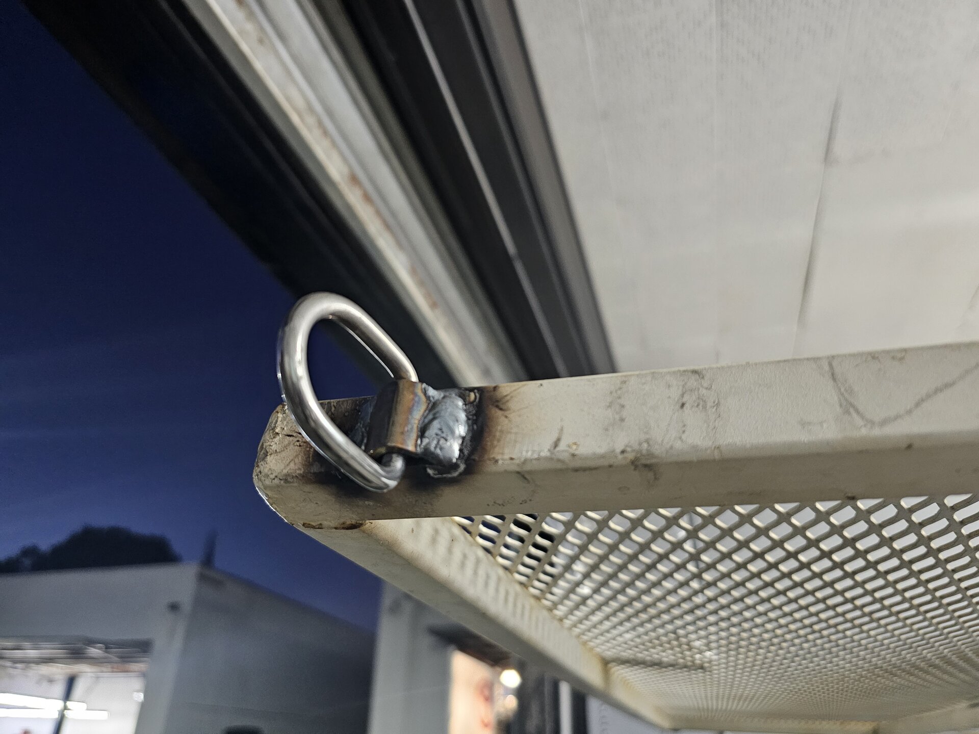

Finished up the rear section in flat black. I also added 8 small D-rings around the roof rack for attaching the RV1 tent. It also works well for tie down points.
