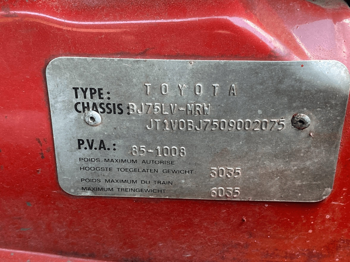

Theres the plate you asked for to use your magical decoding powers on.
That's actually a Dutch VIN plate (I think), not an original Toyota one. Nevertheless, it looks like you've got a K082 rear axle, so 4.11 gears. Same ratio as mine, but I have the K085.

For the Dutch VIN plate, would that mean that the car was originally in the Netherlands? A big amount of the red Troopys I see online are dutch emergency vehicles, but they all have locking diffs, which led me to think mine wasn't since I have open diffs.

Yes, I would guess from the VIN tag that the truck was originally sold in the Netherlands. Could have been a fire truck, but maybe not--hard to say. Most of the fire vehicles I've seen with lockers are Danish, rather than Dutch. I've also seen Finnish forestry trucks (in 6H9 green) with lockers. Almost all of both are badly rusted. Rare to find one that isn't.
For reference:
K082 = 4.11 semi-floating axle, open diff
K085 = 4.11 full-floating axle, limited slip diff
K084 = 4.11 full-floating axle with diff lock

Theres the plate you asked for to use your magical decoding powers on. Also how are you able to measure what grade you are driving on? or do you just know. Again thank you for all the help.

Congrats on your Red Rocket troopy ! From the VIN plate you show , I can assure you that your BJ75 is original from Belgium , not the Netherlands . Why ? It is written both in French and Dutch languages . Your BJ75 should also have the original Toyota VIN plate on the left to this one . The plate you have is the Belgian homologation for the maximum wheigt you can tow . Let me show a pix of both the VIN plates present on my 1994 HZJ80 , sold new in Belgium , imported and registered in Portugal 1996 .

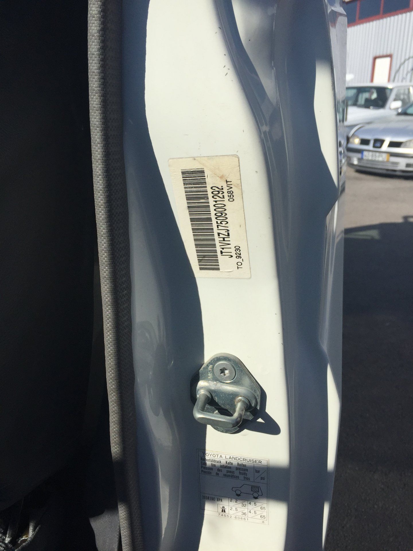

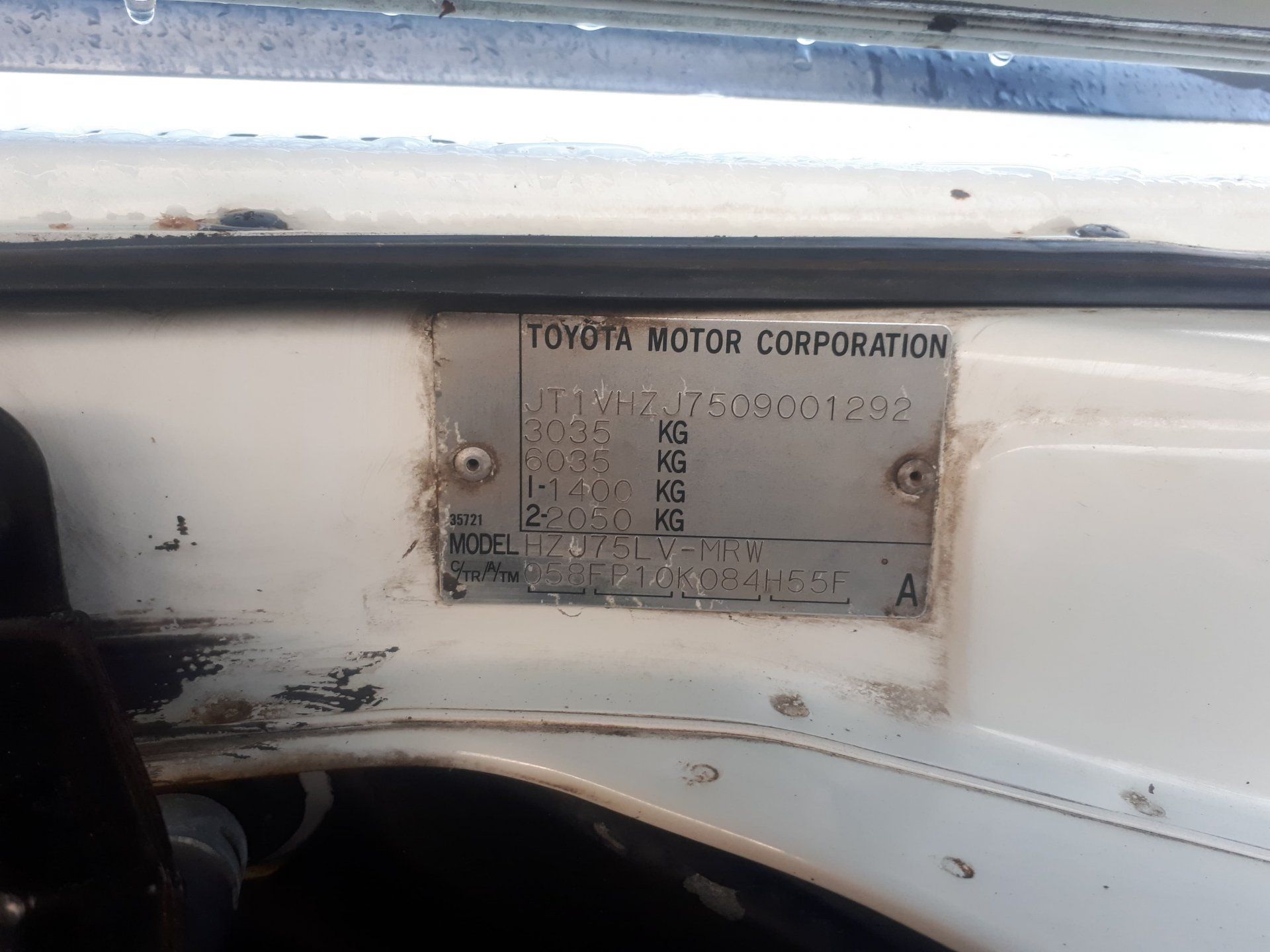

On the other pix , I show the original Toyota VIN plate on my July 1999 HZJ75 Troopy , one of the last 75 produced ! Produced 05-1999 , sold new in Sweden 07-22-1999 some days before 75 series production ended . Bought her at the Netherlands , some months ago and registered here in Portugal some weeks ago ( a real saga ) . Note there is also a VIN sticker on the B pilar , driver's side , but this is perhaps characteristic of the latest ones built .
