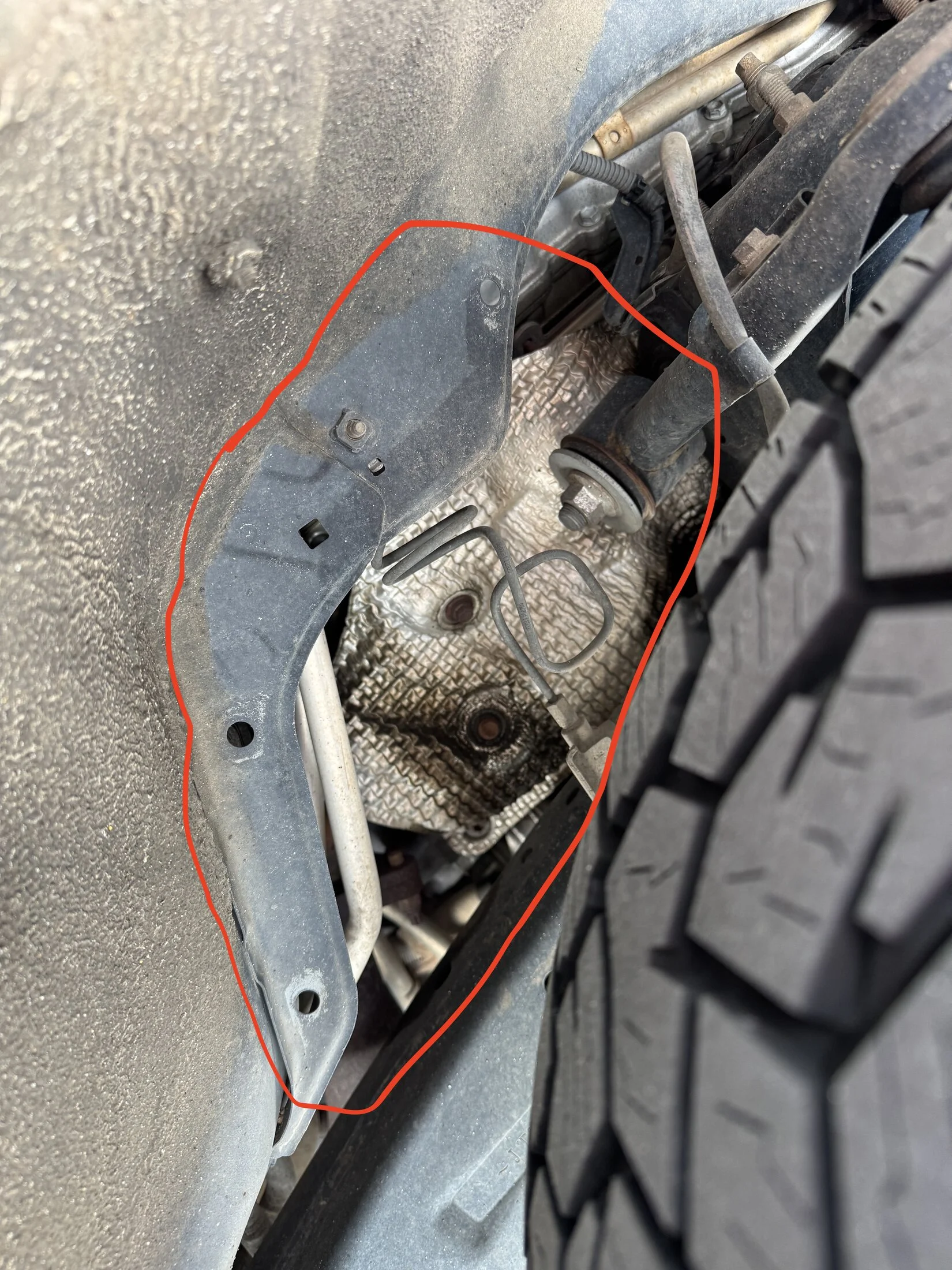

Hi! I'm looking for this apron on the front passenger side.
Thanks!

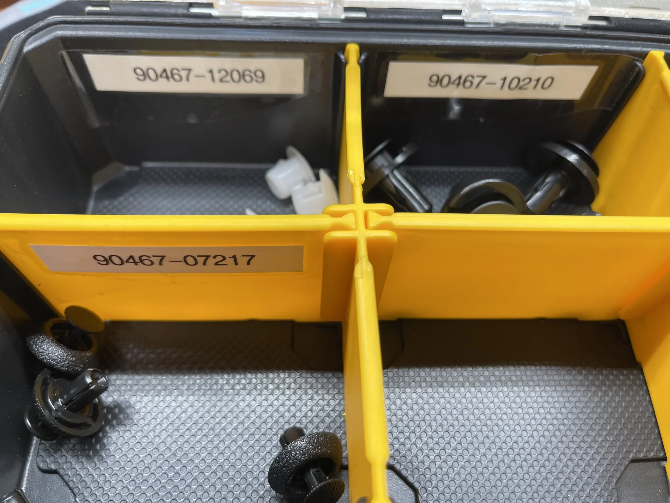

Since there is a sale going on right now I’m looking to stock up on the breakable plastic bits. I’ve bought in the past but I don’t think some of them are on my truck, it’s tough to tell what goes on there when some of the parts don’t have pics on the web site.
What should I grab that’s not in this pic for a 2021 HE?

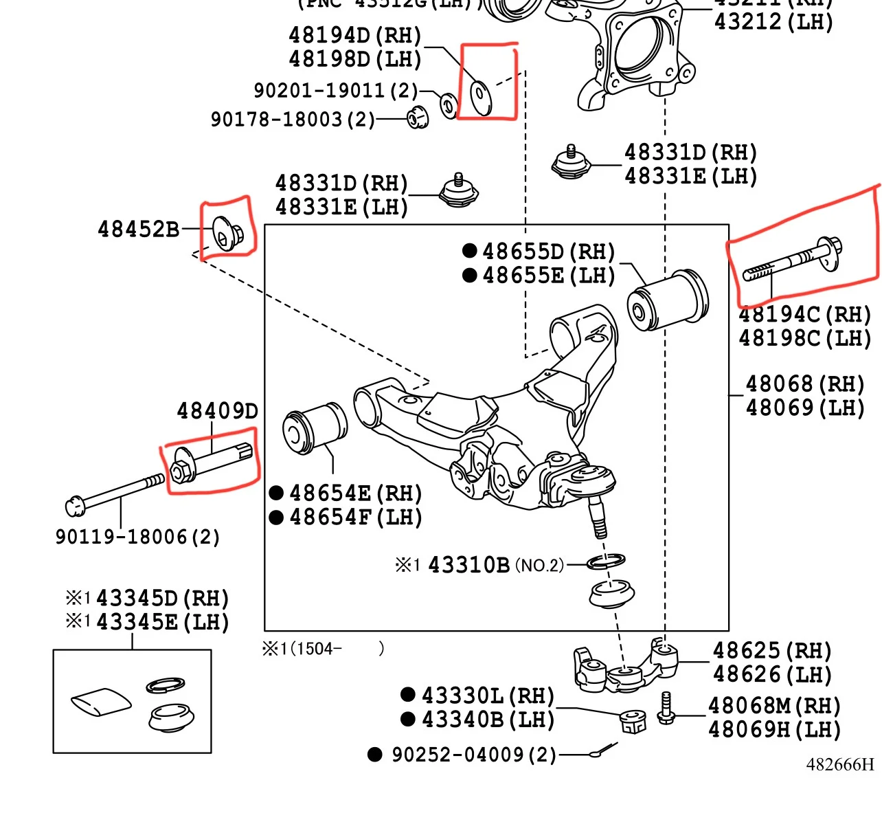

I can’t seem to find the “exact fit” for my model on the Toyota parts site for the alignment cams, circled in red in the pic below. I’m having all my cam tabs redone with the total chaos gussets and want new everything for my new LCA’s so I need all 4 part numbers unless they are the same on both sides for front and back. The bolts they show on this schematic that go through the cams I can locate the “correct fit” ones for because the part numbers are complete on this. I’m assuming the stock ones will be fine and I don’t need any extra length for the gussets.
48198-0C020
48452-34011
Sweet, 2 down!
How did you get the other half of the part number for these? This is always my issue and I want to learn so I don’t bug yall.
