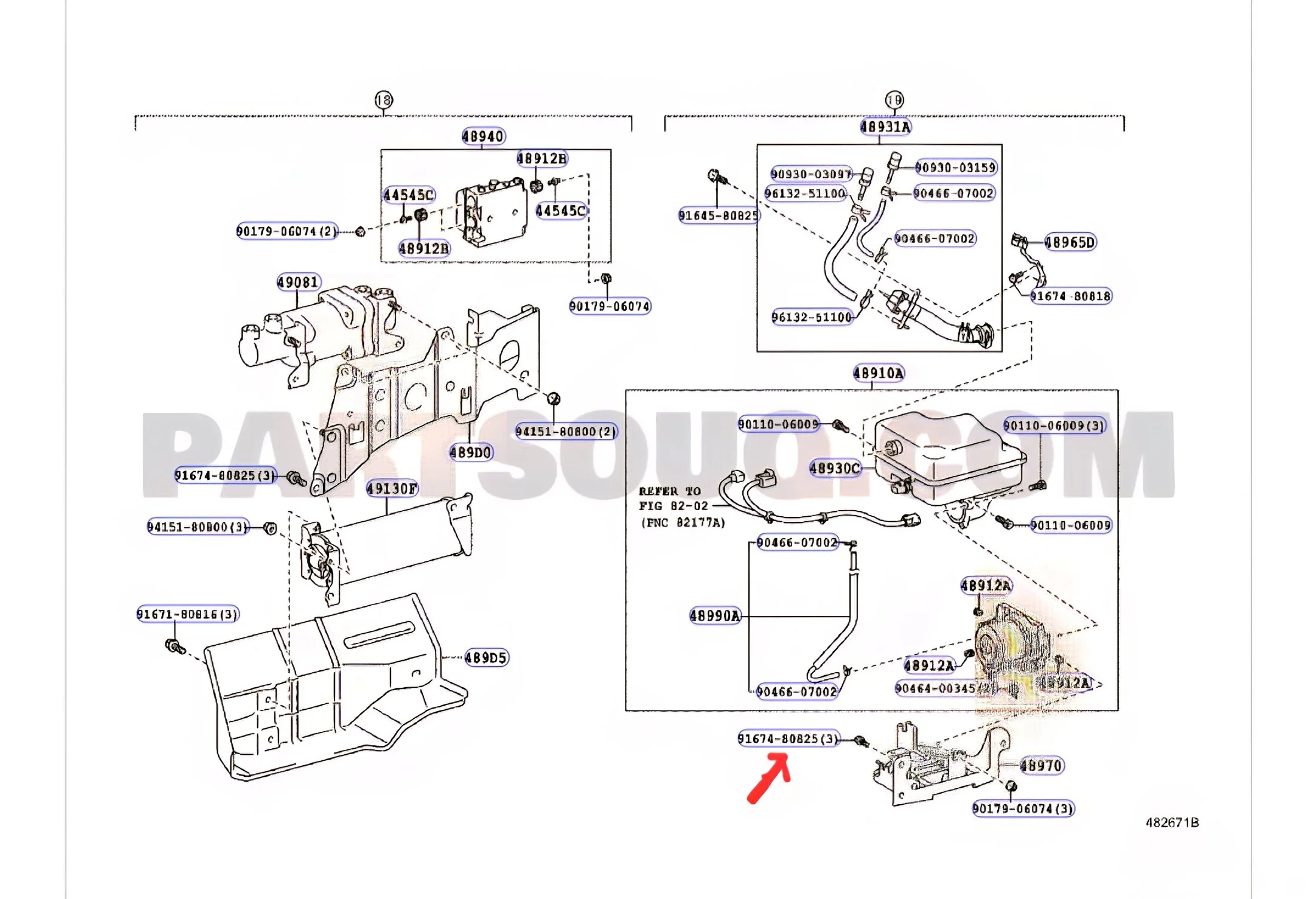

Does anyone have the part number for the three bolts that hold the AHC pump to the frame for an LX570?

Most likely 9167480825

I believe those are 91674-80825
Google image search the part number and compare to yours to confirm.

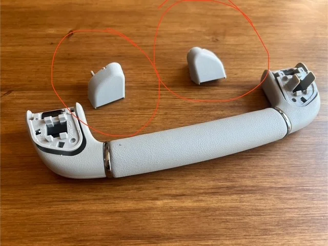

Anybody know what these ceiling "assist grip" part numbers are on the land cruiser 200? Also presume the part numbers are the same on all six pairs in the car.

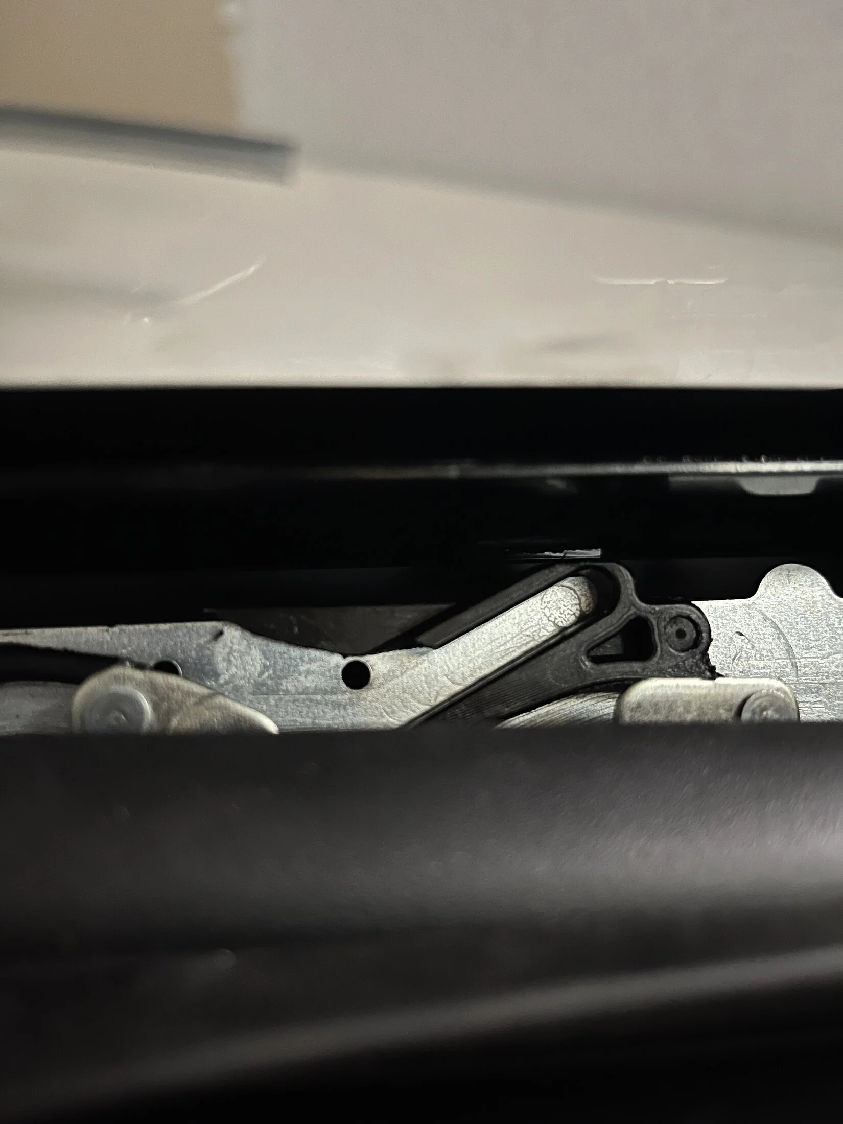

Sunroof is proving to need a bit of adjustment. For my worst case scenario, which of the following do I need, or is it both? From the looks of it the plastic guide gave up, and I can’t find a part number for just that plastic part. Part of me is thinking the 200 series have the cables available separately as all the sunroof threads are from 100 series owners and it looks like they have to buy the entire assembly.

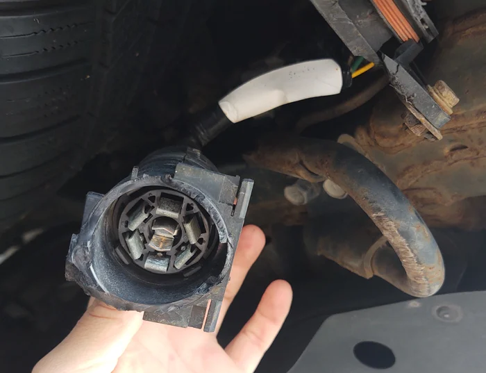

I damaged the trailer connector and bent the bracket. Can I replace only the connector without the short harness?
Someone posted before that the pigtail harness # is 8216960080. It looks like it includes the connector with the cover, the bracket and the 2 bolts to connect to each other. Is that true?
Here is the broken connector. The lid with its orange gasket can be seen in the upper part of the image still connected to the bent bracket.
Assuming I can see colors correctly and you have the light gray headliner, a pair for each handle should be 74611-60050-B0 and 74612-60100-B0
The shapes are different, so on one side of the truck one of those will be front one rear. It's the opposite configuration on the other side of the truck. But a pair of the above for each handle, yes.
Diagrams seem to indicate it only being available as a whole unit.
Most toyota plus have a very small five-digit number molded into them that can be combined with another number to get a part number.. but that's all of toyota's "normal" plugs, not sure if it applies to the trailer harness. But it's probably worth inspecting it closely for a number sequence.

My diagrams show three relevant main parts. The motor and gearbox assembly, the overall support frame, and the cable assembly. It appears the support frame doesn't have separate parts like ramps or what's in your picture... probably just rails for things to slide in.
My gut is you'd need the cable assembly. But for stuff like this that can be quite expensive if you order the wrong thing, I'd usually suggest finding a toyota parts counter with someone that knows what they are doing. That way if they get the wrong parts it's on them.

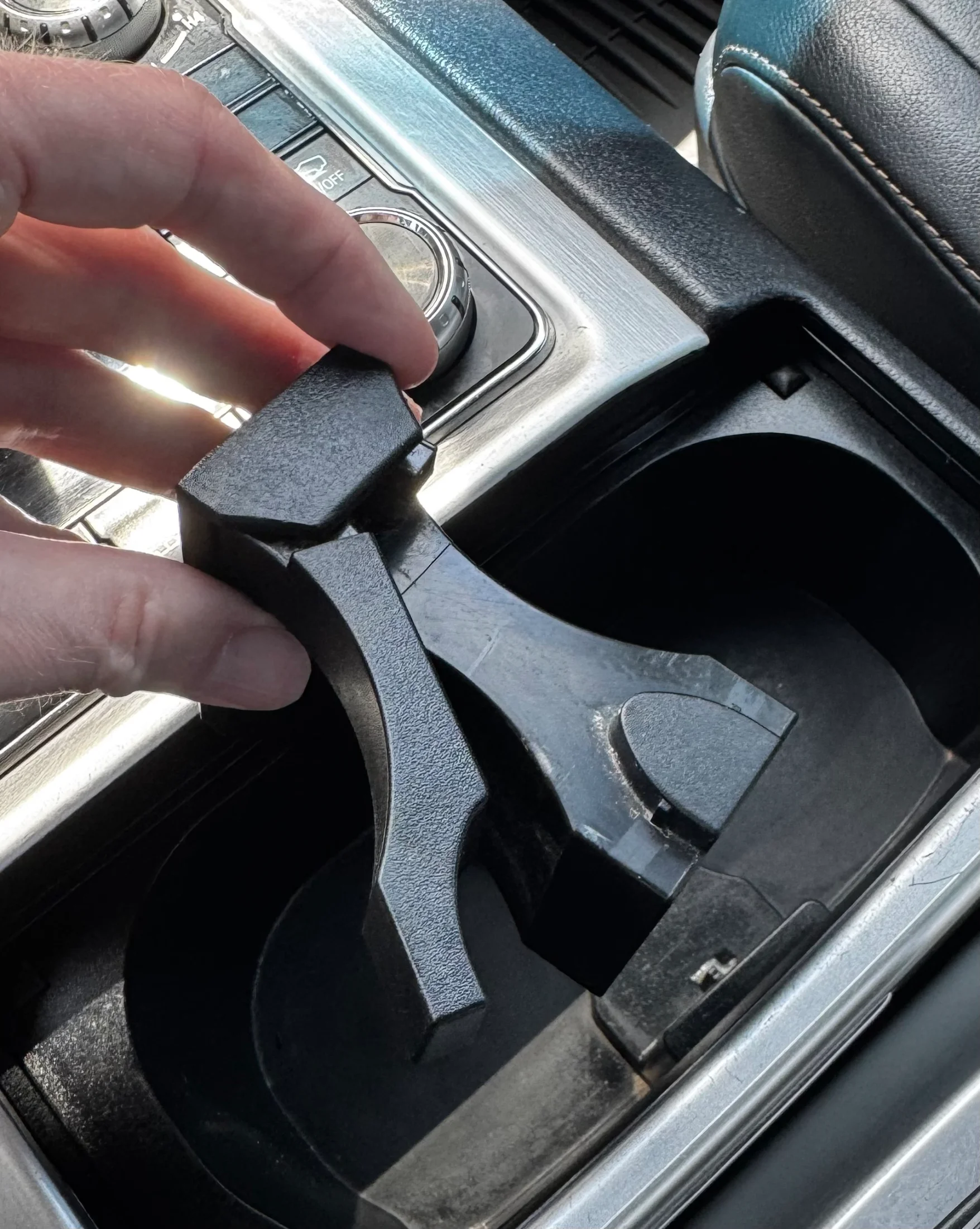

Hi Bloc,
Could you give me the part number for the little divider that goes into the cup holder?
I had my car cleaned today and somehow they broke off one of the arms. (And annoying, didn’t bother to mention this to me and just threw away the arm)
I have a 2022 heritage Land Cruiser with a black interior.

Hi Bloc,

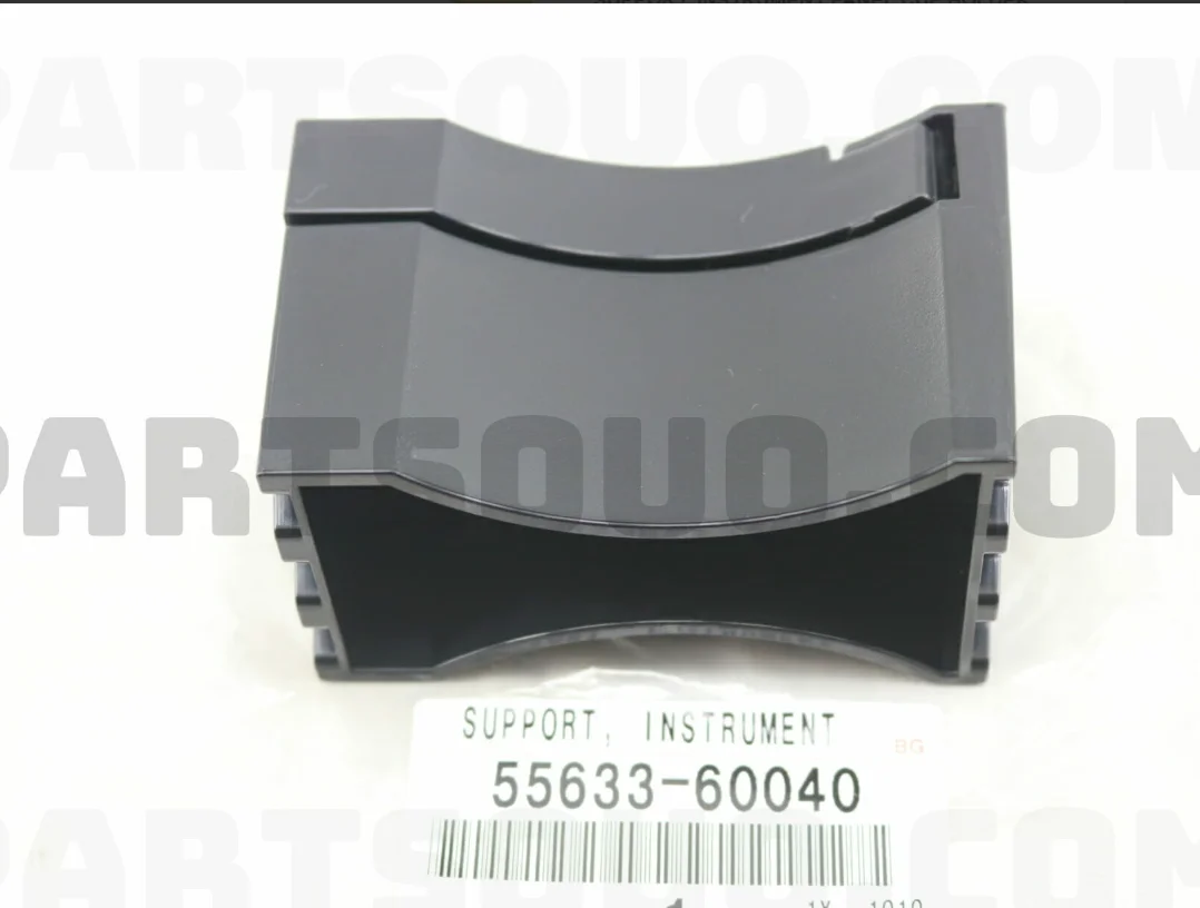

This is what you should have in your LC.
Thanks @turbo8 & @bloc !
And the replacement costs $30something!?!
Wow!
I’m going to take a flier and purchase a knock-off on Amazon for $12.
I’m sure I’ll regret this, but for $12 I’m willing to roll the dice a bit.
Just to follow-up on my previous message; I received the $12 version of the 55633-60040 from Amazon.
As far as I can tell, it’s indistinguishable from my original one. Hopefully it lasts.
