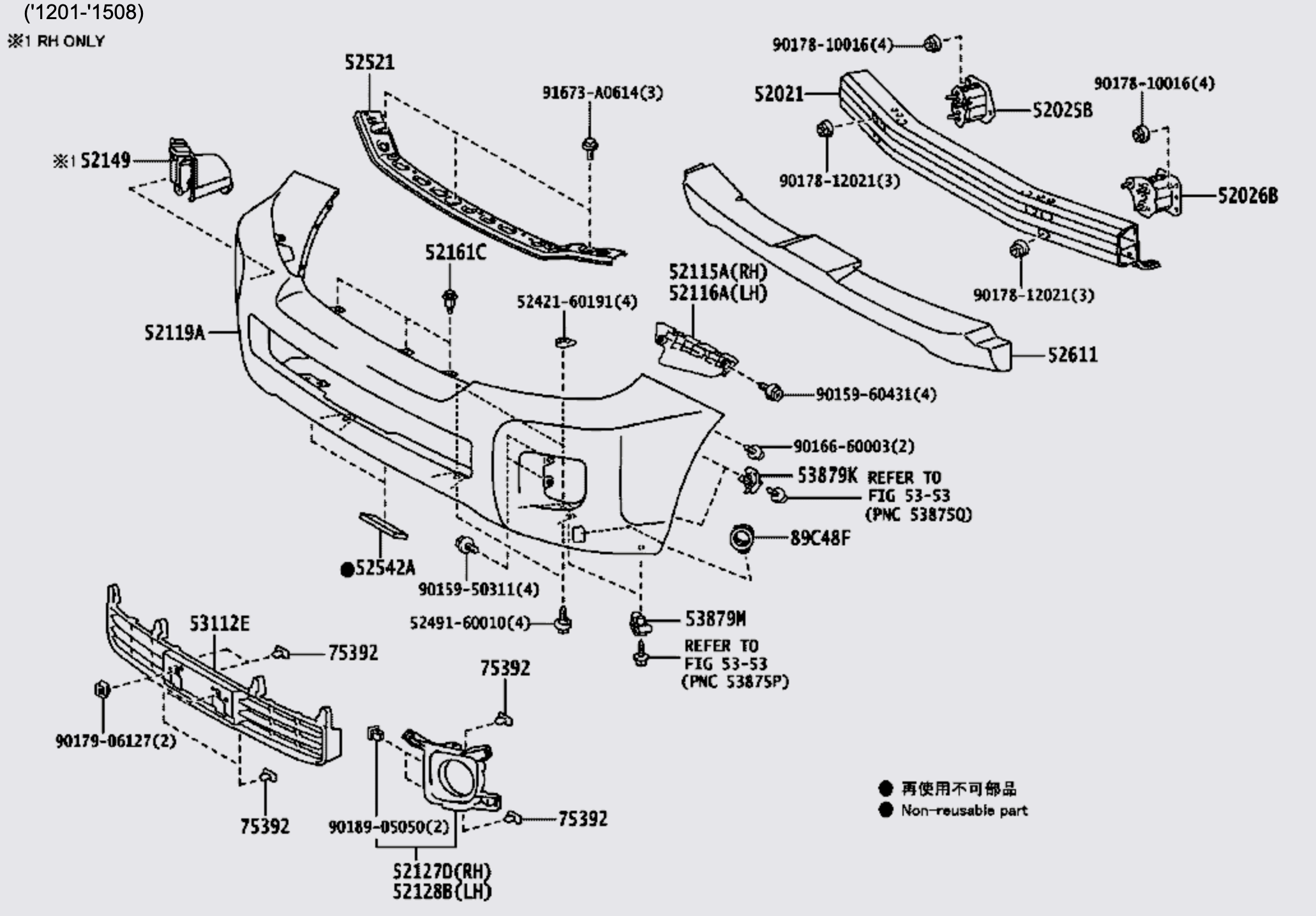

looking for the name and part number of the brackets(?) that 52521-60130 “retainer front bumper” attaches to. Specifically the ones outboard of where the lower headlight bolt attach
Thanks.
2013 landcruiser
Build date 05/12
Thanks.
The diagrams aren't very clear on this particular part, and I even went out and had a look at my 2013 without it being clear what you need.
I'll attach the diagram and you let me know if what you need is on here.
looking at 52521, there are 3 91673-A0624 bolts indicated. I’m looking for the part that the left (passenger side) bolt wold attach/mount to.
I think the mounting point was removed when the PO removed 52521 to install a bumper and winch.
Thanks for looking.

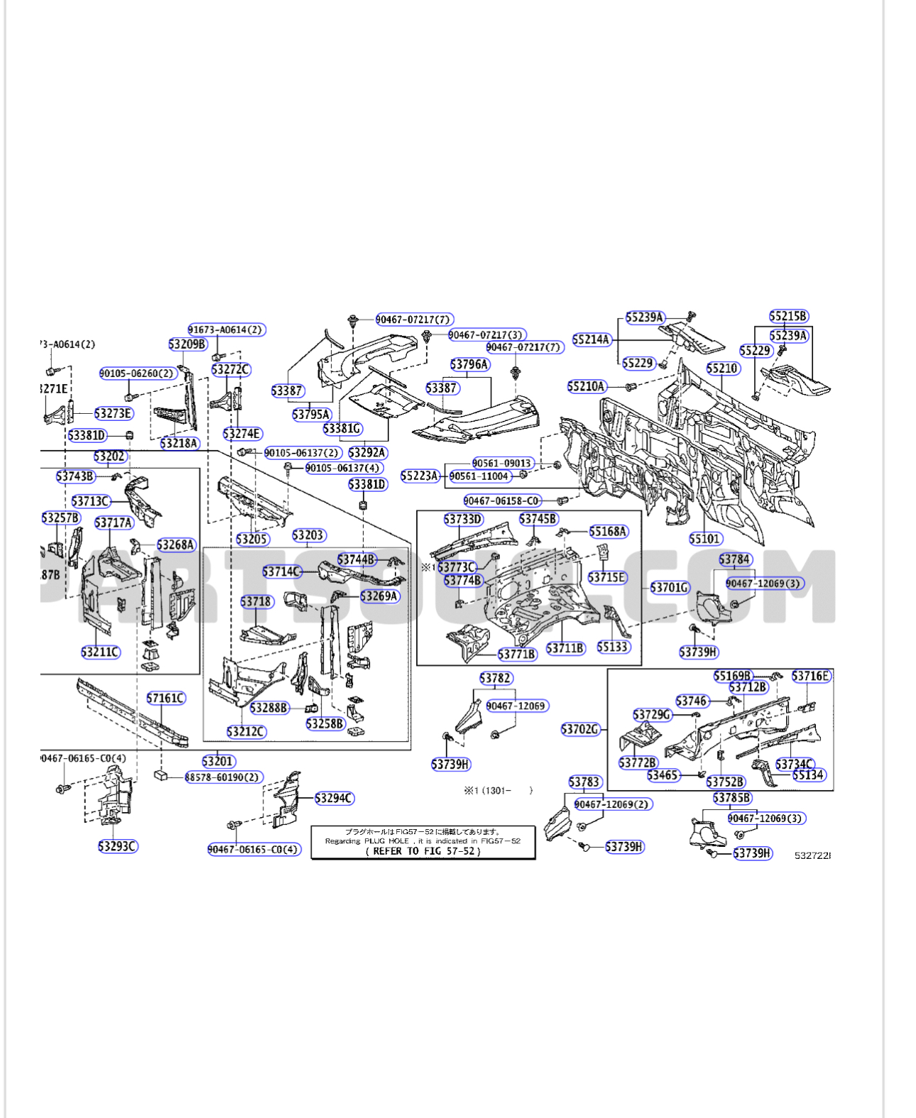

I went to look at this diagram and dont believe what he is looking for is in the picture.
Pretty sure it’s on this page, but good luck picking it out.
