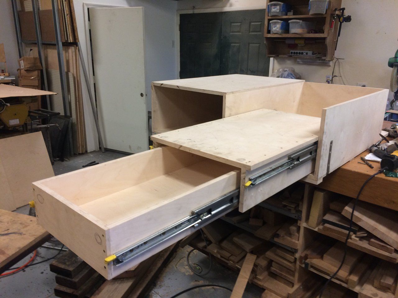

Box. With the trip coming to Colorado, figured it was time to build the box I have been talking about forever. Stole ideas from several different boxes I have seen over the years. Thanks to @StucknKS for tricks on shimming under the box. Ends up that our floors are not flat. There is one rib in the front of the rear axle that is higher by 3/8 inch!
I found some locking slides on ebay. They are shortish, but seem to work great. May upgrade to longer ones in the future.
The drawer is made from HDPE. There is enough tension that it does not slide around, but slick enough that you can pull it easily. Thanks again Stucknks for that idea.

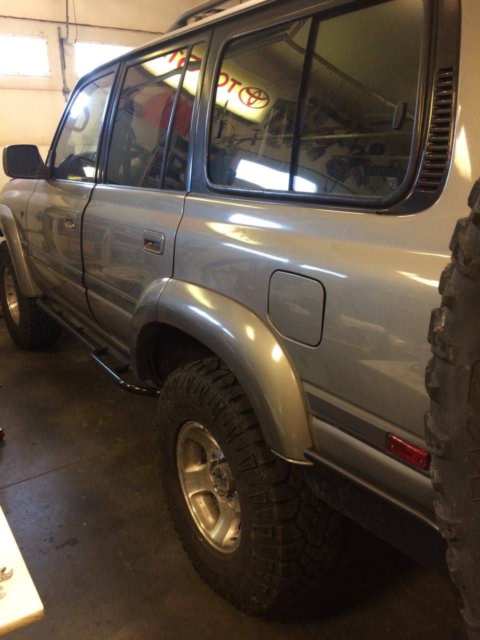

Finally, stole the tires that are for my son's rig for the trip. The goodyear tires make this look totally different.

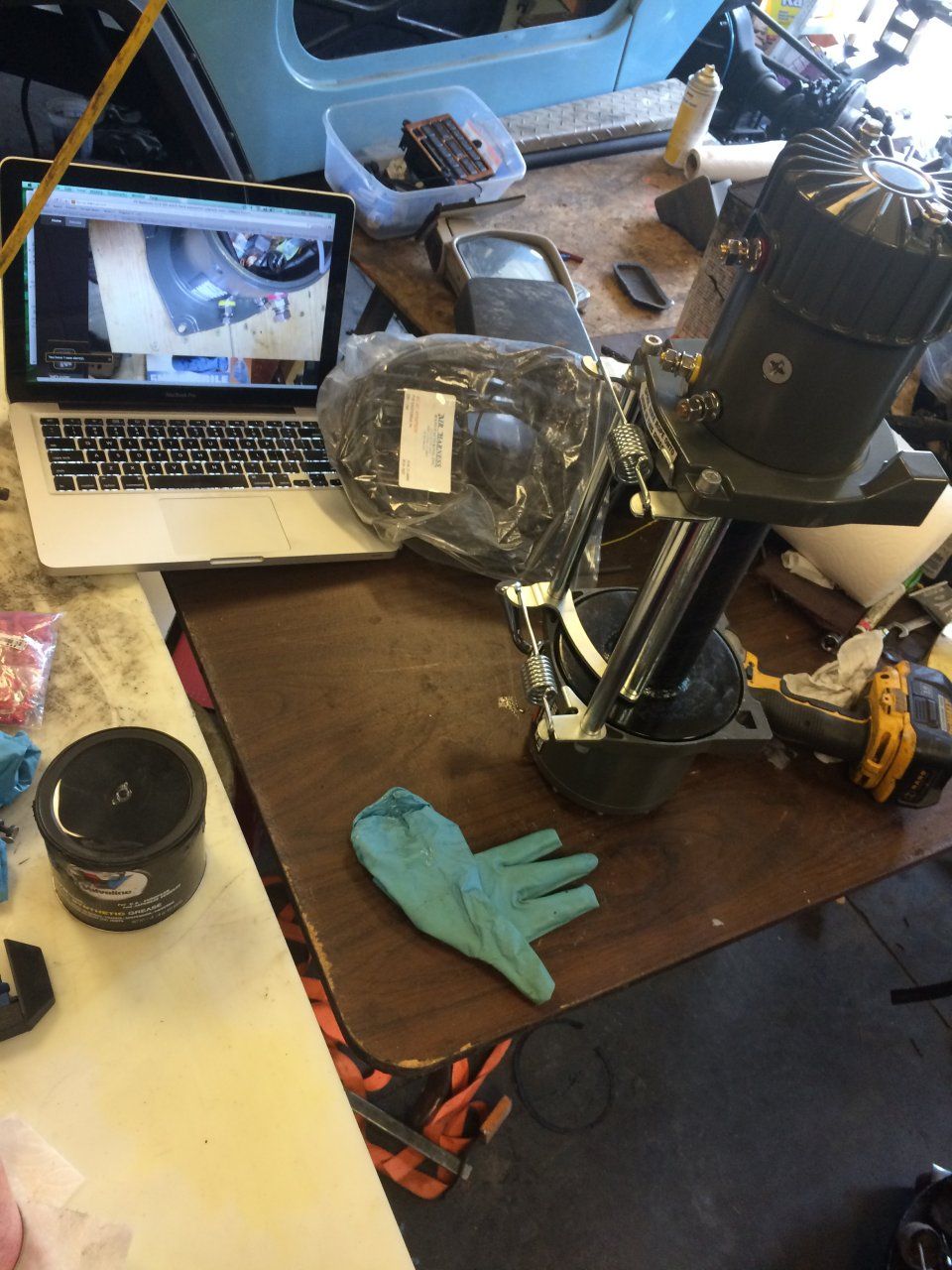

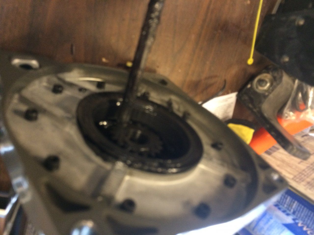

Winch waterproof. Need to thank @half k cruiser for his information thread on waterproofing the HF badlands winch. I went ahead and clocked it and cut and turned the engagement level. If found that if you cut and turn it clockwise 90 degrees it is much easier to operate, and you can move the winch back further, thus move your bumper back more.

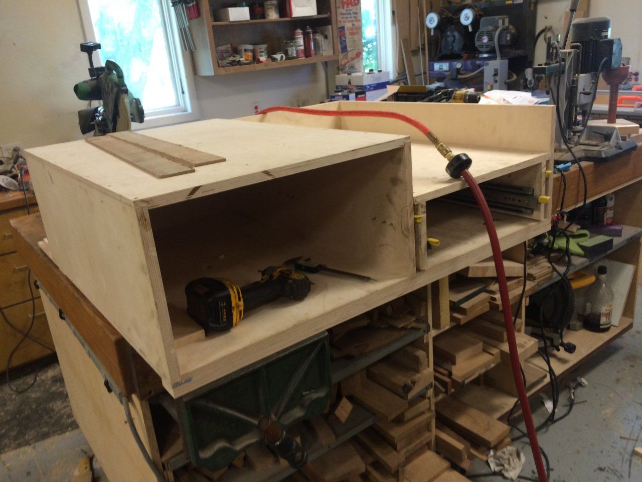

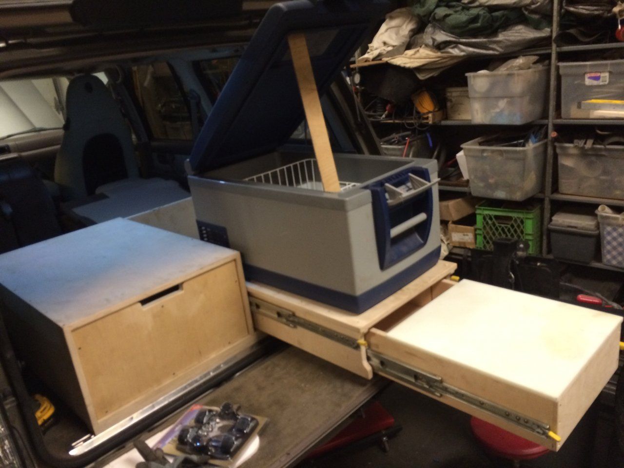

Got the rough project wrapped up and installed ready for Colorado. I will take it out Sand it and finish it when we get back. Only unplanned thing was that when the rear hatch is shut there's a curvature to the back of the car that meant I had to push forward the fridge a little more than planned. Right now I kind of like that the fridge only slides out 20 inches but the lower drawer I can't access the back so I would like it to be a little longer

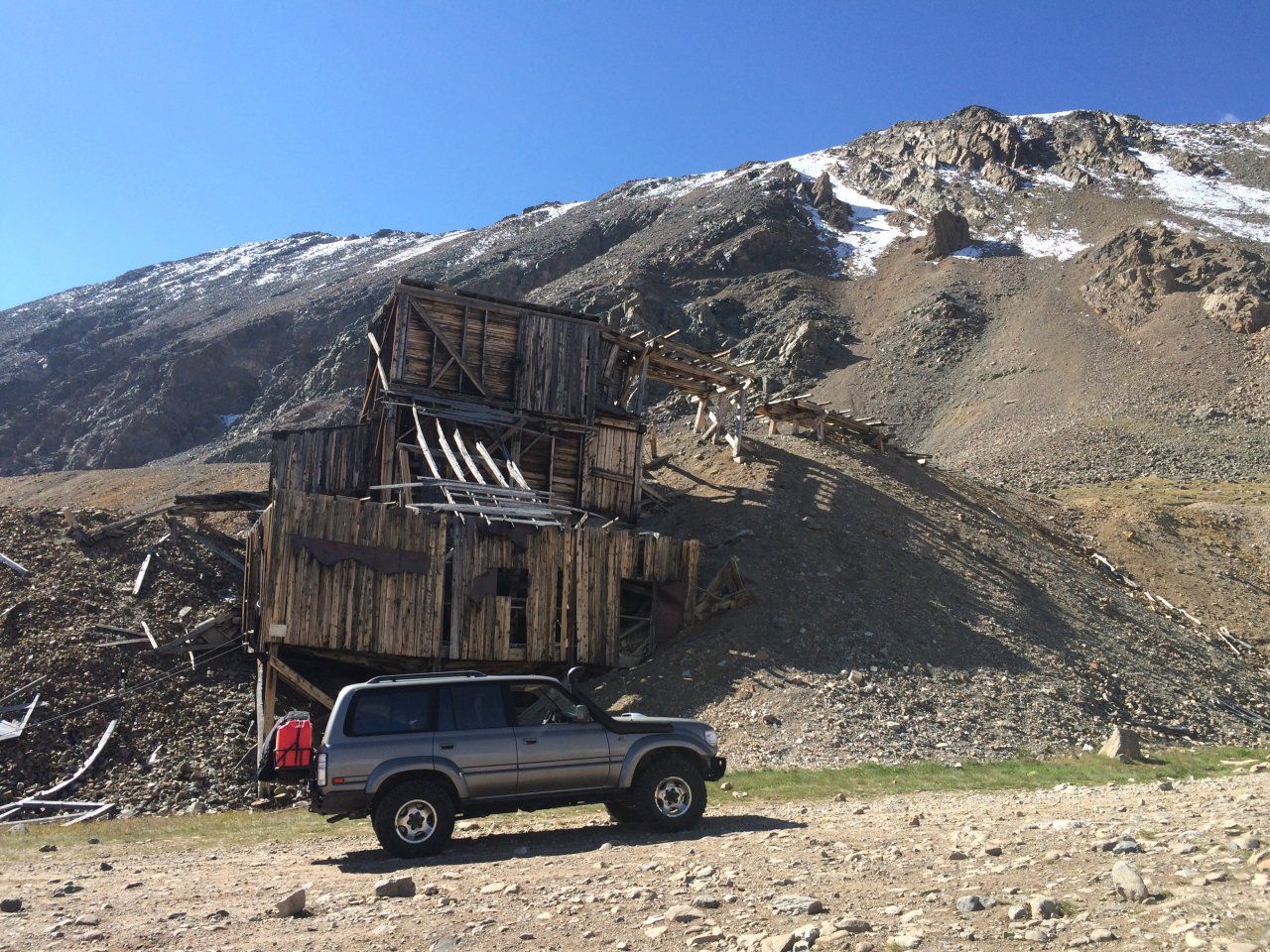

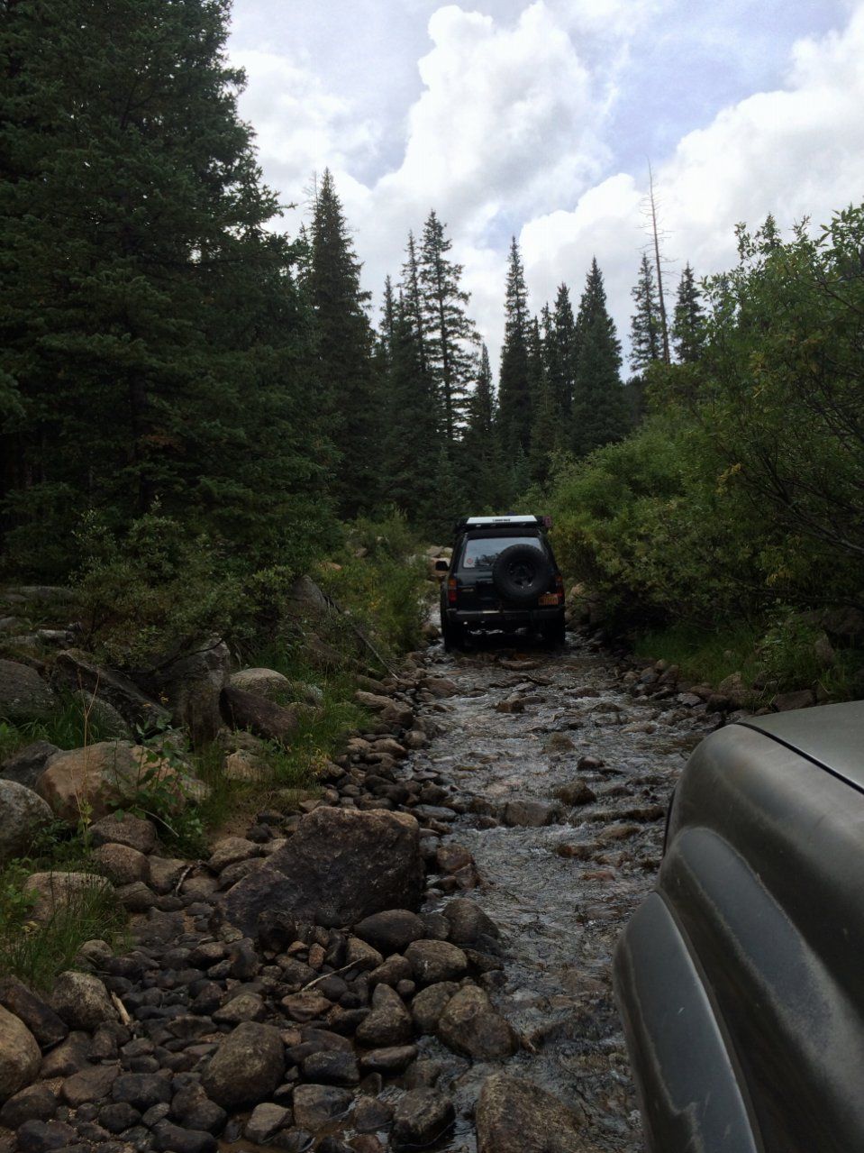

@2fpower first pic looks like North London mine at the top of Mosquito Pass, where was the second pic taken ?
I'm pretty sure that was on Taylor Pass. It had a long section of driving in the stream.
Yep, Taylor pass. Of course that is @StucknKS rig in the picture. Mike, I like your new Avitar. Anyone know where that came from?

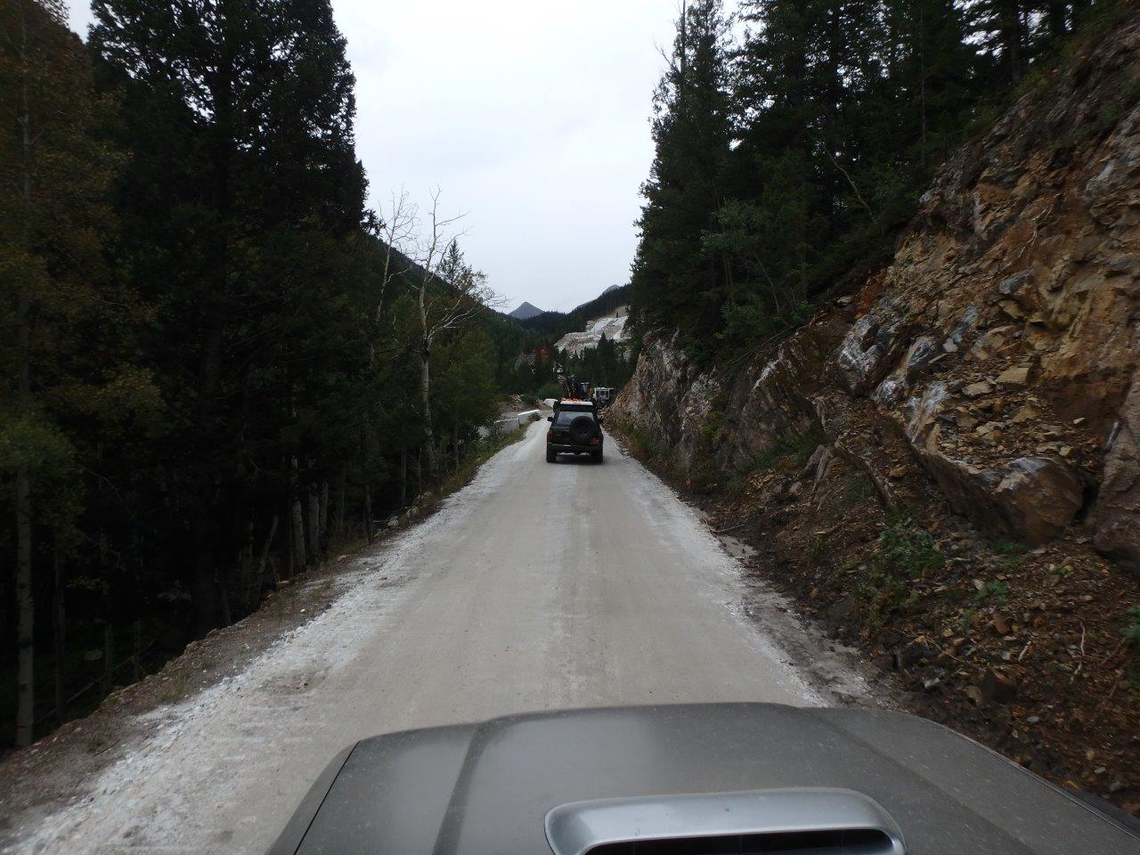

The white road is near Marble Colorado. They were spreading marble filings on the road that day making the pure white road.

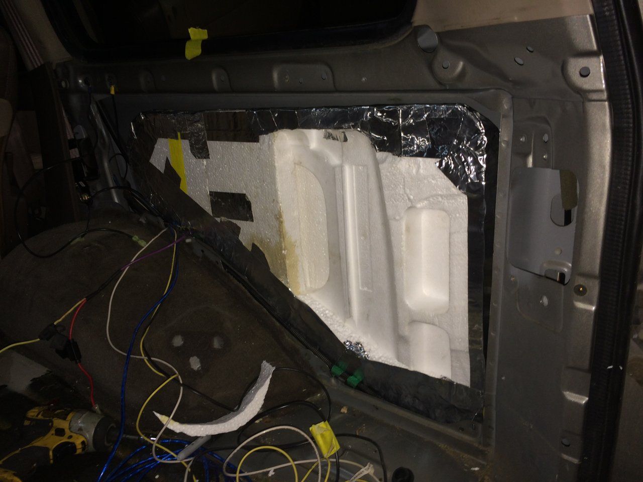

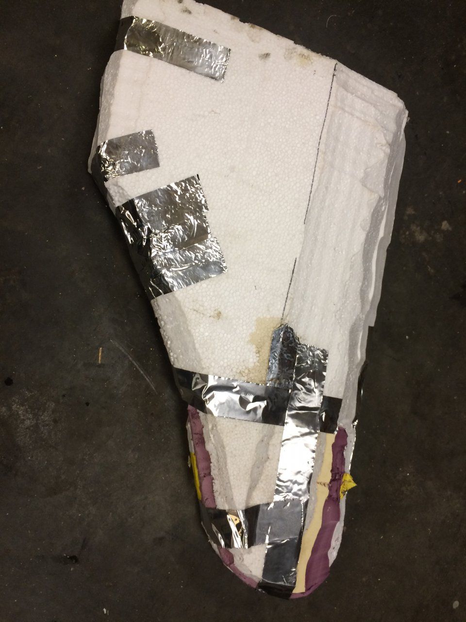

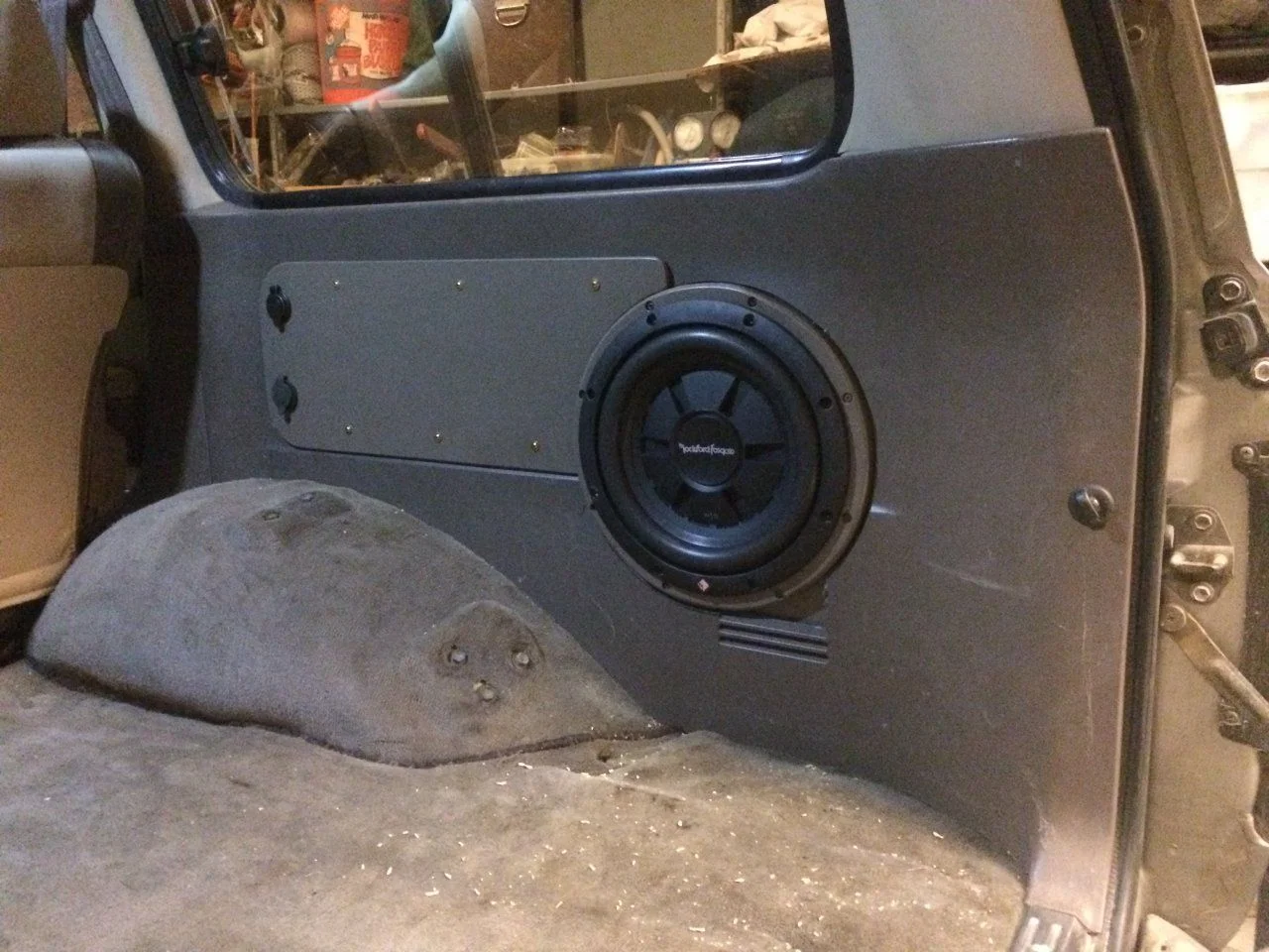

Decided that before I finalize the rear storage I needed to get the sub woofer finished Based my ideas off of some old threads what people build fiberglass enclosures in the rear quarter panel. Started making a rough foam insert to act like a mold. I am just not sure of my fiberglass skills to make a mold in place.
Second step was to wrap the mold with aluminum tape. I think that will allow it to release and be a smoother surface.
Then, I decided to go ahead and put a 1/2 plywood cap to be the mounting surface on the front.
4 layers of fiberglass later it looked interesting.
Plan is to figure out where I want the sub to mount now (recall that I had to remove the rear cubby) and then cut the hole and then extract all the foam out of the mold.

Update pictures of the sub, and the inverter under the tuffy box. I also made some aluminum dividers the Tuffy box to be able to organize things better

I was told a lil sub enclosure tip from an ex MTX audio installer, use felt in place of fiberglass, then just spray or brush with resin, like you would the sheet type glass... easier to work it and to smooth out and paint...
Polar fleece works great too - absorbs enough to go single layer for asthetic areas, or stapled over a wood skeleton & layered you can get crazy.
