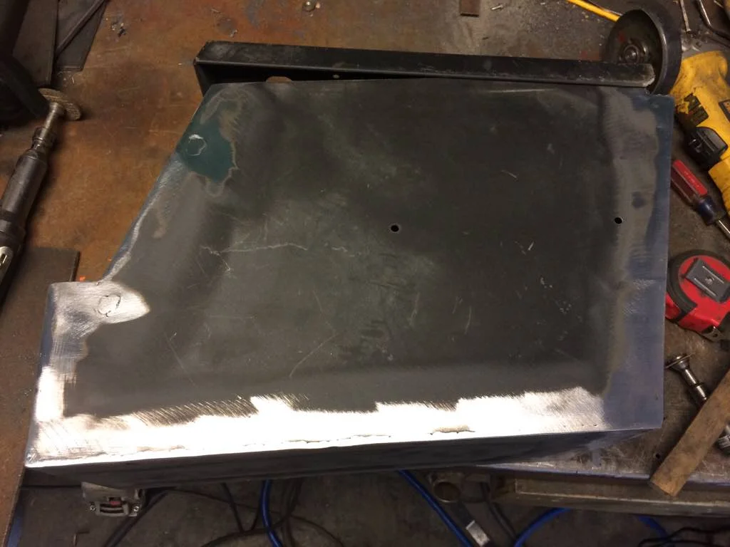

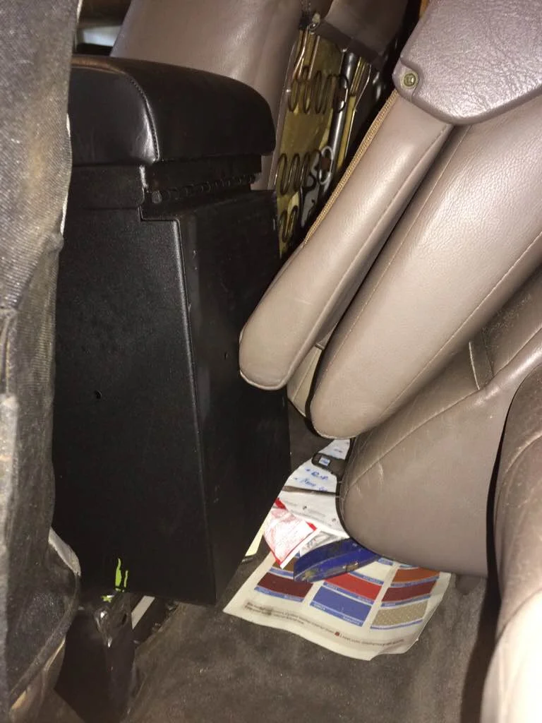

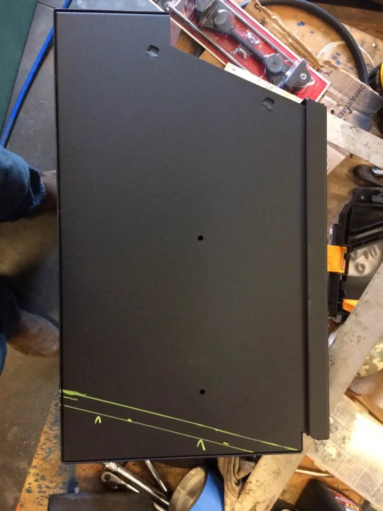

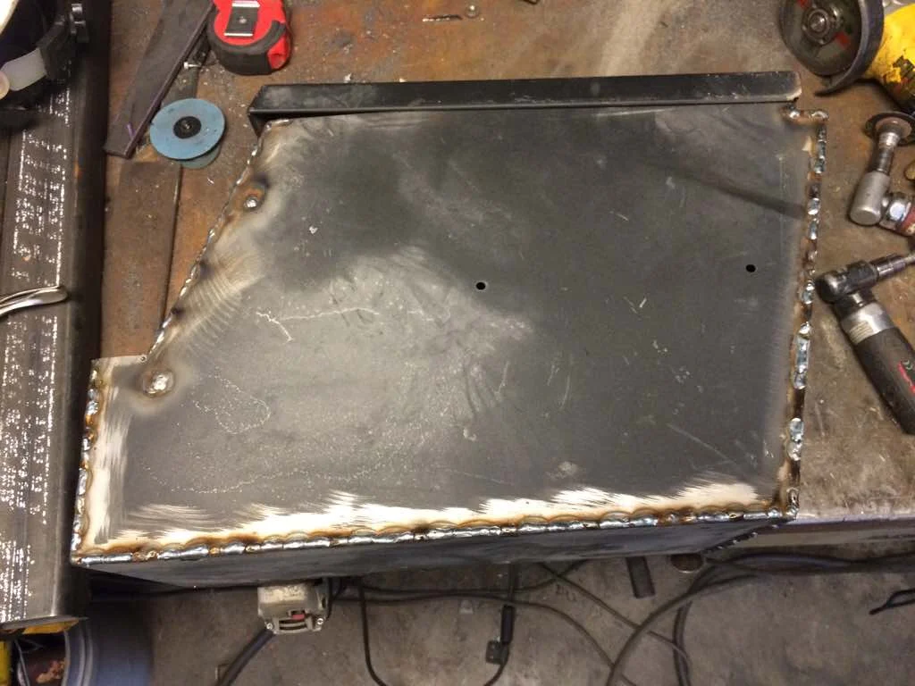

Been working on the Tuffy box installation. I started doing it just like I did foo; however, quickly realized the backseats would not fold up.
Decide to modify the Tuffy box. It's only brand-new once, right.

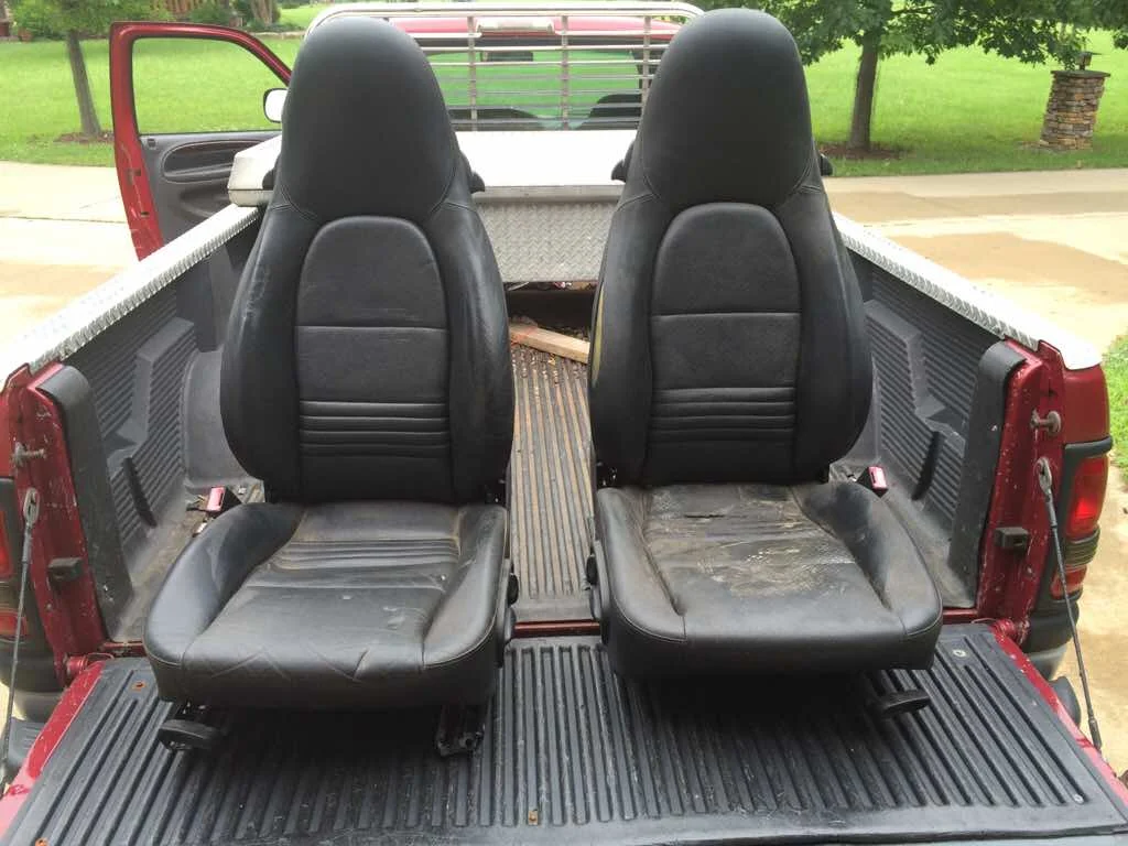

Forgot to mention that I found some new seats.
Anyone recognize what these came from?
Almost looks like porsche recaro's
Dang, that was fast. Got them out of a 02' boxster. Need to get an electrical wiring diagram for it though. Must of had a dozen wires going into it.

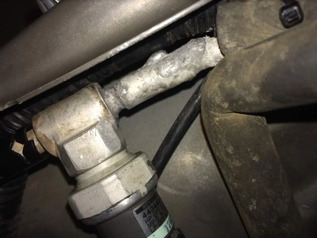

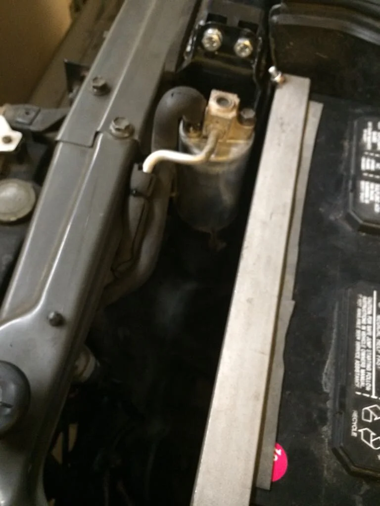

Here is where I spliced in the older 80 series tubing for the a/c. The pressure sensor is different on my 97 year, so I joined just before that.
First time using aluminum brazing, used forney sticks.
Did u get a new dryer? Need vacuum pump?
That is a good question. Short answer is that I got a dryer from Beno. Came from a Camry or something. Worked perfect except for the alignment pin was out of place, so I just yanked it out. I plan to do this adaption to FOO next, so i need to see if there is another dryer that fits perfect to the 93-94 land cruiser piping.

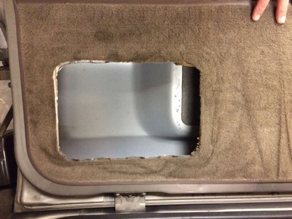

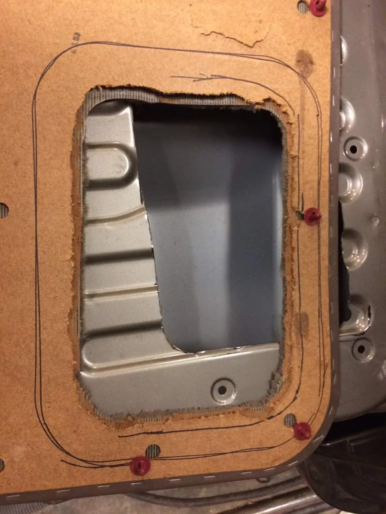

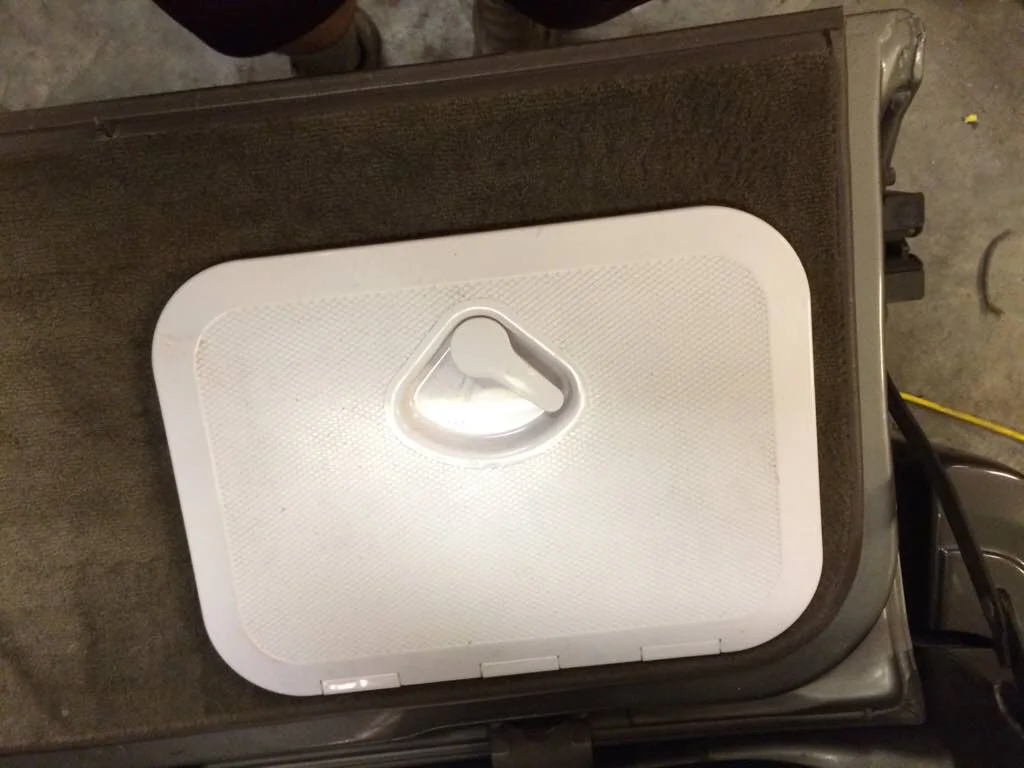

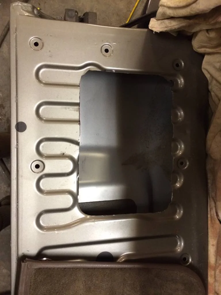

Oops, I forgot to post pictures of the rear cargo storage. I cut out the hole for the new door, carpet cut quarter inch smaller, A little primer, and put it all together

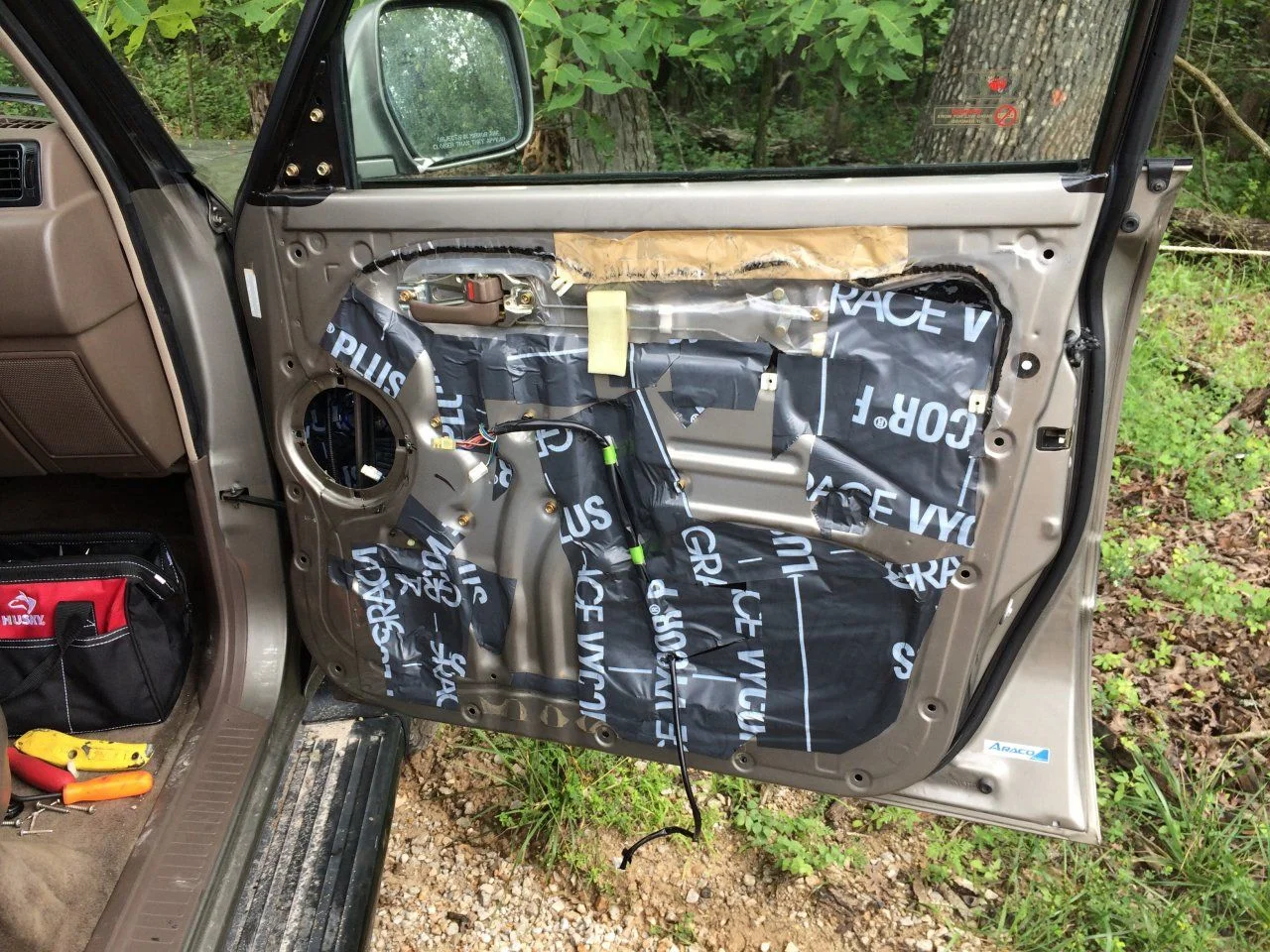

Still looking for the right powder coat color for the TUffy box, but started working on sound deadener in doors.

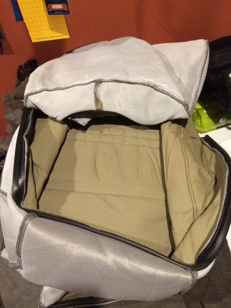

Got a package from L seat today.
New seat covers for the Porsche seats.

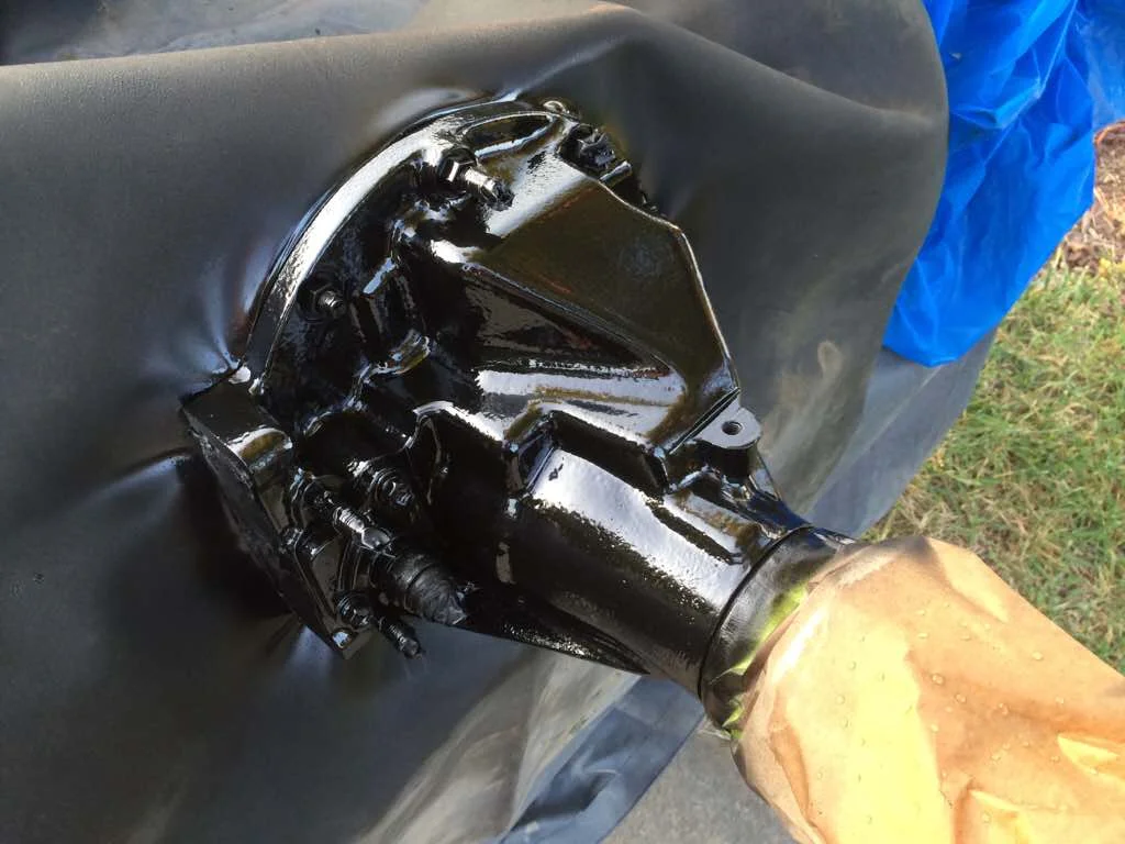

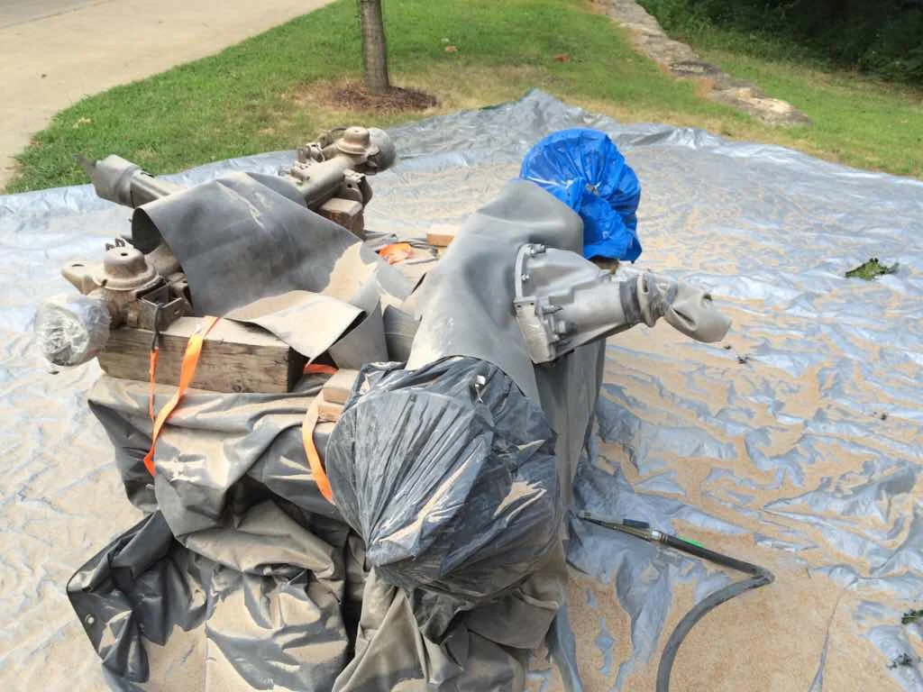

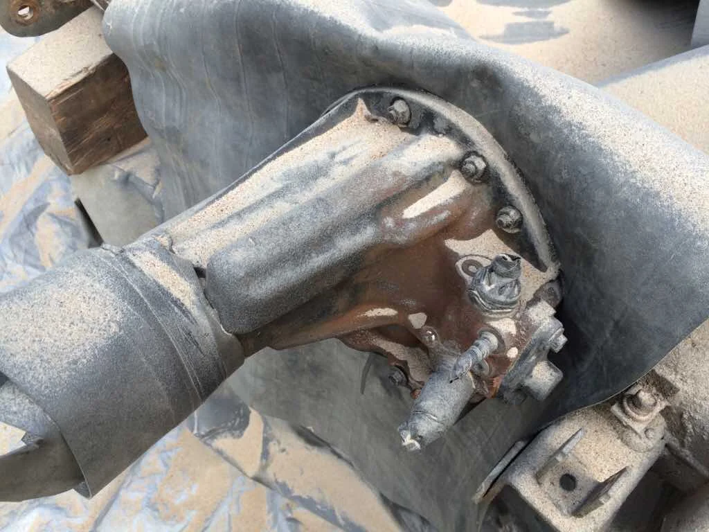

Thanks to Dave, I got a nice low mileage set of 4.11 gears. They were a bit rusty so sealed them up sandblasted and painted them.
