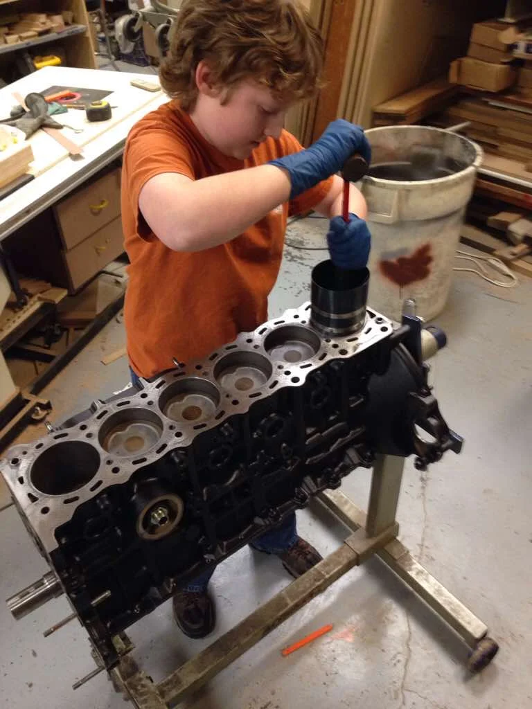

Finally got the kids out to work on the engine.

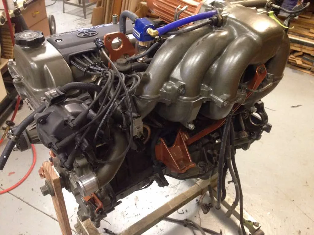

and finally got three of the different color parts installed on the engine. Plus a nice rusty oil pressure sensor. :(
Head went back on great. Used ARP studs, but otherwise followed the FSM. While I was doing the reassembly, I found that the prior owner did not put much care into the wire extensions for the supercharger. Wire shielding was brittle with being near all that heat.
I decided to take the harness apart, and pull the wires out of the loom over by the repositioned throttle body and solder the connections. I took apart the loom and the factory heat tape was terrible - just falling apart. This is the area where the EGR pipe is, so heat can be bad. I am not replacing the EGR pipe; however, figured it cannot hurt to protect these wires, so installed new heat tape.
Got most stuff buttoned up, except the front gear. My poor engine stand seemed like it needed help, so I will wait until the engine is in before I put it on. Still need to swap over some supercharger goodies, but getting close to having it ready to drop back in Boost.
