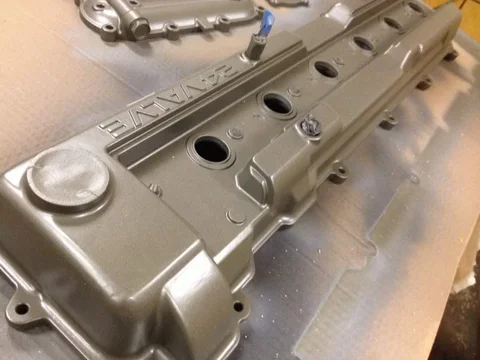

Here are some pics of the paint. [
ATTACH=full]1009071[/ATTACH]
